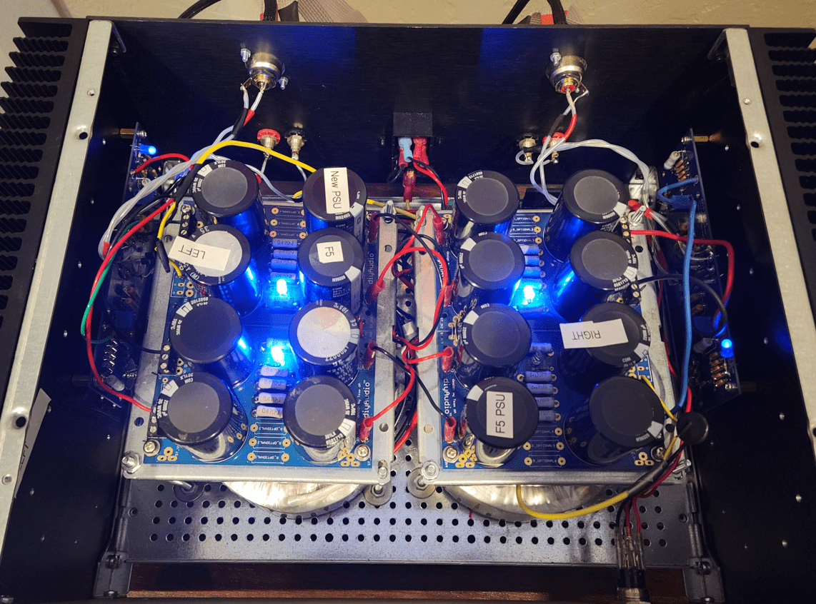

I don't think this patient has a pulse. The first time I turned the F5 on with the new mono PSUs and the amp boards attached I got music out of both channels but the sound was poor. So I rebiased the right channel but had no luck biasing the left channel which is its current state. The amp boards were previously biased for the basic F5 build I decided to move to the dual mono build. I don't think in my various testing since then that I caused a voltage shock to the left channel, unless I did it that first time.

No wonder the 2SJ74 wasn't working....one of the three legs was broken. Too much rough handling on my part. I tested it and it still works.
What if I just swap that out for a new one before I make the other swaps? I'm confident I caused that breakage before I first turned on the PSU for that amp board. Would that broken JFET make it unlikely that any other parts got damaged?

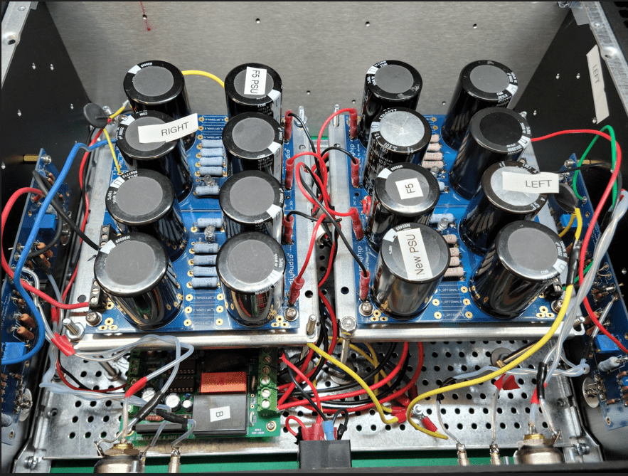

Update on my Duo-Mono Conversion of my F5.
With lots of help, I'm listening to it right now. Sounds punchier, but that could just be my biased listening. Time will tell. No, I think it is driving my Magnepan 1.7i's deeper now.
This was a great build project. Thanks again to DamonB over in the F6 thread who showed me the way.
And thanks to everyone with the help and support.
