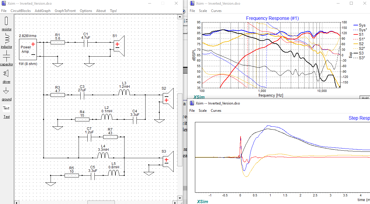

This is probably the last example. I here use a three way design but using first order. It's a non-coherent design with the mid being inverted polarity, while the woofer and tweeter are positive polarity. So I guess you would expect that being a first order design, the step response should not be complicated right?
But I guess as anything in life, as you want more and more, things start get complicated. The step response now looks a bit of a mess. Interestingly, the step response looks a bit like a 2way using 3rd order filters. I don't know if it's a coincidence or not, a 2way using second order looks the same as a 2way using first order filter. Looks like anything 3 or above is where HE's starting to get real pissed.
Anyway, I'll leave it to the consideration of the readers (if there's any lols).

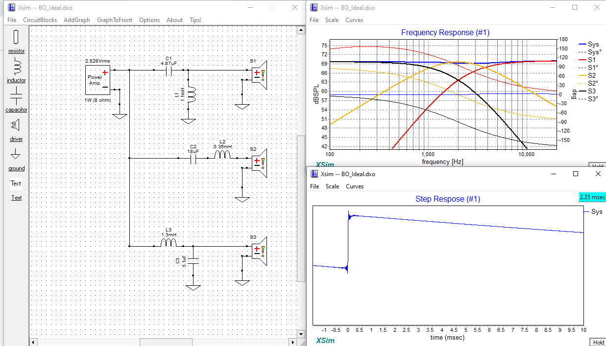

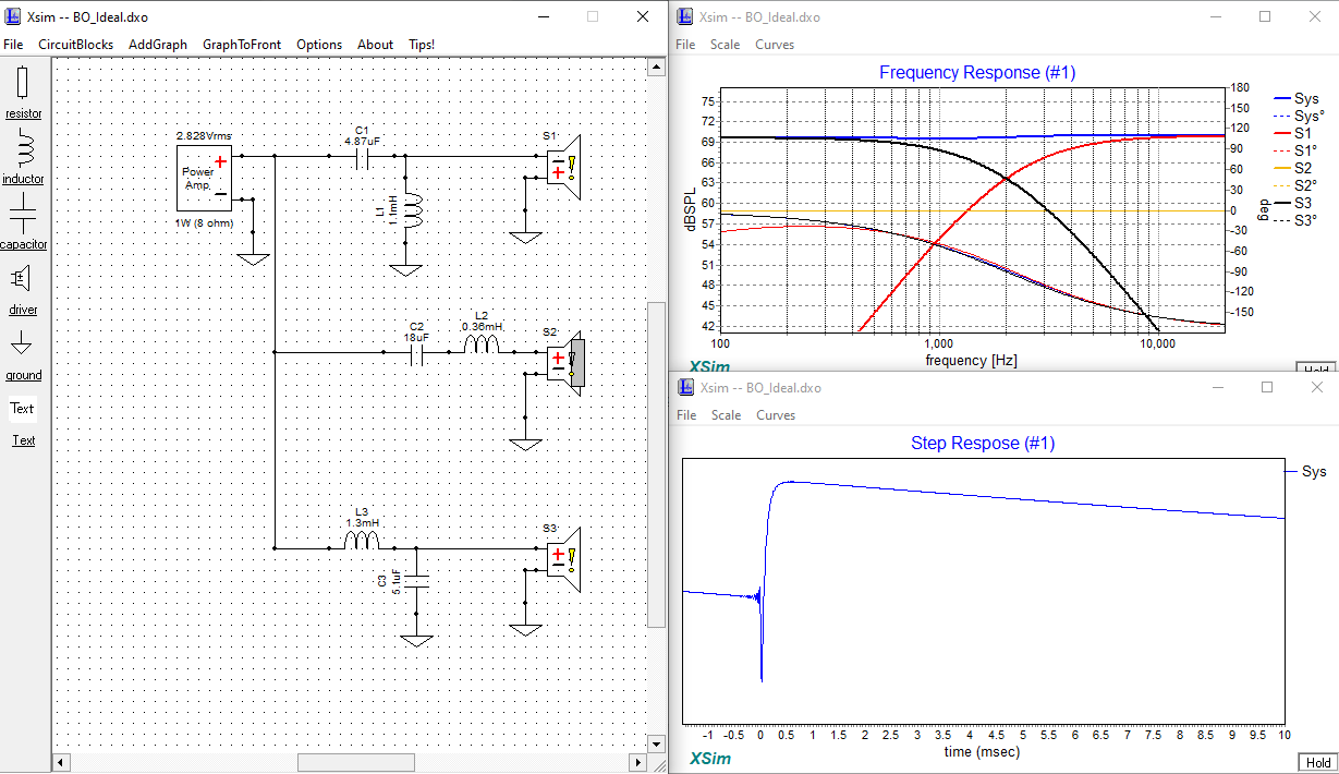

I put together a 3way xover using ideal drivers so it's a little better to see how the phase of the woofer, mid, and tweeter matched up in a "B&O" filter setup. Of course, the woofer and the tweeter are using 2nd order filters. The mid is using first order filter.
1. The first one is with all the drivers on. Overall system phase is 0 degree phase shift. The system shows proper step response.
2. The second one is with the mid off. The tweeter is inverted to show that without the mid, the system is basically a 2way system using 2nd order filter roll off. So the phase shift is -180 degree at 20KHz.

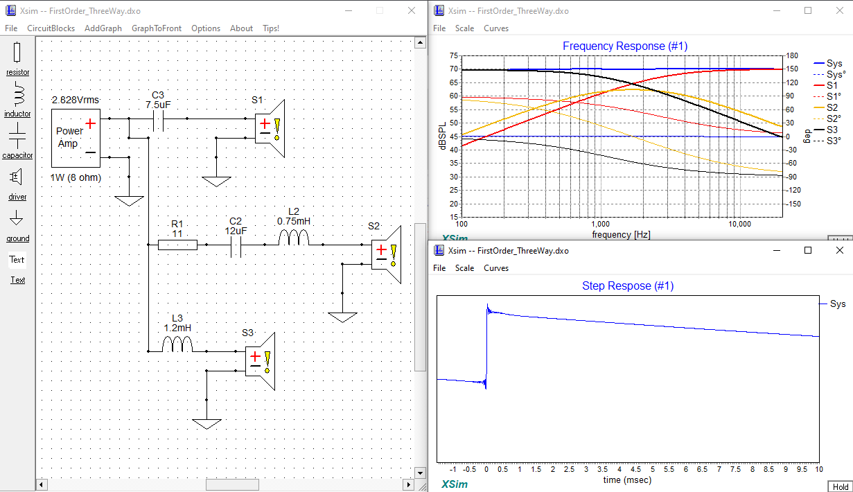

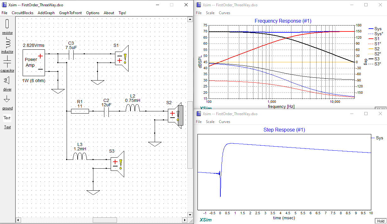

And in contrast to the "B&O" type filter, the first order filter version does show some very similarities. The only difference is the woofer and tweeter are using 1st order roll off.
1. Again with all drivers all, 0 phase shift. Proper step response.
2. With the mid off, the tweeter inverted polarity, then you have a typical 2way system with the phase shift also at -180 degree at 20KHz.
