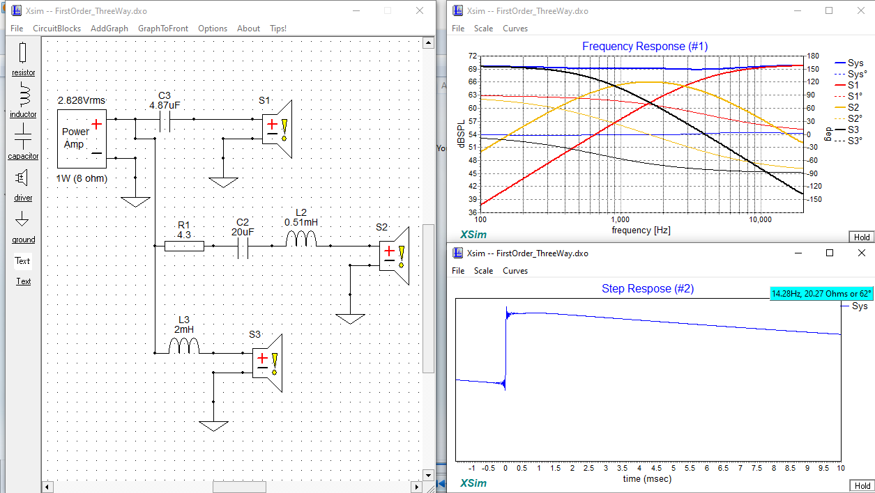

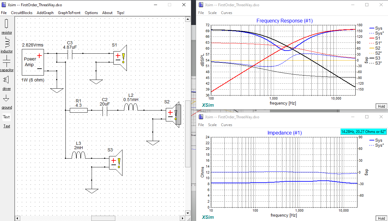

Here is a more ideal plot using ideal drivers in a three way setup using first order filter so it's easier to see without any of the real world imperfections. It's basically a similar concept to B&O approach albeit using first order. The mid driver behaves in similar way as "filler" in the B&O filter.
See the first attached plot with the mid turned off. The second plot is with the mid on. Notice the phase of the mid is running in between the tweeter and the woofer phase as similar to the B&O filter.
Here's my comments on the term "transient perfect". I think if you somehow are able to achieve a 0 phase shift within the human audio band, then by definition, you have "transient perfect" within that audio band. Of course it's a lot easier said than done.
I think the words "transient perfect" can be interpreted differently by different people and people may end up saying different things.
