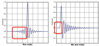

IIR "infinite" filters run the signal through a series of mathematical calculation loops where the tail of the signal could, in theory, run infinitely long because it cycles back through those loops and would never reach absolutely zero. Every part of the signal is delayed, some parts more than others based on the minimum phase characteristics of the filter. This is why IIRs have no "pre-ring."
For decades, CD player test reports have shown either "no pre-ring" response to impulses (that means they have IIR filters) or "has pre-ring" on the impulse (they have FIR filters in the brick wall 20KHz filter).
FIR "finite" filters work differently. They decompose the signal and run pieces of it through a set of parallel delay lines where literally each sample, one by one, gets multiplied by a FINITE string of numbers (this is where the term finite comes from) that is commonly 512, 1024, 2048 bits long and it is then re-assembled at the output.
So if the FIR filter is 512 bits long, that is 512 samples at X KHz sampling rate that some or all of the signal is delayed by. You'll typically design a 512 sample window so the peak of the impulse is at ~256 samples in, so for a 96KHz sampling rate, the FIR filter will delay the main impulse by about 2.7 milliseconds.
When the signal is reconstructed, the FIR's correction of phase response will result in the system having pre-ring. Pre-ring (FIR) and no pre-ring (IIR) look like this:
