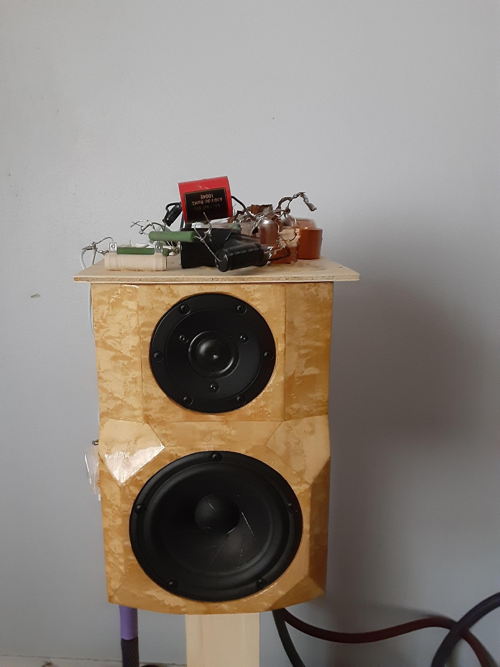

One way to do 1st order is to not use a dome tweeter but a wideband full range like ScanSpeak 10F/8424 with a very wideband woofer.
10F/8424 & RS225-8 FAST / WAW Ref Monitor
Like this:
Predicted XO response:
Here is measured frequency response and phase:
Here is measured step response:

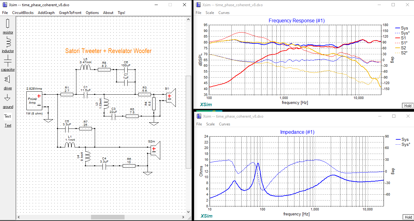

Finally got to implement the xover below. It sounds pretty good. Is there a down side? First order filter sounds not quite as "clear" as higher order, but to me more natural. Instrument separation is not quite as clear ... a bit like a forest vs. the trees, in which higher order is more tree than forest of the first order.

Yep. You can get carried away with the technology. At some point you realize that you aren't listening to the music. Today nothing pleases me more than to go out for a jog and listen a bunch of mp3 audio tracks stripped from YouTube videos played on my SanDisk Clip. But wait, those ear buds don't have a crossover. TP? LOL.
None of this stuff makes speakers better, just different. And that's even more to the point. There is a difference between "I heard a difference", and "it sounds better".
