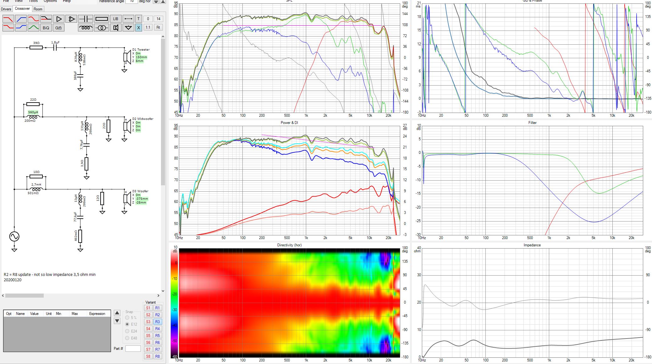

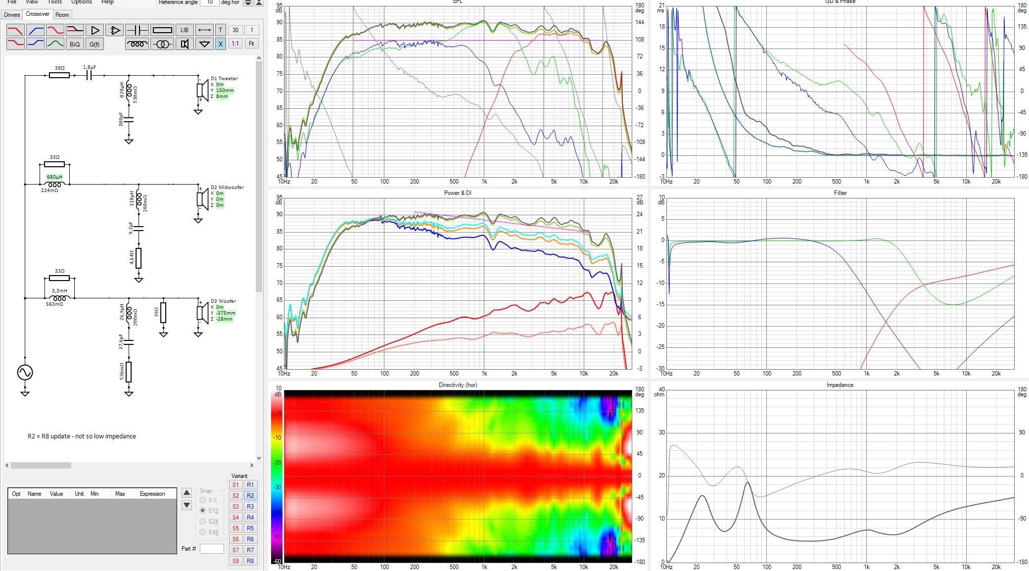

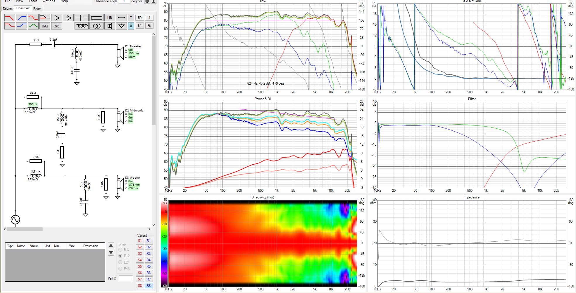

I posted earlier on VituixCAD thread, however this one seems more suitable. I wanted to achieve the goals that you were talking about in this thread and stumbled upon, a problem with low impedance. I was wondering whether this plays a great role when you use Hypex D-class amp which is capable of delivering in 2 ohms.
With the help of VituixCAD, very nice piece of software, I managed to get: rather flat frequency response, flat directivity index, good impulse response, flat impedance and phase but it payed for it with an impedance of 2,1ohm almost all across frequency spectrum - “2,5 way crossover v1.jpg”. Then I modeled two more variants “2,5 way crossover v2.jpg” with minimum impedance of 5ohm at 260Hz and “2,5 way crossover v3.jpg” with min imp of 3,2 at 250Hz. Somehow, I couldn’t get time coincidence as good as in “2,5 way crossover v1.jpg”. Maybe I need to work with it a little more. I was wondering what compromise is wise in this case between those three variants. I am going to test it in real life but before I do, I really would like to hear what are your thoughts. I would really appreciate your input.
Bartosz
