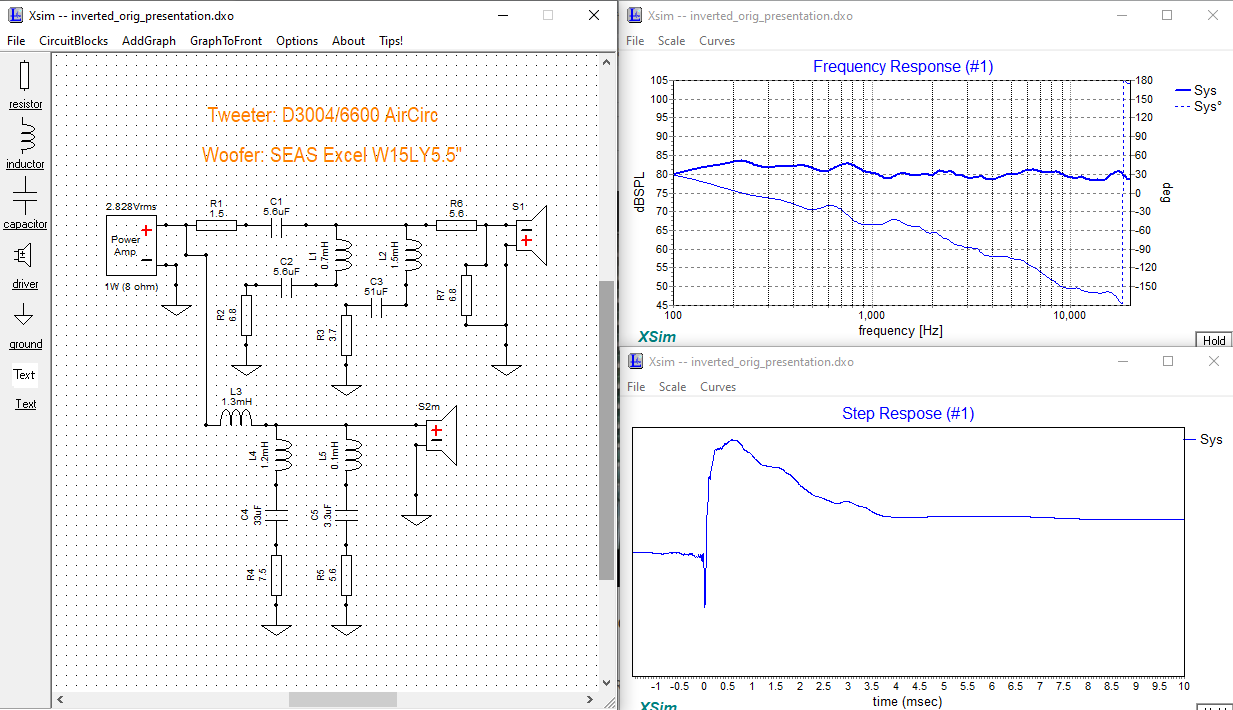

One way to do 1st order is to not use a dome tweeter but a wideband full range like ScanSpeak 10F/8424 with a very wideband woofer.
10F/8424 & RS225-8 FAST / WAW Ref Monitor
Like this:
Predicted XO response:
Here is measured frequency response and phase:
Here is measured step response:

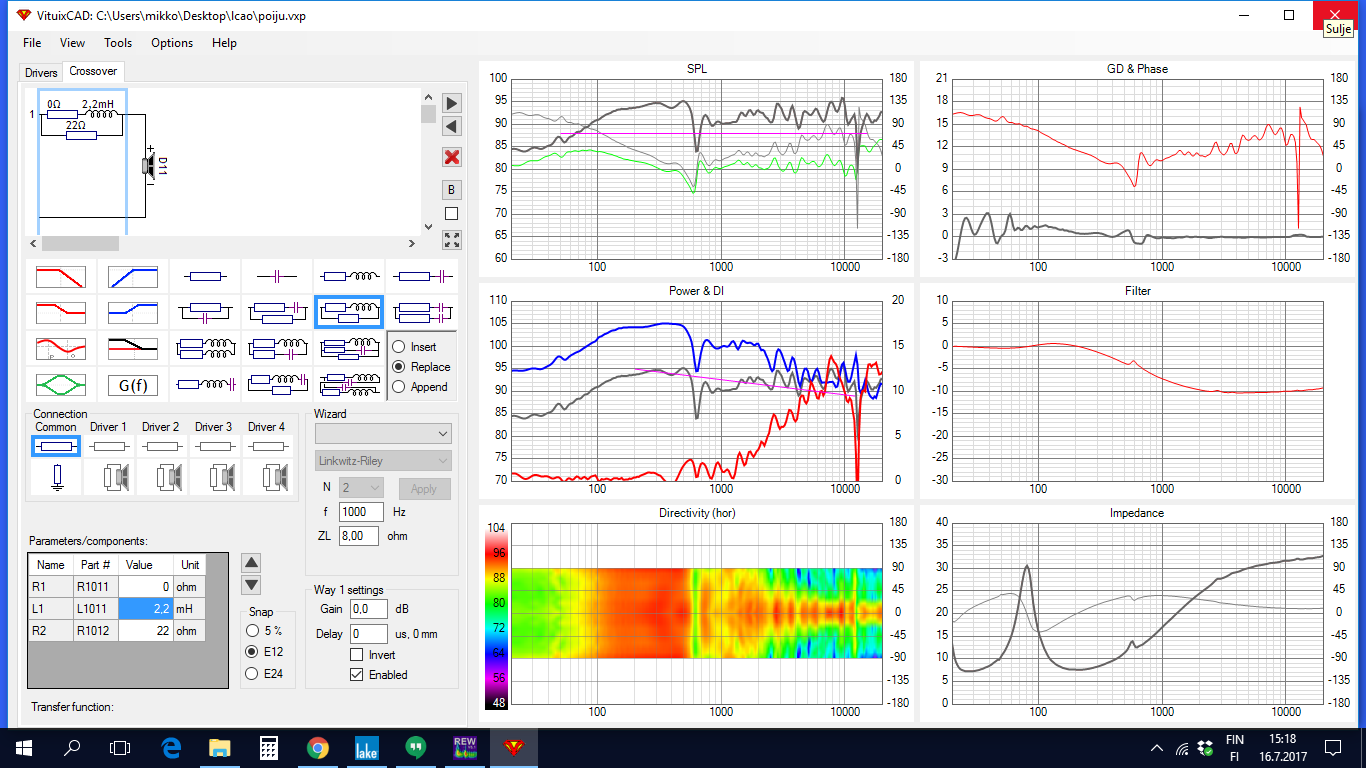

well if you want to go that exact ima gona tel you a stoory apaut disainin that kurrent krossover.
i didn´t have impedance measuring device at that time. i took measure raw driver on the box and measure with parts which came with driver. took some drivers impedance curves from internet which came closest to curve with those parts i had.
yes im aware of most exact database to make best simulations.
enclosure is plastic buoy with allsorts of problems, even driver has its own problems.
no matter how exact i do things does not change that thing 6.5" fr beams after 2k.
still happy with these, when wanking with my main 4-way its good to reset your head with this speaker.
