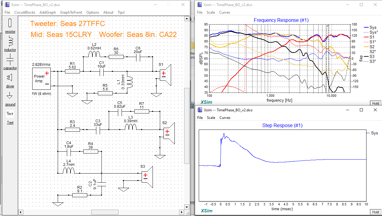

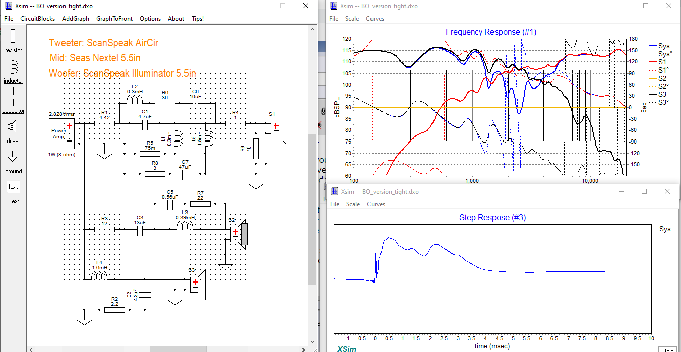

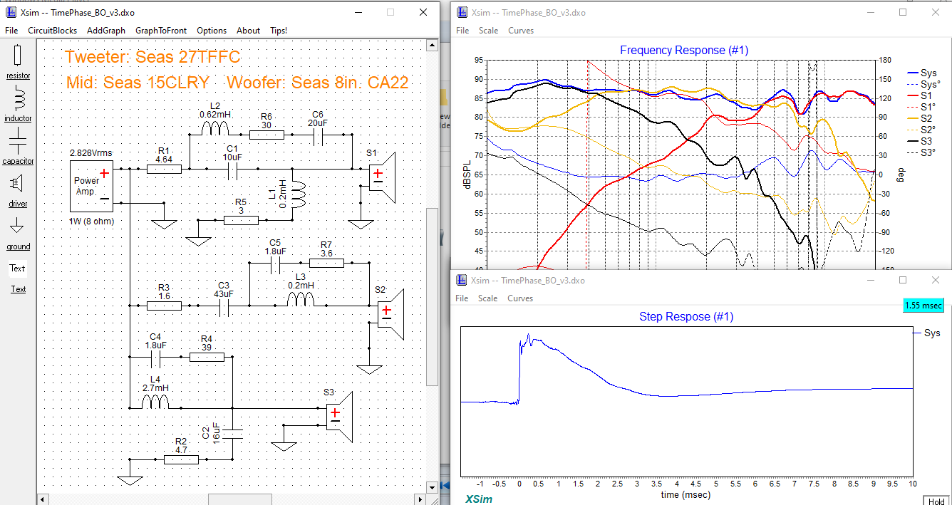

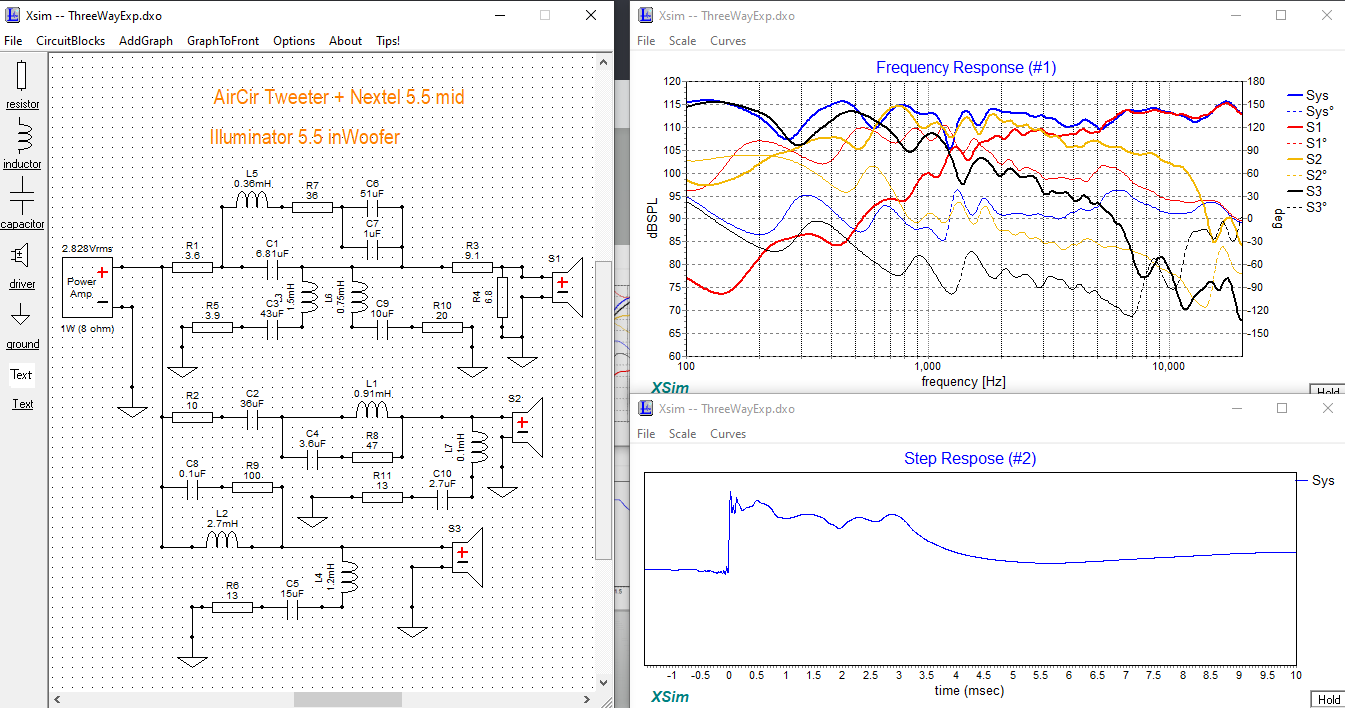

This post is to compare a three way design using First-Order Coherent and B&O “Transient Perfect”. Before going further, let's get the terminology out of the way, The word “Coherent” and “Transient Perfect” may conjure up endless discussions as to the meaning but in term of freq. and phase, they all mean the following: the overall response of the speaker as a whole should have absolutely 0 phase shift in the audio band, such as 50Hz to 20KHz. That's it. Nothing more complicated than this.
We should not “mystify” these terminologies to make things more complicated. If the response has zero phase shift, then by definition, it is coherent or if you prefer “transient perfect”. This means that you could call your speaker “transient perfect” as long as it has zero phase shift with however way you arrived at your solution – be it LR4, LR2, first order, or DSP, or whatever way you see fit.
Of course, no real world speaker will have absolutely zero phase shift. It will have some amount of phase shift, but just make sure the phase shift should be as minimal as possible. Since it's an analog world, no exception, some speakers will have more or less at some frequency bands than the others, so one shouldn't get all too worked up over who's better. This post is not meant to say anything the better. Sure 8in will have more bass than 6in but that's something all different.
I won't get into the theoretical aspect of B&O (there are quite a few links that can do a better job), but will touch on things in a more intuitive way. Here's what it comes down to. The B&O approach basically runs the woofer and tweeter in a LR2 roll off (12db/octave roughly) which has the advantage of not making too much demand on the drivers. On the other hand, the pure first order approach runs all three drivers – woofer, tweeter, and mid – in first order (6db/octave roughly). Before going further, some might ask what's the big deal? There are a lot of three way designs so what's so special about the B&O or first-order coherence approaches? Well the difference is the B&O and coherent approaches promise zero (0) or very close to zero in the audio frequency band and therefore will be able to perform a proper “step response” among other things (lower group delay...). A run-of-the-mill 3way approach won't have 0 phase shift because you may have drivers with different polarity.
OK, so we got the definition part out of the way. So what's the real difference between the B&O and first order coherence? The B&O also promises a zero phase shift (just like first order coherent), but using 12db/octave roll off not too unlike most speakers out there, like having a cake and eat it too. But I was playing with some simulations doing something similar to the B&O way, but I found something that I didn't quite like – like a devil's promise but with a hidden agenda (hahaha just joking!).
Here's the intuition part, the B&O approach runs the woofer and tweeter at 12db/octave, with a hole in the middle of the frequency band (somewhere between 500Hz and 3KHz), and the mid driver acts as a “filler” to fill in the whole no pun intended. The steeper the roll-off of the woofer and tweeter, the “larger” the hole, and the mid “filler” the more has to work to fill in the hole. And here's the devil's little secret that requires you to sell your soul (hahaha joke!). But seriously, that's what it comes down to. There's really no free lunch. In the B&O approach, the woofer and tweeter may not work very hard at 12db/octave, but the mid still has to work pretty hard at 6db/octave roll-off, which means that the mid is still in first-order mode, the whole time.
But that may not be all. Here's the hidden part of the devil's promise that may not be that obvious to the innocent xover-er (joking!). On the upper mid where the mid and the tweeter have to integrate at the cross-over point, the tweeter has been running at 12db/octave or there about, but the mid has always been running at 6db/octave and has to match the tweeter 12db roll off, so in the real world, the sound may not be that well integrated on a listening test due to the unsymmetric of the two roll-offs. Of course it will be implementation dependent and I guess if you're pretty good at xover, or making your cabinet, you may be able to out-smart the devil (joking!), by making them better integrated either electrically or acoustically. Based on my own listening experience, at the upper frequencies where the wavelengths are shorter, these types of mismatch can be made worse by the vertical listening level, and if not paid attention too, the treble and the upper mid may sound like they come from different source. Base on my simulation, I did have a hard time matching the phase of the tweeter and mid at the cross over point. Sure, I did have the frequency and phase did come out OK, but what I did was not that natural.
Having reading some of the comments regarding the B&O, there were comments along the line of using a small mid so that it is able to play at higher frequencies, or having to resorting to the usage of full range driver. Find full range drive may not be easy, at least the quality one. Also having a small mid range may compromise the lower frequencies at least some I have heard sounded somewhat “thin” especially with male voices! I guess in this case the devil's promise is a beautiful woman but with small mids (joking!). You can go around this small mid limitation by having a closer overlap of the woofer and the tweeter so the mid does not have to work hard at the lower frequencies, but then the woofer has to work harder at the upper frequencies therefore an 8in woofer may have a problem. Anyway, there are always trade-off, and as I said, there's no free lunch and the devil at the end will just fool you. Or to make a compromise, you could have a 7in. woofer which will work up to 1KHz to integrate to a 3in mid and so to relieve the mid lower frequencies.
Of course first-order filters are not any easier either and may even be harder than the B&O. It places a lot of demands on the drivers, and only a few drivers perfect enough that can meet the strict requirement of first-order 6db/octave roll-of. And realistically the other limitation is a first-order coherence can have at most 3 drivers – tweeter, mid, woofer. Anymore and the problem may be impossible. You can add a subwoofer at the end but that's something different and can be done afterward. In this case, the promise of first-order 0 phase shift is there, but at least you know upfront all the hard works, and no hidden surprises. During the simulation, I actually found going all first-order having a more “natural” integration between all the drivers and some way easier since they're all running at 6db/octave roll-off and all symmetric.
In my next post or two, I'll attached two 3way xovers: one is all first order (at least on the electrical side), and a B&O LIKE approach. My “B&O” version does not have the typical LR2 roll-off. Probably more like LR1.68 or there about but enough to illustrate the point. The example also illustrate how “harder” the mid in the B&O vs. a first order approach.
I then will compare two different xover approaches to having “B&O LIKE” way. One have a steeper roll-off on the woofer and tweeter, and the point is to illustrate how “harder” the mid has to be driven to make up for the steep roll off of the woofer/tweeter, everything else being equal.

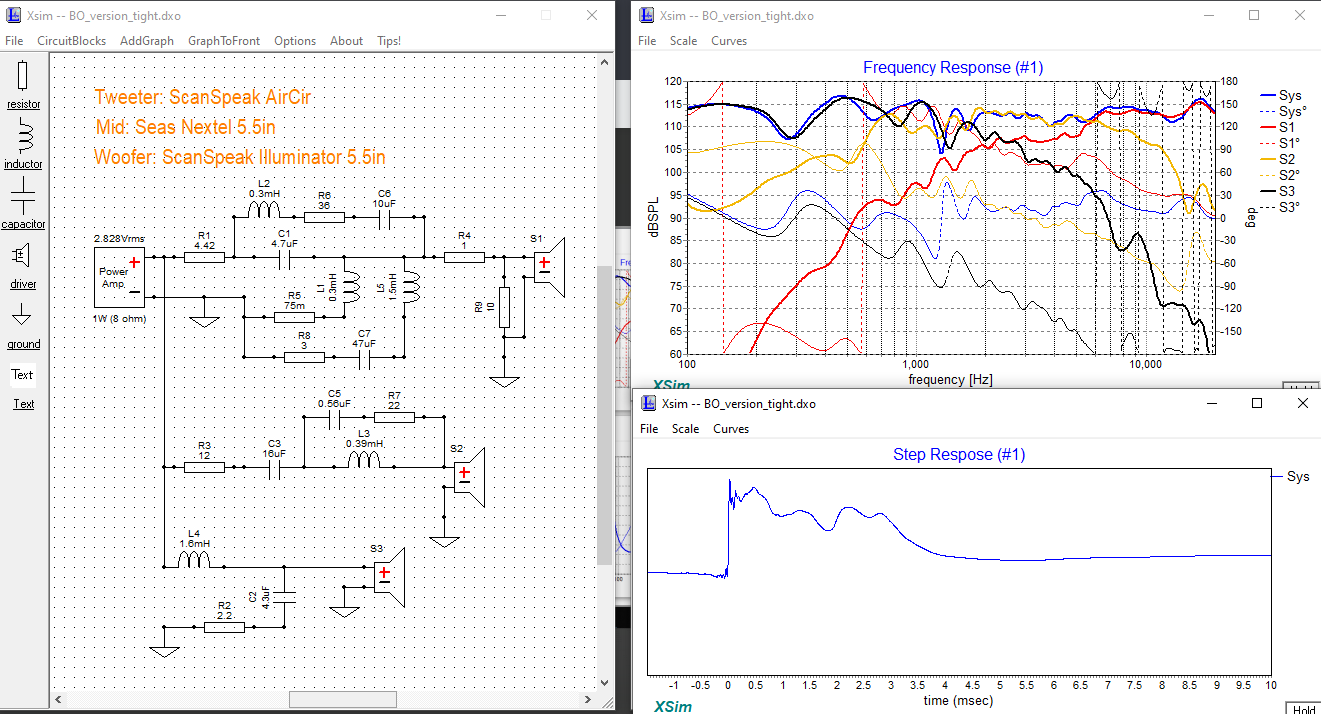

Making this simply a first order filter. Why make anything up. The industry has spent over 100 years using the same terms.let's get the terminology out of the way, The word “Coherent” and “Transient Perfect” may conjure up endless discussions as to the meaning but in term of freq. and phase, they all mean the following: the overall response of the speaker as a whole should have absolutely 0 phase shift in the audio band,

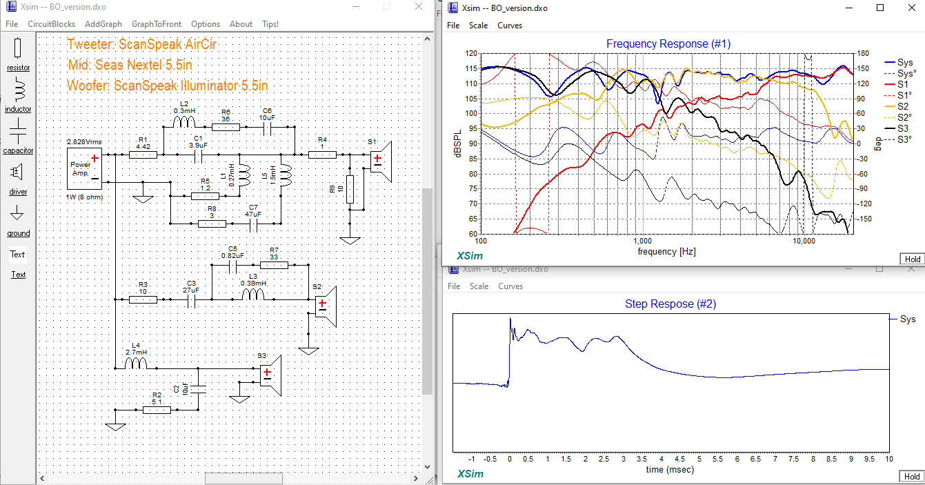

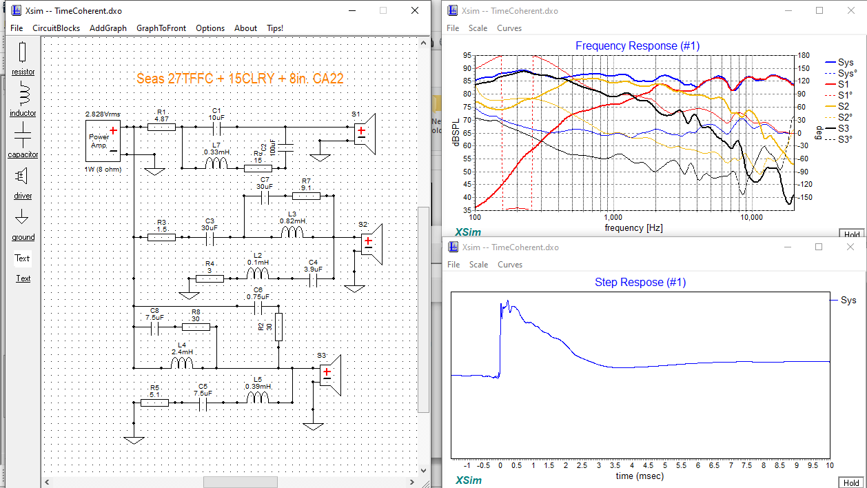

I here have two versions of a three way speakers: one using first-order and one using a "B&O" like approach although it's not quite BO LR2 but probably more like LR1.68 lols.
A few words regarding to BO and all-first-order filters. There are quite a lot of similarities between them which is not a surprise since they are all derived from basic filter theory. It's not like BO comes from another dimension. If you think of them just as basic math, Laplace transform, freq. and time domain manipulation … and so on then you probably won't treat them as a mystery.
Notice the tweeter and woofer of the first order work harder vs. the BO but the mid in the BO has to work harder. So if you use BO approach, you probably need a small mid to run slightly at higher frequency.
Another disadvantage of BO is it can only be used in a three way albeit with a rather small mid, whereas all-first-order can be 2way as well. One more advantage of all-first-order is that the mid can be used with more options … such as larger mid driver size.
Another observation is although the tweeter in the first order version works harder, it has a "better" impulse response with less secondary "ringing". Being second order, the tweeter in the BO has a slightly more under-shoot.

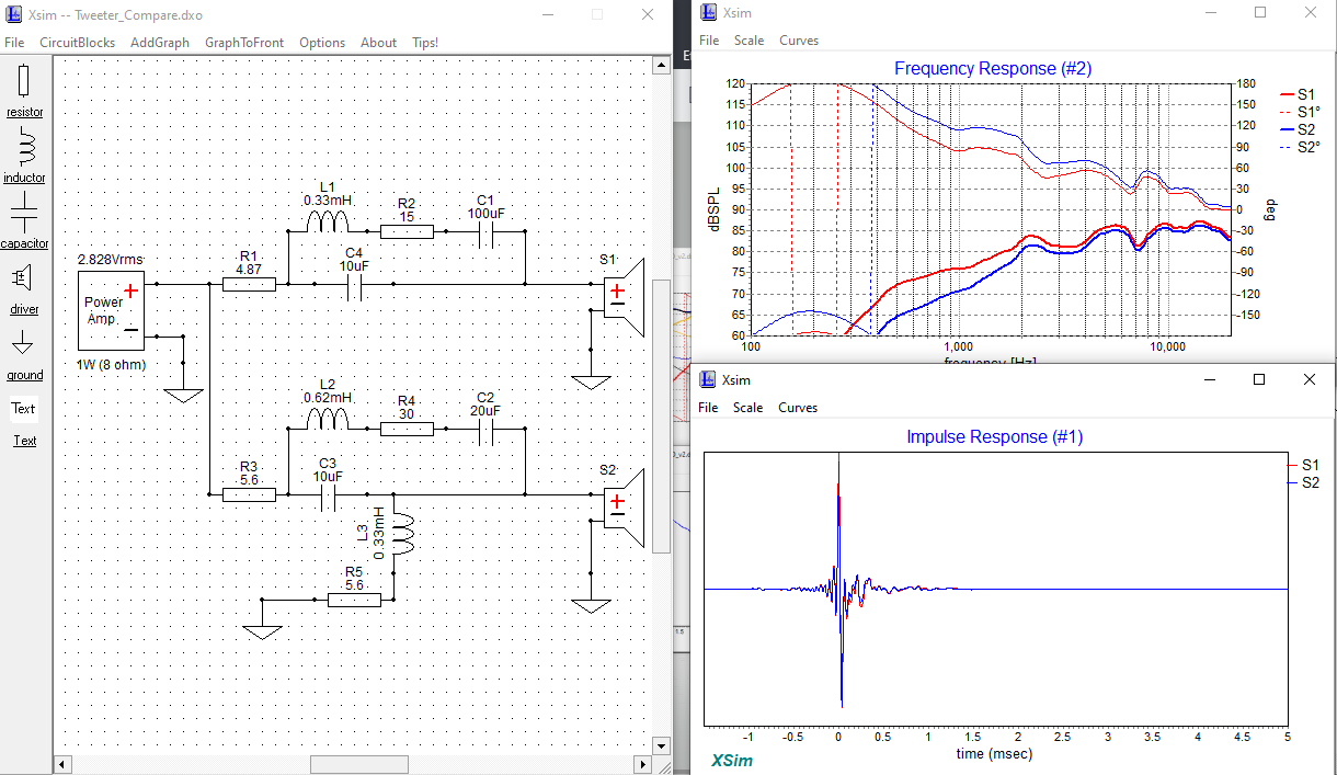

Here is two different versions of "BO"-like filters. One with more steeper roll off from the woofer and tweeter, but the mid is then required to run slightly harder at the low end and high end frequencies. Anyway, definitely a trade off.
First, no speaker can have anywhere close to zero phase across the audio band of the speaker unless it uses digital phase correction. It doesn't matter if it's passive or active analog, or digital implementation of these "analog" derived crossovers. The best that can be achieved is elimination of the crossover induced phase nonlinearity which renders the system minimum phase. As I stated earlier, the phase of the speaker will then be determined by the low and high frequency cut offs and the order of the of the roll off at those limits. For example, a sealed box system with Fc = 30Hz and some Q will have the low frequency phase response similar to a 2nd order high pass filter with the same FC and Q. The high frequency phase will similarly be that of a low pass filter with the same Fc and roll off. You can easily simulate this as a band pass filter to see what the phase looks like.
Often you see phase plots that look more linear than what I have stated. This is usually because more than just excess phase is removed from the measured phase as is often shown by a turn up of the phase at high frequency. This is purely misrepresentation of the system phase response
Second, the B&O filler driver approach does not require LR2 woofer and tweeter filters. I generalized the approach back in 2002

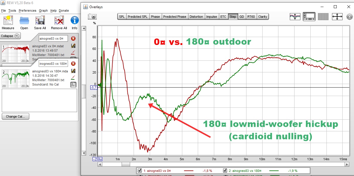

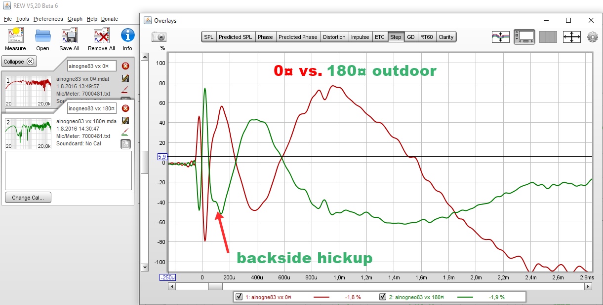

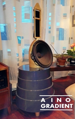

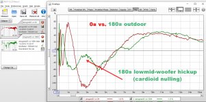

...and vertical angle change will mess it anyway. Backside raditation's coherency is not as important as the frontside which makes the "direct wavefront" towards the listener.
This is the reason why also OB could have delay correction with DSP if physical acoustic centers are not exactly time aligned to listening spot in front. Rear side produces close to same sound power for ambience regardless of less controlled timing and response to exactly 180 deg axis, and total sound power should be designed balanced anyway.
Less pressure to exactly 180 deg could be even advantageous in practice, though not so idealistic as a design target by looking single 180 deg response only.
Here are my AINOgradient's 0 and 180deg step responses overlaid (two time scales)
...measured with Umik-1 and normalized by REW without timing reference so information is something else than timing differences.

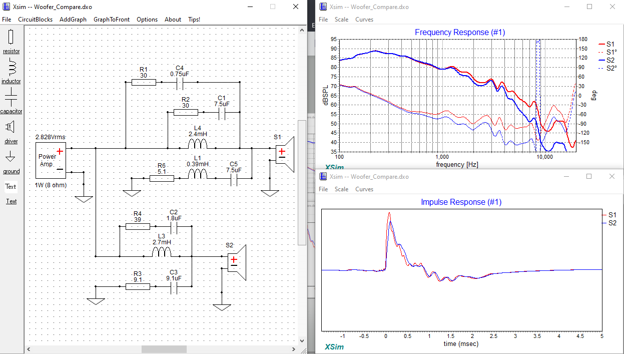

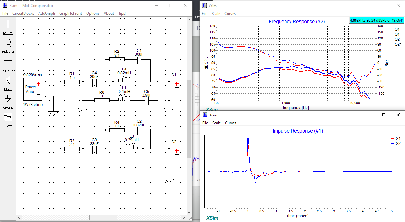

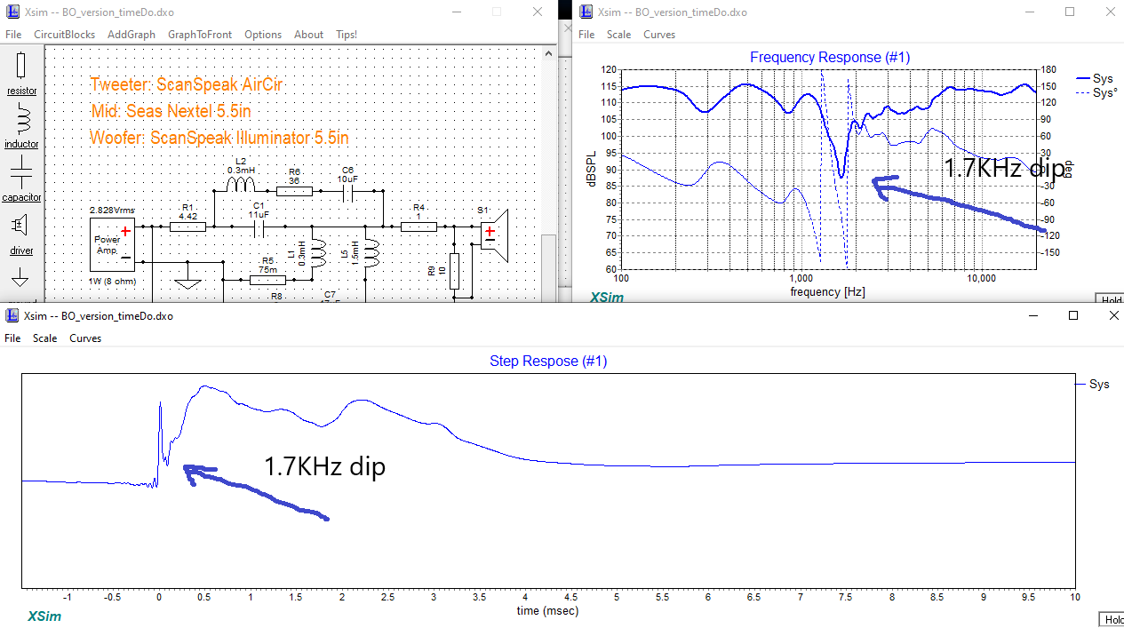

Along the line with the previous example, here is another similar situation where the woofer and tweeter having a 2nd roll off but the mid having to shoulder a wider band. You have to adjust the 2nd roll off rate depends on your own implementation and whether you want to adhere strictly to the "B&O" having the exact LR2 roll off. I guess the common observation is the mid needs to play at a higher frequency range if the woofer and tweeter having a 2nd order roll off.
I put together a couple of "monitor" cabinets. One is used for the bass, and the other is used for the mid and tweeter. Ignore all the peaks and dips since I think the measurements had a lot of room reflections. Maybe should retake the data but probably won't make much of a difference in term of the general xover design.
What's the purpose of those crossovers in the tweeter path?
I just can't figure out why complexity arises...
But that's also probably due to the complexity of doin' a good two-way, when a three-way would be sufficient to cover the expectations of a listener. Dunno what to expect from a B&O three-way but mid configured a la...B&O. AllenB often says that resistors do put phase alterations in circuits, so I'm tempted to say: bring some Rs
If individual drivers' sweeps would have been overlaid, we might have the problem that kimmosto suspects.
But those step responses come from two sweeps of a complete 4-way speaker measured at same setup. REW aligns them automatically in overlay, by first peak. So, I am confident that they tell the interplay and relative acoustic delays of "ways" (Red frontside 0¤, green backside 180¤)
In a series of vertical off-axis measurements (not shown), we can see how step response changes as relative timing gets messed (and spl response gets wiggly), because of increasing physical misalignment.

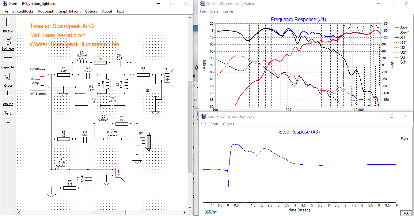

And here is the real problem with the B&O approach. As was pointed out, the filter function responses are targets for the acoustic response. Since the tweeter filter will required a 2nd order acoustic response, and conventional tweeters already have a natural 2nd order roll off, the filter must be a simple Fc, Q shifter filter, also known as a Linkwitz transformation. These types of filters are usually implemented actively alter the fc and Q of sealed box woofers, but can be applied to tweeters too. The problem should be apparent. Assuming the tweeter's Fct is above the desired crossover Fcc, the filter will roll off between Fct and Fcc, but below Fcc the filter will have flat response. Assiming Fct is an octave below Fcc that means the tweeter will receive the full range signal below Fcc attenuated by 12dB.Adding a HP filter somewhere below Fct to further attenuate the signal screws up the phase. The problem is the tweeter excursion at low frequency, if it can survive, will increase distortion significantly.
Similarly, with the filler driver there are two issues. A typical cone driver used as a filler will have a 2nd order HP roll off at it's Fc and will roll off at at least 12db/octave at hog frequency. All this has to be shaped to a 1st order BP acoustic response. The problem here is worse because with the 1st HP response fort he filler means that below the filler's Fc the response will actually have to be boosted meaning that below fc the driver excursion will increase as the frequency decrease >>>> distortion if the driver can survive.
The net result is that although these B&O like systems can produce excellent impulse response and very good square wave response of a portion of their bandwidth, they can not play as relatively high SPL without at least high levels of distortion.
I admire Andy2 for the effort he is making. Having been through it I know the effort. But having done it, other than for the exercise, it's a complete waste of time and money to pursue this approach for a quality speaker.

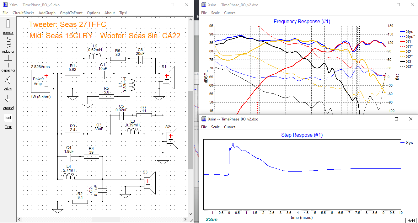

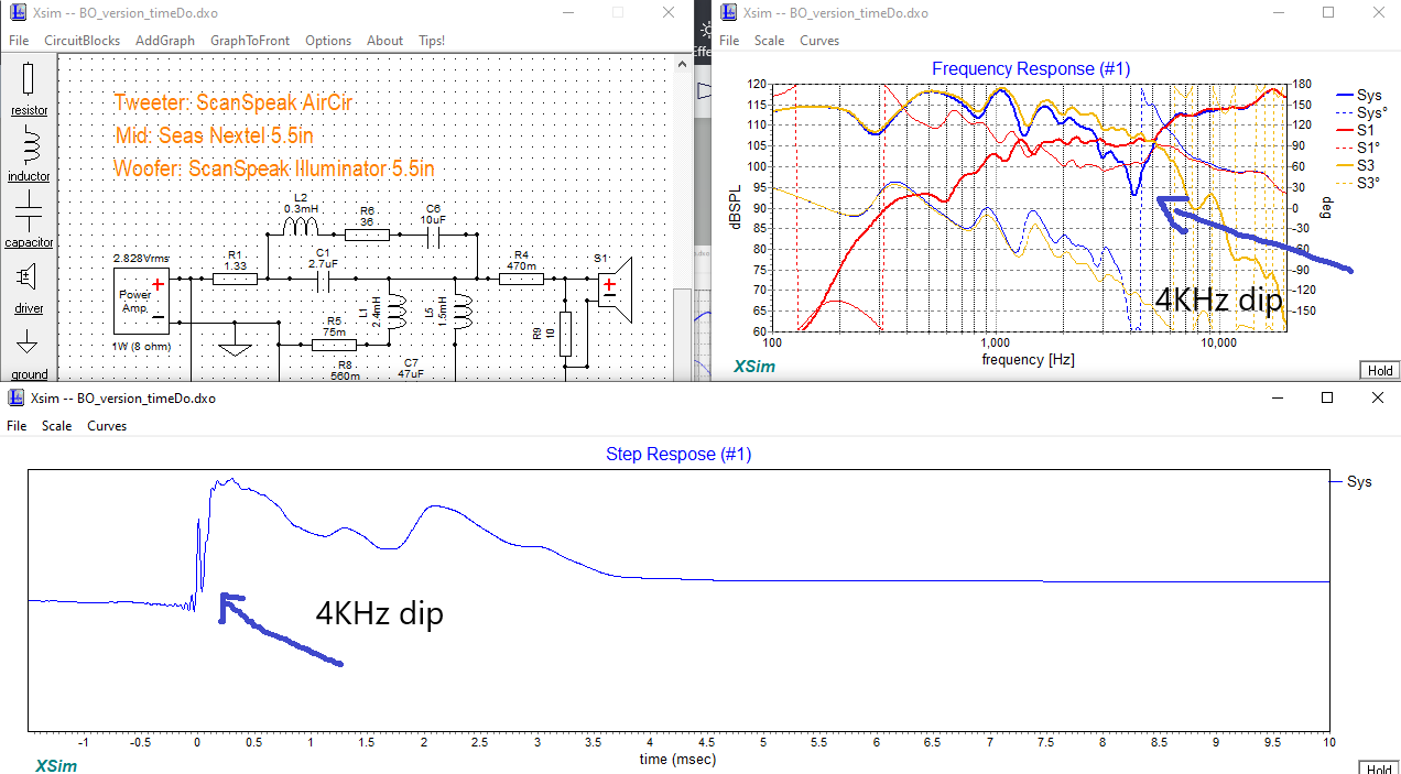

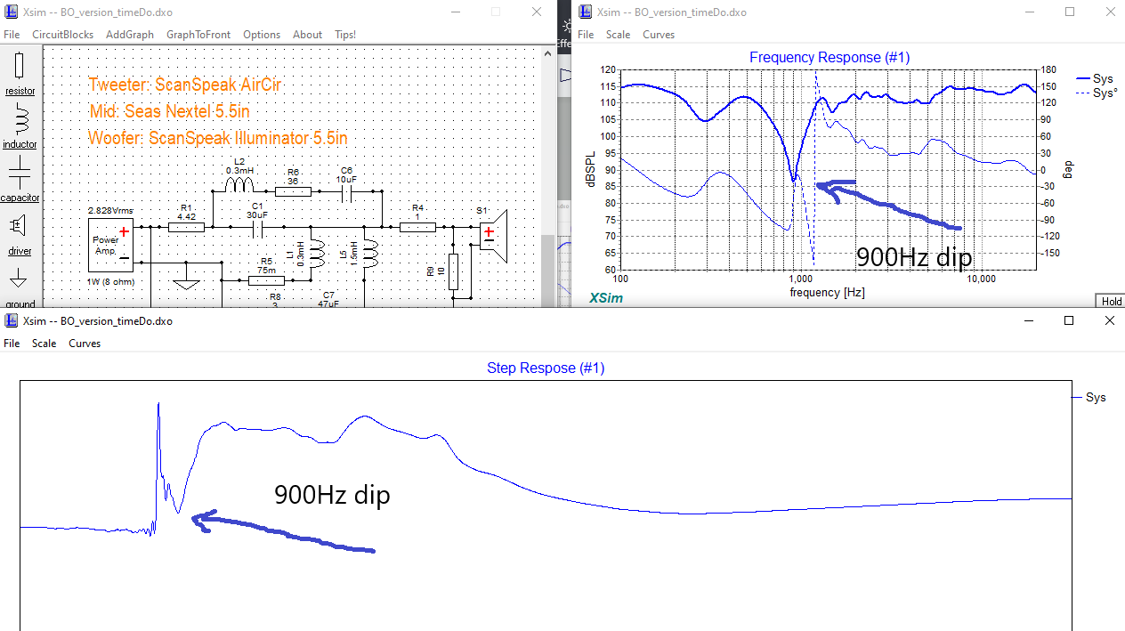

I've reworked the xover so that it might be a bit more "B&O" original intent. Basically I move the woofer and the tweeter closer together, so the "hole" in the middle is narrower, which also reduces the work load on the mid. You can see the mid upper frequency response drops off a bit more vs. my previous version. Not only that, the low frequency of the mid also rolls off a bit earlier as well.
1. First if I mute the mid, then there would be a "hole" in the middle of the frequency band. See the first attachment.
2. Then, if I now invert the tweeter, then it would look like any typical 2way using a 2nd order roll off, as if the mid driver is not there. The only problem is there is gradual phase shift toward 180 degree at the freq approaches 20KHz. Also the step response shows the typical 2way with the tweeter inverted polarity. Of course what we want is 0 phase shift across the frequency band.
3. Now if I turn the mid back on, then making all the drivers positive polarity, with the exact xover, now you have "0 phase shift" at the same time having the same proper frequency response as the 2way version in #2. See the third attachment. Of course, because of room reflection, diffraction and so on ... so the phase shift will bounce around 0 degree. The worse case is about +30 degree at 6.3KHz which happens to be at the dip of the diffraction due partly to the step-baffle. Therefore in order to have very minimal phase shift, the baffle needs to be optimized to minimize diffraction and also better align the driver acoustic centers. (There is a bit of a spike in phase at around 1.3KHz probably due to the dip in room reflection and for whatever reason the dip just happens at the same place for the mid and the woofer.) Also further optimization of the xover to further improve the phase shift.

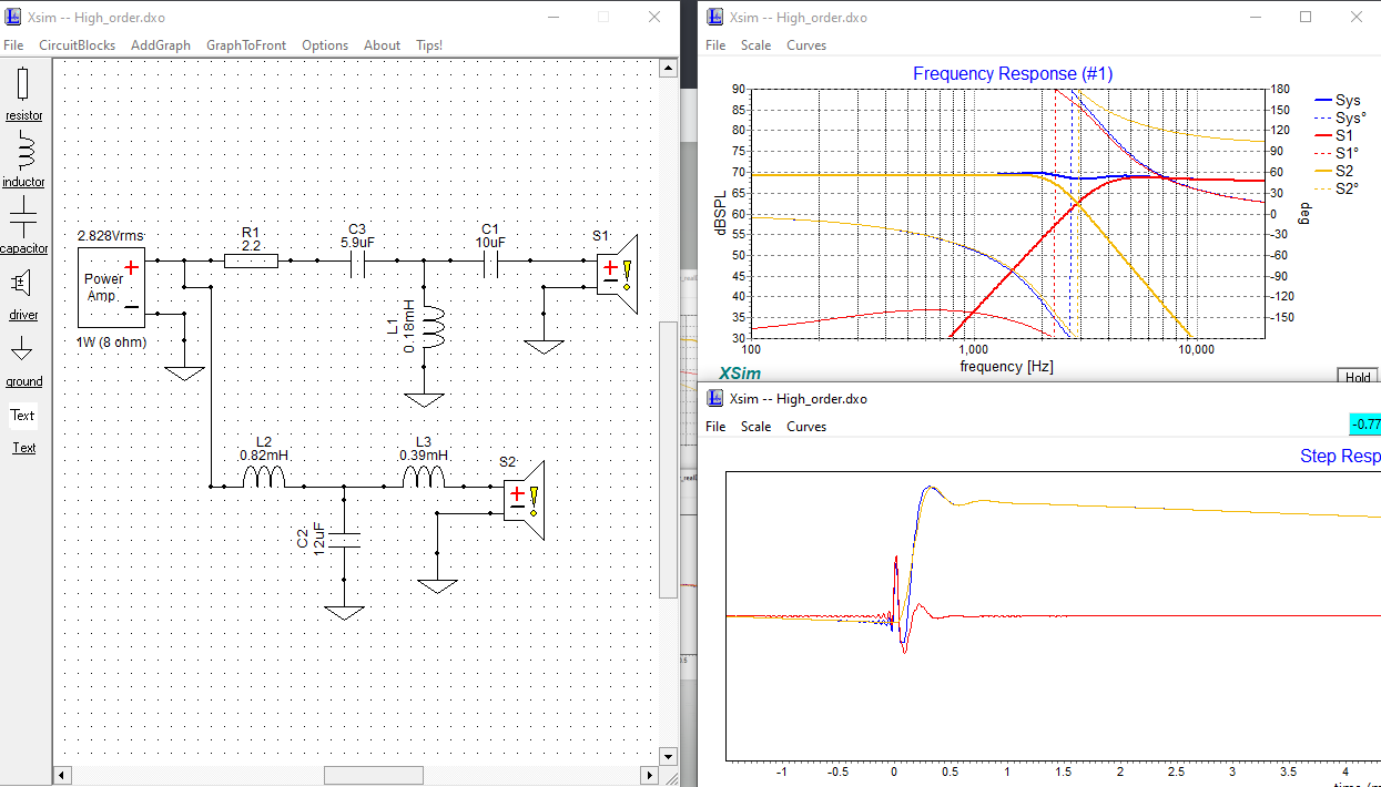

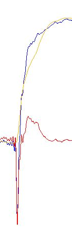

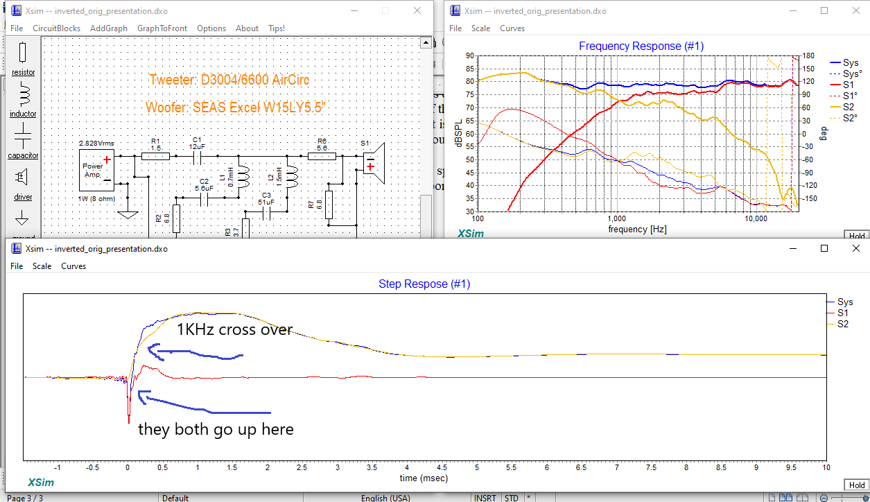

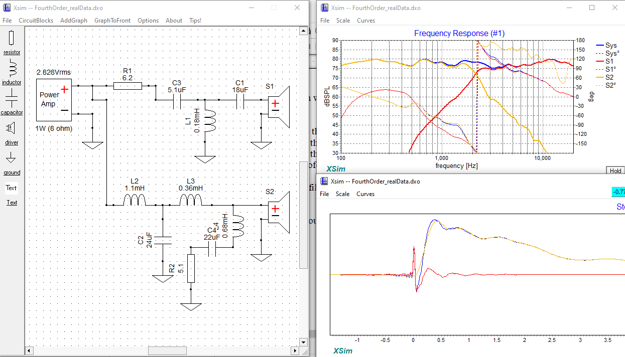

Let's look at the step response of a simple 2way, but this time the tweeter is reverse polarity. As seen the frequency response seems fine with no dip. On the other hand, the step response shows an initial dip, and as we talk about in the previous post, the initial dip is in the high frequency portion. See the blue trace as the overall system step response.
For this example, I intentionally made the cross over frequency pretty low at 1KHz so it is easy to make an demonstration. The initial reaction of the “coherent” camp would be like, “see, the treble and the low frequencies are all opposite therefore it is inferior and I would be surprised it will make music at all … blah blah blah ...”. Well not so fast though.
In the attachment #1, you see the overall speaker as the blue trace. But looking closely, you should also see the step response of each component: the blue trace, the yellow trace, and the red trace.
Blue – system
Yellow – woofer
Red – tweeter.
I will zoom in the step response so you will clearly see each component. First notice from the frequency plot, the cross over point is at 1KHz. Now if you look closely on the step response, you see that only initially that the tweeter goes opposite of the woofer (high freq), but then both the woofer and tweeter go up together at 1KHz and before that. See the “cross over” on the step response at 1KHz. Everywhere on the right of the cross over point at 1KHz on the step response (or on the left of the frequency plot) is where the tweeter and the woofer all go up together. Or you could say below the cross over point, they all go up together and only after the cross over point, they start to slowly diverge. So to say both tweeter and woofer go opposite is not entirely true, you have to take into consideration the frequency band where the overlap occurs.

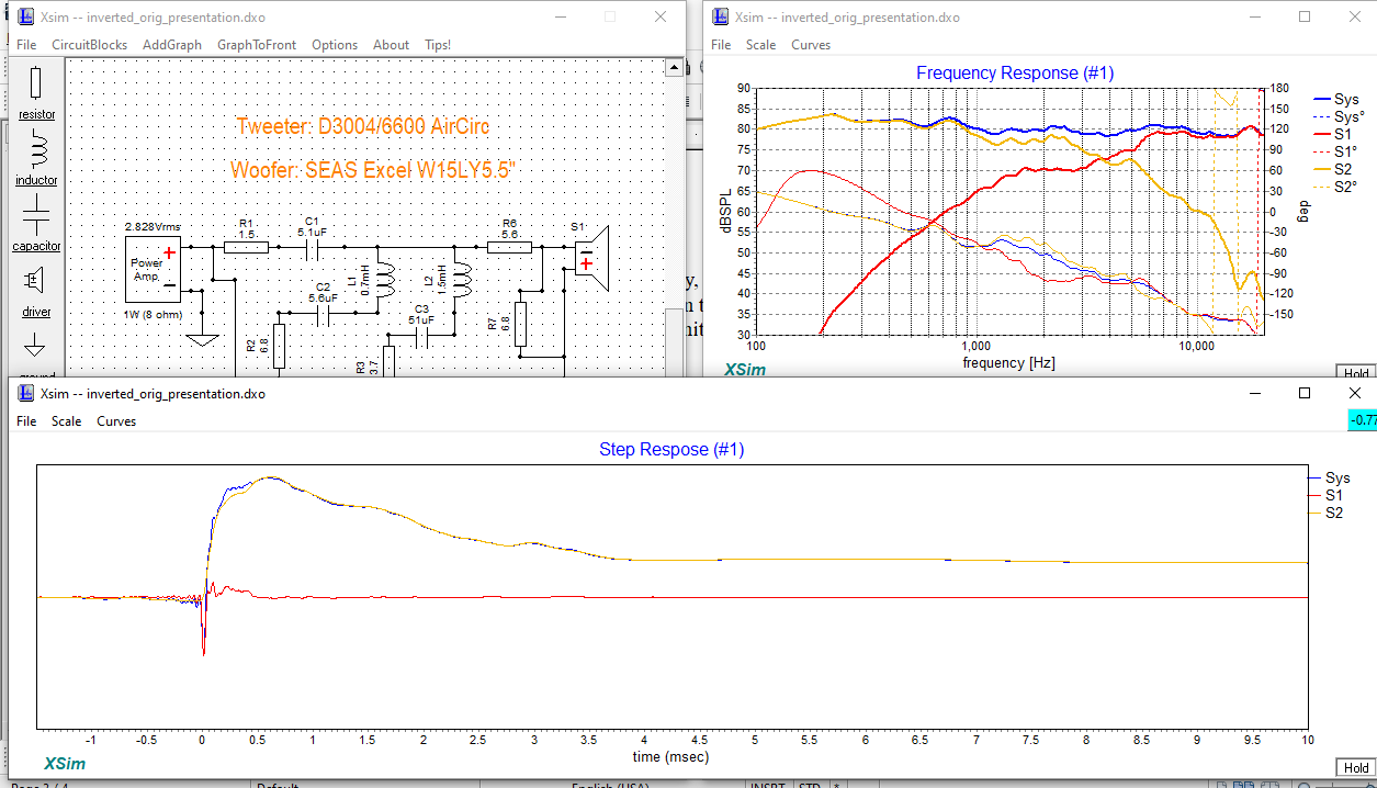

For this example, I used 1KHz cross over point as an example. But in most speaker, the cross over point is probably around 3KHz so you have a much large portion of the frequency response where much of the music presides, or where it matters most, that the tweeter and woofer all go up together.
On the third attachment, here I go back to 3KHz cross over. 3KHz is even better, and up to 3KHz, both go up together as opposed to 1KHz. So does it mean the higher the cross over point, the better because you get more frequencies where both the tweeter and woofer go up together?

Now look at an example using high order filter. For this, I use a third order electrical filter. I will also use ideal driver because it's a bit cleaner and easier to see.
As expected, the phase shift should be steeper vs a first order filter. Interestingly, for this example, both drivers are in positive polarity, so you would expect they are able to perform a proper step response right?
Actually because the nature of high order, even when the drivers in the same polarity, they cannot perform a step response.
See the first attachment. And you can see here that with the same 2way, even with positive polarity, the step response looks quite a bit messy. You see that the initial spike is from the tweeter which is a full 360 degree ahead of the low frequencies. And then there is a dip in the step response from the tweeter, then only at this time, both the tweeter and woofer both go up together at the cross over at 3KHz.
So you can see as you go higher and higher in filter order, things look a bit complicated because of the higher phase shift. Sure at below the cross over point, the tweeter and woofer go up together, but after that the phase can look a bit dicey.
I also attached an example using real data but it's more or less the same.
Again, we go back the question from my previous post, where does it matter? How high, or how low does phase shift matter? Or does it matter at all?
