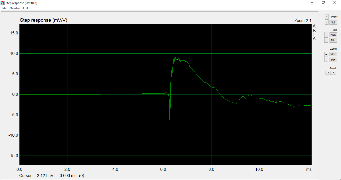

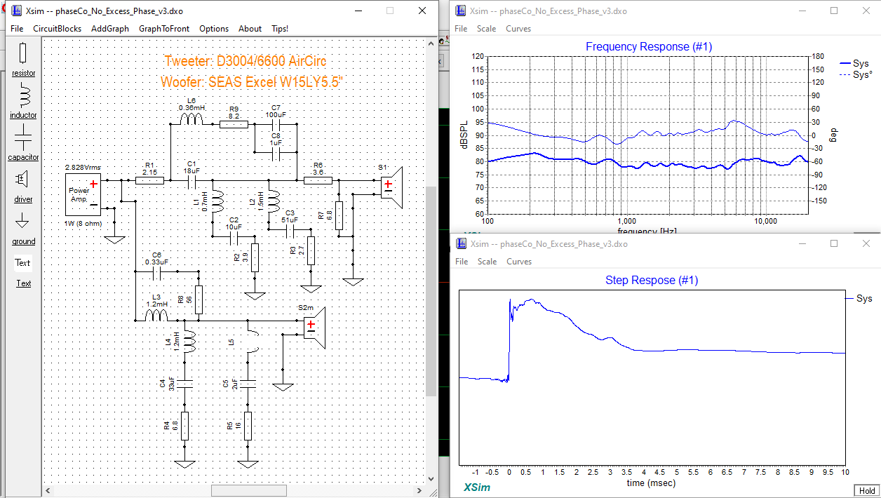

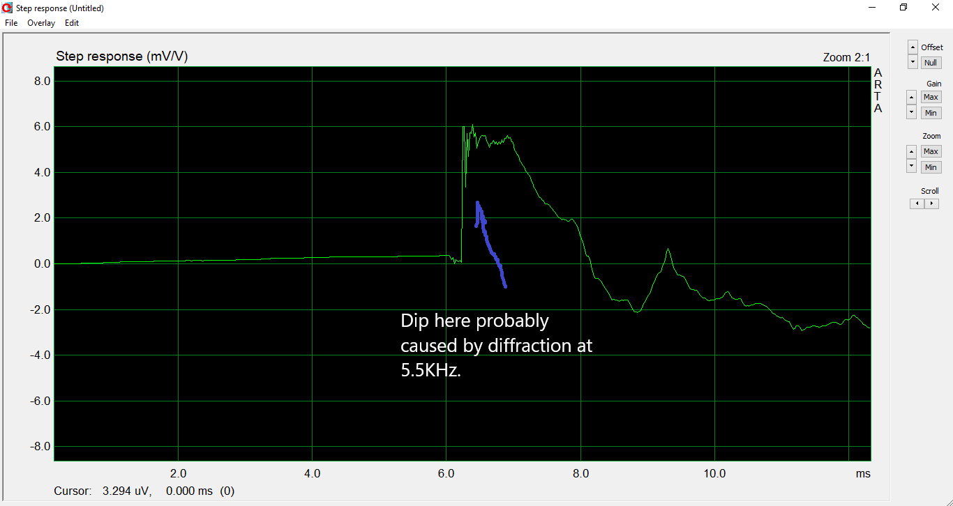

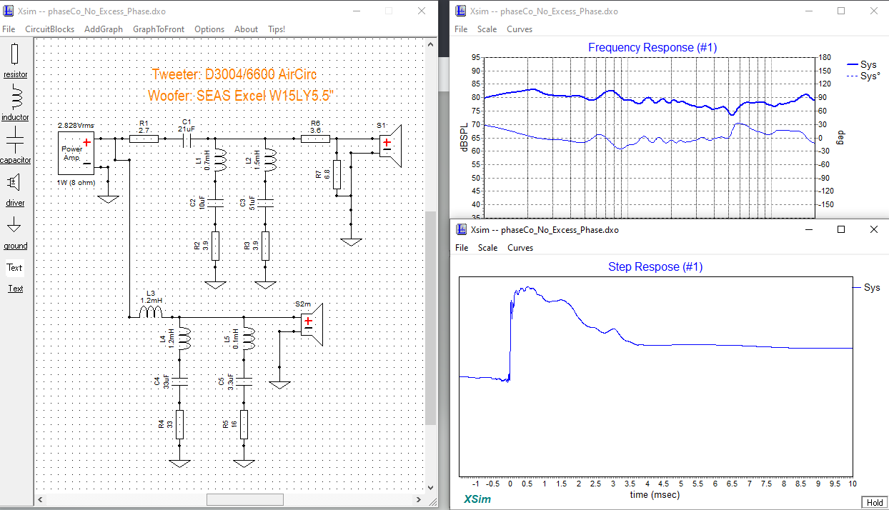

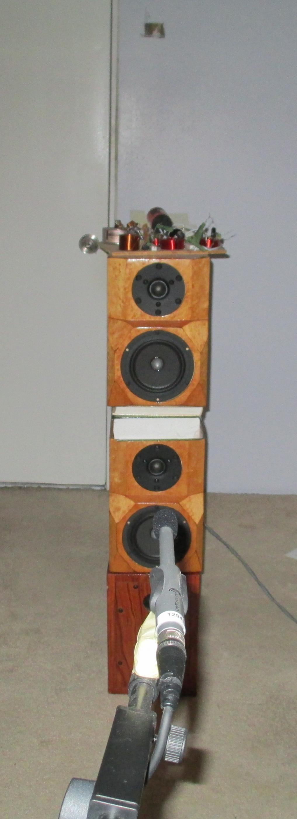

I did a quick measurement of one version of the time-phase coherent. Attached are the simulated results and measurements. There is a bit of a dip on the step response at the initial spike up. Probably due to the diffraction at around 5.5KHz. It's also there on the simulated step response. Notice the min. phase is at about +30 degrees worse case at around 5.5KHz. Will probably need to optimize the baffle to minimize the diffraction. Maybe it's better to not use step baffle, but have the baffle tilted to align the driver acoustic centers.

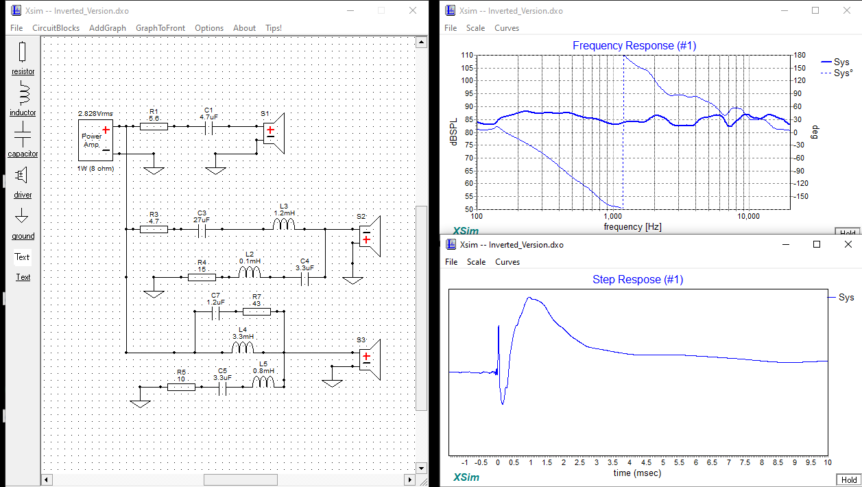

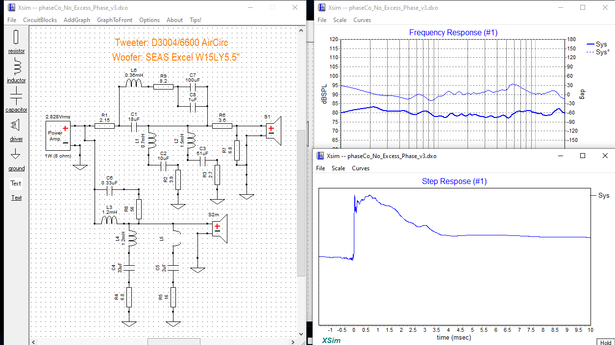

Here is a 2-way setup but the tweeter is inverted polarity while the woofer polarity is positive. The step response shows at first the tweeter goes negative with respect to the woofer. Also on the freq/phase plot, you can see the phase shift at 20KHz is -180 degree with respect to, say at 200Hz, because the tweeter is inverted polarity. On a time-phase coherent speaker, the phase shift should be very close to zero.

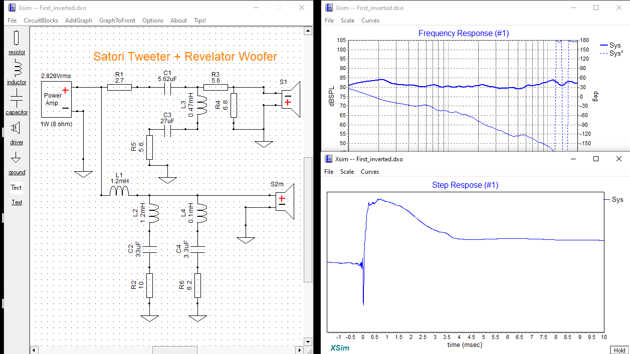

Here is the reason the proponents of time-phase coherent/time-coincident think there is an advantage over conventional speakers with drivers having different polarity.
Below is a simulation of a three-way, with the tweeter and woofer in positive polarity, but the mid is inverted polarity. You can see from the phase plot, at 20KHz, the tweeter is a full 360 degree ahead ( 360 degree phase leads) of the low frequency. The step response shows that the initial high frequencies arrive at your ears ahead of the low frequencies in the time domain.
For example, when the drum is hit, the high frequencies arrives at your ears first, then the low frequencies arrive later. In the real world, they should arrive at your ears at the same time.
The question is can our hearing notice the phase shift at 20KHz? For example, at 20KHz, the 360 degree phase shift equates to about .05milli second. Could you hear that the drum high frequencies arrive at about .05msec ahead of the drum low frequencies? Some people think we could. People have told me that they can hear the difference in time-phase coherent speakers especially in the treble region. I suppose this question will be debated and different people will have their own opinions.

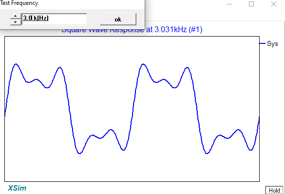

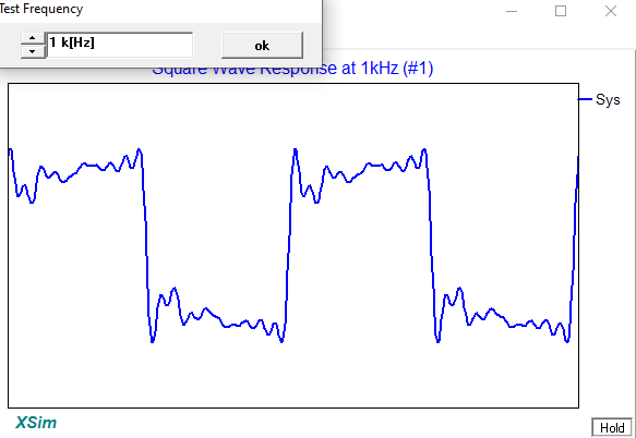

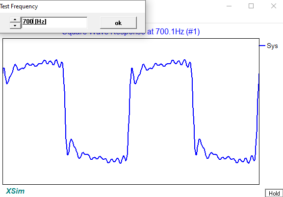

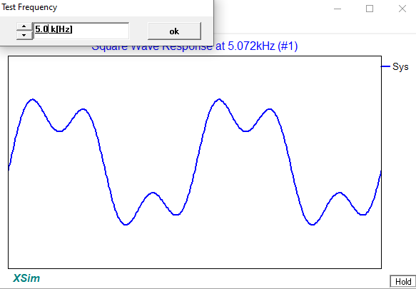

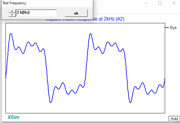

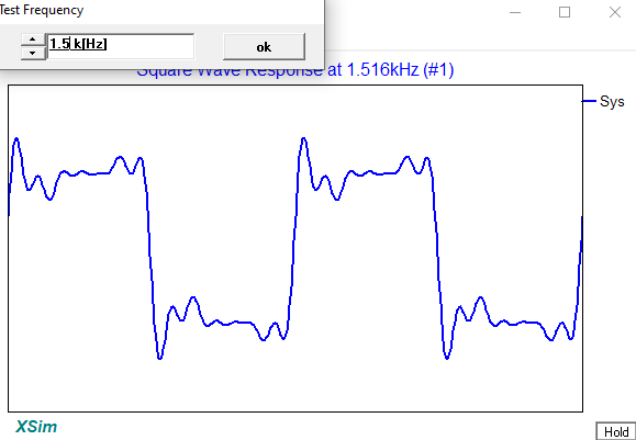

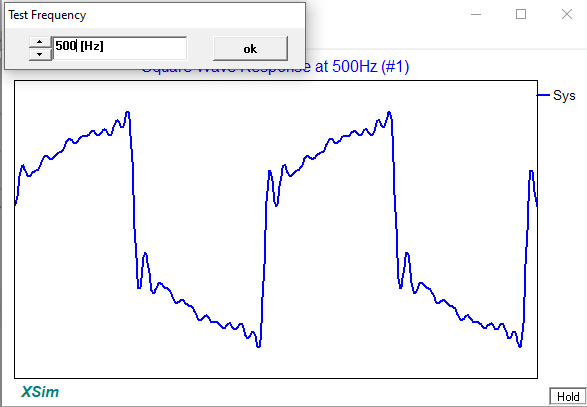

Here are a series of square waveform being simulated from the xover.

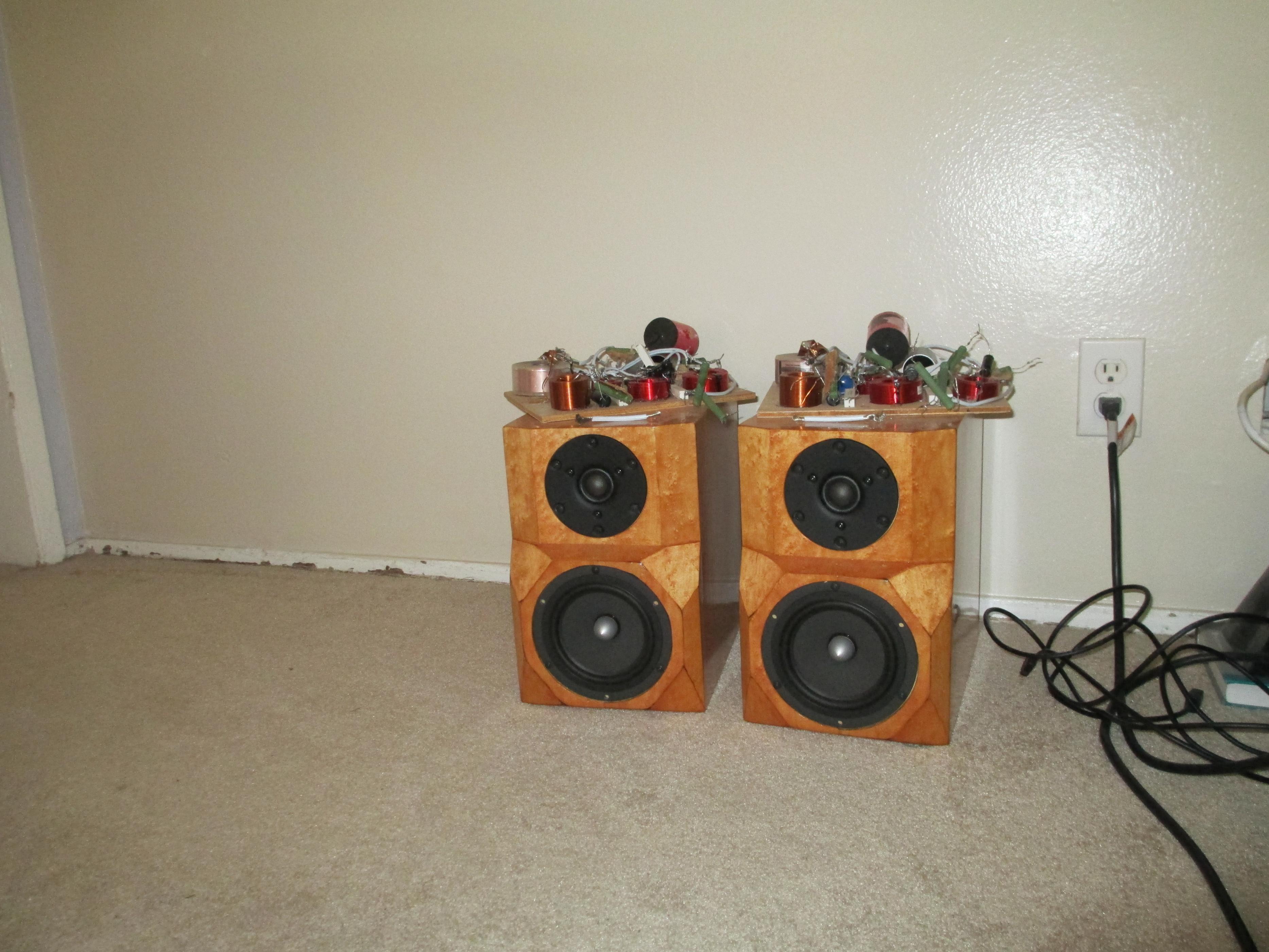

A quick comparison of the step response from two different baffle designs for acoustic center alignment : one is a stepped baffle and one is slanted baffle.
1. Stepped baffle is 3/4in. in the Z-direction. A matter of convenience since a 3/4in. plywood is easily obtained.
2. Slanted baffle at about 7 - 8 degree approximately.
The slanted baffle seems to have a smoother step response at the to of the spike where the tweeter and woofer meet. I think in order to get an optimal step-response, one probably has to pay a lot of attention in how the baffle is designed. Notice the slanted baffle has a more benign diffraction dip vs. the stepped baffle which I suspected.

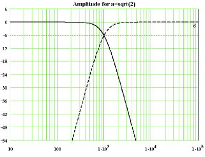

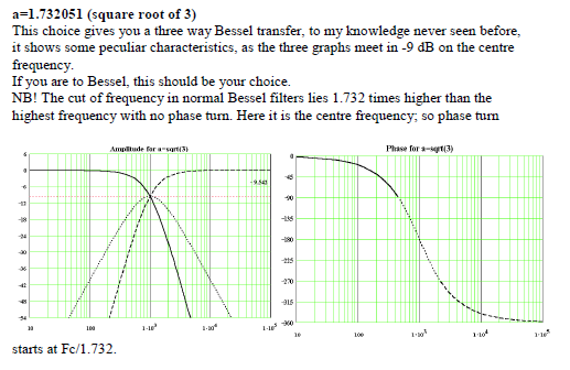

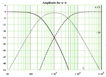

638108d1506851773-8-duelund-woofer-aequal_root2_steen_duelund_filter-jpg
Wiring it out of phase will create a phasey hole in frequency response at crossover. But all is not lost! 😕
If we can find a superb midrange or fullranger, and do some difficult maths, it turns out you can fill the hole! 😀
I won't attempt to create the exact solution, The mid must be in a 90 degree relation with the other two drivers. It only works on axis for overall zero group delay.
Here is what you get when you do a near two-way with a filler driver at midrange:
687002d1529097418-passive-passe-steen-duelund-1-732051-root-3-png
You can improve time delay by upping the midrange level:
687003d1529097418-passive-passe-steen-duelund-2-828427-2root2-png
And it starts to look really good when we employ a really wideband midrange:
638109d1506851773-8-duelund-woofer-aequal4_steen_duelund_filter-2-jpg

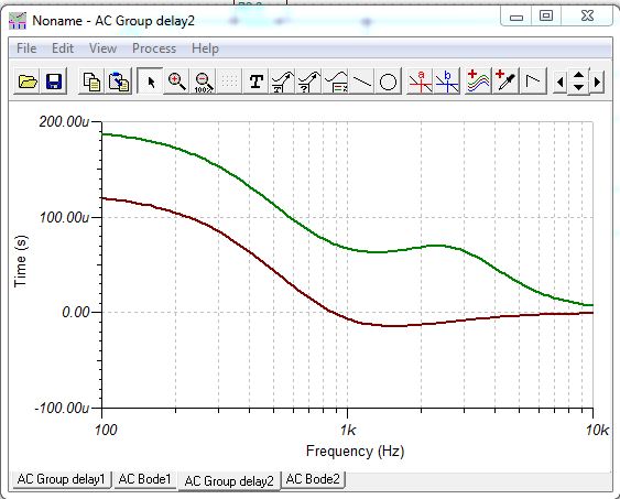

Here's a simulated group-delay response:
687023d1529098577-passive-passe-group_delay_with_bafflestep2-jpg
The bass delay is due to bafflestep and bass roll-off. The 3kHz delay is due to the 3KHz. filter. There is an intimate relationship between slopes, phase and group delay.
