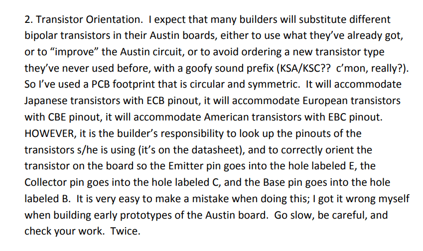

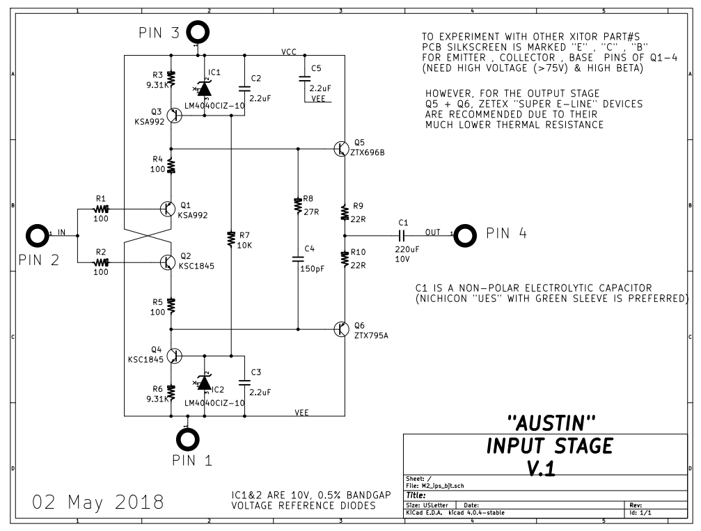

As usual, great work. Did you check difference in BC vs. ZTX case orientation? Silkscreen is for ZTX.Hopefully no magic smoke is released during the power verification, I waited a year to accumulate the parts and don’t want them to go Poof💥!!

Yes, the BC components would seem “backwards” in the ZTX locations.….Did you check difference in BC vs. ZTX case orientation? Silkscreen is for ZTX….
Hfe ‘A’ grade is installed here.
‘B’ and ‘C’ are used as per BOM for 327/337 replacements.

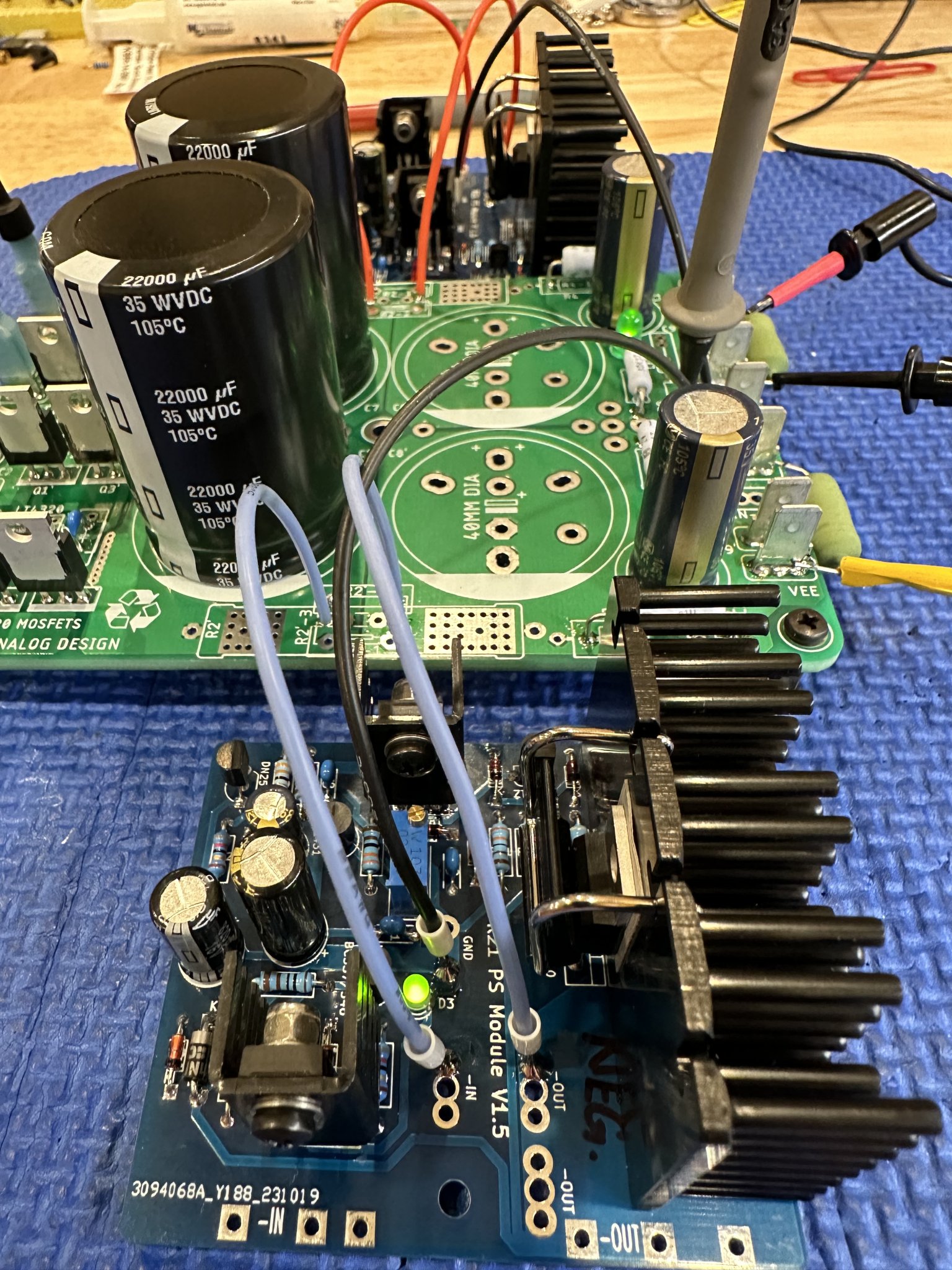

I will use my bench supply as you recommended, a bit safer than a variac in case of a problem.
Hahaa, another pitfall. I take it as a gift of my guardian-angel that I haven’t yet fallen into it, since I blindly trusted mouser, diyaudio, punky and everyone I got those three-legged bugs from. Never has it come to me that there could be european/us/japanese versions!
It’s a good night without fireworks at the bench! Besides a reversed diode (D5) on a negative regulator, all R21 modules powered up drama free. The red led (D7) blinks when voltage drop isn’t sufficient and falls out of regulation.😉

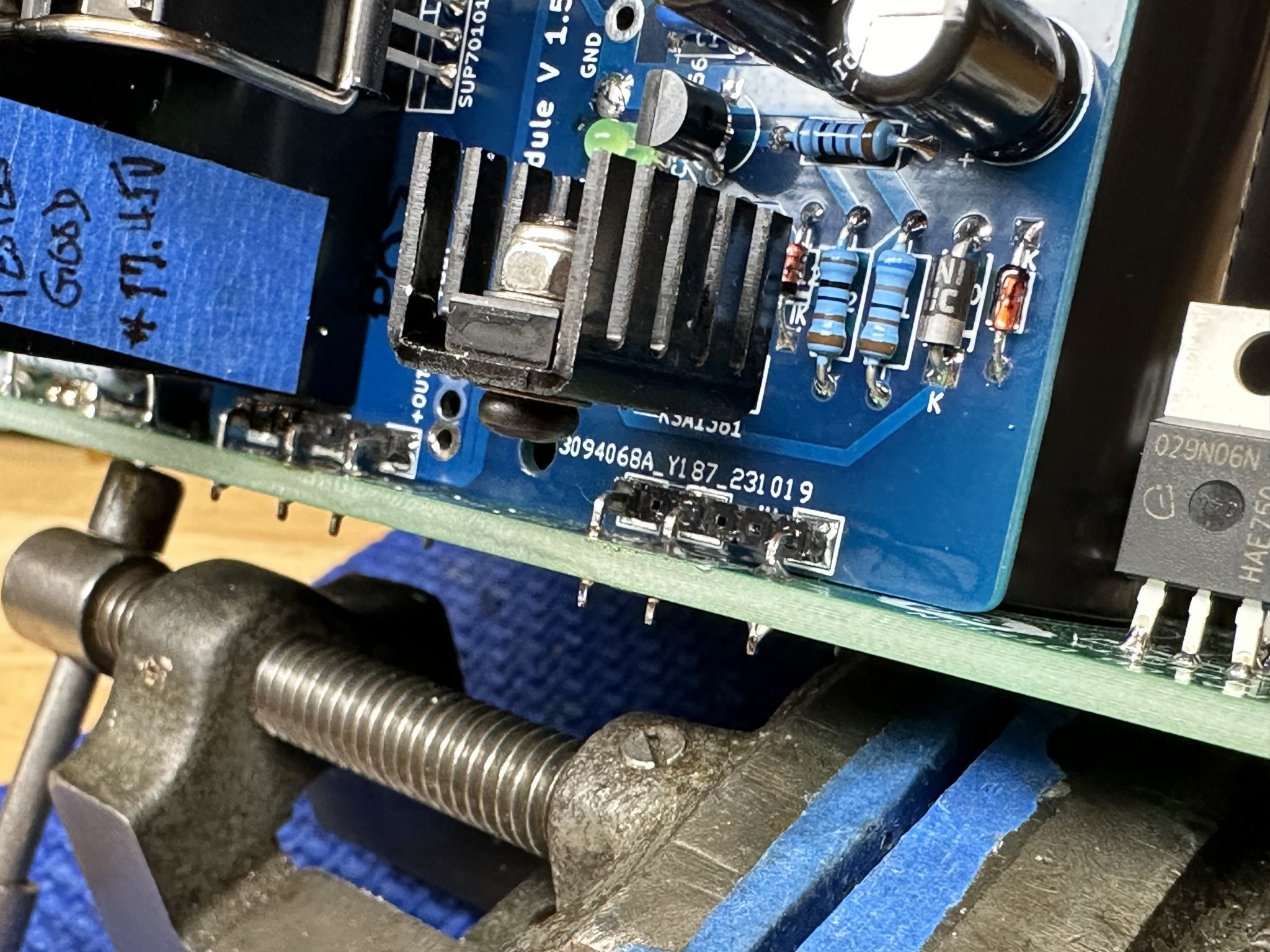

If your next step is soldering regulators to the CRC boards, I would propose the following way:
There are 6 connection points per regulator, aligned with CRC board holes provided for power resistors. Connecting 4 is enough for stable mounting but 6 is better. I used 0.8 mm cutoff wires from diodes. IIRC, 1 mm is max. what would fit to CRC board holes. First, all 6 straight wires were soldered to regulator PCBs. Then, all were bended 90° to be parallel with regulator PCB. Ground wire was soldered from the regulator bottom side and left with excess length.
Next, whole regulators was inserted to CRC PCB aligning/bending wires as necessary. Then, whole CRC PCB + regulators assembly was flipped over and left resting on regulator modules for easy soldering.
Grounding wires should be 1 – 1.5 mm2. Solder both to sides of the same middle GND faston. Ground wires should be short but leave enough length for routing around possible output capacitors.

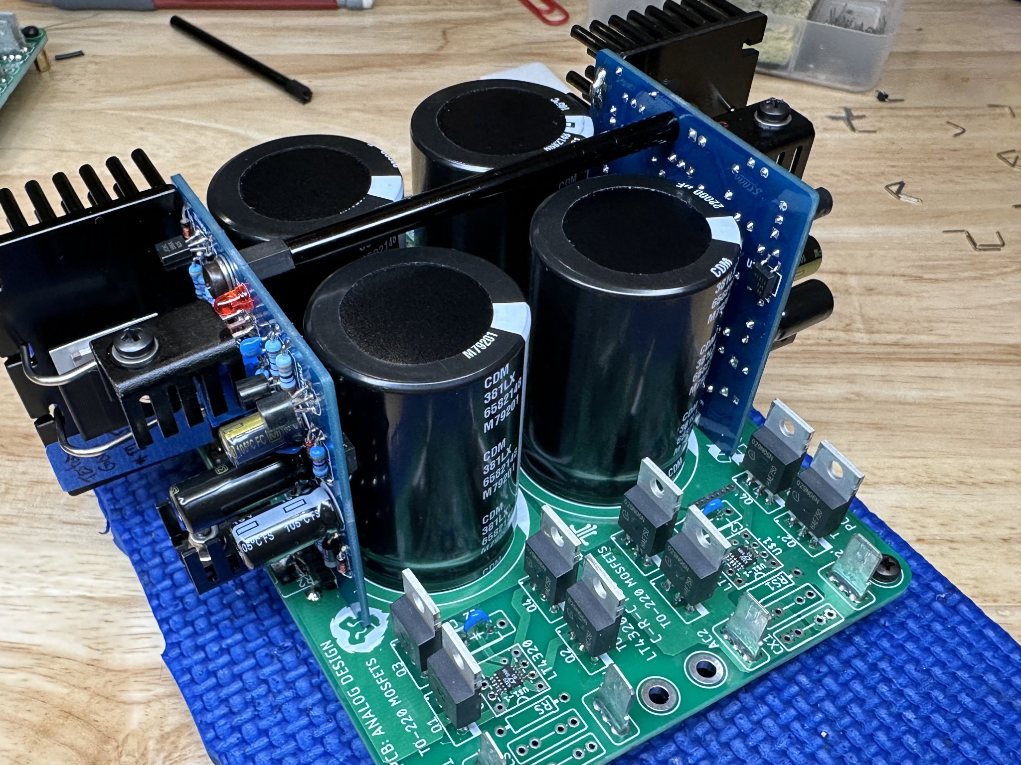

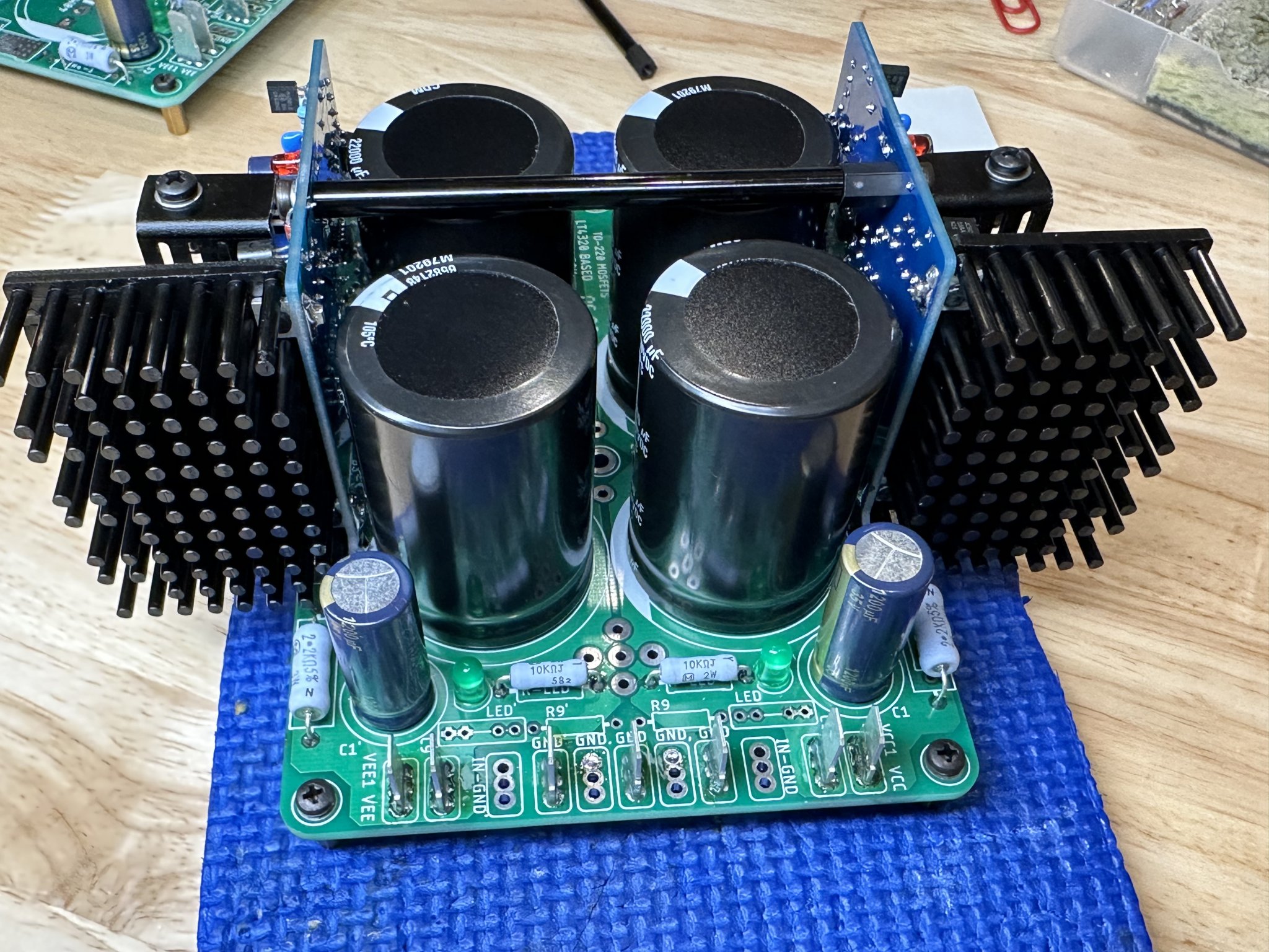

Thanks for the install tips but I went with right angle pin headers in all 6 positions. Very solid as is, I installed a cross brace between the pair of R21 modules for added rigidity.
Prasi’s 2mm thick boards are a perfect foundation to carry the extra weight without flexing. This is one Bad*SS psu!! Should be named Mad Maxx Regulator 😆
Vunce, you are a genius - a great implementation, well built. Now if only I could get my hands on some of those mosfets, I would copy that!
The cross brace is great. Looks like a great package.
👍Vunce, you are a genius - a great implementation, well built.
It is possible that Mouser didn’t play fair with latest MOSFETs shipment and ignored small customers. 🙁Now if only I could get my hands on some of those mosfets, I would copy that!
