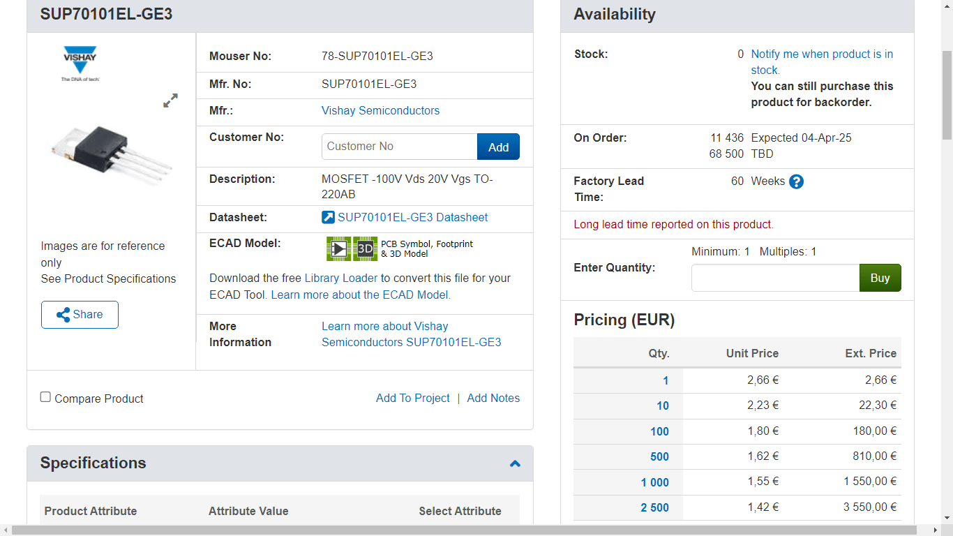

I was thinking of building a couple of these modules, but according to Mouser the next delivery of SUP70101EL-GE3 isn't scheduled until April 2025 (see image below)!
In light of this information, I don't think there's any chance of getting them this November.
As such, sadly, I don't think it's feasible to go ahead with this project, it will have to remain on hold waiting for a more propitious moment! Or, until Tombo revises this project with available components! 😉

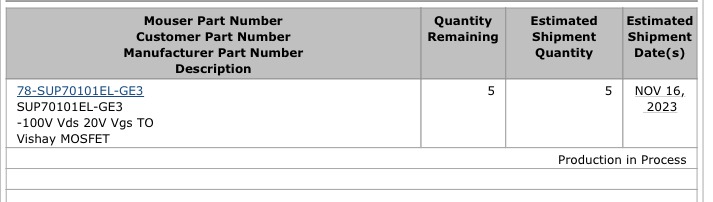

That part is a big problem - only yesterday Mouser was showing delivery on the 15th November this year for this, see post #67 and #68. Very strange. Other parts are also out of stock.
Those were the posts that led me to try my luck at Mouser. But, you can confirm the result by the image I included in my previous post, taken from Mouser's (Portugal) website approximately one hour ago.

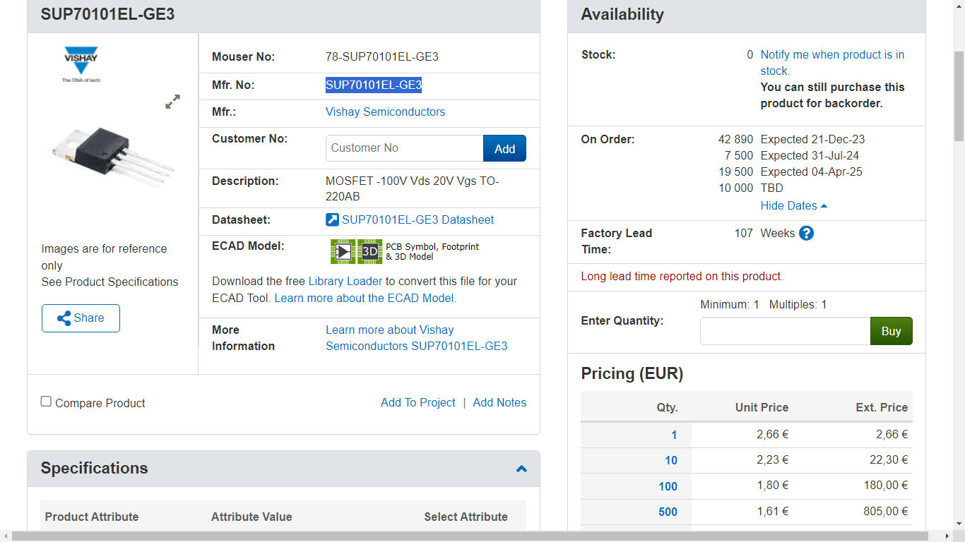

Wow! Mouser's expected delivery dates for the SUP70101EL-GE3 have changed again.
As the first delivery is now scheduled for December, I think I'll take my chances and order a couple of units.
With those wildly changing delivery dates, who knows what will happen. There is a mysterious large customer buying all these parts, so they might get in first. Good luck with ordering them.
