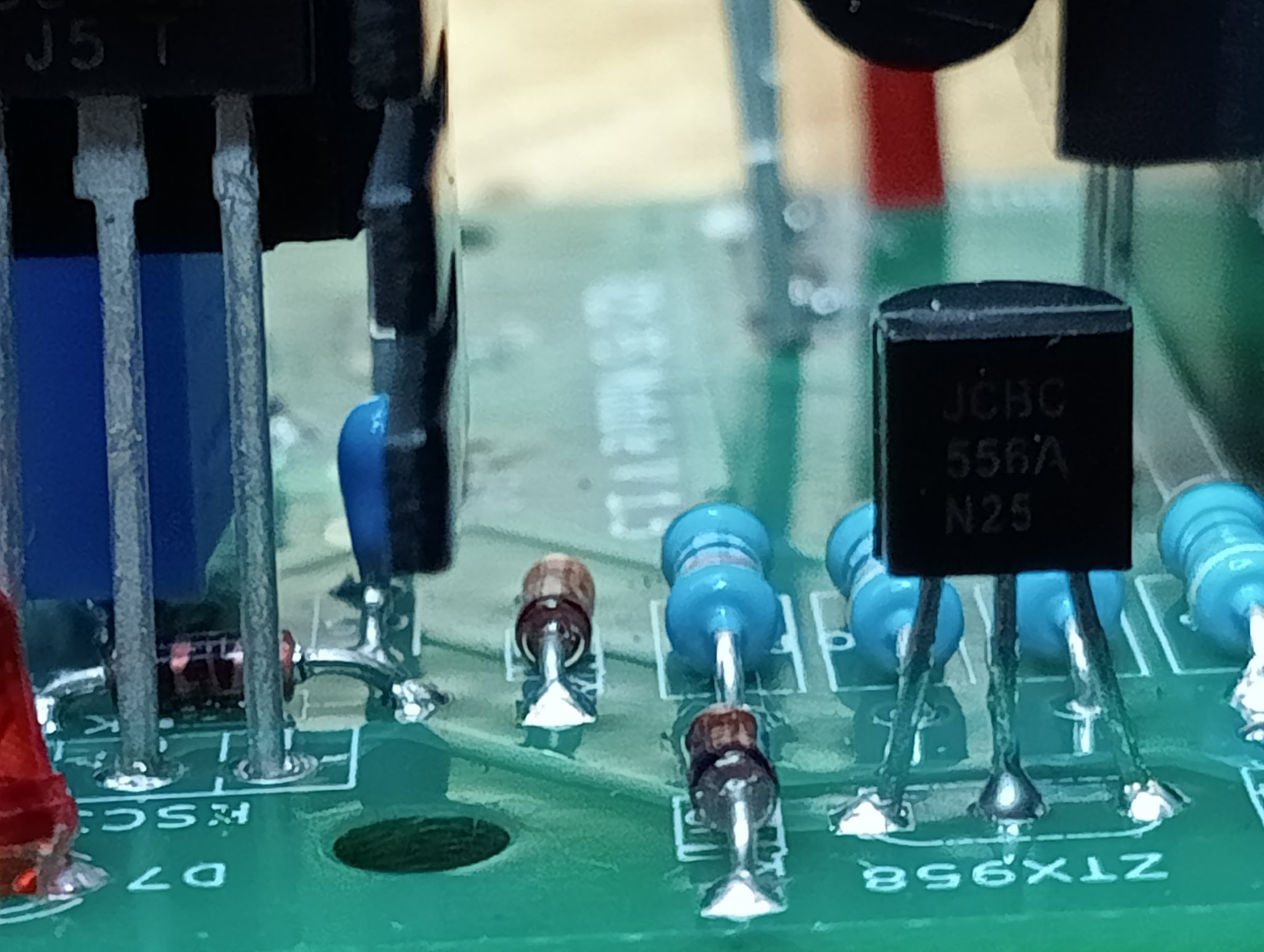

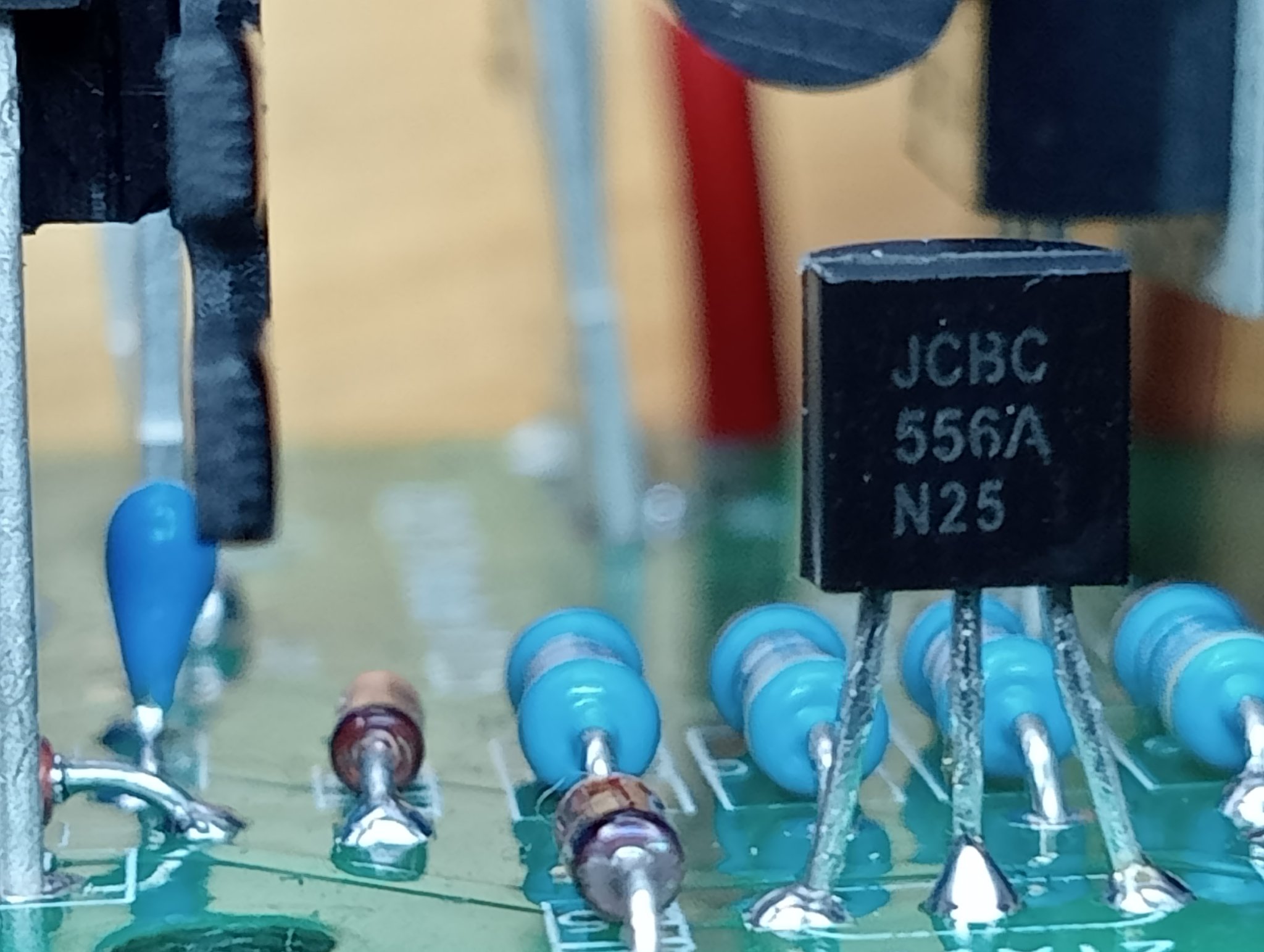

Hello Tombo,
I managed to get the 'original' parts, except the ztx which I replaced with the recommended transistors. When I try to set the correct output voltage I get a problem. Both with 50 watt power resistors of 15 ohm or with 1 watt 220 ohm. Turning counter clockwise to turn off the red led, and then a bit more same direction I get about 10 volt less output than input. Increasing the voltage very slowly it goes up to about 8 volt less than input. And then jumps immediately to the input voltage.... I then reduce the voltage again anti clockwise and the dame story in repeat. Any ideas where I have to look for my errors?
Thanks Leo
Thanks Leo
Did you take in the account that BC transistors, replacing ZTX parts, have different pin orientation if looking at their package. They should be mounted against silkscreen markings as rotated 180 degrees or backward. Look at post #103.
If that is done OK, then post some close-up pictures for both PCB sides.

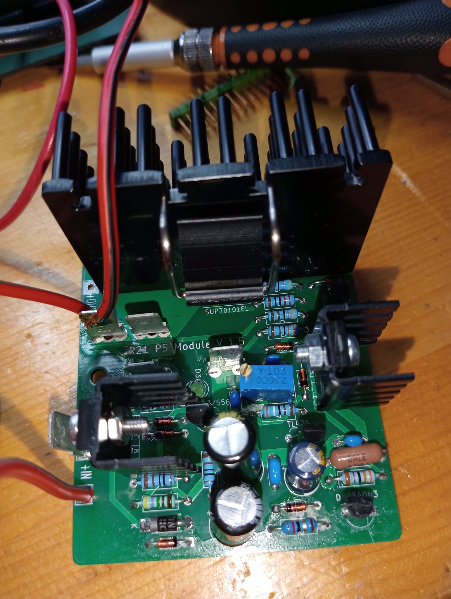

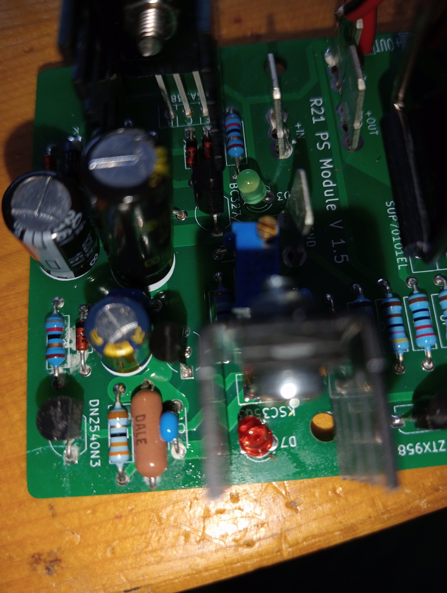

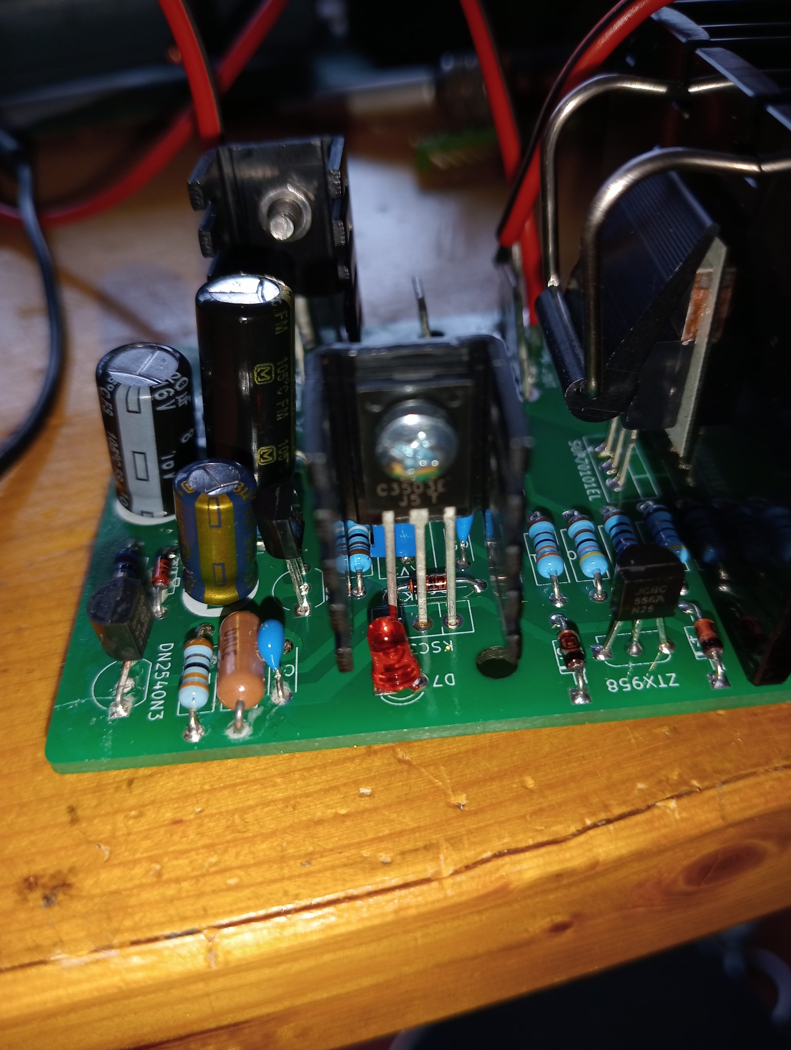

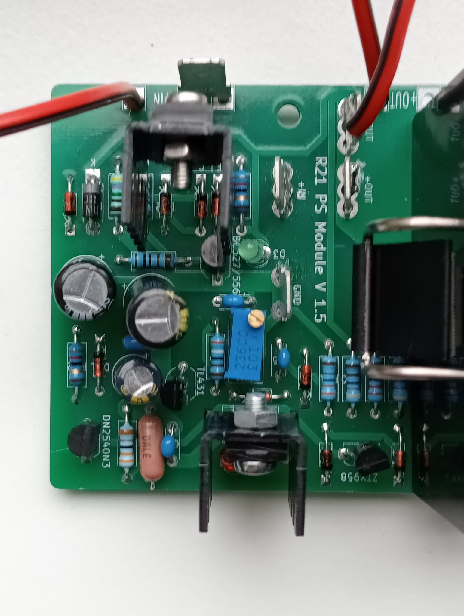

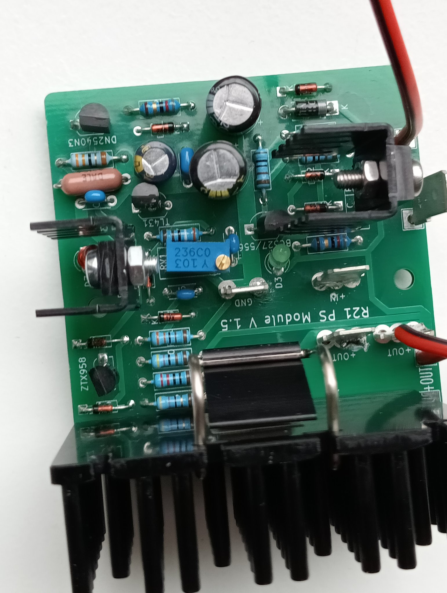

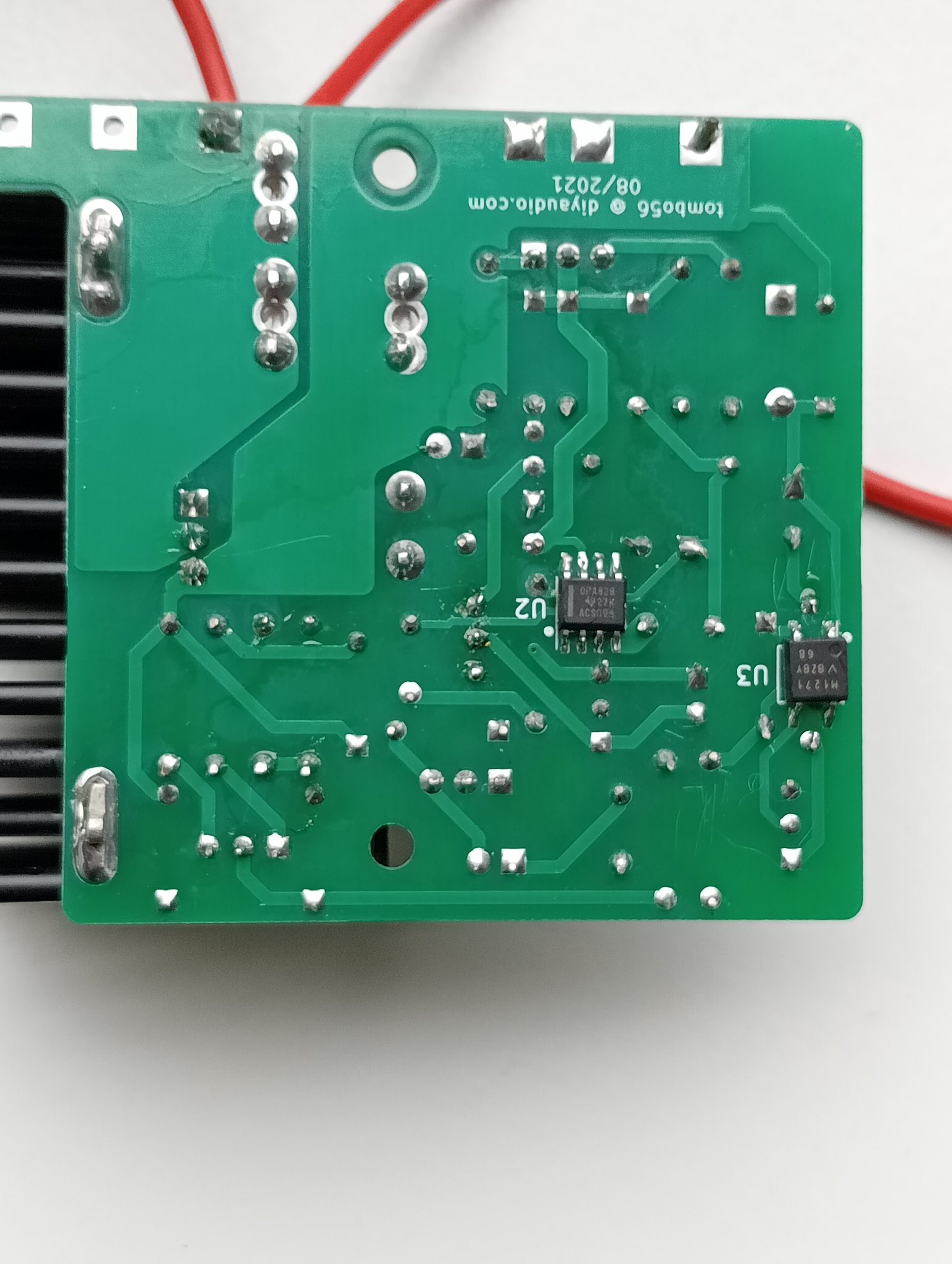

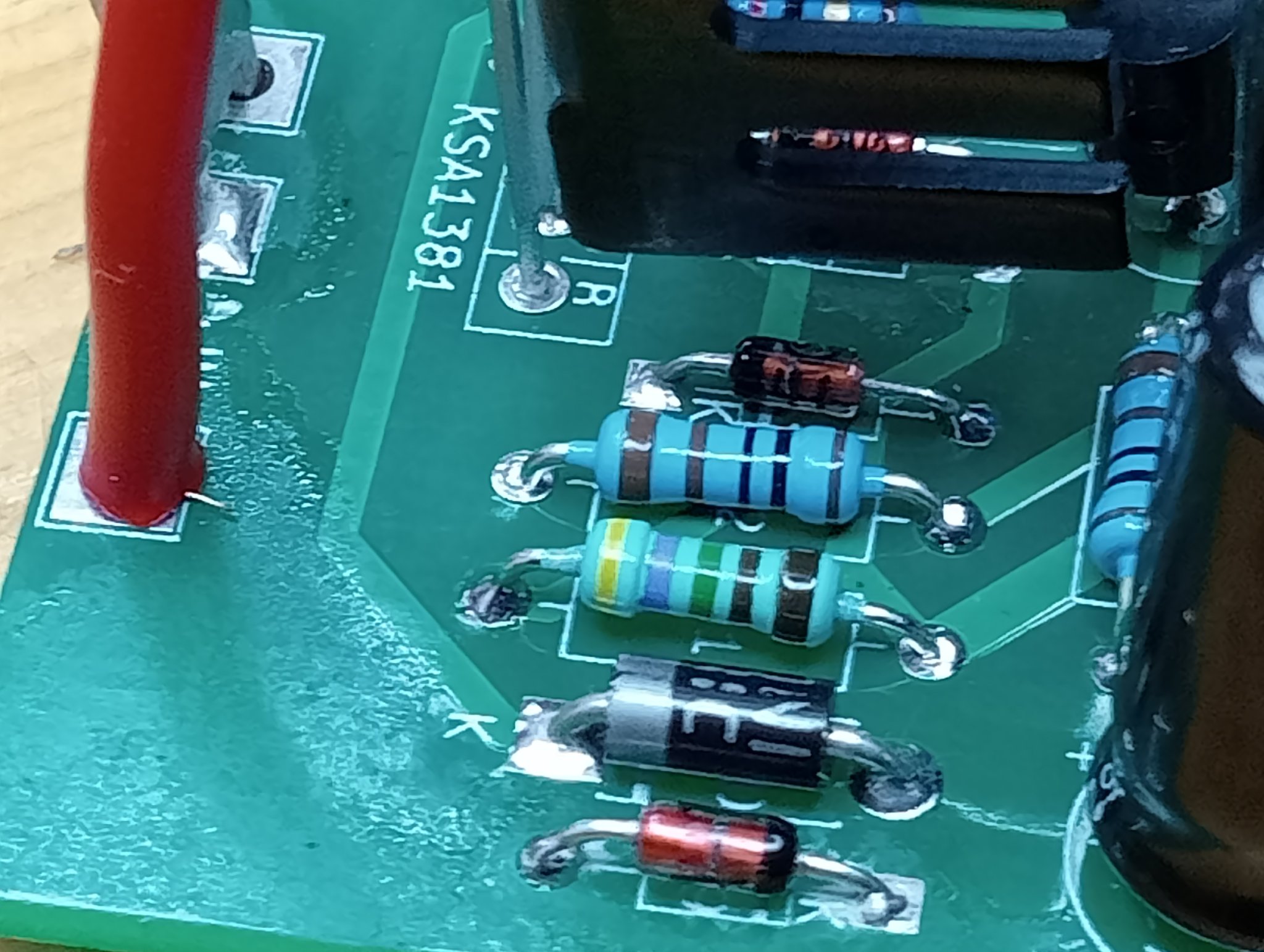

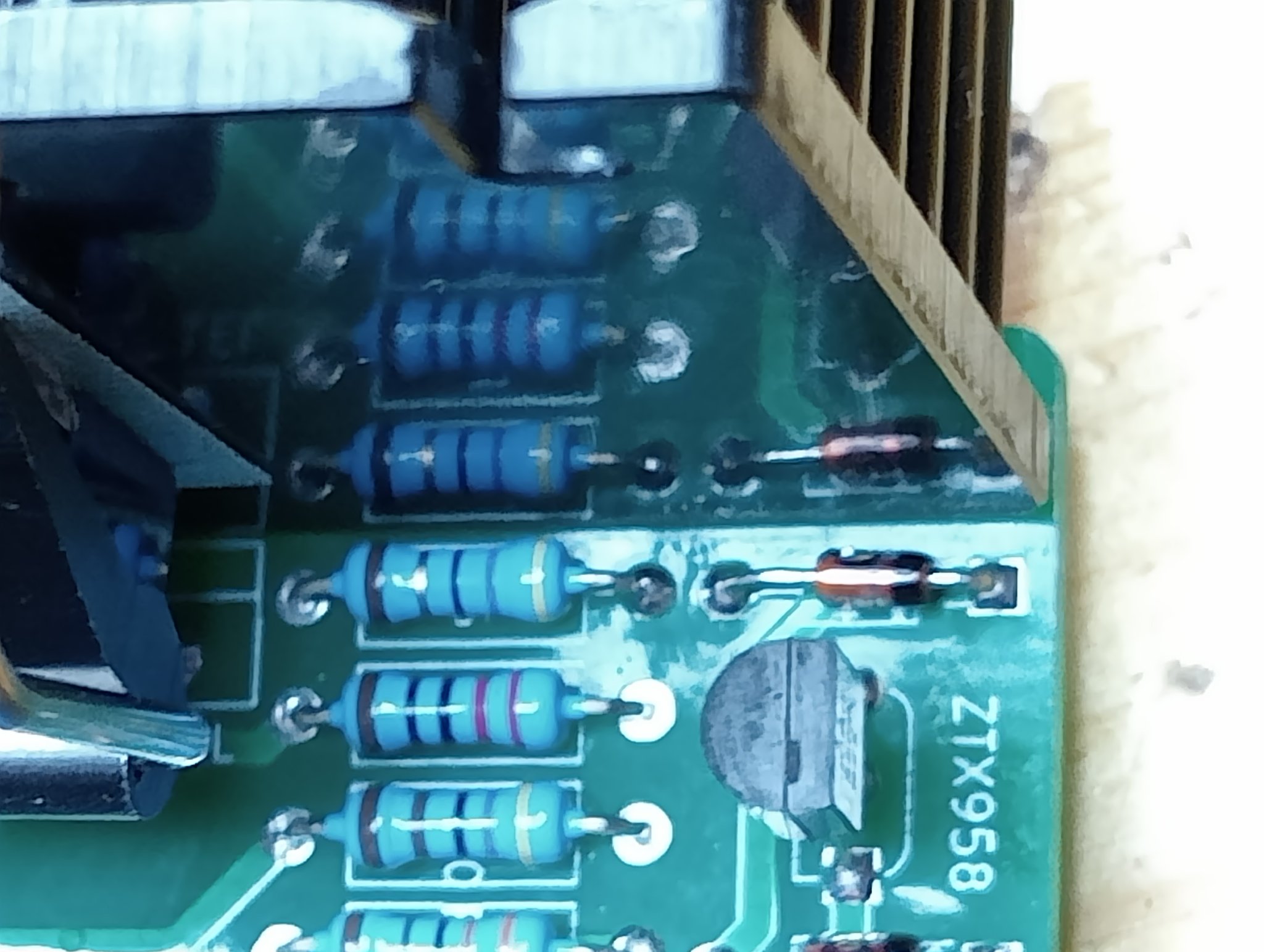

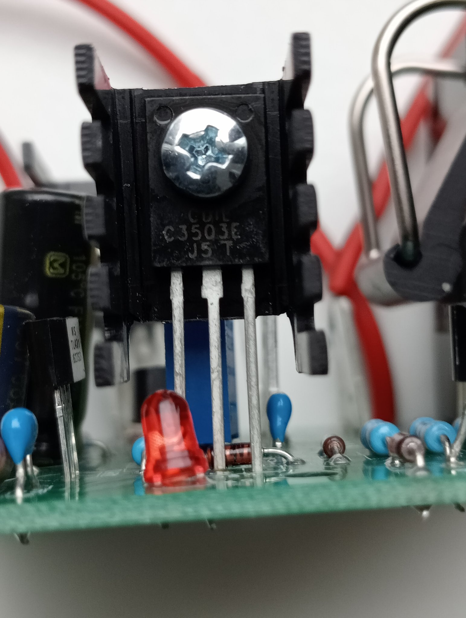

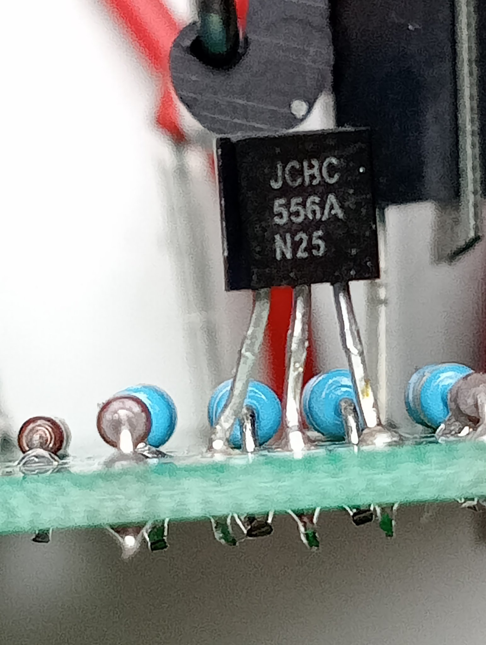

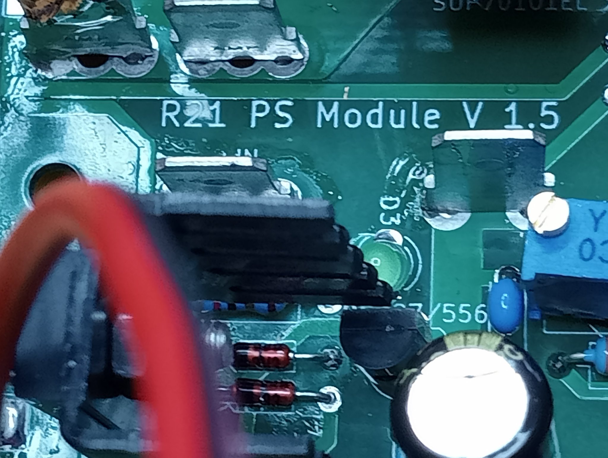

Hello Tombo
I checked the BC556, even desoldered it and tested it. Seems ok, so I hope you can help based on these photo's...
I built 3 positive R21 in parallel, part by part. I tested the second one and it works fine. As I tried to take care in putting them together I am surprised at my inconsistency to put it mildly.
But also very happy that I have one working that I will try with my Pass F1 this week.
Tomorrow I will hook up the third one and see whether that one works ok as well.
And thanks for any help or direction you could give me with solving this.

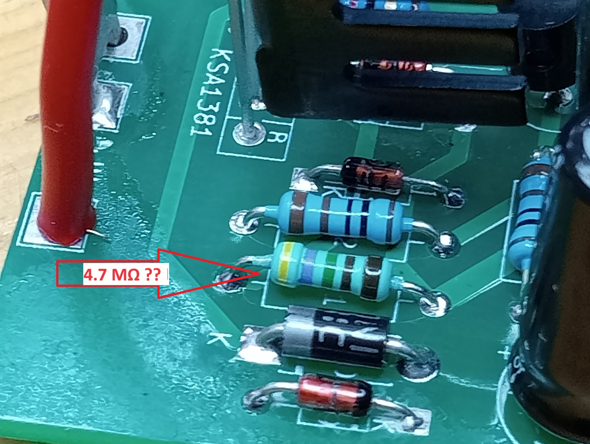

It’s very good that one regulator works as expected. You can compare if there is any difference in part values or orientation. For the moment, I see suspicious colors on R1. Looks like 4.7 M resistor instead of 1000 x less required. Does green LED light on?
