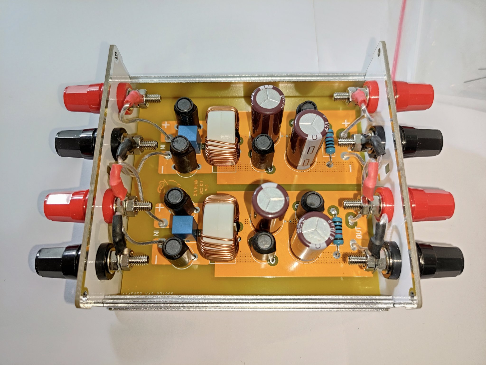

Please feel free to call your creation any name you like, as long as it's NOT "AmyAlice". AmyAlice includes no R050 resistor and no 1K resistor and no 0.1uF capacitor and CERTAINLY no toroidal common mode choke. AmyAlice has two inductors per rail (not four). AmyAlice includes a TVS, missing from yours. Whatever that circuit in #69 happens to be, it certainly isn't AmyAlice.

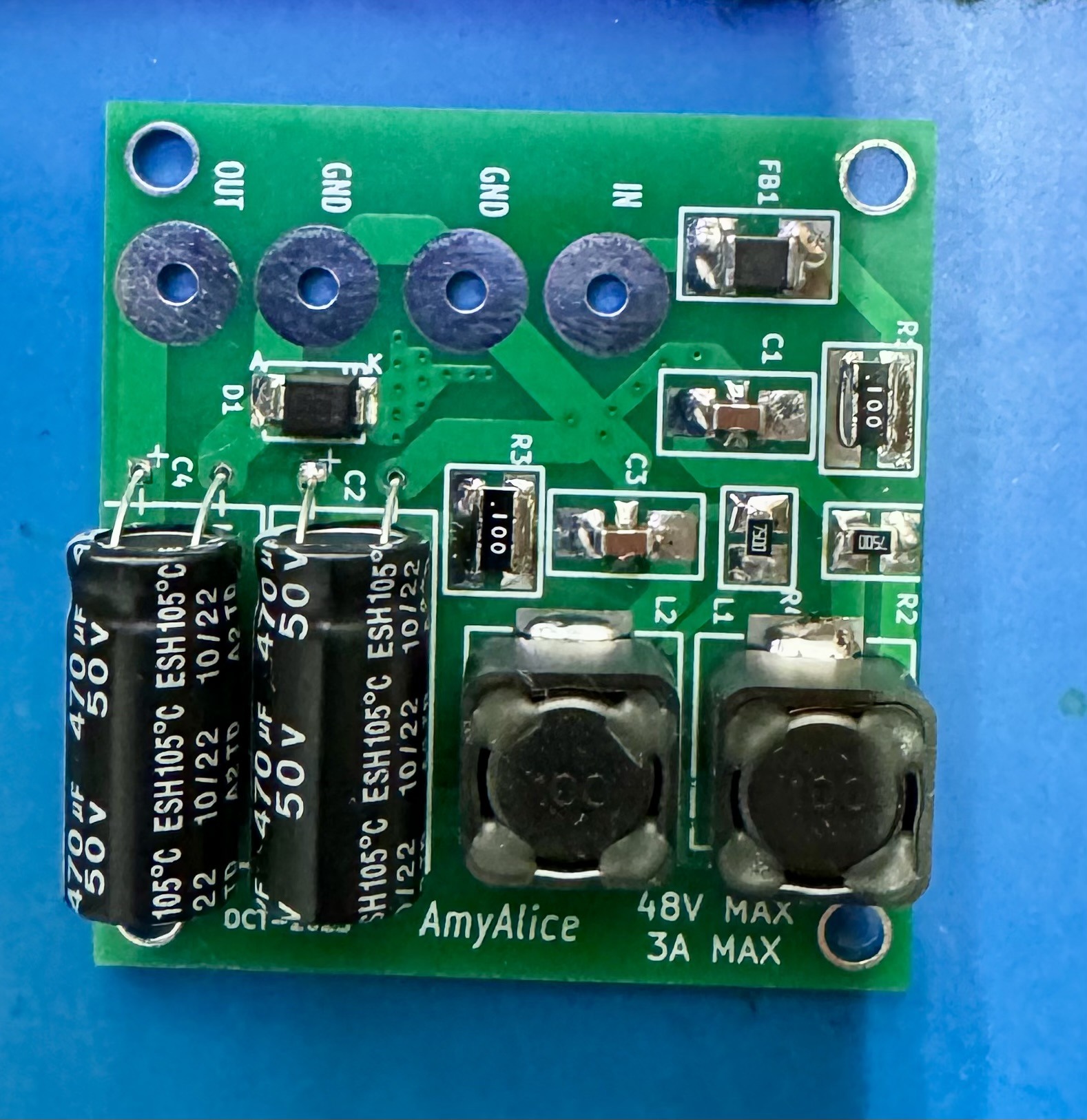

Thanks for a great intro into SMT. I've built 3 with more on the horizon, when parts arrive from Mouser.

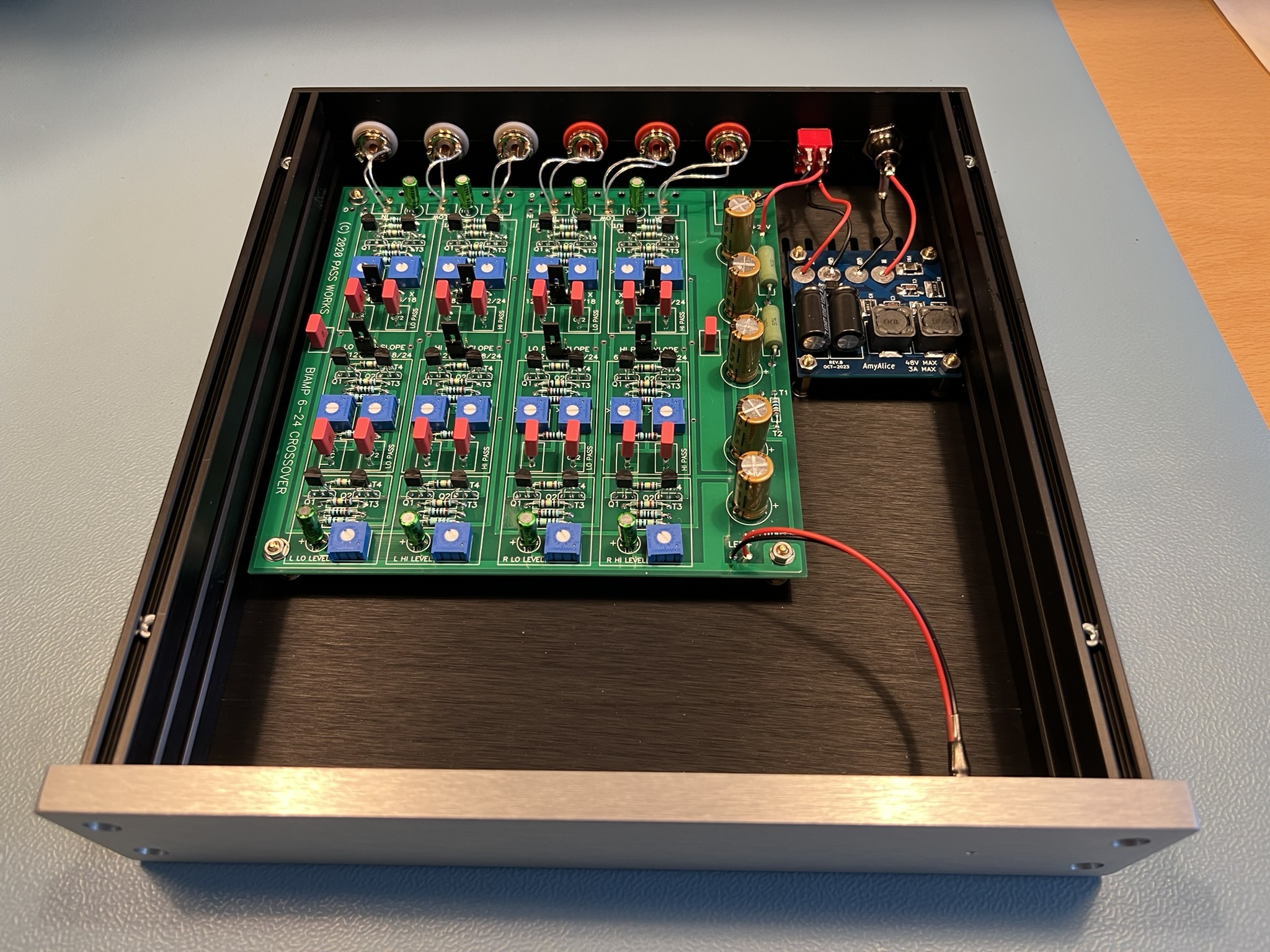

Replaced 2 P089ZB (original SMPS) and the deference in sound is pretty stunning. Most notably in the ACA Mini amp. The sound dynamics increased beyond what I could have imagined possible.
Appreciate all you're education bits regarding SMT tech.
this is t he first board that is setup for the negative side of a power supply source. Waiting to build the positive side of the rail.
Congratulations @carlpsyd , glad you tried SMD and succeeded! Thanks for the listening evaluations as well.

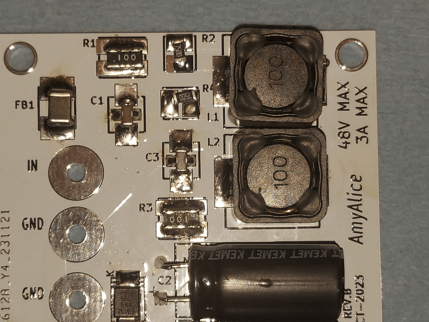

I think you may want to double check whether you remembered to rotate TVS Diode "D1" on the Negative Supply Filter PCB shown in post #73. The diagram showing the proper rotations is attached to post #31.
