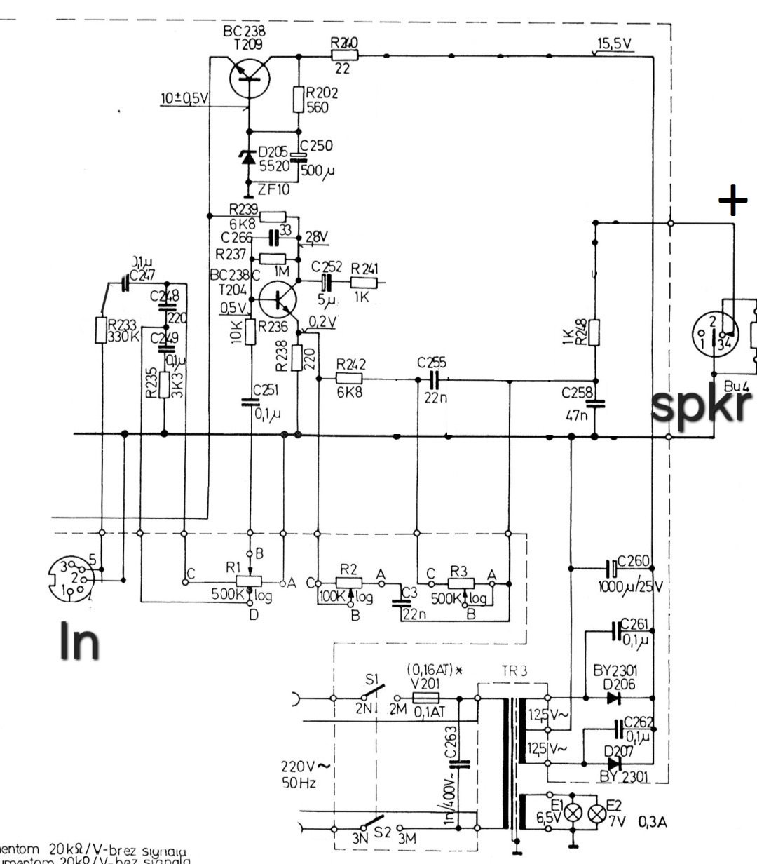

As said it should be connected in inverting mode, this way it can be connected to R241 on the schematic and will replace
T205/206/207/208 but not T204, hence the original tone control will be unchanged.

The original tone controls are probably the reason you liked the sound of this thing in the first place, and they ARE active. It’s in the feedback loop of the power amp section. I’d put them elsewhere, then ANY power amp of sufficient output can be used. Even when the bass and treble are turned ALL THE WAY DOWN there is still boost going on. There is just more with them turned up. I’ve analyzed the circuit and it’s a smiley face from Hell. That speaker, poorly baffled, without it is going to sound like a tuna fish can.

Here I have deleted everything but tone controls (I think), input of TDA2030 to R241....
R248 must stay or not?
Anything else?

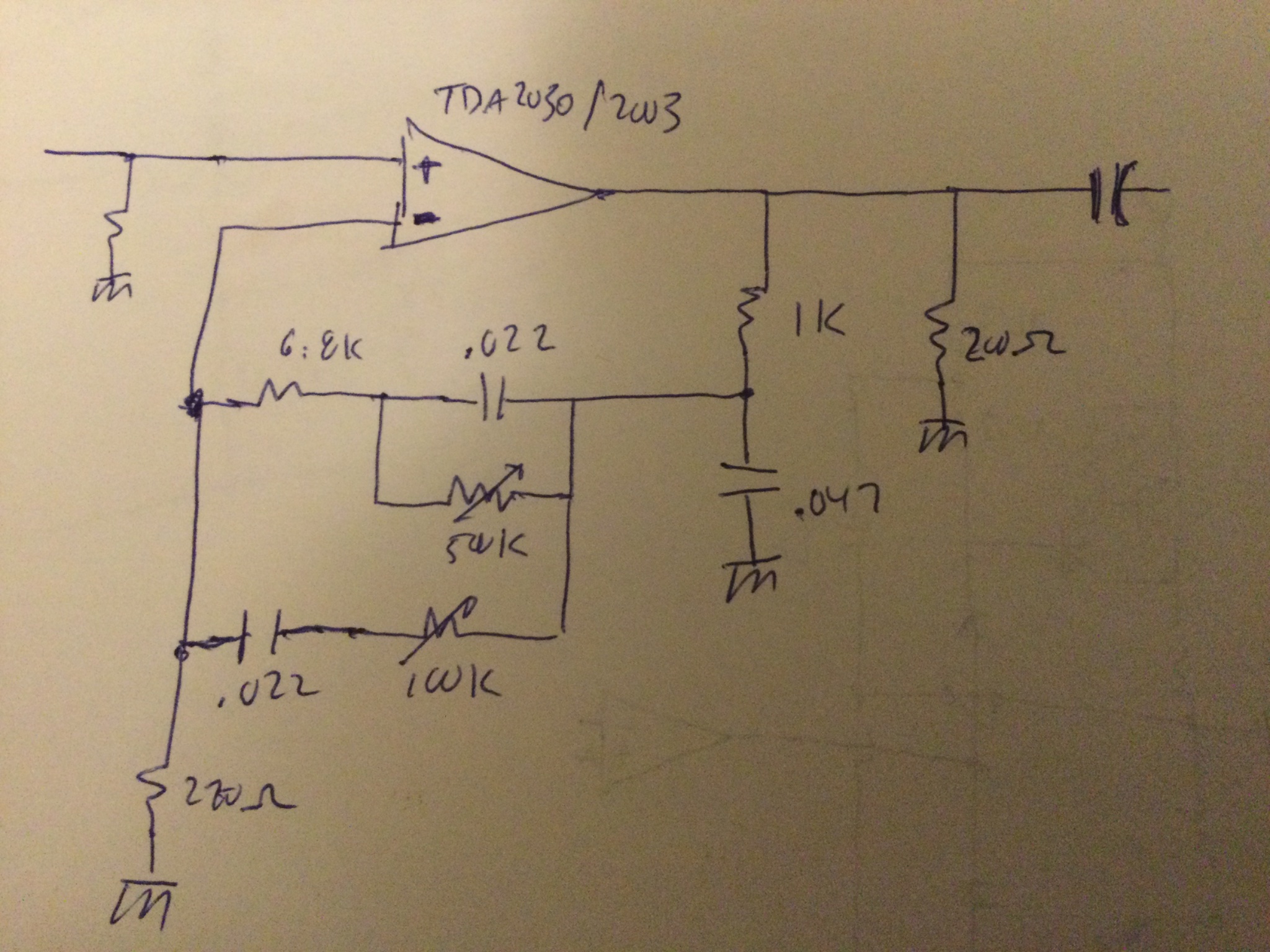

Those tone controls are part of the feedback loop that went all the way around the amp from speaker out to the emitter of T204. The power amp included T204. To duplicate the original amplifier one must:

Gain is high enough that it will be stable, regardless of position of the controls. Don’t omit the 200 ohm to ground if the TDA2003 is used. It mitigates crossover distortion. Also wastes DC power, but nobody cared about that in car radio application. The 2030 should work too. If you use 2003, run the supply up to 18V. If you use 2030, run it up to 20-22, just to get the same power. And it will need a heat sink.
I’d prefer to do any tone shaping in a separate block, ahead of a flat amplifier - but if you want to press the Easy Button, this is it…..
Output coupling capacitor can be 4700uF?
What would be the value of resistor going from in put to gnd? around 50k?
And should I add input coupling capacitor? around 10uF I suppose?
The original power supply is just the positive half of a split supply. What to do depends on the voltages you need, and the transformer(s) available.
Output cap needs to be something “big”. Just make it bigger than what was there and all is good. If you have a 2200, use it. Resistor from + input to ground isn’t critical. Just use the one from the data sheet of the chip you use. Input cap, 10 uF is fine. You probably have some.
If using a single supply with a split supply chip, use a 10k+10k voltage divider to make the bias reference, and bypass the lower cap with 100 uF. That will keep the 1/2Vcc reference noise and hum free. Hang the input resistor to that point. Then capacitor-couple the resistor from minus input to ground to keep the DC gain at 1. 100 uF is enough, more can’t hurt.

Correct on rail connections. The input bias circuit just needs to be adjusted according to which is used, and of course an output cap is required on a single supply. It’s a good thing actually. A misconnection could result in the output voltage sticking to the rail. The cap prevents that from killing the speaker. You can correct the mistake, and move on with no harm done.
