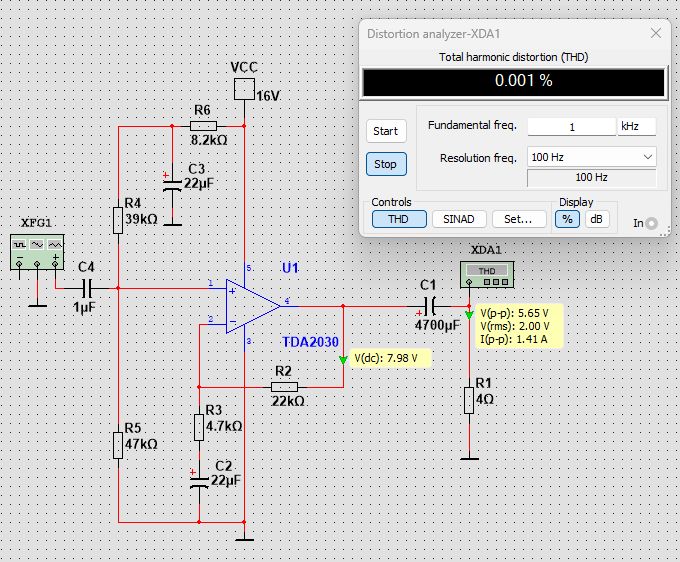

Most simple is to replace the inverting amp part with a TDA2030 with gain set at 68 and connected as inverter,
this way the original tone control can be kept as it is while the TDA2030 will provide HiFi class perfs, this chip
is still available at 3€ or so for a STM.
Also what is possible in this case is to use the transfo s 2 x 12V5 capability to feed the TDA with +-15V while keeping
the rest at single rail +15V5, this require only a 3A diodes bridge and a 2200uF cap, power would rise to 12-15W/4R,
of course with another speaker but a car dedicated one is cheap.

At 15.5V a TDA2030 will do 3W/4R, so that s not an issue, the advantage is the simplicity with a single TO220
package, 4 resistances and no cap needed since they are already on the circuit, and of course a cost of less than 5€
for a sound that will be as good.

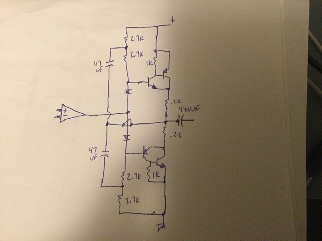

CFP followers have increased current gain, and are easier to drive. You lose about 3 Vbe from the available voltage instead of only two. Regardless of what op amp is used I’d use them. You don’t need the high speed high gain outputs. BD441, TIP41, and the like can be used. The small signal drivers should be “beefy” ones, although I’ve used 2N3904/6 with up to +/-18 (ie 36 volt) supply and the output stage doesn’t go into thermal runaway. If I were using an op amp I’d end up with something like this, boot strapping both sides of the driver. Op amps themselves already lose about 3 volts to each rail, and the boot strap allows you to make this up.
But you see all this and you go “Time out, it’s already getting complicated”. I could accomplish with two miserable transistors and the same number of other components, what the op amp does. And you get to ditch the boot strap on one side. Overall, a simpler circuit. More like the original. This is why I’d probably just go back to the original circuit, adding the two bias diodes and using silicon outputs. It already has a pretty damn well optimized driver stage, although if lower gain (ie BD or TIP) outputs are used I’d consider increasing the tail current in the driver.
But no one has addressed the elephant in the room yet - which is the frequency response shaping network in the feedback of the power amp stage. If you don’t have that, it’s going to sound tinny and small. Personally, I’d get it OUT of the power stage, but it will have to be implemented SOMEWHERE.

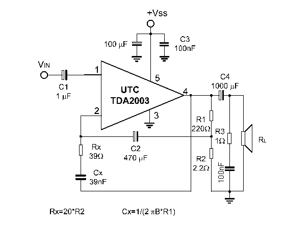

It’s not the IC’s fault. It’s because overall design details of the original are being ignored. A TDA2003 operated at 16 volts is comparable to the original power. At 18 you get a wee bit more and I’d take it.
A lot of those old ICs were at fault, though, because many couldn’t even muster three watts at 26 volt supplies. And had 10% distortion trying. And if you do pre-equalize (as required to obtain your original sound) a half watt amplifier is simply going to run out of juice.

I`ll try the TDA2003 then.
This "testing circuit" from the datasheet is a bit different from what @lineup posted...
Should I use yours or this one? Rolloff is good on yours, right?
Also 12v transformer would give 18,87vDC, TDA2003 has stated max at 18v. Can this be overlooked?
