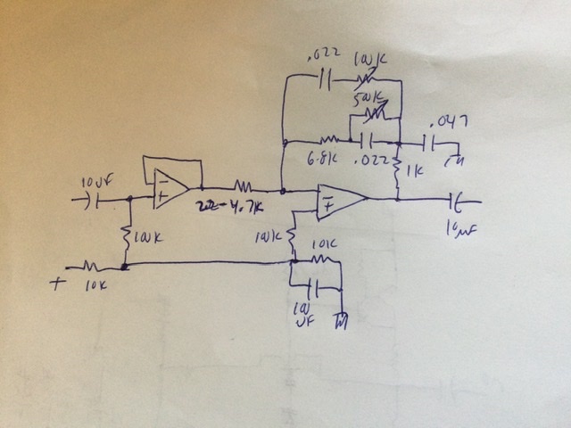

I would, but I have no idea on how to come up with the schematic.It’s also another reason to get that stuff out of the feedback and implement “somewhere else”. What’s one more op amp among friends? 10 milliamps of current draw?
If I did do it separately, I’d run it inverting and bump the 220 ohms up till midband gain was between 1X and 4X. Drive it with the other side of a dual, strapped as a follower. Decrease the power stage gain as needed. Result? Better gain structure and lower noise.
Ain’t hard. Just use a 5532 op amp to drive that miserable 1k load. Alternative is scale all impedances up and be stuck finding a 5 meg pot, or my solution which is yet still another layer of complexity. But I’m stubborn enough to do it (emitter follower and 20 mA current source, inside the feedback. MPSA06’s are cheap and I have more of them than I do 5532’s).

The preamp if I think correctly has 2 inverted buffer followed by inverted tone control stage... Inverted + inverted = noninverted output

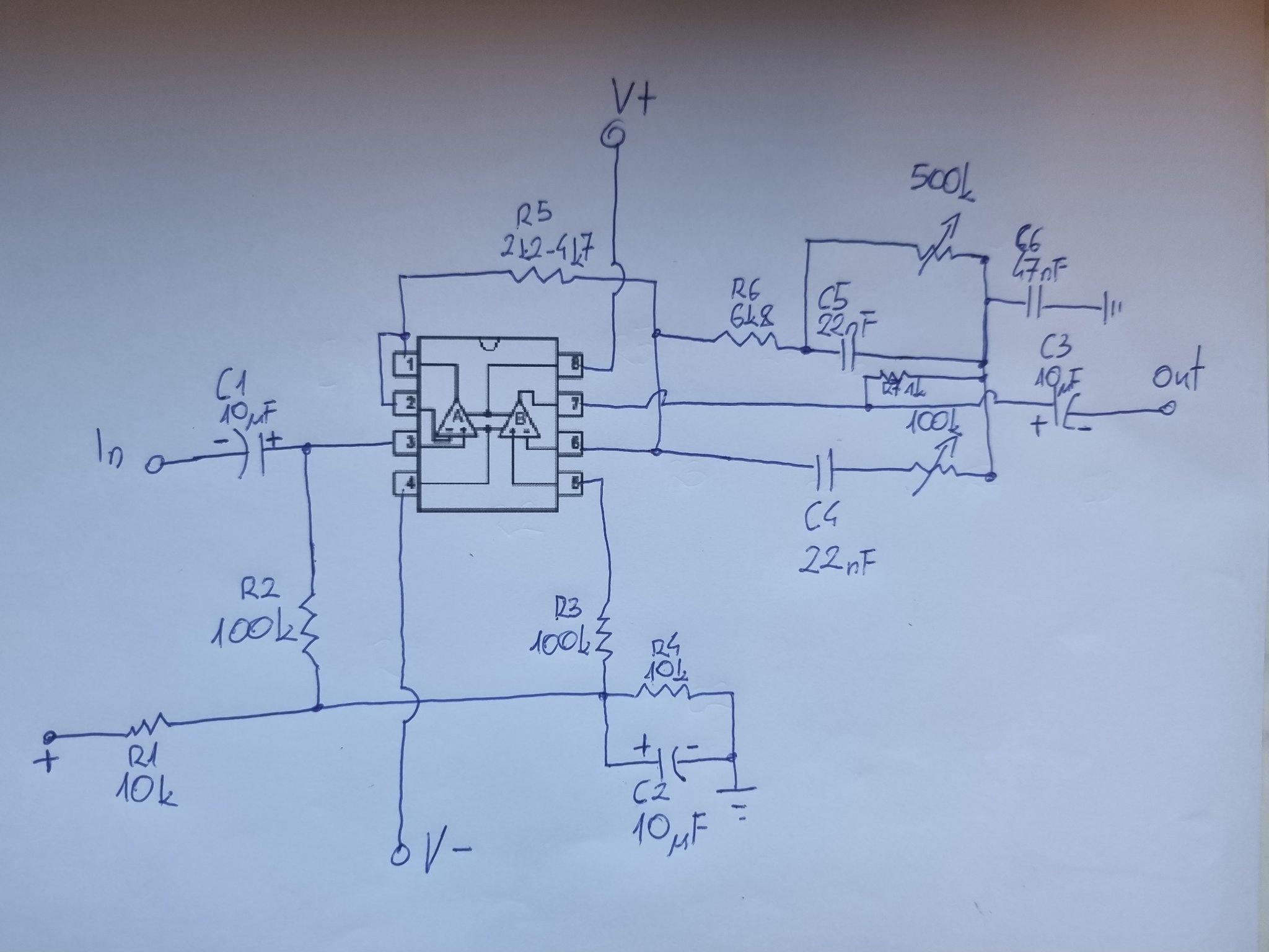

I did draw another schematic, just to make it easier for me to transfer this to perfboard layout.
The circuit is not for split supply right?
That 2x 10k divider got me confused...
I presume that it is for single supply, in that case I must connect 10k (R1 on my schematic) to V+ right?
What would need to be done to get split supply version from this one? I think that I should just remove R1, R2 and connection between R1,R2 and R4 right? Should Input be grounded with resistor anyway? Or 100k towards V- and another 100k towards V+ do make a divider?

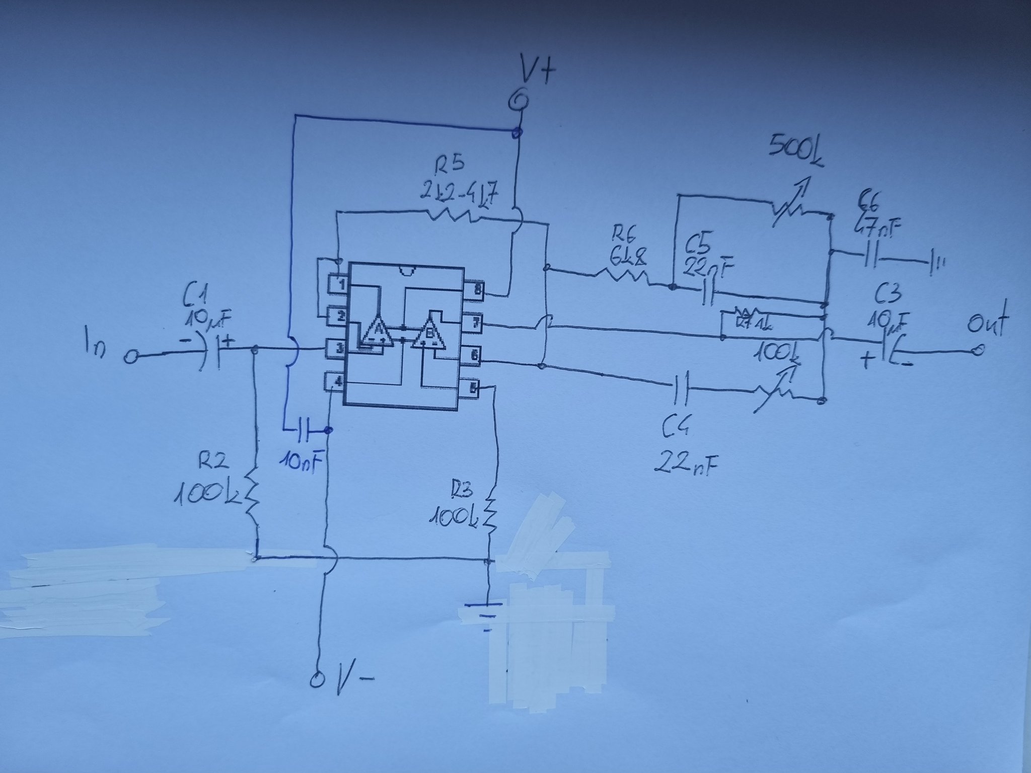

If you are using a split supply, ditch the bias divider and hang the 100k’s directly to ground. And put a .01 or 0.1 uF ceramic cap directly between pins 4 and 8 of the op amp. That’s a good idea regardless, and then you can get a bit sloppy with the supply wiring and not run into problems.
Ok, will draw, just to double check I don`t get something wrong before building.
0.01 or 0.1uF ceramic cap... can I use something in between those values right?
I also presume that if I will run amp in split supply, from same supply, it is better to run also preamp in split supply to load both rails equaly?
