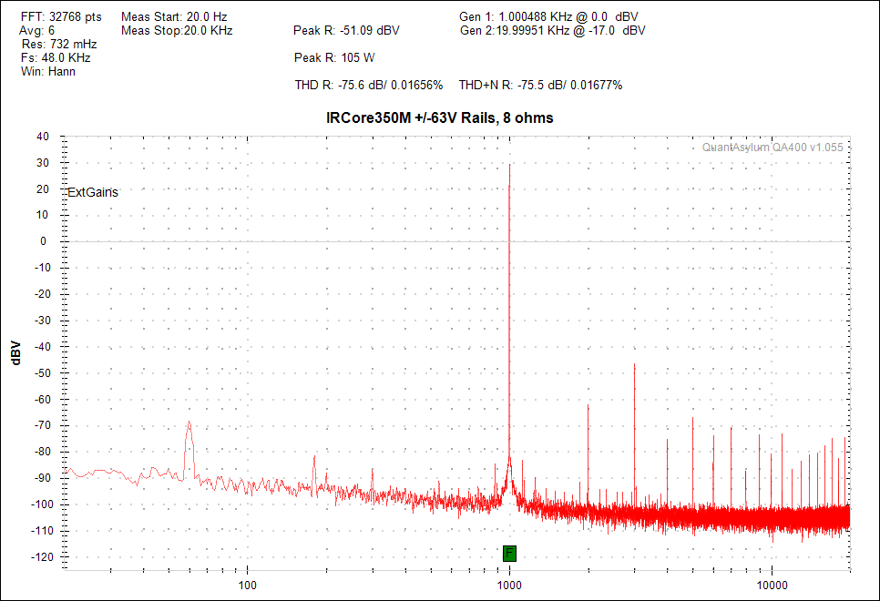

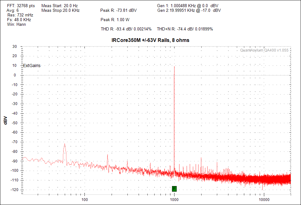

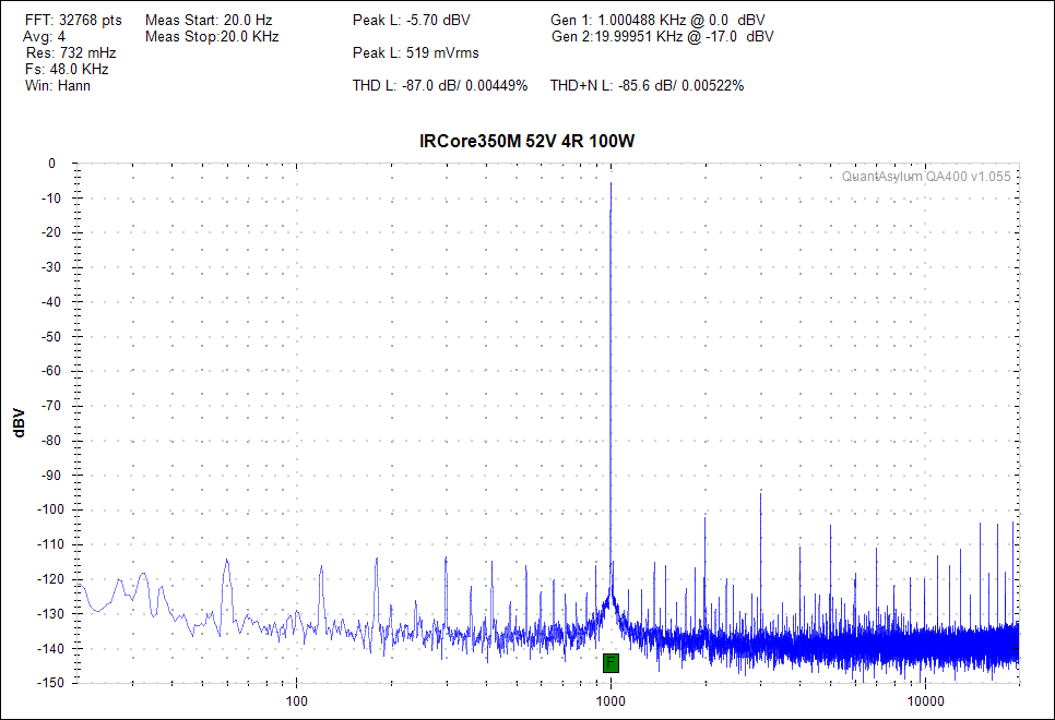

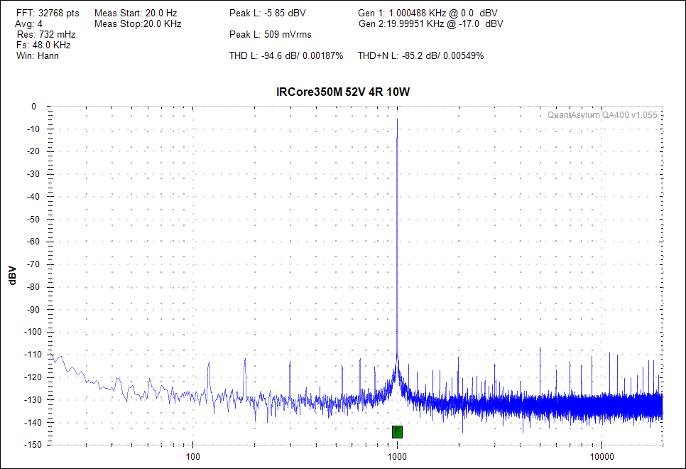

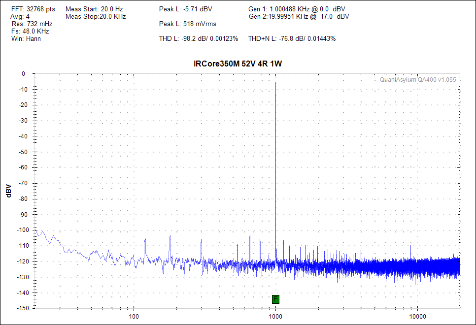

Yes, it's already available on my eBay store.

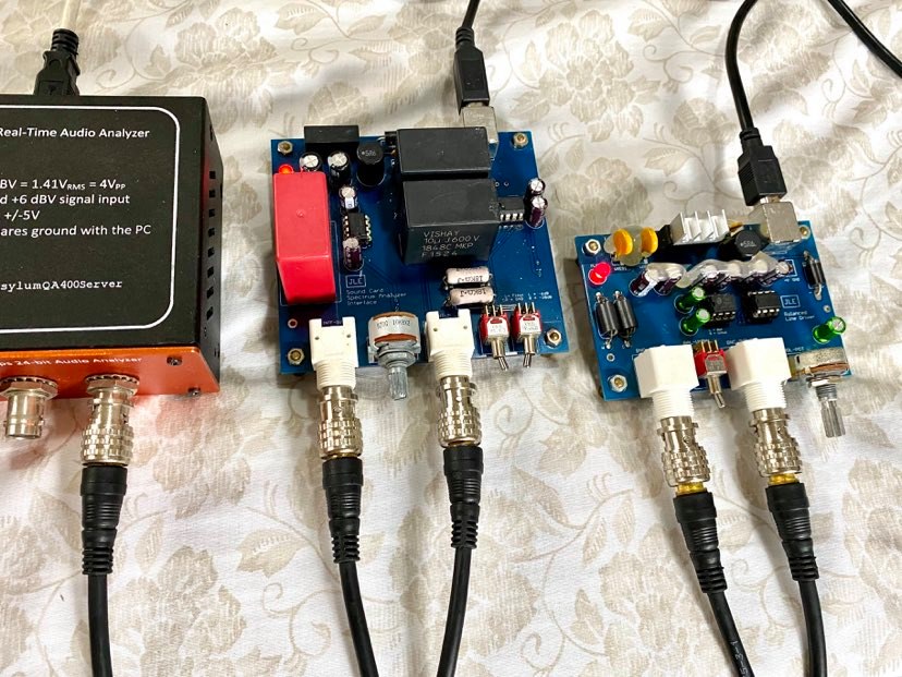

Attached QA400 measurements

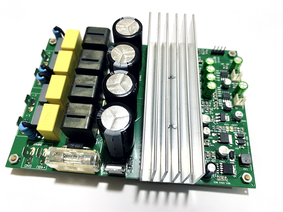

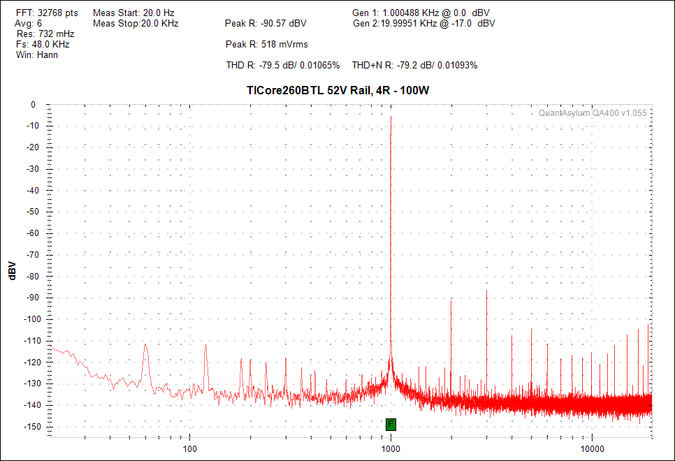

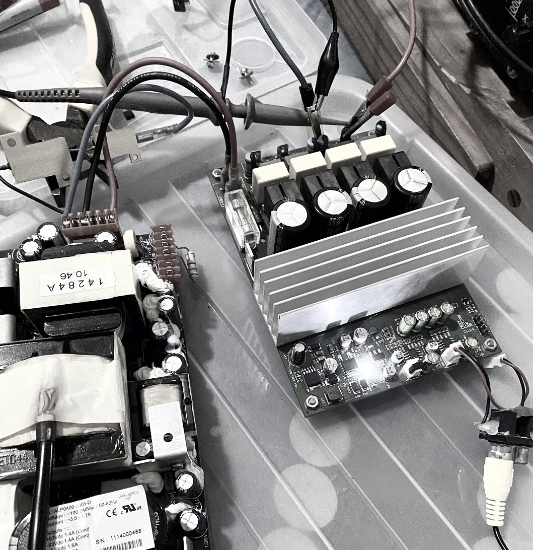

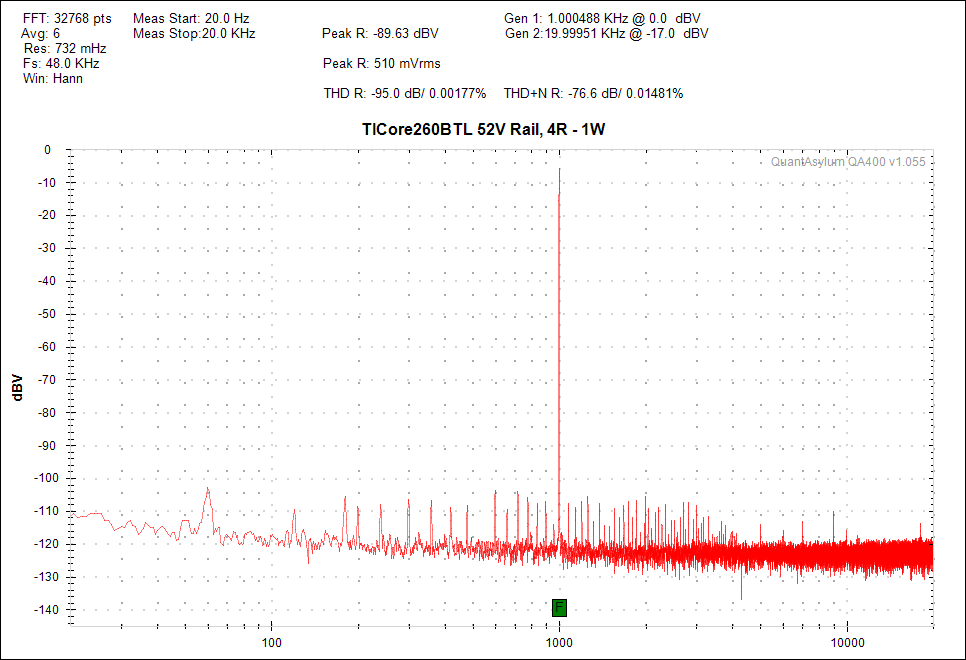

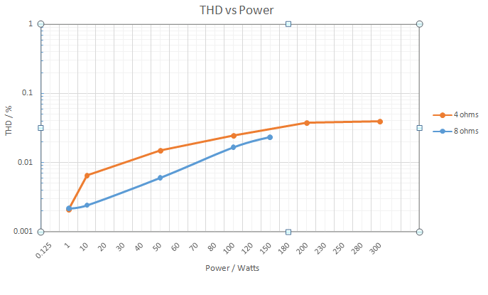

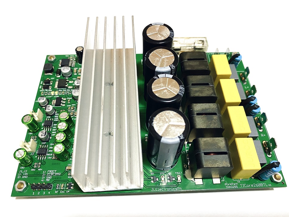

TPA3255 V1.0
TPA3255 TICore260BTL V1.0 QA400 measurements 1W to 100W 4 ohms load.

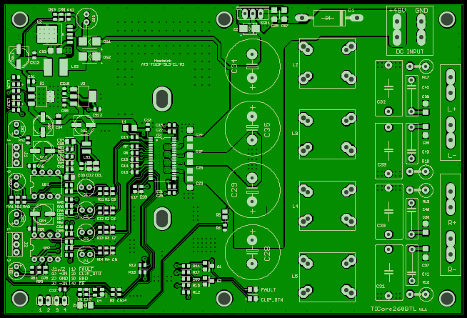

Production version (V1.1) has DIP IC's, balanced input, and has an option for upgrading inductors to a larger type (1D23A). Heatsink is also upgradable to ATS-TI10P-519-C1-R3

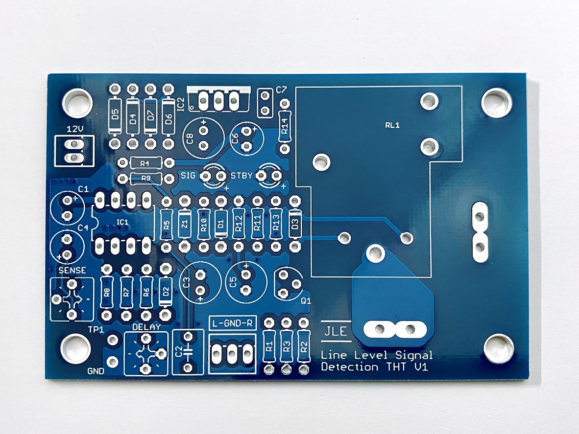

Line Level Signal Detect
Line Level Signal Detect available on my eBay shop.
Updated version. I changed all parts to through hole for easier assembly.

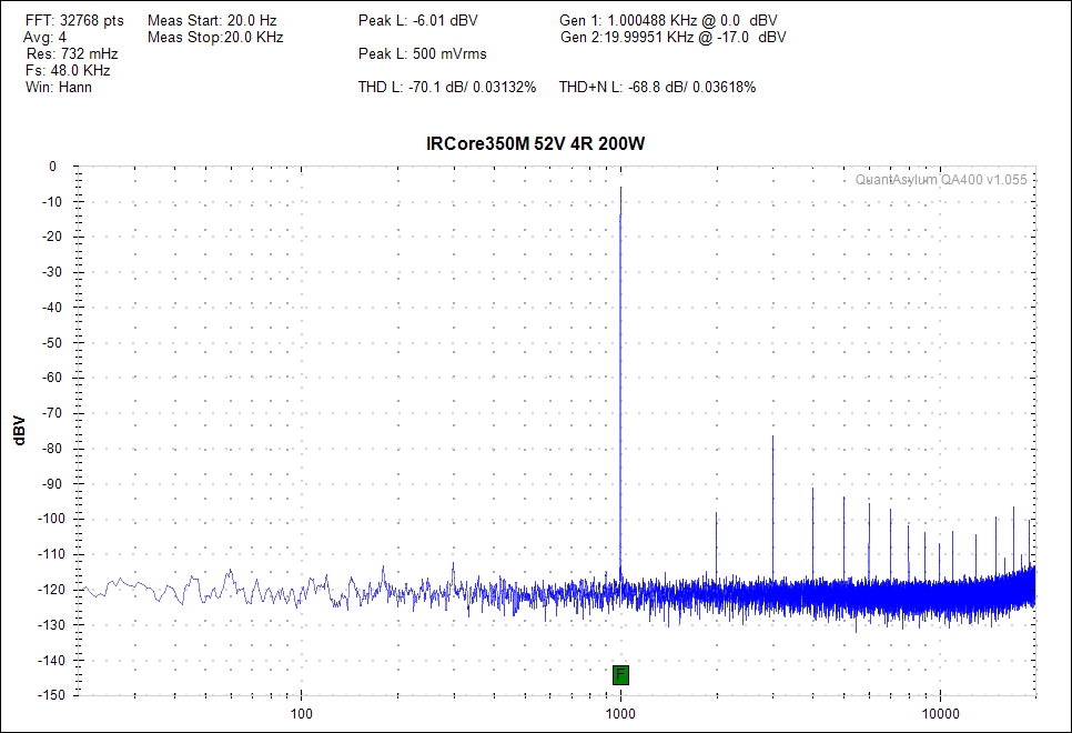

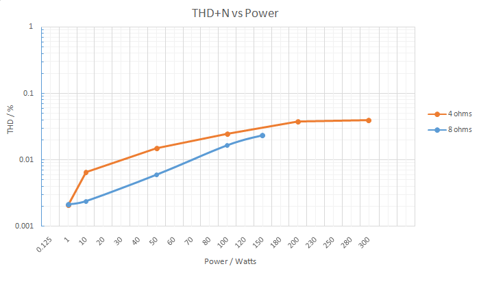

I tested the sound of my TPA3255 V1.0 prototype with my JBL 230 and it sounds very good even though it only uses NE5532 opamps.
After I listened on speakers, I retested it again on my QA400 and got better results, wiring change on my balanced interface affected the measurements.
200W measurement is worse than generic TPA3255 on QA401 blogs, I think the 1D17A inductor is the culprit. Using 1D23A will get better measurement on >100W power.
My TICore260BTL version 1.1 will be available in mid September. (attached snapshot of design)

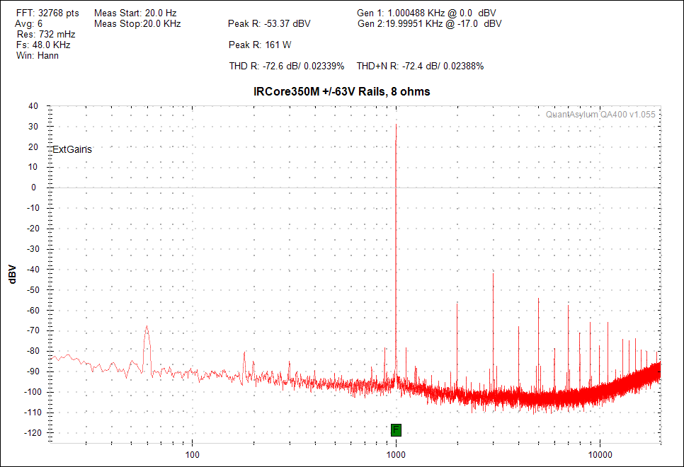

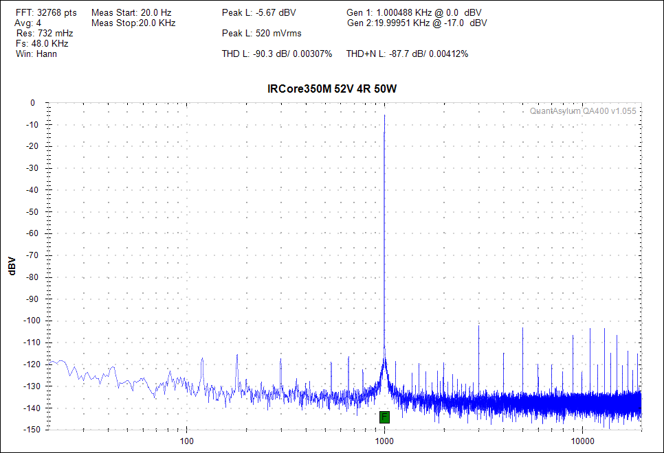

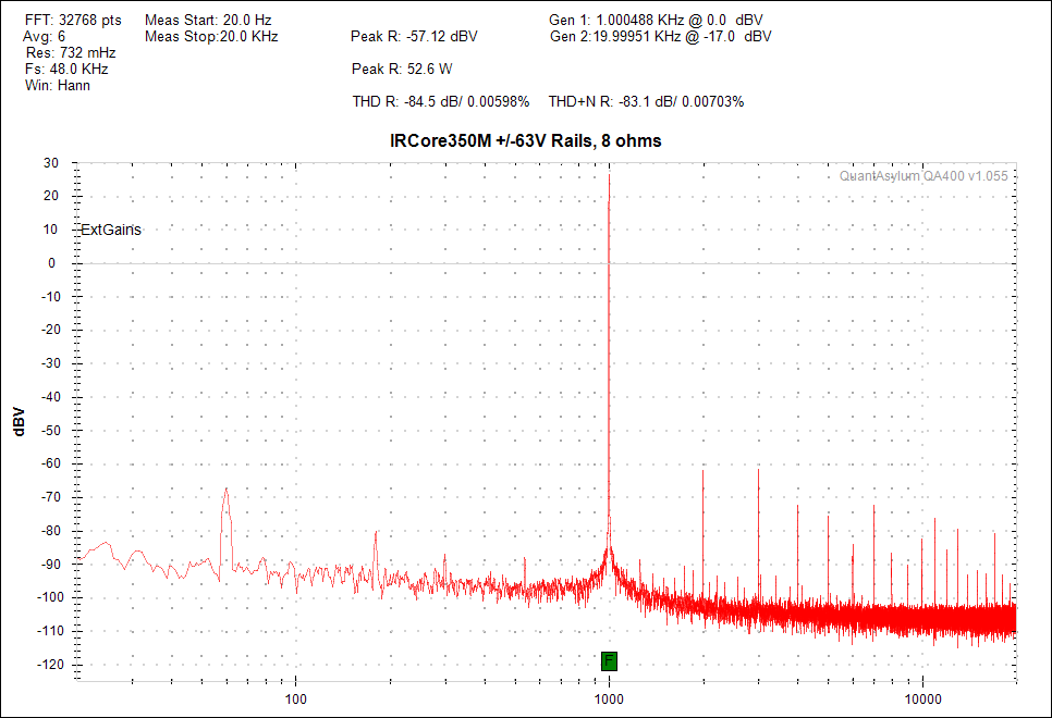

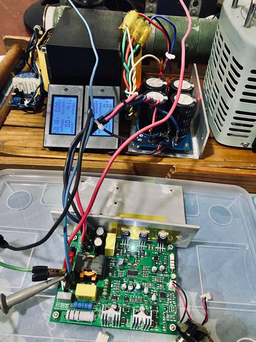

I haven't tried to listen to my IRCore350M but I already stress tested them. THD is on par with IRAUDAMP7 reference design and my amp is more powerful (0.05% THD+N on 350W 4ohms)
