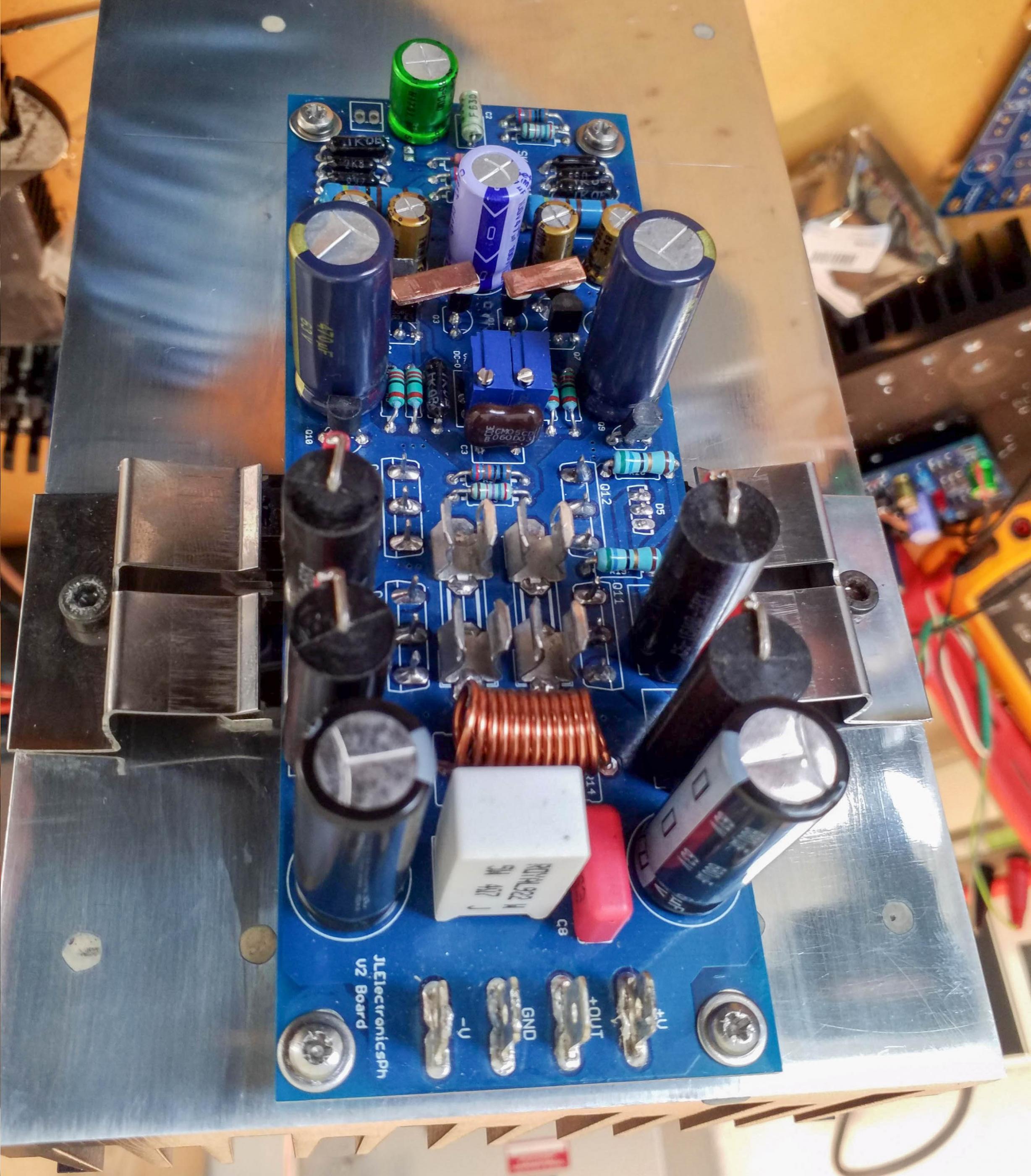

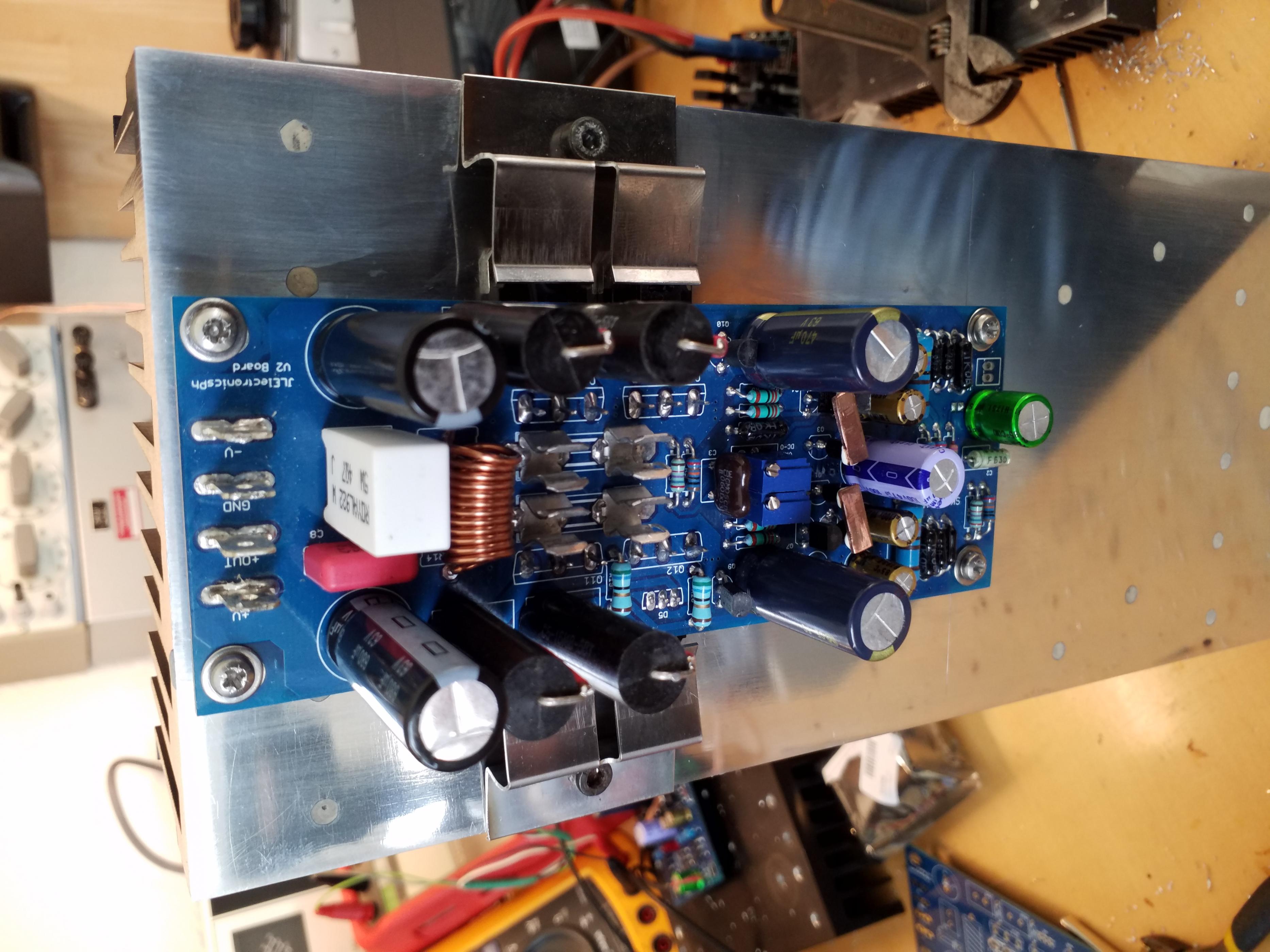

Started assembling the "simple killer amp" heatsink is from an old pa amp, there are two and they will be cut in half to accommodate 4 modules, outputs are mounted with spring clamps, I believe they do a better job than bolts, they apply constant pressure regardless of heat/cold, also a leftover from pa amp, a nice feeling putting it together..😉 will post the finished amps also, sure they will be a stunner, both visually and audio wise.
Wow nice build 😎
That's why I don't write product build guides anymore (only schem and BOM), because builders / DIYers have better ideas than mine 😱
I will try spring clamp on my build. Thanks!

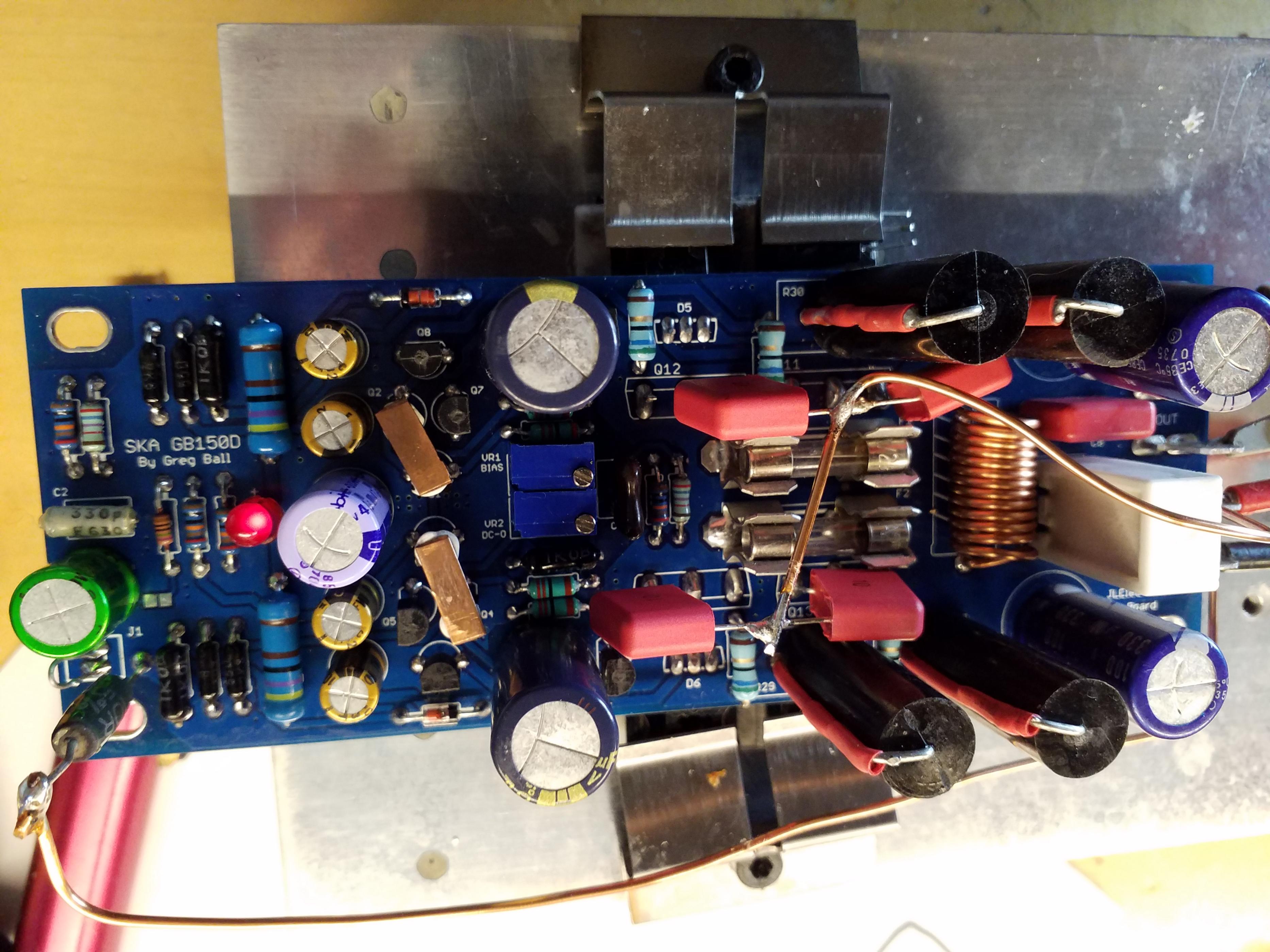

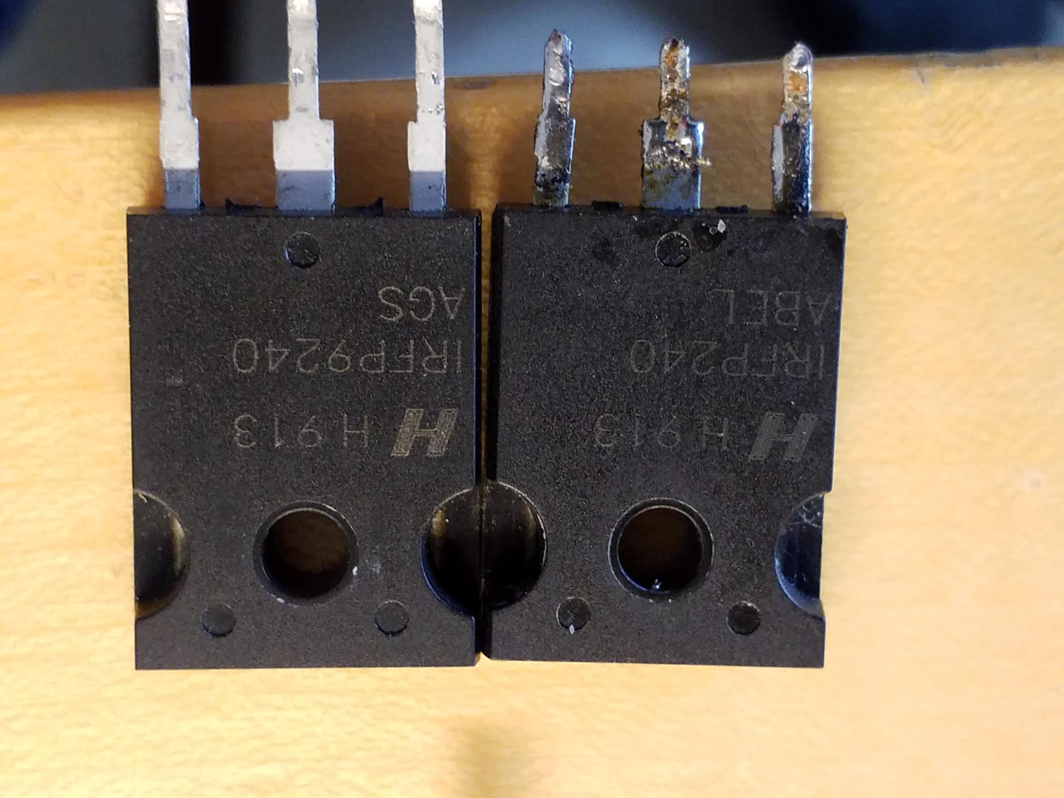

Headed into trouble again.
I recieved from you two boards more, and finished one yesterday, it is build from exact same parts as the other 4, except the output mosfet are from Harris intersil, still very close in vgs on.
My problem is again oscillation, and a stubborn one, it oscillate at 6 mhz, with shorted input and 8 ohm dummyload connected, I tried your suggestion with no connected ground solder point, instead a short wire from ground to 10 ohm resistor, didn't do anything, I suspect the n channel mosfet from harris have high gate charge and that might cause instability, the 6mhz oscillation increases as I increase bias, what to do? Gate/drain capacitor something to slow it down? I also checked the zobel, inductor/capacitor are okay, checked bad solder points, I put 100nf across large capacitors also with no change.
By the way I didn't have 47 ohm gate resistors so used 56 ohm, same as the other 4 which work.

Putting 100nf across large capacitors is not advisable as it can form resonance circuit which might trigger oscillations too. Please remove it.
To rule out PCB parasitics, put 100nf capacitor on source pin of each mosfet: Solder 1 pin of 100nf very close to source pin of mosfet, then connect the other pin of 100nf to ground (ground near amp output).
Also check bias with no load connected.

I figured the 100nf on capacitors was a bad idea, they are removed again cause they did nothing, I will try your suggestion tomorrow, I do have alot of small ferite beads could they help if put on gate pin.
I'll get back tomorrow, thanks for advice.

Okay.
I did as you said (see pics) and it's still oscillating, so we can rule out pcb parasitic, whats the next step?
Have you put tank capacitors near the terminals of the module? 2x6800uf is enough.

Yes 40000uf pr rail
Can you try ferrite bead in series of gate resistor?
