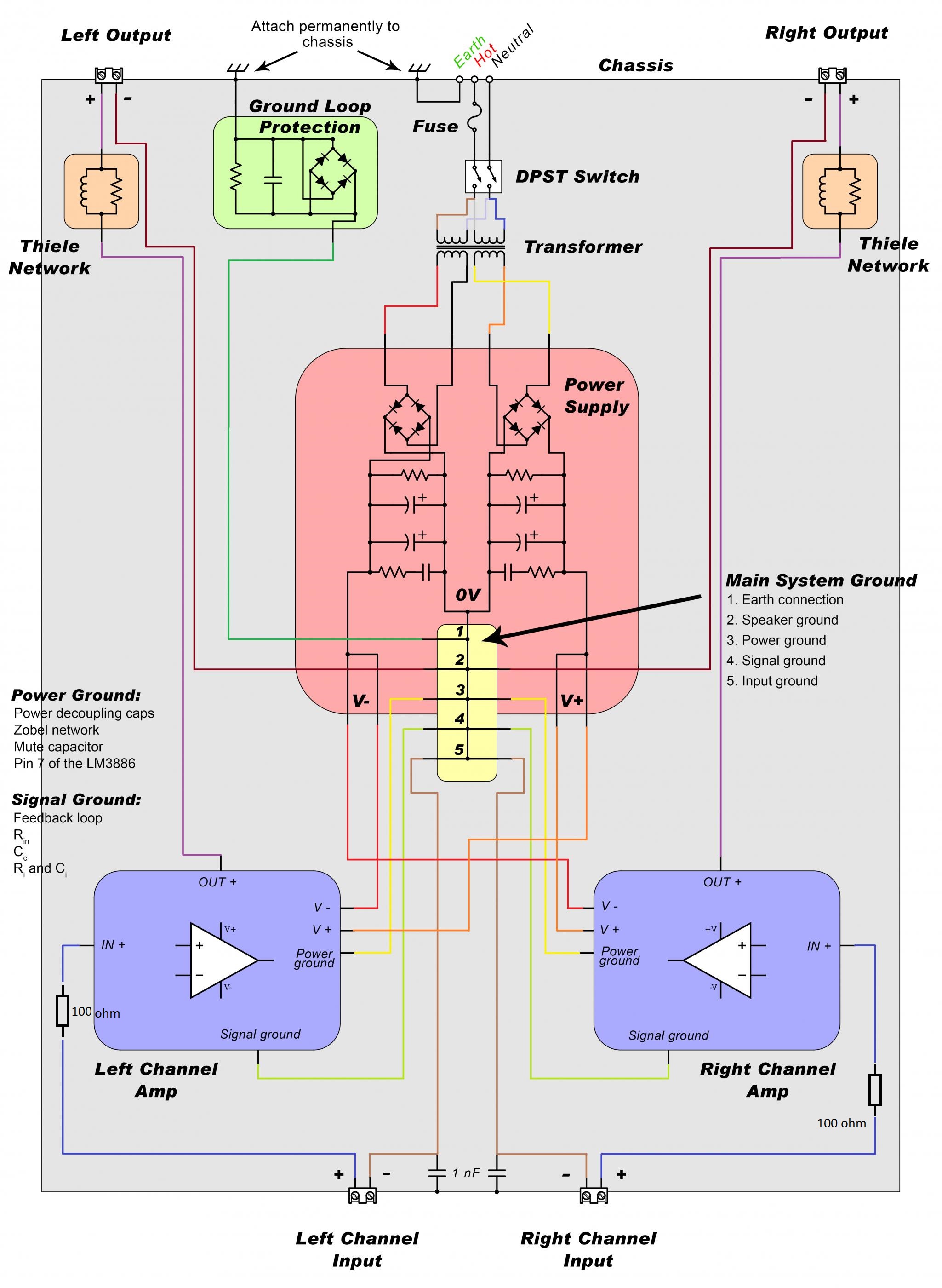

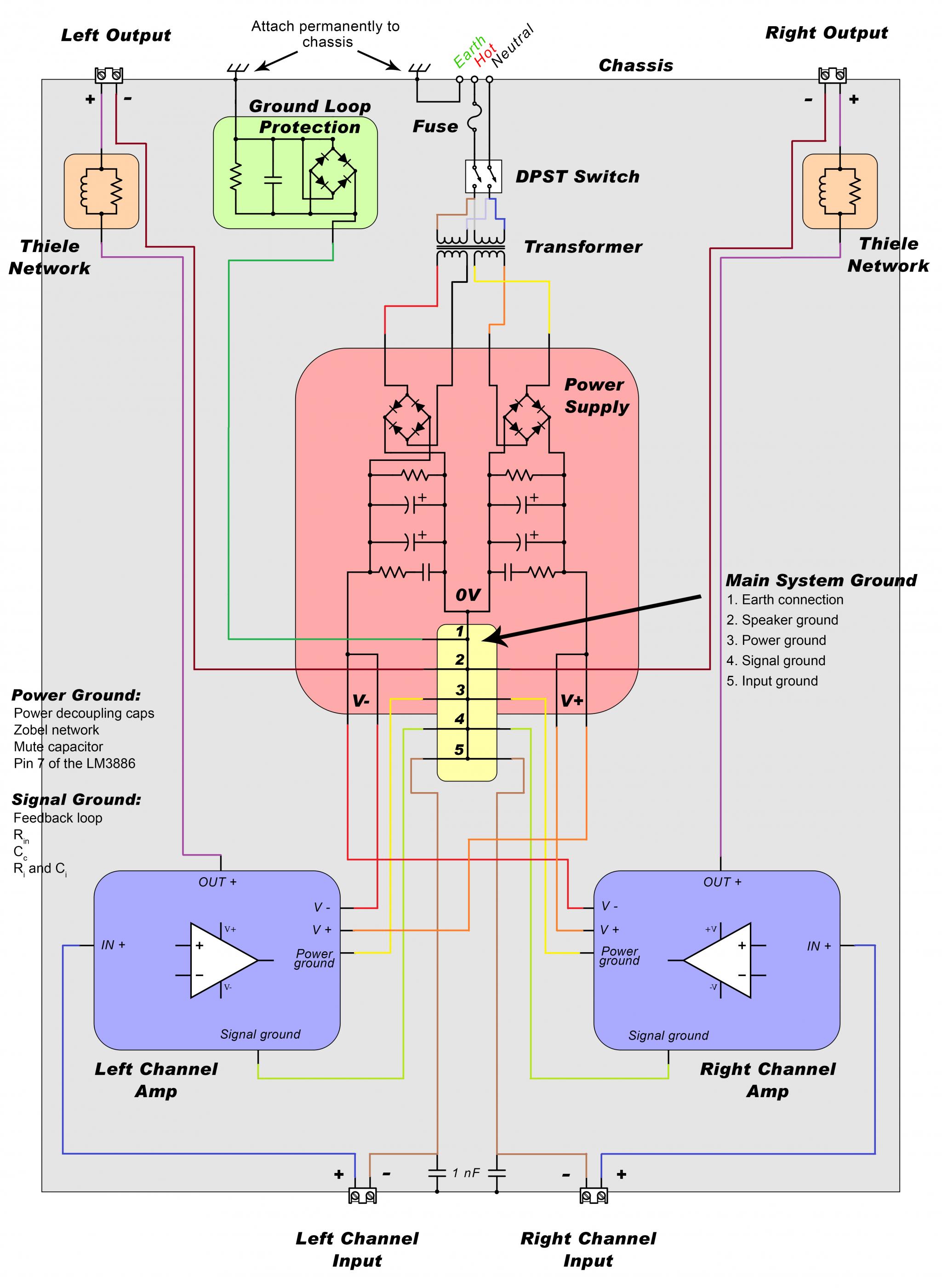

- You can use the grounding scheme attached (not mine, credits to the rightful owner)Hi lester, how are you ?

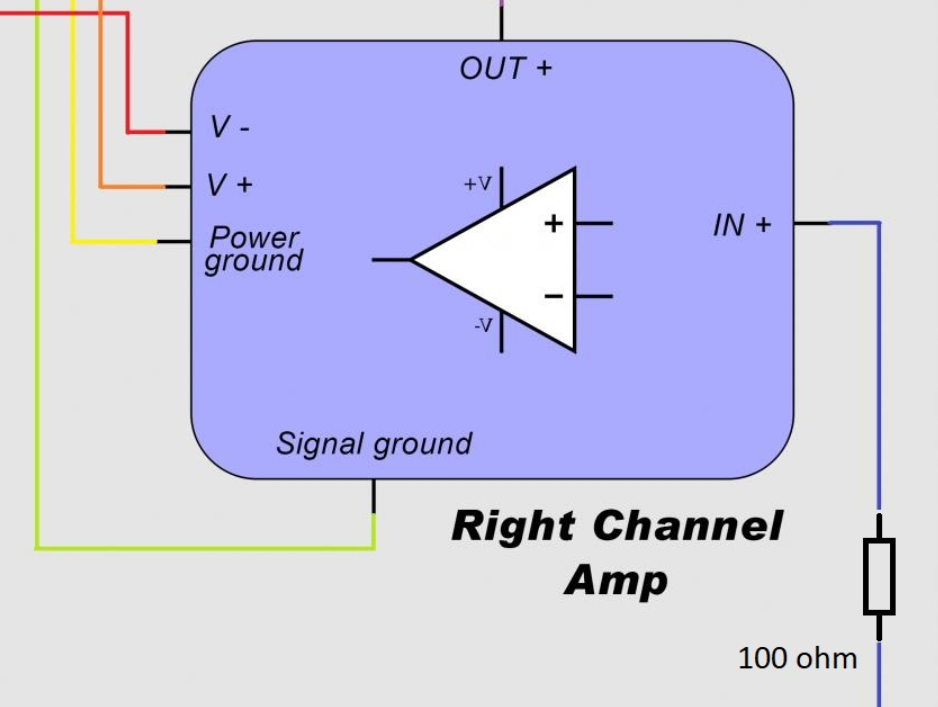

- Do not put a volume control on the JLE/JLA module's input. It requires low impedance input drive.
- Put the Volume control on the input of the buffer or preamp. (I do see some preamp designs which put the potentiometer at their very output with no follower which is not good for JLE/JLA modules, buffer is still needed if that is the case)
- You might have lots of gain on your system. You can lower the gain of JLE/JLA module by changing input resistor value.

I know this schema Lester... i already do this... and other configuration... no change.

Hi Alex, try these changes in order:
1. Change all low level signal wires to shielded cables / RCA cables.
2. Connect GND wire of JLE/JLA module to Speaker GND terminal.
3. Connect Speaker GND terminal to Main power supply GND
4. Use ground lift 10 ohms from source GND to JLE/JLA input GND.
5. Try to use different supply for speaker protection.

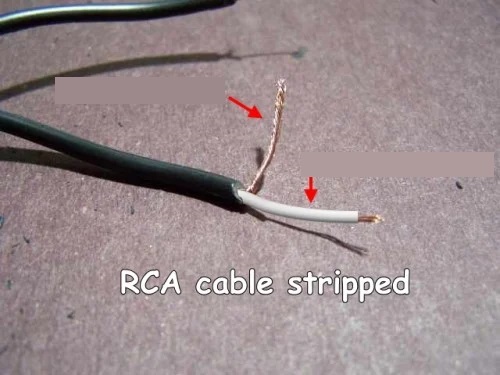

I also tried LJM L25D, shielded cable is a must otherwise there will be a hiss.
Also important that the GND of the module is referenced to speaker ground, then connect speaker ground to power supply ground.
Stripped RCA cable will suffice.

I already use RCA stripped cable (SC-Onyx 2025):
On my main system (Sure IRS2092)= no noise and on 5 channels JLA = noise
I have ordered some Sommercable Isopod SC-F22 100% screened and wire:
White on GND input
Green on + signal input
Screen on GND input...

You can fix it with correct wiring, use T-ground instead of star ground, use a strip of copper or PCB copper for connecting the grounds and with correct order (on attached pic) then on the input of JLA module, use a 100 ohm resistor (blue wire on attached pic)

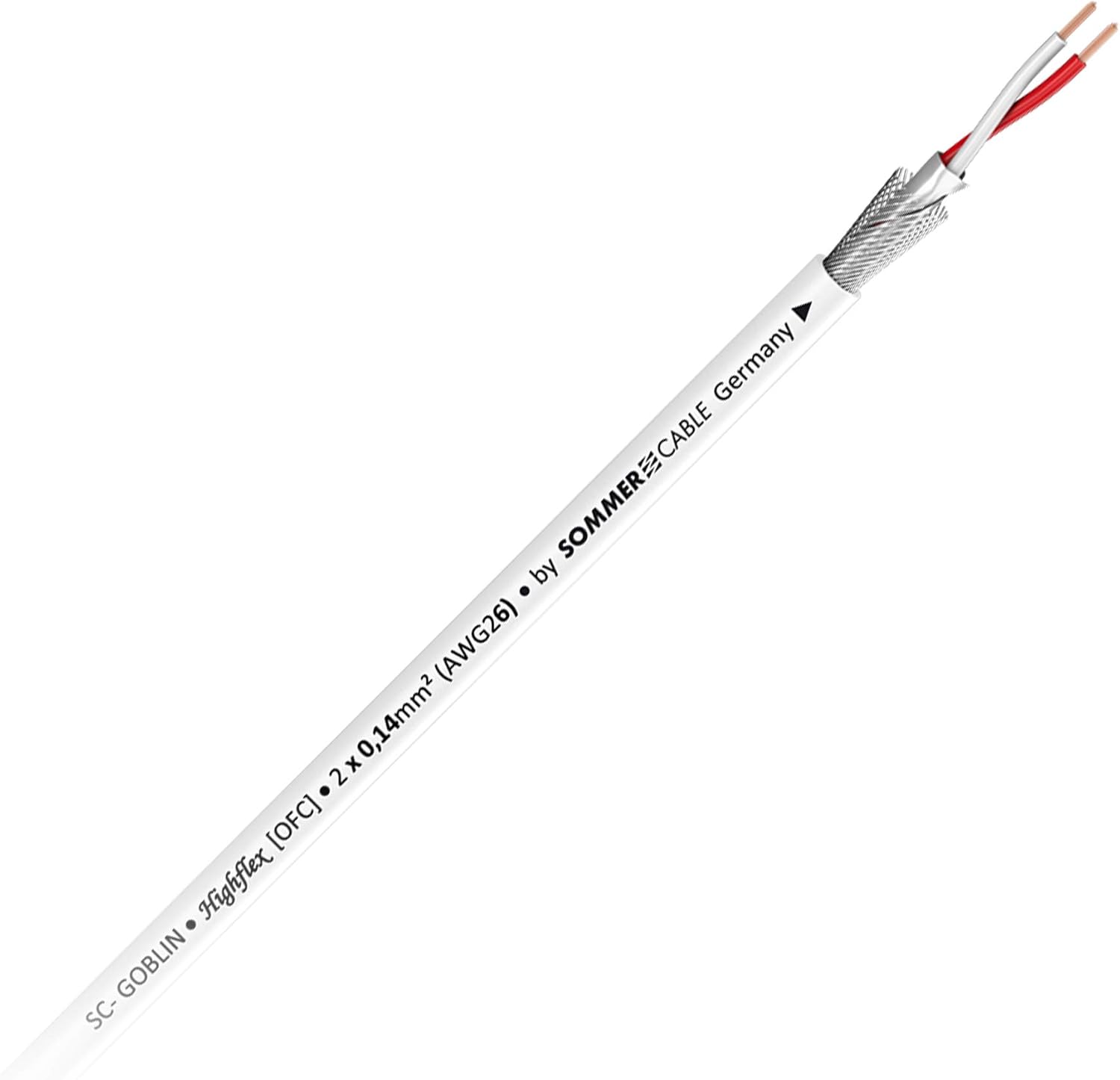

White on GND input
Try to disconnect white cable since it is for the - balanced signal.
No, that's the principle of total screened earth wiring to connect the - signal cable and the shield on the GND input:
The total earth wiring prevents current from flowing through the shielding braid. Thus, the electromagnetic disturbances blocked by the braid can in no case disturb the signal when these weak currents are discharged to ground.
What is the difference between T ground and Star ground ?
Ok for the resistor but in serial with input signal or in parallel between + and GND input ?

No, that's the principle of screened wiring to connect the - signal cable and the shield on the GND input:
Usually on unbalanced connections, single core wire is being used as the hot and the screen is being used as the return path / gnd signal.
For 2 core + screen cable, usually it is being used for balanced connections. Green and white core is for hot and cold while the shield is for ground.

Ok for the resistor but in serial with input signal or in parralel between + and GND input ?
use it in serial to + input. (see attached pic)
Your right, "usually" this is that... but this in a special case named "total ground cable"...

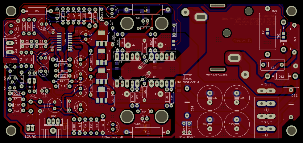

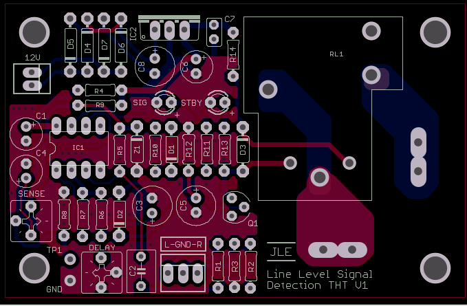

Upcoming updates on previous modules.
Line Level Signal Detection THT V1
Same functionality as before and same PCB size but through hole parts were used for easier assembly.
IRCore2000 V1.2
Changed gate buffer to more powerful zetex transistors FZT853 and FZT953
IRCore2000 V1.2

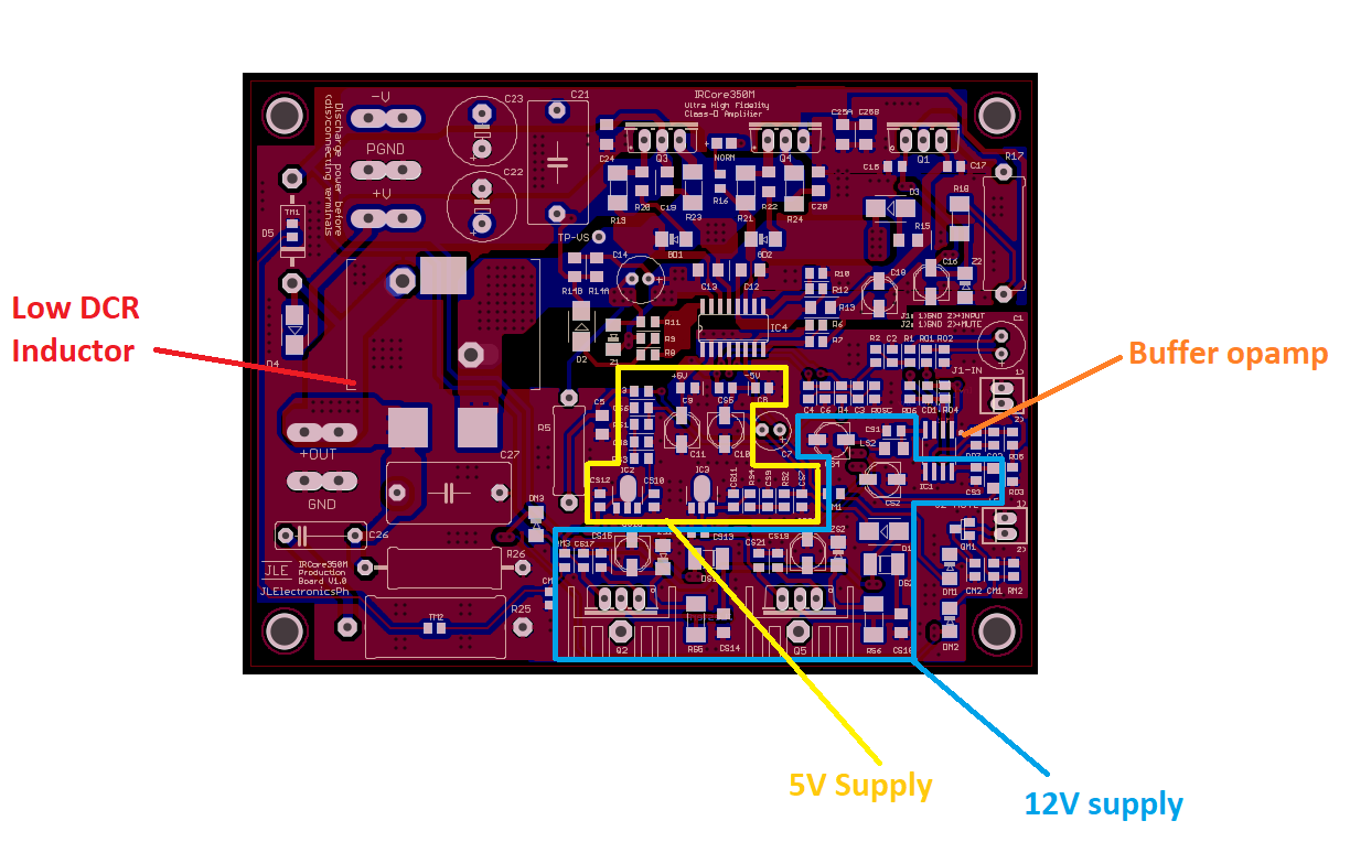

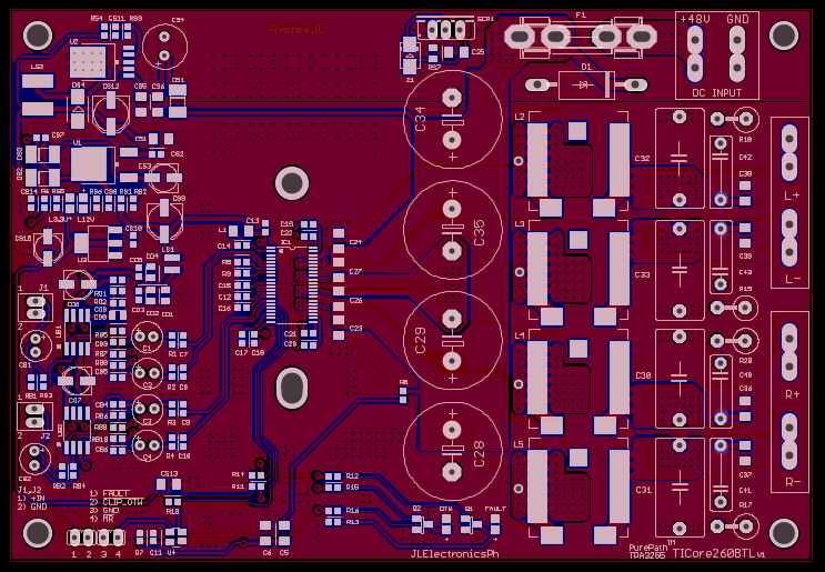

Upcoming amplifier modules next month.
IRCore350M - Audiophile Grade IRS2092 Amp
TICore260BTL - TPA3255 Fixed Stereo BTL Amp
They will be available on my eBay page soon. 🙂
- All housekeeping supplies are linear regulators.
- LDO regulators with 2 stage noise filter were used on 5V analog supplies of IRS2092.
- Compatible with low DCR (2.5 mOhm) inductors from coilcraft or bourns.
- Infineon optimos for output mosfets.
- Onboard buffer is included with selectable inverting/non-inverting jumper (for bridging 2 modules)
- Open collector mute input.
- XL7015 / LM2576HV 150kHz switching regulator for 15V Supply
- Properly implemented LM317 for 12V supply
- Voltage supervisor for reset control and zero turn-on/off pops or clicks.
- Single ended input NE5532 buffer and nichicon muse input capacitors.
- SCR + TVS + Fuse for overvoltage / transient protection
- Overkill zobel network
- 18mm diameter tank capacitors.

To reduce complexity, we only set the mode to stereo BTL configuration. Then SE input, and master mode, so no complicated jumpers for the user.Great news Lester !

For the opamp buffer, default IC soldered is NE5532, but the PCB trace is compatible with DMP8 and SOIC-8 package so you can upgrade it to OPA1656 and other dual opamp ICs.. you just need hot air soldering tool to replace it.
In the future maybe we will release a version with premium 12V regulator. For now the choice is LM317 to reduce the price to 68USD + 24USD shipping.
The IRcore350M is the new version of JLE-800s your promised for 2020 ?
Yes, IRCore350M is our latest IRS2092 amp, max voltage is +/-60V. Aside from other improvements mentioned, we've placed a switching noise filter on feedback for better THD performance. It will be priced to 46USD + 15USD Shipping.

For the TPA3255 wich inductor can you put ?... i don't recognize the PCB trace... the TPA is very infuenced by the output inductor (like IRS2092 and all classD), see the measurement of 360customs:
Best one is wurth 7443630 7µH but he don't test the Coilcraft AGP2900 or SER2900...
