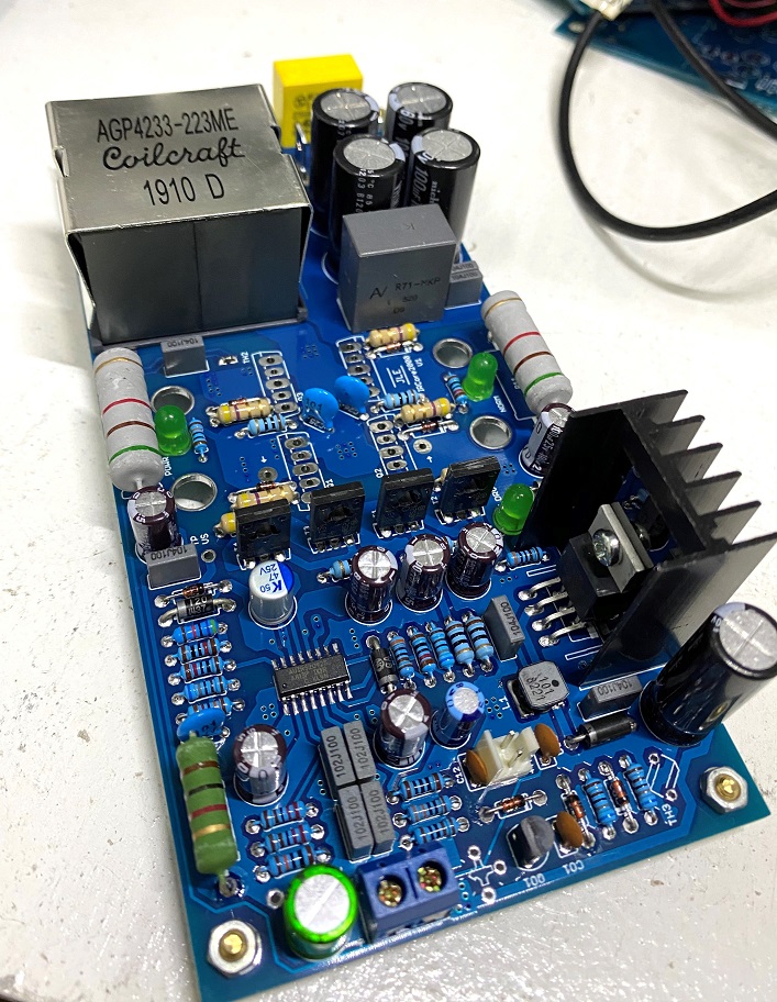

It's alive
Finished one channel of your amp and it runs perfect, no audible hiss on my JBL tweeters,
So I'm off to drill heatsink and get some real power, and some measurements.

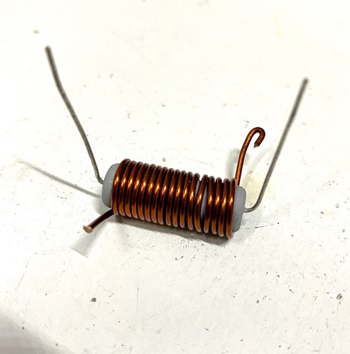

I will find more suitable power resistors to, project was cheap, I had some irs2092 chips, and I made a sample request at coilcraft, and they send me these nice inductors for free, so if you're building jle amp, it might be an idea for a free sample request for inductor

Nice work, For soldering IRS2092S you need liquid flux + solder wick for better SMT pad solder contacts.
Yes that would have made it much easier, I used what I had, but had pressure on the chip to ensure good contact, I will need to invest in tools for surface mount I guess.

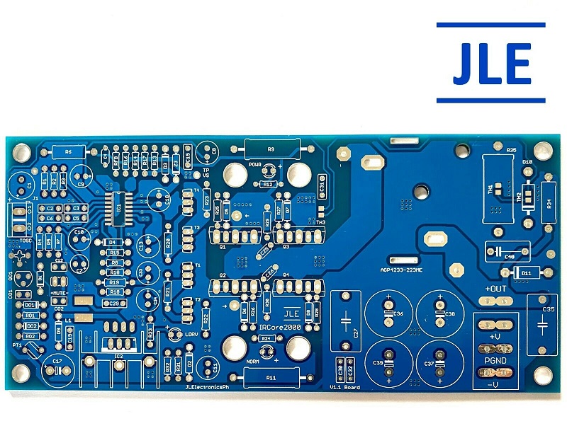

IRCore2000 V1.1 Blank PCB now available
Now available on my eBay Merch
2pcs Blank PCB: IRCore2000 V1.1 Class-D Amplifier PCB | eBay

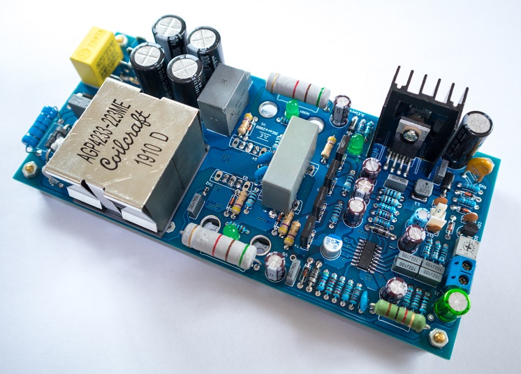

Great success
Got the pcb with premounted smd, thanks lester, one board running, but struggled alot with heatsink on totempole drivers, had to saw and grind, is there any heatsink that's plug and play?, you think surface is sufficient for high power continuous? Heatsink is 40mm by 40, with a few fins removed

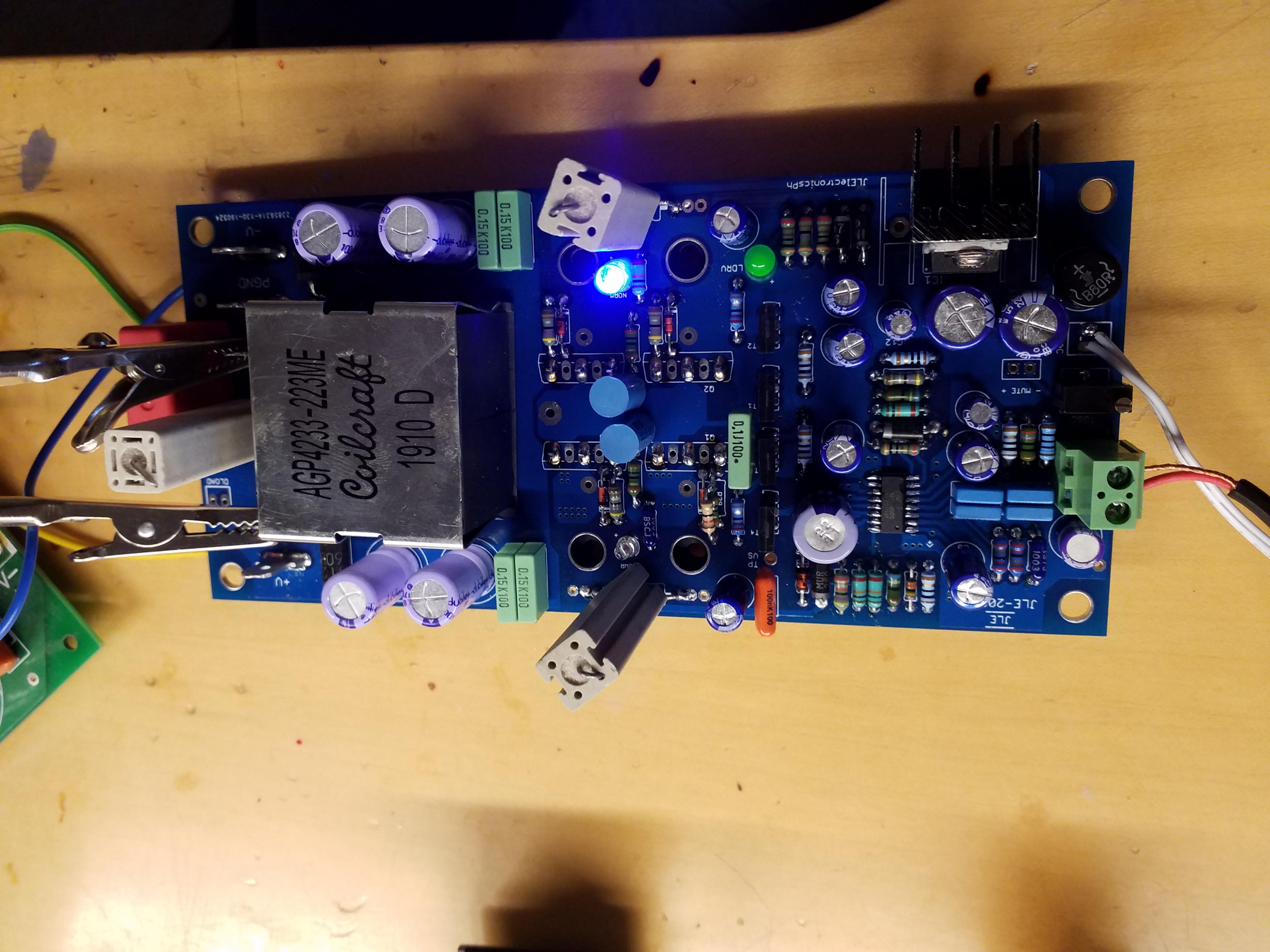

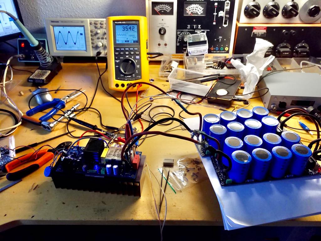

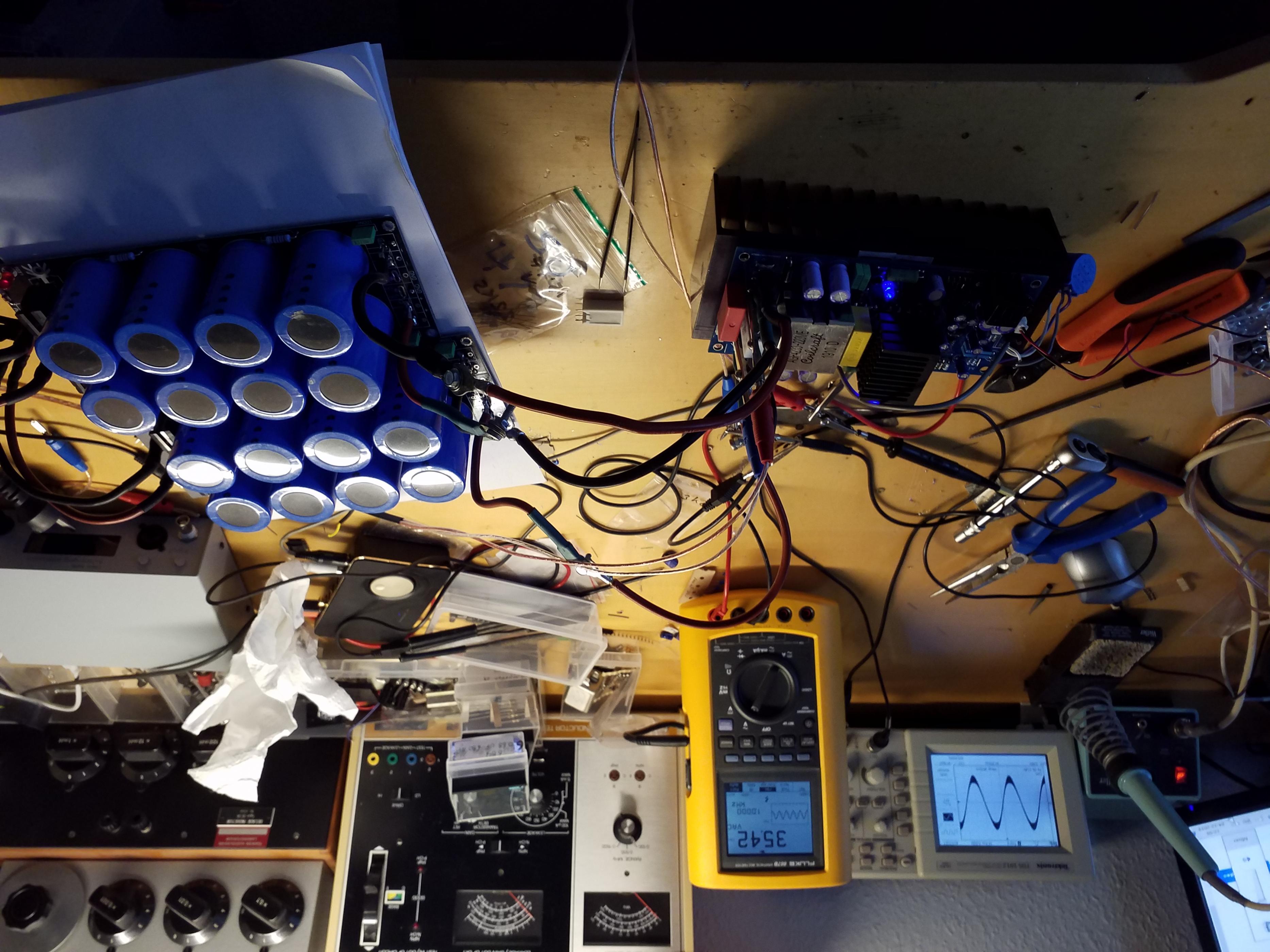

Hi again.
A have today tried and power test the 2000-d module, it is hooked up to a 1.2kw 45v, 65 volt dc, 160000uf, dummy load is 8 ohm, 1khz.
My question is as you see in pic if I raise volume beyond 36v arms output, the wave flattens out like its hitting rail voltage, why is that happening ?? Output in 8 ohm is 150w
Tried putting scope in average mode and found out it was the 300khz carrier wave interfering, was able to get 41v clean since, above that it started some clipping.
A 40mm x 20mm copper or aluminum plate is sufficient, no need for finned heatsink. I will update BOM with suitable part number but we still have to drill holes.
What is the rail voltage at clipping point?
Yes carrier residual is still present because there are no onboard filters to remove it. You can put additional filters on a breadboard, I'll update the build guide. Thanks!

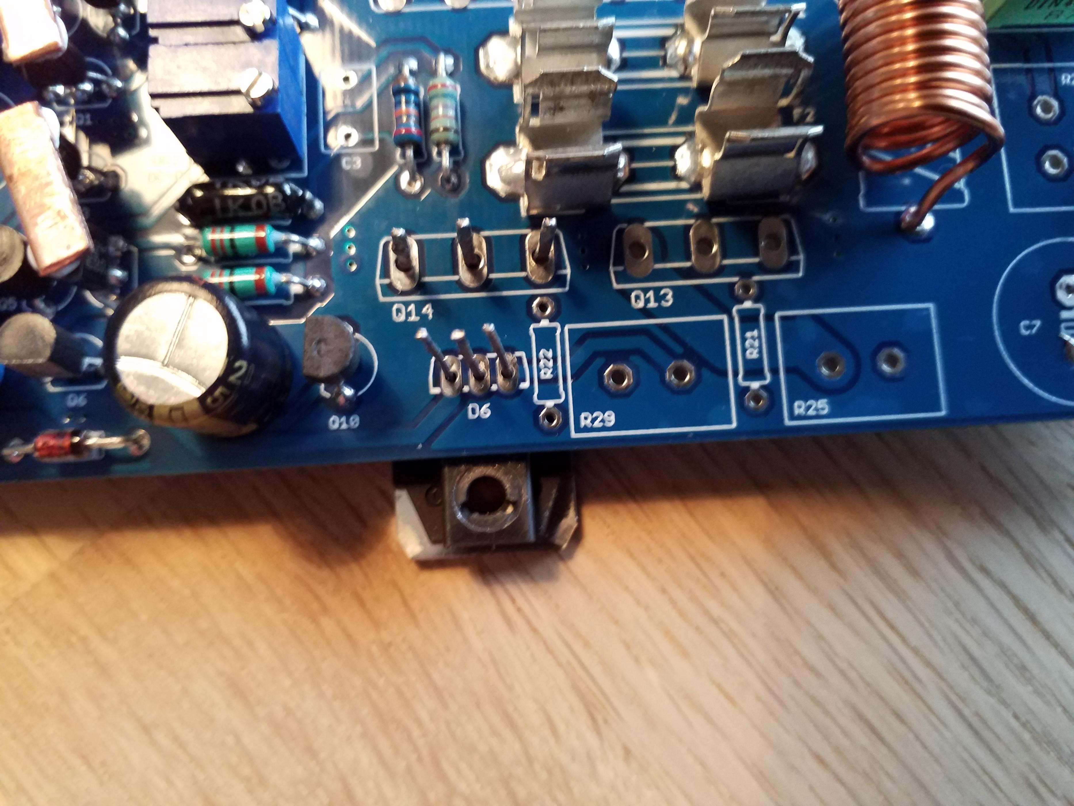

Hi Lester,
How do you mount the Mosfets with your version of the GB150D? Using wires, or flat under the board? I note the original had the Mosfets near the edge of the board.
How does it perform on the scope? I remember Bigun from this forum had issues with stability when he made his version of this amp.

Hi.
I answered the same question and got this response, they are mounted flat under the board, sticking out the sides, the bd139/140 go on top of the mosfet.
As to stability I don't know, I'm waiting for boards, but am pretty sure they are stable

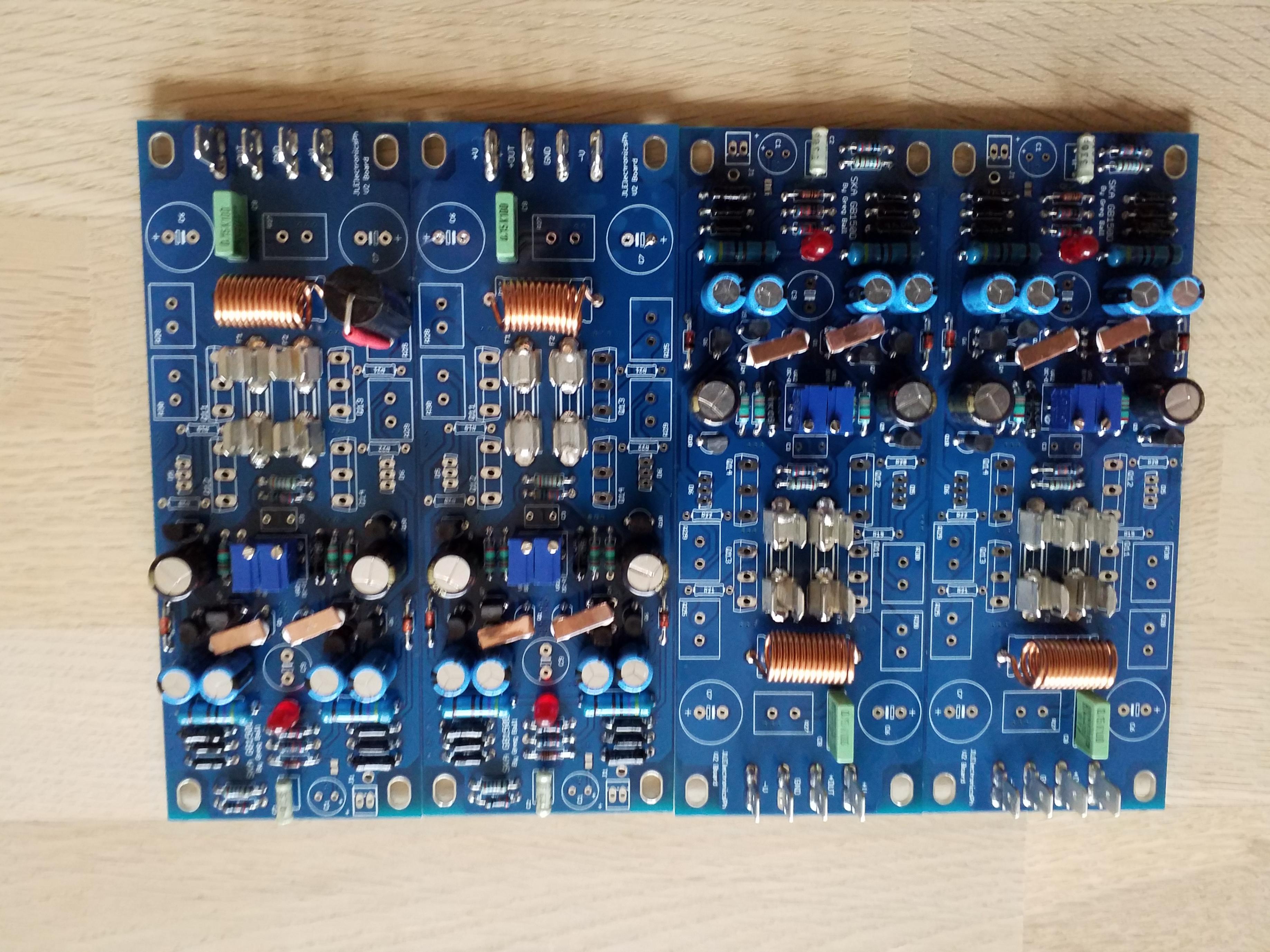

A quick question jlester.
It's regarding the greg ball amplifier.
I have four 300 watt toroidal transformers , and label says 36 volt on secondary, that adds up to the 50 volt dc the amp needs, all fine, except the transformers are old and back then our grid was 220 volt, so I measured them at current 230v grid unloaded, and they deliver +/÷56 volt dc, can the ska150 handle the extra voltage?
Thomas
Thomas

Hi.
Yes that's how it is mounted, very well explained 🙂
Regarding scope / thd measurements, yes it's stable, I'll publish them soon. I got busy with TPA3255 lately.

SKA GB150D can handle it but you can only use it for 8 ohms speakers.
Output stage of this amp is not designed for more than 150W at 4 ohms.
For home use / casual listening, 4 ohms is fine. But for party level volume / RMS output measurements, it's not advisable.
Great news, no need to spend money on other psu, my speakers are 8 ohm and 100db sensitivity. So ska150 is plenty power.

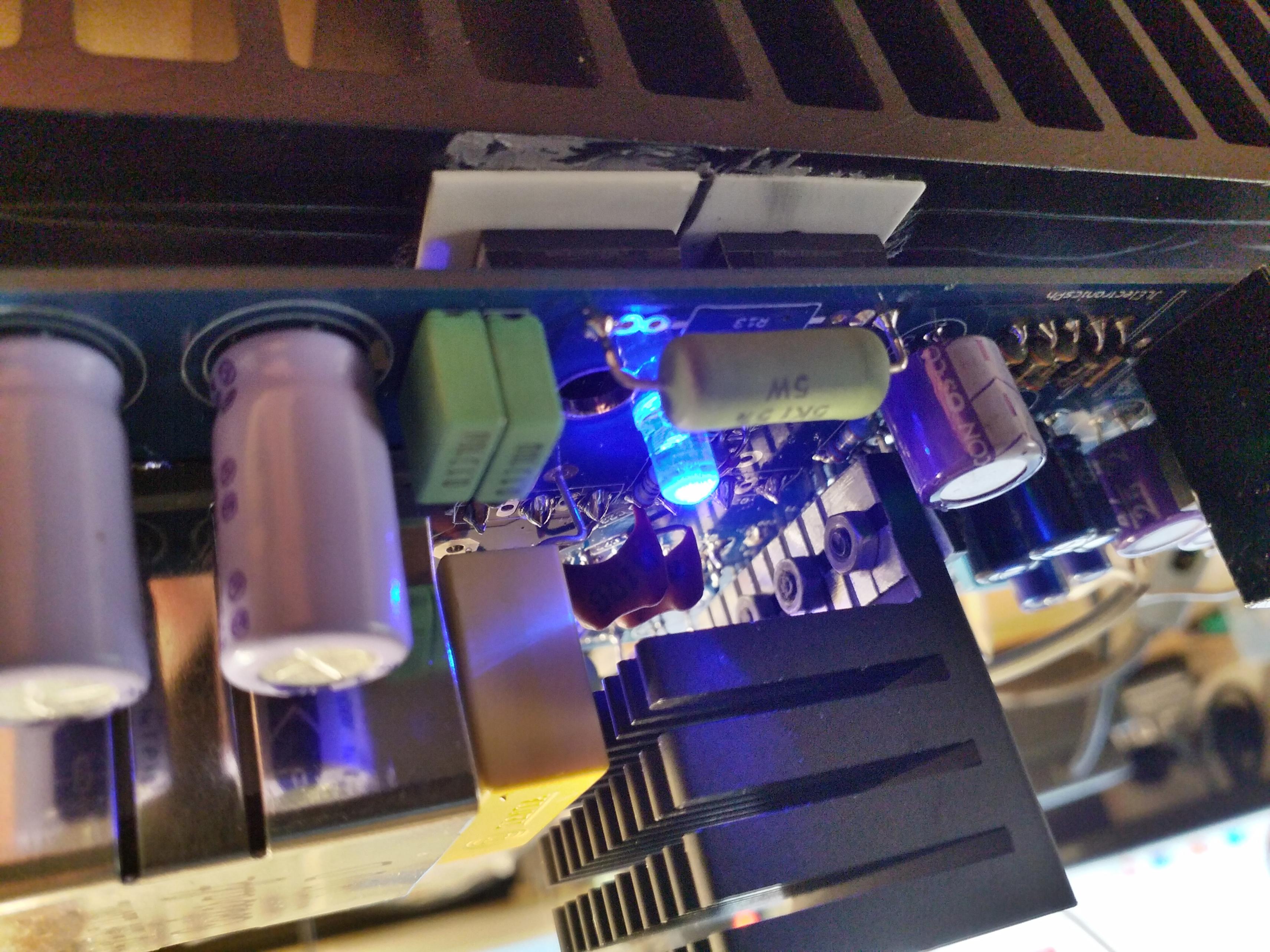

Photos often say more, i glued copperbar on top of the matched bc546c bc556c to thermally stabilize them, in case you were wondering.Hi Lester,

Nice idea about the copper bar.

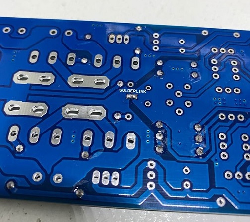

Also don't forget to put solder blob on solder link under the PCB. (attached picture) And put parallel 10 ohms with the output inductor.
Looks like your mosfet has a different package? or is it just a dummy?
I separated the power ground plane from input ground plane so that I can experiment with it.
