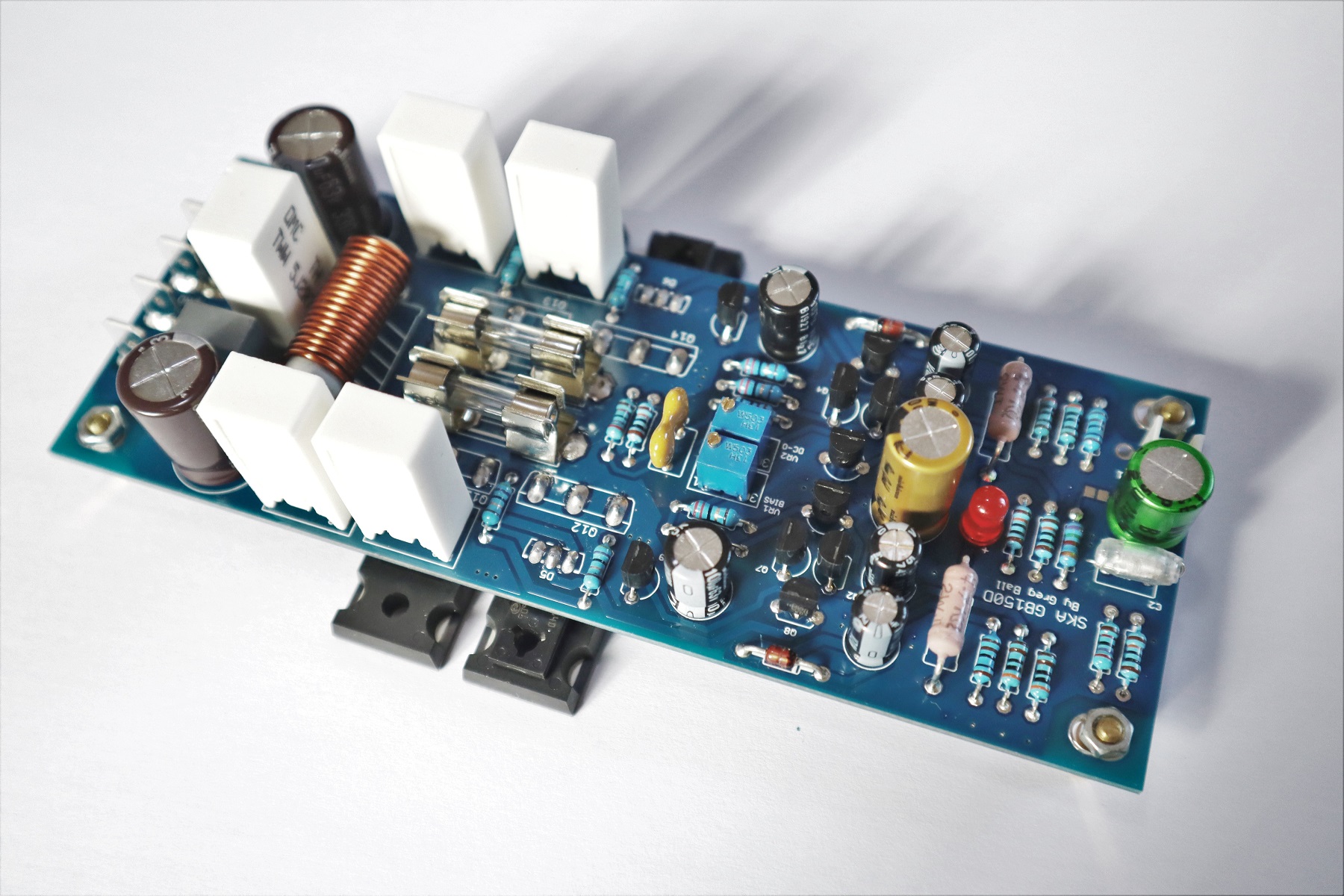

I've been fiddling with the four ska150 boards, 3 of them work excellent, the last is a mystery, I can adjust bias up until 20Ma, beyond that bias goes haywire jumping from 1 to 1.5 amps, I checked that all parts are correct, functioning, and rotated correctly, the I checked every single solder, as far as I can tell, they are all good.
I am able to adjust the dc to almost perfect zero,
It must be the bd139/140 with the current sources that are bad, I just can't figure it out, any good advice?

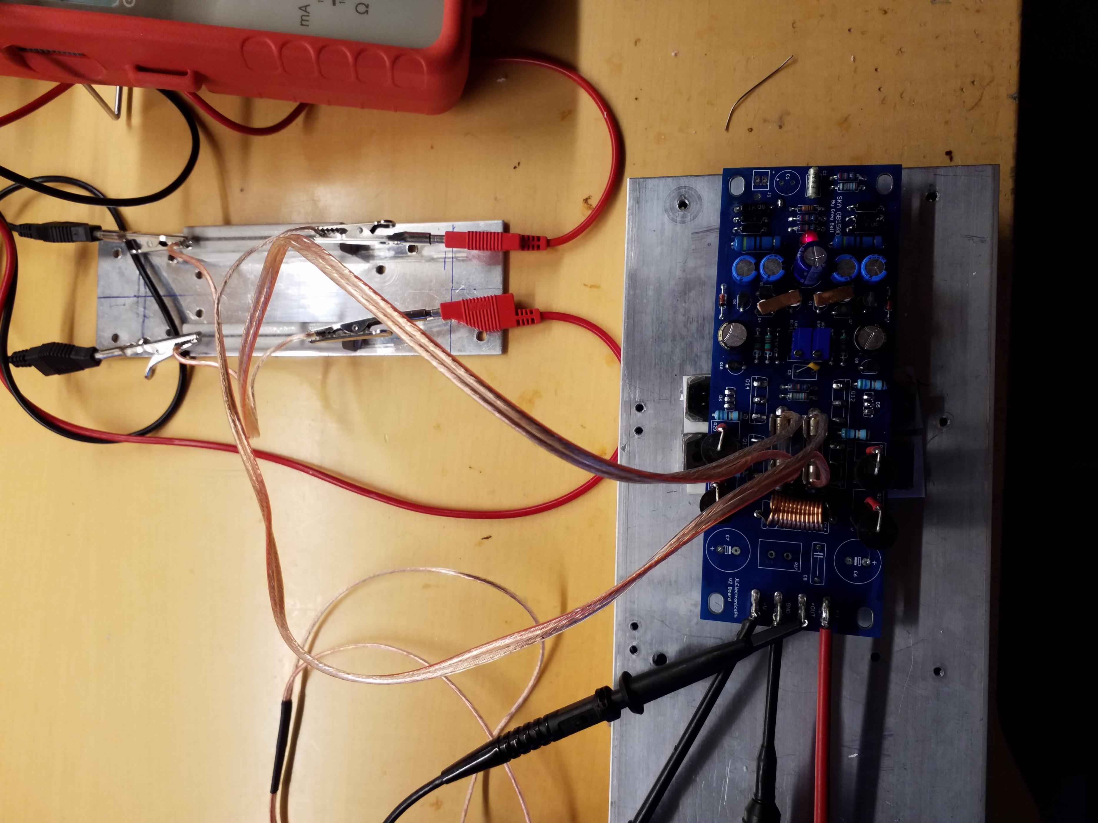

Can you share a picture on how the wiring was done while you measure the bias, is it connected to source and speakers? Did you use ground lift and have you replaced any part's values?, some parts might be out of spec.
Also please resolder the solderlink part under the board.
Tighten the fuse on the holder. Might be some loose connections, like power supply, etc..

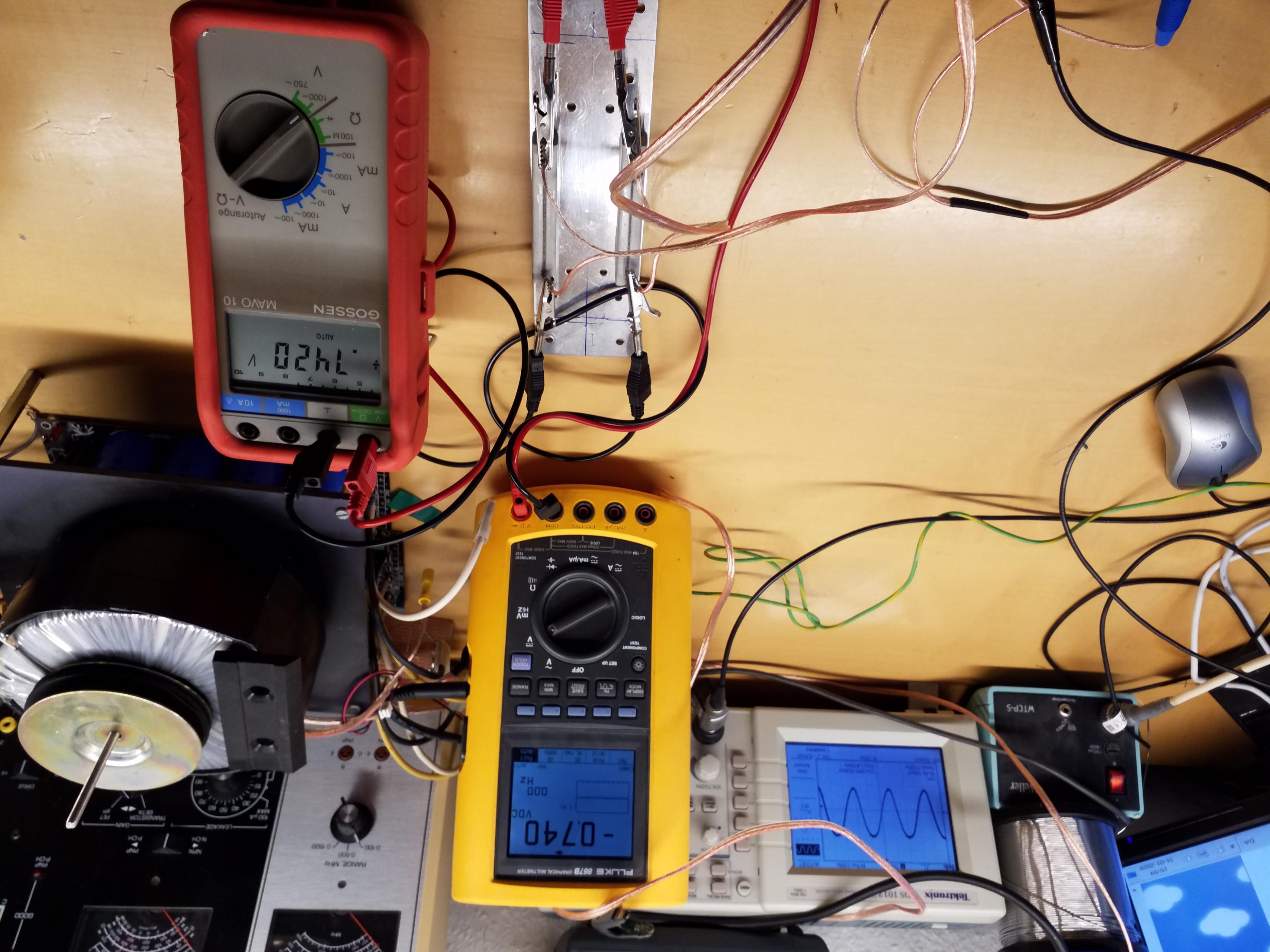

Here's what I've been doing.
The boards are not complete I'm awaiting capacitors this week, the components missing are c8 on zobel. c6-c7.c1 bipolar .c3 6pf ( now its running with a 10pf). C9 ( now running with 50v 100uf) .
The only parts that are not within spec are the r15 to r18, they are supposed to be 3k mine are 2k8.
I'm testing it from two series connected lab supply at +/÷ 25 volt.
I'm measuring bias through the two fuses, the fuses are blown and each is wired to a 250 ohm dummy resistor, the two Dmm are measuring the voltage drop on each resistor.

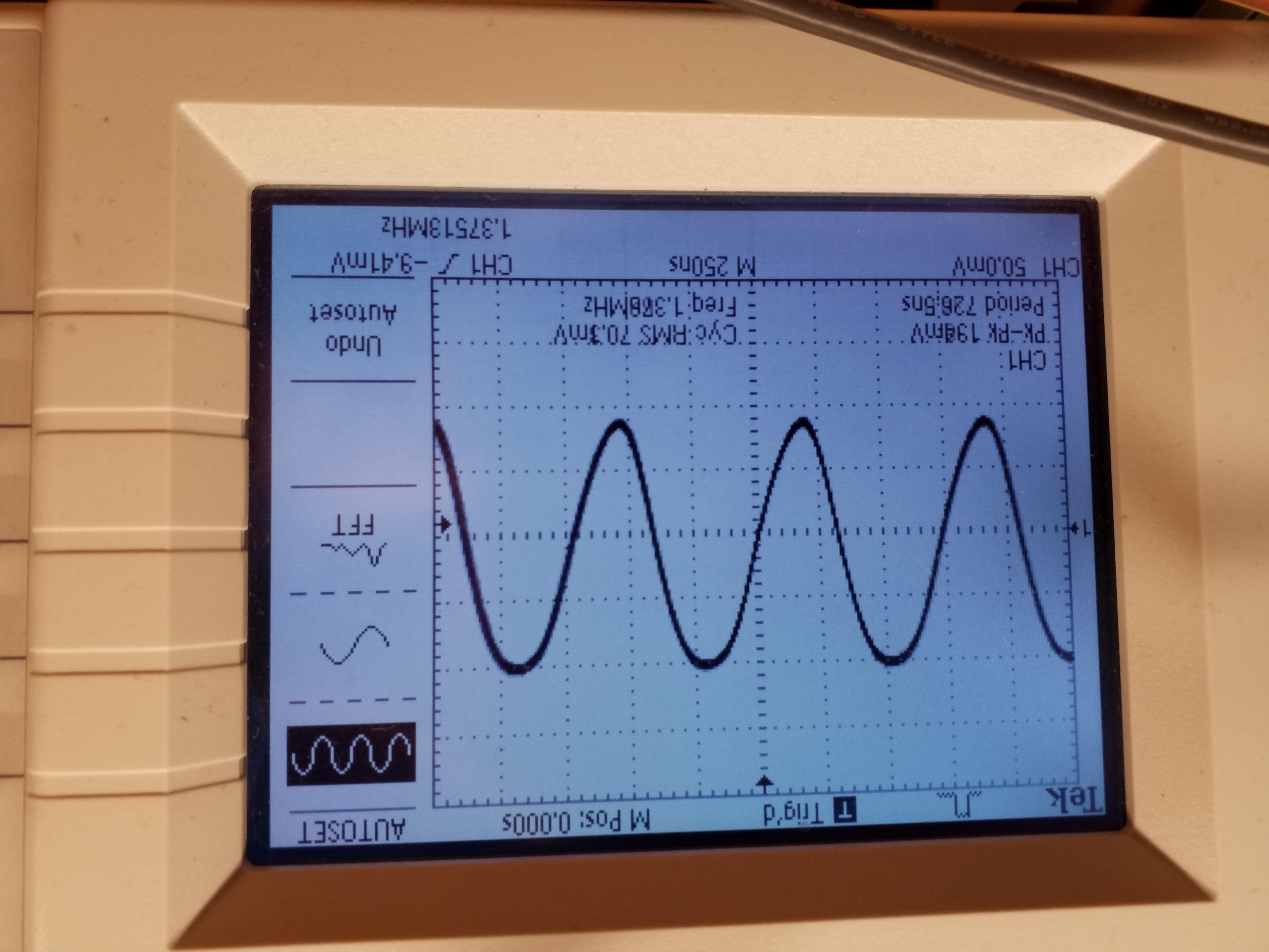

Today I hooked up the scope and did read oscillations 1.2 mhz.
If I try increase bias so the dmm read 1 volt drop it suddenly becomes unstable and the full rail voltage comes across resistors.
If this because missing parts? Or am I doing something wrong? I suppose the modules are able to run of 25 volt

I see, let's wait for the tank capacitors and zobel. Then check again.
Tank caps placed near the mosfets help a lot since you are using long wires to connect the module to the power supply.
Also instead of long wires, just solder a 10 ohm 3w resistor on each blown fuse, make sure the connection of each fuse to the fuse holder is tight.
Then adjust bias without input and speakers attached.

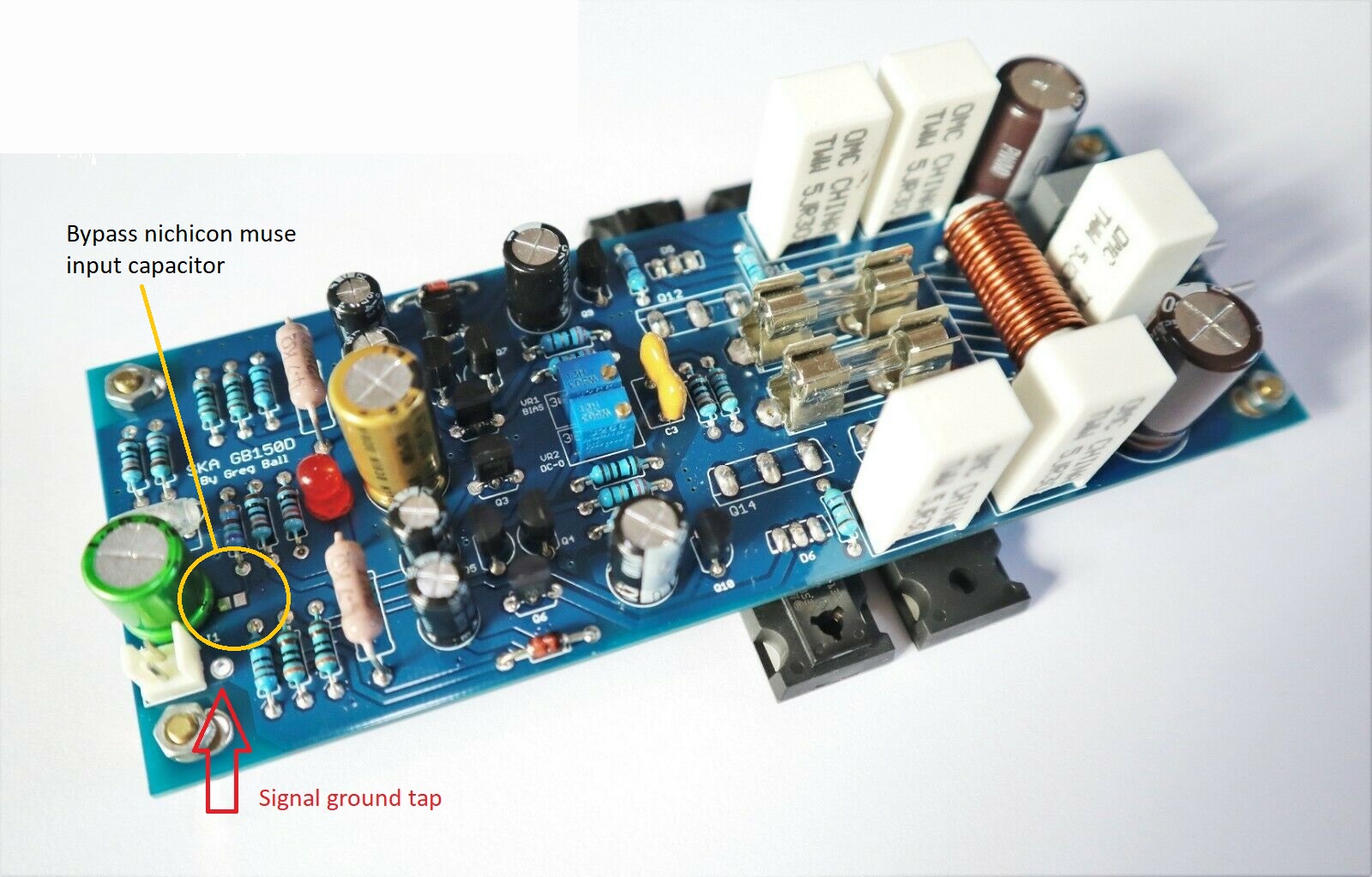

Attached my build, I used nichicon caps all throughout, fine gold on bootstrap cap and muse on input cap. Will gonna replace the zobel cap soon with wima 10mm pitch 100nf.

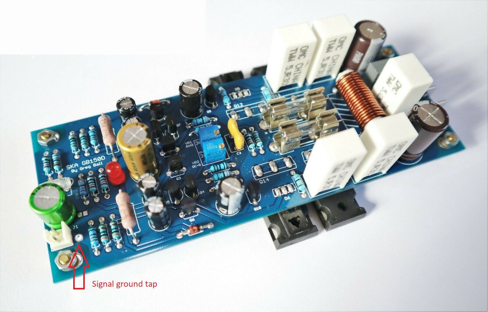

On my latest PCB (V2) I removed the ground lift resistor (see attached pic of original gb150d schem) , so if you put it back maybe it would help with emf sensitivity.
Try to remove solderlink connection (by using solder wick) and then I have placed a signal ground tap on the pcb (arrow on attached picture) connect it to speaker ground via 10 ohms. (or 4.7 ohms, then 1 ohm whichever suits your build)
