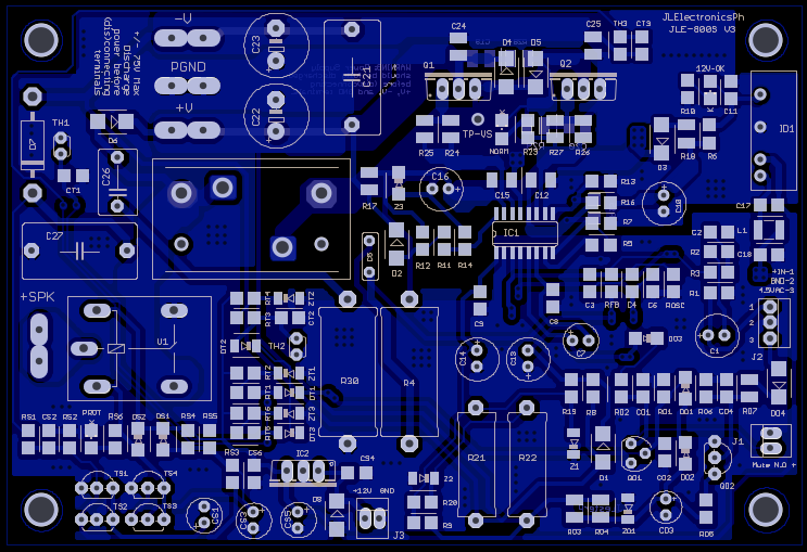

Just an internal name for JLE-800S V3, a proper 2020 update for my IRS2092 module. It will be available next year.
Design considerations:
It uses more SMT parts for faster manufacturing and lower production cost.
Less idle power consumption, less heat buildup.
Overtemp protect, open load detect, DC protect, loss of AC muting.
Also aimed for lower THD compared to previous version (JLE-800S V2).
Capable of 800W into 2ohms, 500W into 4 ohms, and 280W into 8 ohms load

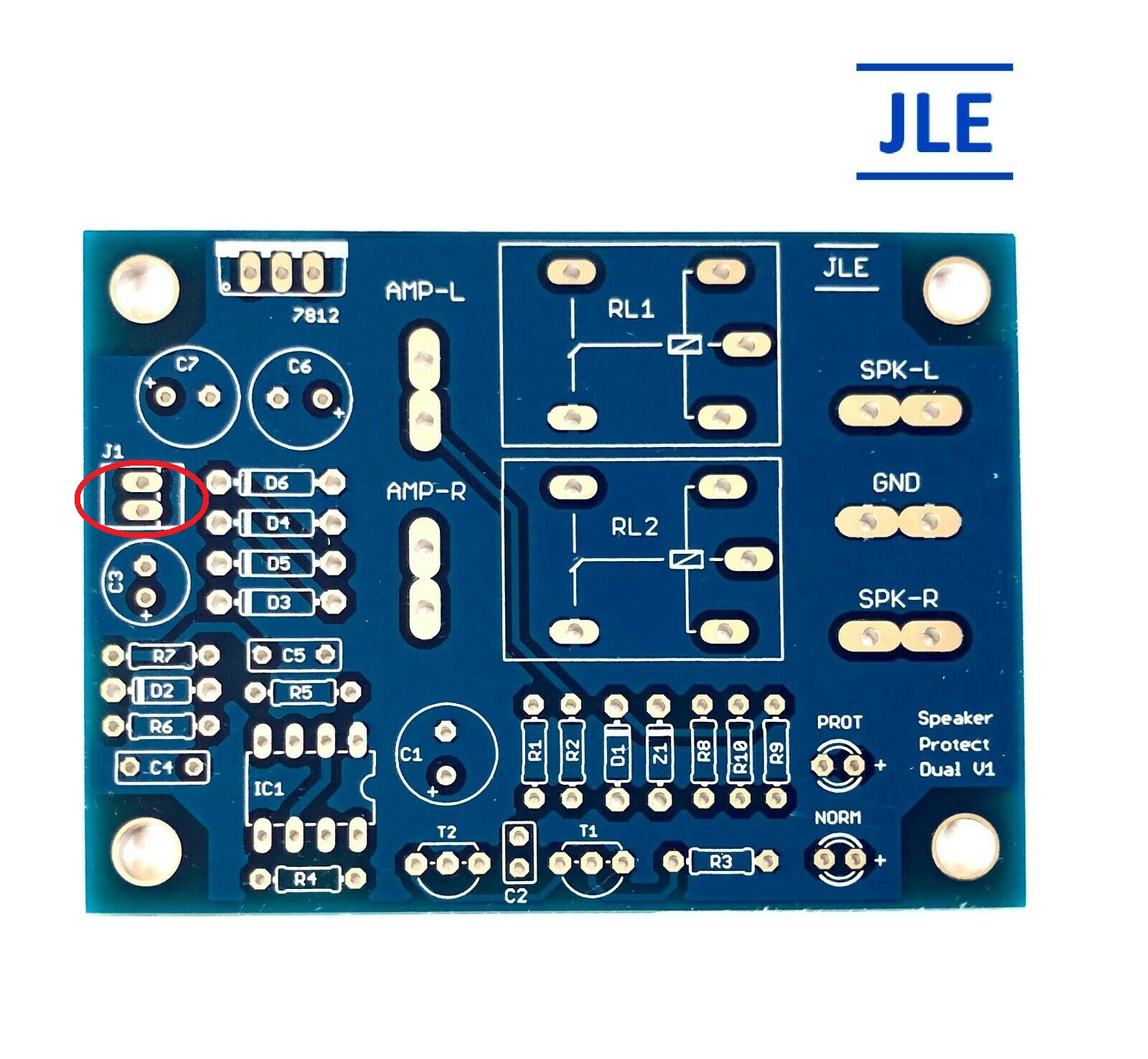

Hi Lester, I see you have in your shop a dual channel speaker protection board but I don't understand how this is powered as I don't see any solder joints on it either for AC or DC.

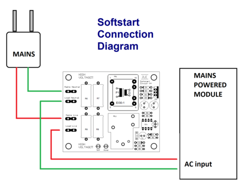

Lester I have one more question about the sof start board, is it possible not to use an on board transformer but instead power the board with a secondary 12V AC from the power transformer of the amp?
Hi, you can power it via J1 header, it has a 2.54mm lead spacing, you can use male header 22-23-2021.
If you will use 12V relays, you can power it with 12V to 15V AC floating or ground referenced;
Or 12V DC with no bulk capacitance like the 12V ground referenced output from SMPS supplies. Remove LM7812 since it has no use unless your SMPS has 15V DC output. You can ignore voltage drop from rectifier since 12V relays can operate at 9V DC.
If you will use a DC source from SMPS, replace C6 and C7 with 22uf capacitor so that the relay can turn off fast when you turn off your amplifier.

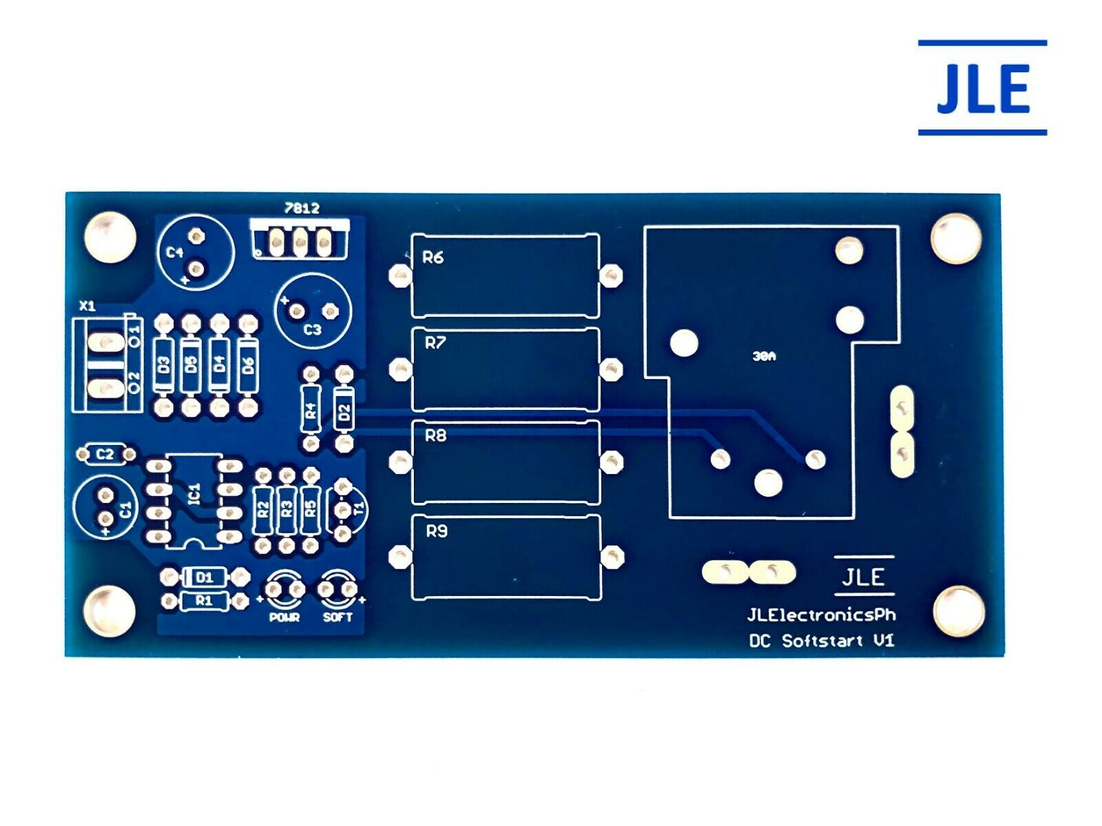

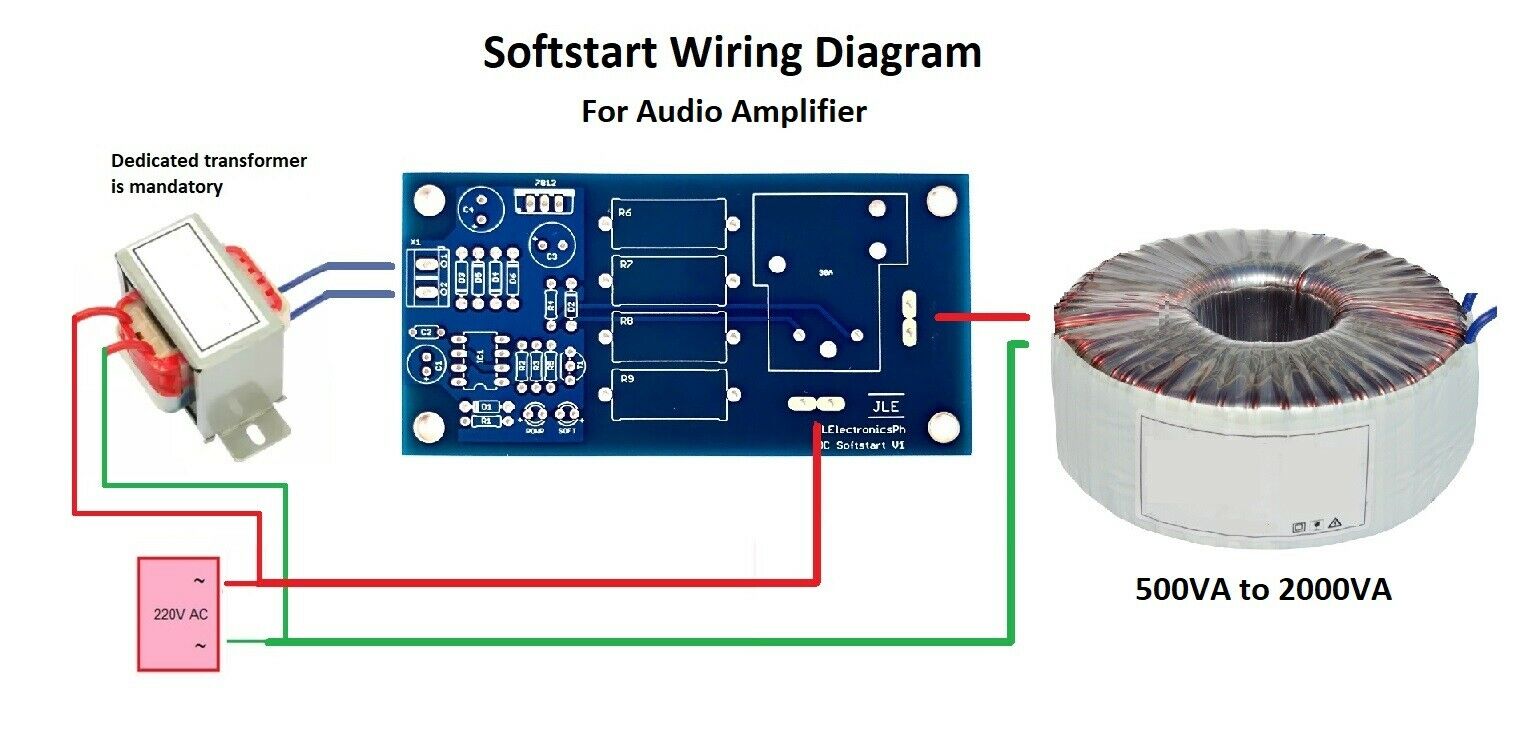

Do not use the power transformer of the amp, the softstart should have a dedicated / separate transformer.
Because if your amp has a fault, and before the fuse blows, it will draw large current which will reduce the voltage output your primary transformer. It will then starve the softstart module so the softstart relay will turn off, which will connect the primary resistor to your faulty amp. Then softstart's primary resistor will become busted and most likely will become 'open' which is hassle to repair.
I also have a softstart which has a separate supply. Attached pic
