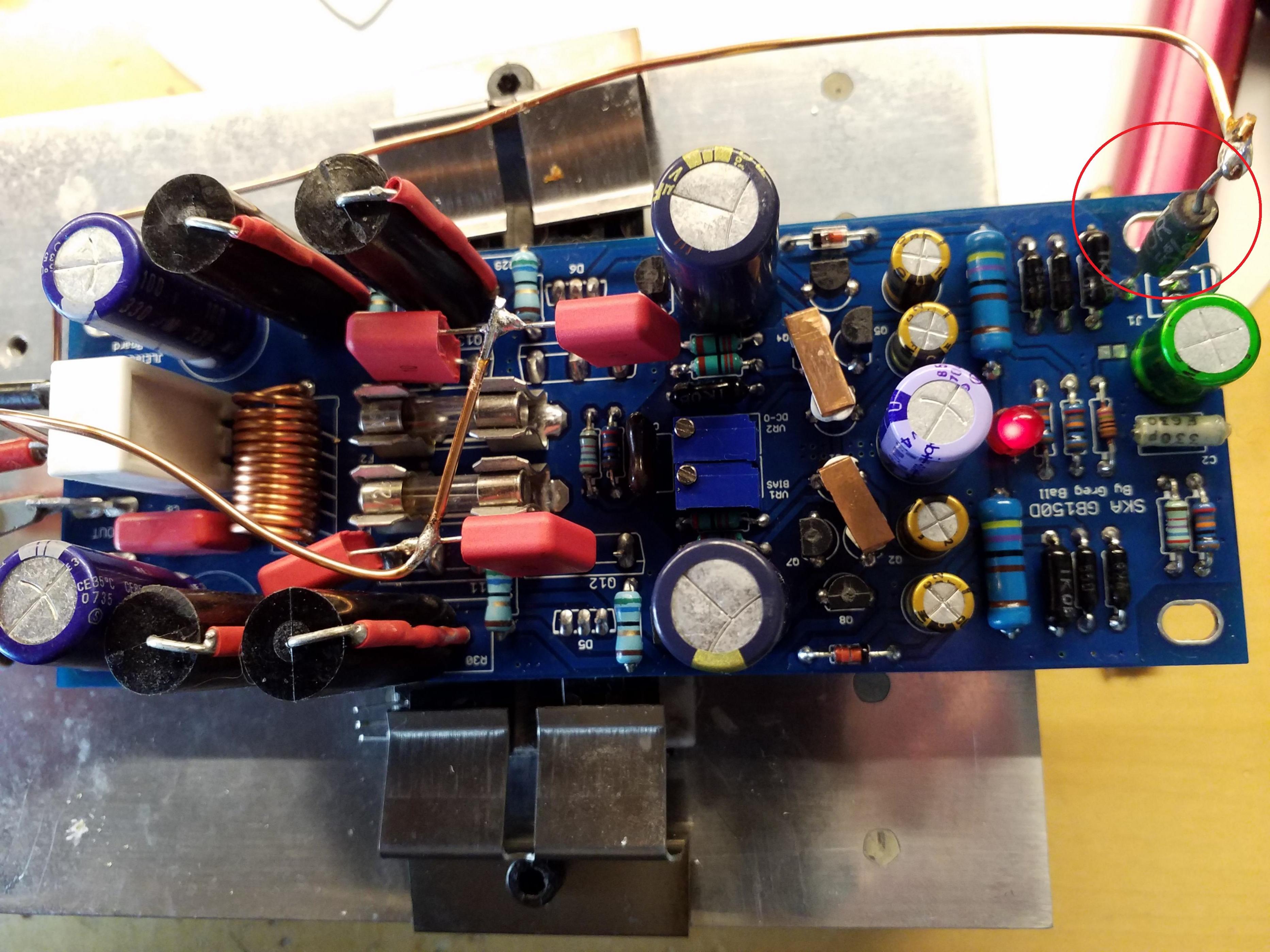

Okay, so I got the ferrite beads on the gate resistors, closest to mosfet, no difference, I noticed that the 0r3 resistors on positive rail heated up, so it's the 9240 that are the problem, also heard the indicator hissing, I poked around with a variable capacitor to ground and set in pf range, I was able to reduce oscillation but not eliminate it, heatsink is grounded in case you were wondering, what's the next logic thing to do?
Can you short out ground lift resistor again? (attached pic) Then check for oscillations.
If it still does, if you have a 1206 47 ohms and 100pf, you can series them on gate and drain of 9240.
I can try, but I just don't get why it's acting up, what is the function of c4 c5 . The other modules work fine just this one with other mosfet, would it help to increase value of gate resistor, make it less prone to oscillation, say 100 ohm?
C4-C5 is for bootstrap current source.
Can you put 100pf on base-collector of Q9 and Q10?
On SKA GB150D thread, some are experiencing oscillations when 10 ohms ground lift is placed on the circuit.
I will try your proposals as soon as I get some free time, I'm not one of the lucky who are forced to stay home because of corona.
Will theese implementations affect sound quality..?
I will check out that thread, been reading on biguns thread TGM7 he made a version of ska150 and he did also have oscillation trouble.
