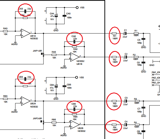

I can't find LME48960 on Mouser, RS Philippines, or Element14. I have lm49720 here and I will order 1D23A on mouser and will use them for new measurements.
Since opamps will be socketed and replaceable, only NE5532 will be provided. I will leave the opamp and capacitor upgrades to audio DIYers.

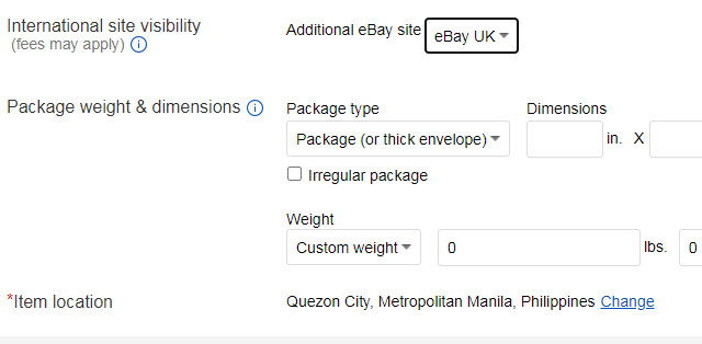

No change if navigator in "English". Tried with Firefox and Chrome.
For me, its a problem with eBay setup. May be France country is out in the eBay selling configuration.
Is this is that... but when I put my navigator in english this passthrought the problem, the trick don't work anymore...
Try Opera with VPN..

Normally, it is up to Lester to configure eBay and declare for which country the products will be available for sale.
I configured the items to be shipped worldwide. Only site visibility option is for eBay UK

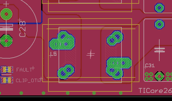

You think you can mod the TPA3255 PCB for adding PCB footprint of SER2918/3018H (or Bourns PQ) ?
D
Deleted member 148505
Very good Lester !
SER2918 / PQ2617 will make the PCB substantially larger.
On my PFFB version I will add provision for VER2923-103KL so that PCB size will only increase by a few mm in length, also it has a lower DCR and higher Isat, although twice more expensive than PQ2617.
OK I see SER3018/PQ2617 is more large (27.9*27.9mm)..
Tell me more about your PFFB version with VER2923... I want to put the TPA3255 in this maximun capacity to beat the Ncore NCxxxMP...

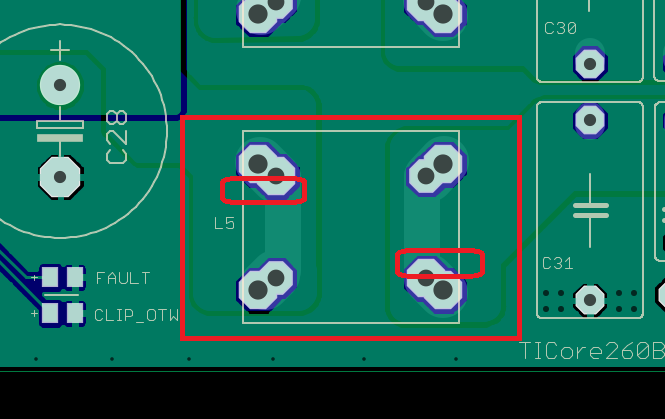

If you can notice on V1.0 board, I made the zobel resistors large, it is for preparation of PFFB implementation.OK I see SER3018/PQ2617 is more large (27.9*27.9mm)..
V1.1 is still not PFFB yet, I find the non PFFB PCB layout more elegant .
On PFFB version I will increase the V1.1 PCB length to accomodate Ver2923 inductors and will add couple of R_fb and C_fb SMT parts.
I will place VER2923 alongside 7G23A and 7G17A holes on PFFB version.
Different inductors for different user applications.
VER2923 is the best option if you don't care about the cost.
Ok I wait for a PFFB version with upgraded inductors... price for VER2923 it's not a problem.

On my V1.1 board, VER2923 actually fits, I just have to score out some of the ground plane on top and drill oval hole for VER2923's flat cable.
