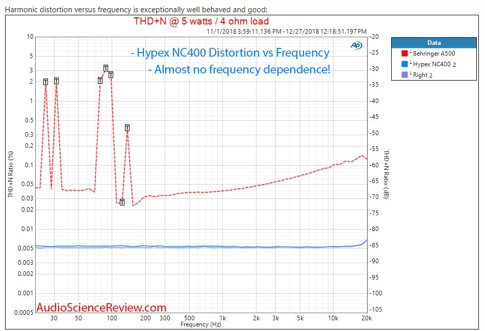

Amir sees a lot of variation in distortion vs frequency performance of Class D amps. It would be nice to see that measured for this amp. Attached is performance of the DIY amp using Hypex NC400 modules, one of the best he's tested so far (but very expensive). Blue curve is Hypex; red curve is a Class AB amp with poor performance.

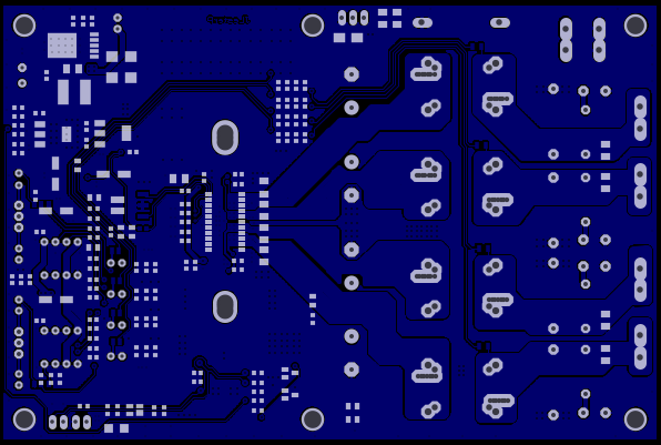

Another interesting TPA3255 PBTL mono board:
TPA3255 - all about DIY, Discussion, Design etc.
He use CPQ4233 (the best big one inductor) and Nippon Chemicon KZN 1800µF Cap, see the schema and PCB attached.
He uses a pair of OPA1632 op-amps with a complete TI PFFB arrangement.
The bi-polar 12V power supplies are generated from a single supply input using Linear Tech's LTC3265 low noise bi-polar supply charge pump.
And +15V was regulated by LM5164.

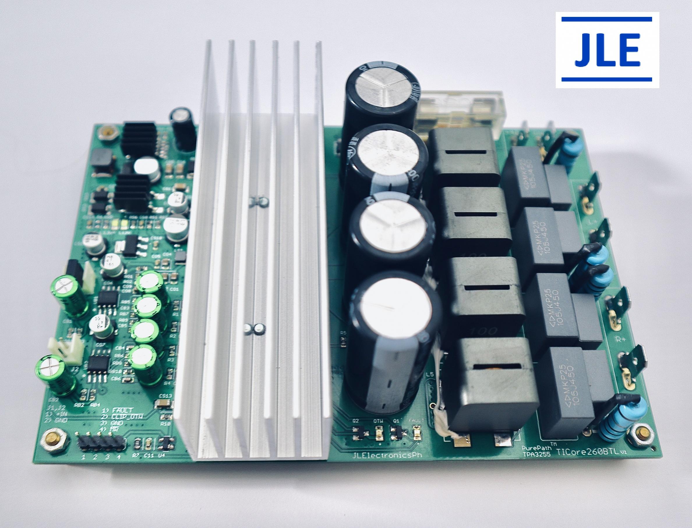

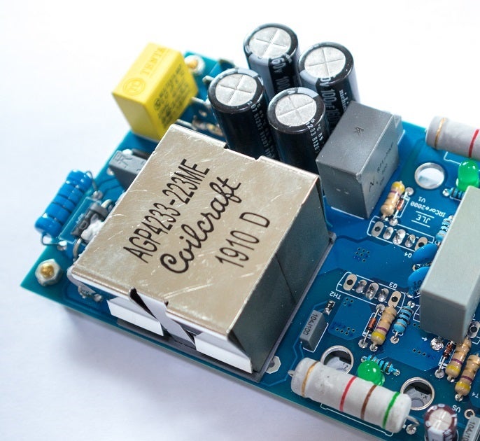

Yes I'm using that kind of inductor on my 1000W power amp (attached pic), it's around 14USD a piece from mouser.
