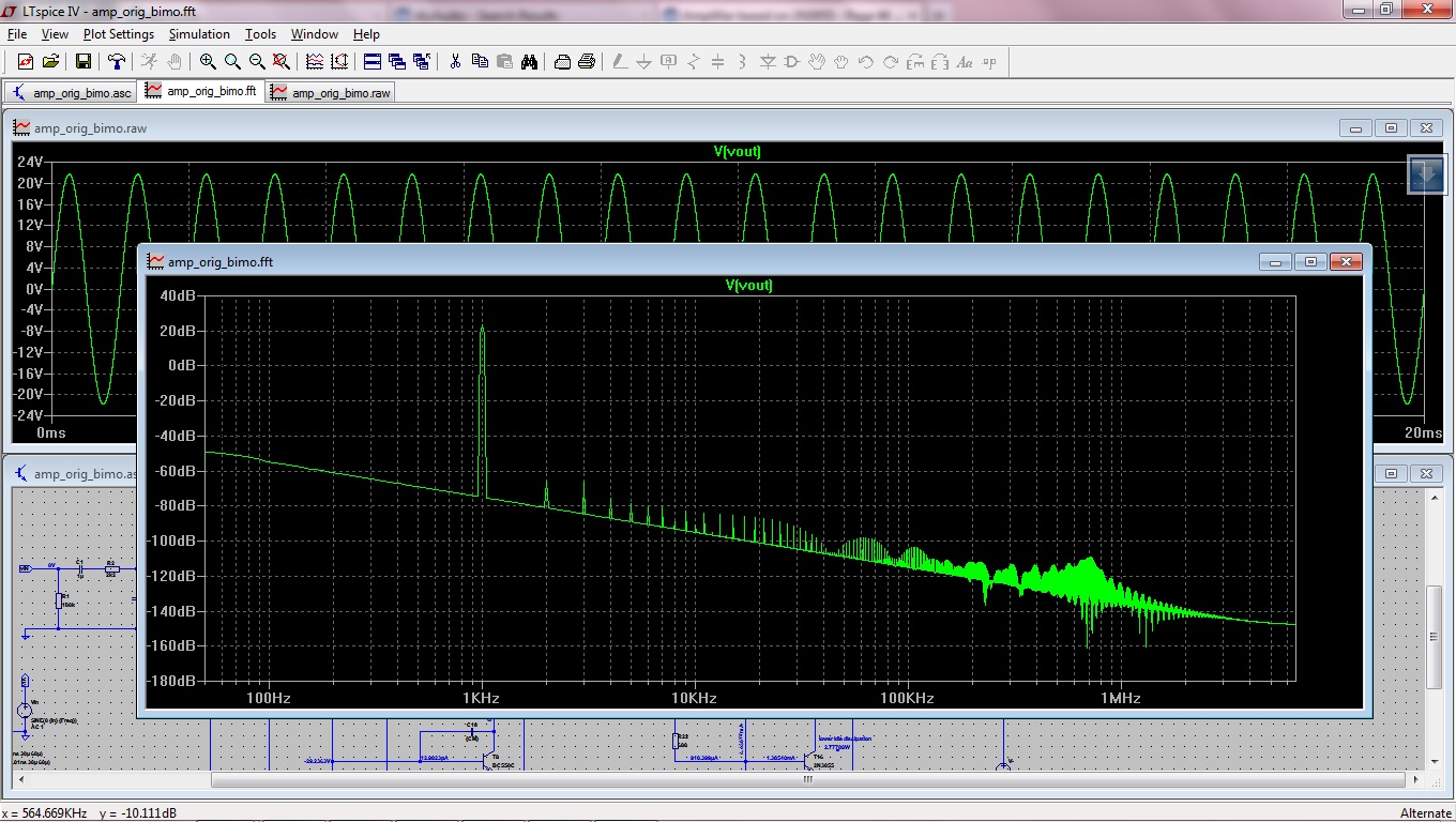

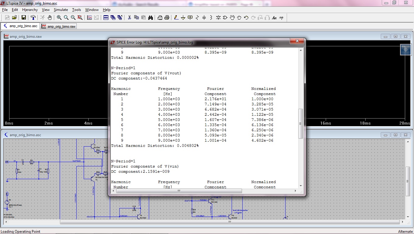

I was able to dig out an original elektor article, from the french edition of the magazine, which I'm posting here for reference.
I'm posting the sim file that should match everything from the article. It should run as is without dependencies issues for models because I used most of what comes with ltspice. I didn't have a known good model for the zeners and there aren't any 5V6 types in the ltspice database, so I just used a 6V2 from cordell's models and adjusted it for 5V6. Hopefully this doesn't change much.
There aren't any bd139/40 in ltspice's database either, so I used and embedded the known good models from keantoken as well.
All the other models are from ltspice's database.
Perhaps I'm doing something wrong with the simulations. See what I used in the sim file. But they state in the article a thd at 40W/8ohms (800mVrms input) of maximum 0.01% from 20Hz to 20Khz. I assume they are using 30V rails, but that may be a tad more. What I find is much higher than that, at 0.024120% at 1Khz and 0.246369% at 20Khz. One order of magnitude increase from 1Khz to 20Khz. And definitely not 0.01% max.
Am I doing it wrong? missing something?
I did optimize the fft for a finer time step and although the plot looks fairly devoid of all that grass, the noise floor is quite high and rather slanted.
There aren't any high value caps on the input filter or the feedback network, so that's not where a long time constant would be coming from to cause a long charge time to cause such a slanted noise floor. Don't know where that comes from and why it's that high.
Perhaps better models could help all this...

I change your original design from Elektor to get higher slew rate. I use spice model from B. Cordell: BC550C/BC5560C and BD139/BD140. Using BC550C and BC560C reduce distortion because their high hFE. But if I use BC546B and BC556B from Phillips, it oscillate. The oscillating gone if I add capacitors 4.7pF from base pre-driver transistor to ground.
I think high slew rate is important. I have VFA amp symmetrical LTP, folded cascode VAS, and 3EF OPS with lower THD and lower slew rate than my CFA (VSSA variant). But I like the CFA sound. May be because the high slew rate but I am not sure.
It is. It really helps reduce TIM, and TIM is harsher on the ears than HD. It's a trade off, but I think lower TIM is more important than lower THD.
I've tried various compensation methods. Some aren't usable on this amp's topo, but one of them worked well on this elektor topo. Using that split miller with the resistors going to ground has been much more effective than plain miller and even inclusive miller. I have reached THD at 0.039 at 20khz/8ohms (with the rails at 30V and output power at about 36W). But that's hardly much of a change in topo. We're going for a 3 pairs of outputs and beefier drivers. Plus we need added protections, which the original doesn't include. Plus we're aiming for 35V rails too.
I don't understand how you arrive at your THD figures. Can you show how?
You have increased the tail current quite a bit. And although it may help slew rate, I wonder how this stays within the linear range of the diff amps.
The very popular Honey Badger amp in this forum using 3,2mA current source in LTP. It is proven design. You can not argue that 2mA can not stay within the linear range of the diff amps. You must learn from proven design that very popular, read their threads.
Many commercial amp using high current source also, you can not say the designer is stupid :D.
Bob Cordell made excellent book, Douglas Self also ( I read their books). But still, you must learn from proven design, how designer made trade off. One person can not mastered all things. Find second opinion.
And the last, you must make many experiments like Hugh (AKSA). Designing, measuring, listening.
