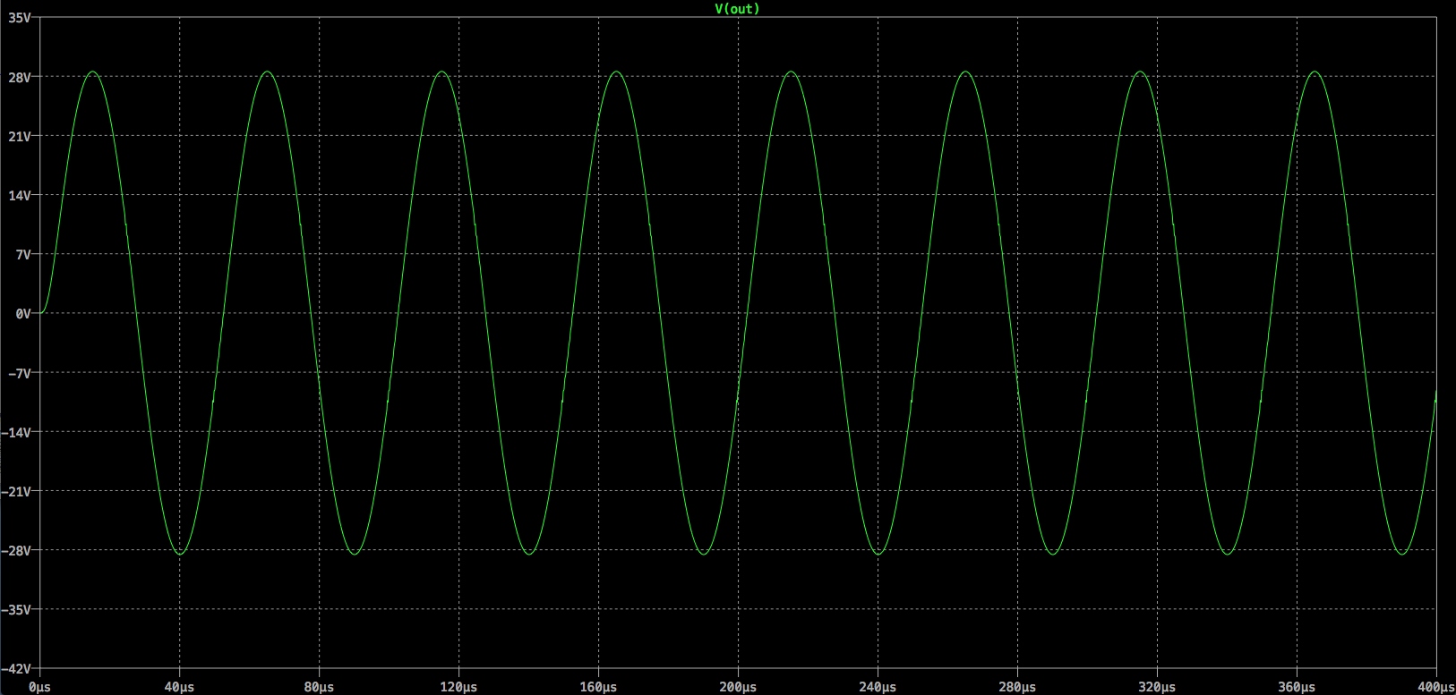

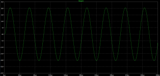

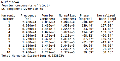

What I found for thd on this sim as it is, with the 4ohms load and at 20khz, is about 0.344% and change... This is too high and we can do much better. Especially since this attempt is to compare using a complementary 3055/2955 triple output with the quasi that we started with. We are getting much better thd on the quasi than on this complementary, so obviously we're far from optimized on this one for now. The best I got was below 0.01%, even on 4ohms and at 20khz, so this can be done. Then if the real build doesn't quite come close to the sims, it still would be better than this. Many of the current values have been tweaked for best effect, but there are so many interactions, there is no way to be sure all values are what they should be. And I'm quite sure the slew rate is less than optimal, since we get such high thd at high freqs.

Wow! If the thd really is that low now, of course there is no need for further improvements.
But I took this sim file and tried running it myself, and it takes a very long time to run, with results that baffle me. The output signal plotted is very ugly, and I don't see any thd result as you have included in the comments.
Obviously my results being so different, I may be doing something wrong. Although I am only using the method outlined by bob cordell in his book, which is rather simple and runs fast. Perhaps it's too superficial, but why can't I reproduce the results?
As it is now, my simulation doesn't have fully calculated component values other than those having to do with the operating point. So although everything is biased and seems to idle properly, anything having to do with a dynamic function isn't properly calculated, and I'm sure there are discrepancies about the various roll offs in the compensations and other factors dealing with the degeneration.
I was getting better thd results with the quasi than with the complementary triple, but that's done with the simple sim method for thd, and that may need improvements. So far I still haven't matched with the complementary what we have with the quasi. More should be expected from the complementary.
Can you explain how this simulation works and how you got this result? Since I can't reproduce this, something escapes me. And why does it take such a long time to run?

I think to get accurately of THD measurement, "Stop time" must be long enough (>= 20 period) and "Time step" must be low enough. Please see my asc file. If you want more accurate, you can adjust values in menu: "Simulate"->"Control Panel"->"SPICE"
For a good simulation you need a small time step. I usually use 20nS max. If it takes a long time to simulate it means that the variations are occurring at even smaller time steps which usually means that something is oscillating. This may explain your output not looking very nice. And it may be that oscillations are causing the high distortion.
Look at the FOurier transform and see if you have high frequencies in the results.

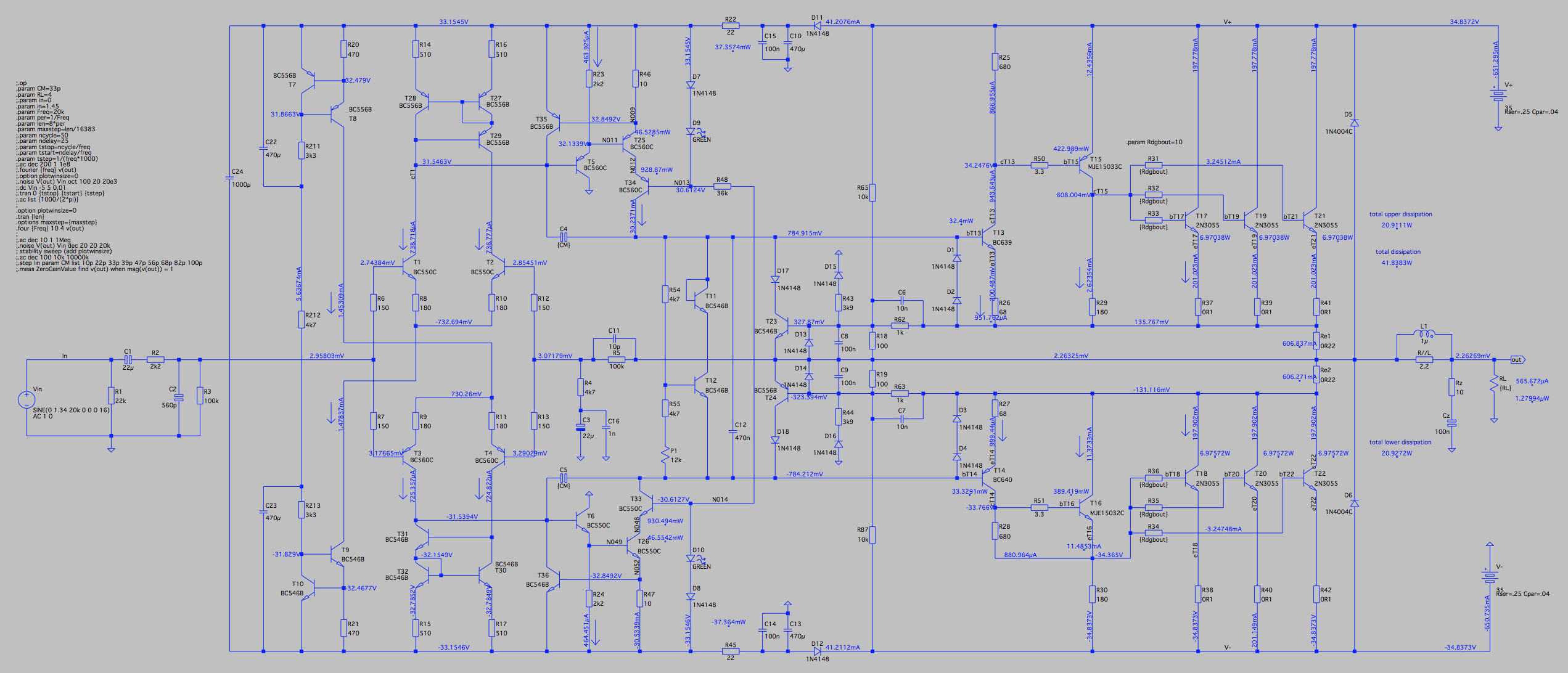

Let's take the simulation that I'm working on for the quasi version of the amp that I am trying to improve as an example. I ran that sim and posted results attached, with the log as well.
Shouldn't the step time be a function of the frequency? as a fraction of it? so it doesn't end on a fraction of the time step at the end of the sim?
I am using bob cordell's suggestions for the sims that I'm running, but those may be a little superficial.

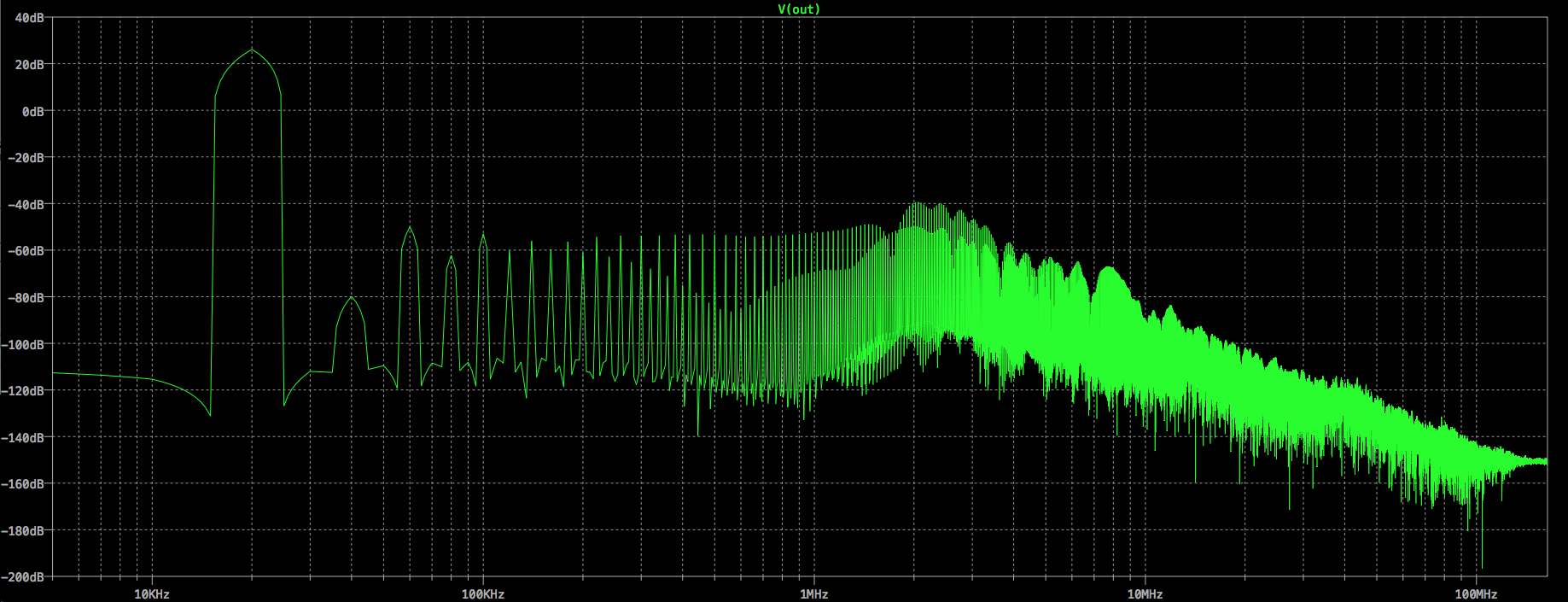

Ok, the fft plot posted shows lots of high frequency harmonics. There surely has to be chances for oscillations at many various high frequencies.
This topology being the altered one from our original elektor amp, with the current mirrors and vas & cascode improvements, the output triple stage is still unchanged as a quasi.
I have changed the transistors used for all small signals, using the high gain types on the diff amps, which makes a huge difference. I noticed that using high gain types on other things such as the current sources and mirrors wasn't such a good thing, sometimes having adverse effects.
I changed the drivers and those have slightly higher gain, so I tweaked their collector load resistors.
One concern is the vas cascode transistors, which are dissipating far too much. But I saw a significant improvement in thd when running the vas "richer" that way, and also the outputs are at a high bias as well, dissipating quite a bit.
Reducing the bias on the outputs and the vas bias current increases the thd a lot.
The problem is that I also need the vas bias to be this high so the collector resistors setting that current have a high enough value so the limiter transistors can act at a reasonable level to protect the vas.
Perhaps there is something further to do to the diff amps' current mirrors to push the diff amps' output taps a little farther away from the rails. But there we may come a little too close to the vas cascode op as well, which could also be pushed a bit farther away from the rails than the 2.5V as it is now. This could involve adding an extra diode there is need be, or use a different led with a higher drop.
At some point, I was able to bring the thd at 20khz below 0.02% on the 4ohms load. But that is using the simulation as it is now, and I may not be getting the right results on thd. See what bimo was getting for that, I don't know what to make of it.

One other thing that I forgot to mention and that I was wondering about:
On this quasi topo with the triple output stage as it is now, is there any way to adapt the non miller compensation method? Would this work? better?
I tried one thing that brought a huge improvement to the other simulation that I'm doing on the complementary topo. I added an inner loop from the pre-drivers, by splitting the load resistor as dr leach did it on his amp. Since that complementary triple is the exact same topo, this works fine and the tweaking on that inner loop brought 1 order of magnitude improvement on thd. Not bad. And I'm also using the non miller compensation scheme on that one as well. It's working, however for some reason I was unable to get a better result from that complementary topo compared to the existing quasi. So I'm still missing something.

Oh! And one more thing, again:
I tried to avoid having certain references to ground because this amp is meant to be used in a grounded bridge.
One reference to ground that I think might be an issue is the 1st vas transistor's collector. So I tried linking both of them together and although that worked, it increased thd quite a bit. I also tried this with a resistor linking both collectors, and this also work but does still up the thd. I think this reference to ground is unwelcomed in a grounded bridge. Is there a fix for this?
One other reference to ground that is new due to using those compensation caps on the pre-drivers' bases, may not be such an issue, with such small value caps.
And an other is the filter and decoupling caps placed after the diodes in the rails. But perhaps those could simply be omitted, as we also have those filters near the current sources and diffs.
I was hoping to get a better result using a straight EF3 output stage compared to this quasi, but so far it's worse.

The grass (I can't see my neighbour!) in pic1 shows that the FFT has not been optimised.
You MUST correct that first.

Yes, it's tall ain't it? I've been trying to figure out what to do about that.
No success so far. I'm still learning spice, so I'm no expert.
What would you suggest for this?
And how about getting a handle on the thd readings? What can I do to get something realistic?
I'm only using bob cordell's suggestions for spice sims, but I may not apply that properly. I'm trying, but need guidance.

Every time I run THD measurement, I just copy this Spice Directive:
.options plotwinsize=0
.options method=gear
.options numdgt=7
.param Freq=1K
.param numcyc=20
.param dlycyc=5
.param FFT=2**16
.param simtime=numcyc/Freq+dlytime
.param dlytime=dlycyc/Freq
.param timestep=(simtime-dlytime)/FFT
.four {Freq} V(Vin) V(Vout)
.four {Freq} 4 V(Vin) V(Vout)
.tran 0 {simtime} {dlytime} {timestep}
.option numdgt=15
.option reltol=1e-6
.option ptrantau=0
And then make label "VIN" on input and "VOUT" on output.
Signal input look like this: SINE(0 0.9 {freq})
DC offset = 0, Amplitude = whatever I want, Freq = {freq}
Frequency can be change in Spice Directive above.
For checking amplifier stability, I use Tian Probe.
Go back to the simple model used by Cordell and follow his instructions to see the FFT and the improved version using step size. I got some grass that was 20dB to 40dB lower than the figures quoted in the book by changing the right numbers. I also got rubbish. I need to learn more.Yes, it's tall ain't it? I've been trying to figure out what to do about that.

Then start playing around with the settings to see how they are very intolerant of wrong data and give rubbish on the FFT.
It seems you and I need to learn what the settings need to be and which can, or should, be altered to give valid FFT results.
It's the valid part that is important.
