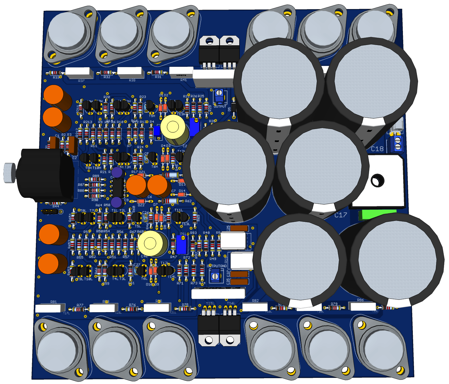

I've been quite a while without enough time to be on the forum and work on the hobby, and it's still rather hectic for me right now and no time to do any hobby stuff.
But I miss it and I was making a little time to do a little something, specifically I re-visited the simulations for the 3055 based grounded bridge (John Ellis') and although I have never been able to get the VI limiter to work properly on it, whatever values calculated never actually ended up being effective. So I was again giving some thoughts about an alternative to the regular VI limiter, which would do more than just plain limiting, and that alternative would be an input muting/limiter that can be triggered by "looking" at the differences between the inputs at the diff stages. This can easily be done by a plain opamp, looking at each diff amp input, without disturbing anything with a high input impedance. Any signal that is beyond legitimate, including what happens when the amp's output gets shorted, is ground to take some measures.
Now there are 2 ways this could be handled at the input, either we just engage a mute of the whole input signal and a timeout, to allow gradually to bring the signal back, and if the fault is still present, it would just mute again to try this later, for as long as the fault remains.
The other way, which would be quite nice to have, is an input signal limiter, that only engages when distortion was detected by the opamp monitoring the diff amp's signal differences. This would be nice because it would also work for clipping situation where we don't really want to mute everything and just limit to keep the issue under control.
Anyway, while pondering on this, I was also trying to measure the margins on the grounded bridge, using the probe (forgot the name), which I've been using on other amps, but that seem to provide faulty data on this bridge, most likely because I'm not using it right.
And I was hoping to get some pointers on how to probe for the margins on that grounded bridge topology.
The main thing is, this bridge essentially has 2 feedback loops, not mentioning the advanced compensation beyond plain miller, and those loops aren't nested. So then, where is the probe to be inserted to get proper phase measurements?
I was inserting it in the feedback return path coming from the output bus on the output stage on the high side (not the grounded low side), coming back to the feedback input, where the compensation and negative input network is.
The measurements are way out of whack (in sims, ltspice), so something ain't right and I have to be doing this wrong.
I won't have much time to spend on this for now, but at least I'd like to get this under control so I could tweak the proper values for the compensation.
I had done several versions of pcb layout already, way back when I was still able to spend time on this, so I actually have a few possible prototype builds that could be made, as long as proper compensation at least is applied, so as to minimise issues (no oscillations).
Just to illustrate, I'm joining a visual of one single board version I had done, long ago now. That was including line receiver at the input for fully differential driving, and all on a single board, with the PSU. I would like to see this project get somewhere. It's not very far from prototyping..
