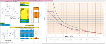

Here is the resistor choices from the spreadsheet.
With the zener strings, all made from the 5v6 to 6v4 range only.
All the limiter resistors, except for R1, can be regular 1% or better, metal film. And R1 might be best as a 1W, to be on the safe side.
One thing that I did do, is to choose a rail voltage a tiny bit over the 35V, to be on the safe side, so the locus crosses the Vce axis beyond the rail voltage (as per M.K's recommendation)
The time constant (C1/R8) is at 220us, and the speedup cap has the same 22n value. With the small 15p cap on the CFP limiter, all this keeps the funny business down to a reasonable level when the limiter is acting.
By the way, the choice of LED based current sources for the limiter references is for thermal drift reasons.

Interesting, I've been playing with VI limiter simulation today as it happens. I think I've a fairly workable solution to two issues with them, the tendency to oscillate, and the effect they can have on linearity some way below limiting conditions due to the gradual turn on of the transistor:
This is a dual slope version using a zener for the knee. The crucial components: Firstly R1, which means that Q1 can conduct upto a mA or two before the diode conducts, so that distortion is unaffected below this point.
Secondly C1 acts to damp the tendency to oscillation once D1 is conducting, but without any effect before limiting (assuming D1 is low capacitance).
That tendency to oscillate is inherent to how the limiter functions, so although we can endeavor to minimize those, they can never be completely eliminated.
Having the time constant helps dampen those somewhat, and a compromise between the speedup cap placed on one of the sense resistors and the time constant one can be found that makes it kindof "acceptable", but it's always a compromise and there is no way around having all kinds of funny business going on when the limiter is acting.
They do start having some small effect long before they actually act. No matter how adamant M.K is about that fact, they are almost never totally transparent, as the transistors don't have a very sharp knee (vbe) and they do act a little way before the calculated values. If the knee was very sharp, that would cause issues as well anyway, although at the very last moment.
If the locus can be pushed far enough above the legit soa usage, then this small disturbance from premature action can be minimize, but that automatically means the output stage must be overbuilt to allow this, which pretty much defeats the need to use more than a single slope and if the output stage is really way over built, then a simple current limit could suffice.
But in any case, any foldback action to suppress the drive to the output stage will always cause serious disturbance, and the fact that the limiter is really fighting hard against the amp feedback makes it sometimes hard to act enough.
That's the main issue on our 3055 grounded bridge design, the vi limiter has the hardest time steeling enough drive and when it's fully activated, there is still enough drive to push the output stage over the soa.
This is why I'm also searching for a good combination that will help keep things under control, within soa, and hopefully remain as transparent as possible.

The locus we calculated for recently, with the triple slope, on the 4 pairs output stage, has shown to be rather transparent all the way up to full power before clipping, until it acts, and all hell breaks loose then, but that's to be expected.
So it's calculated right, and works fairly well, but not enough for full soa compliance.

When they're acting, the vi limiters definitely cause a lot of distortion (and oscillations) and this can't be all good for the speakers in any case.
So if the remedy is acting by compressing the input drive signal, not only a lot of distortion would be avoided, which would be better for speakers, but it would also be easier on the ears as well.
This sounds like a very interesting track to follow up on. Maybe a good way to make use of arduinos, which can be procured and programmed by anyone anywhere on the planet, even in the poorest countries I'm sure an arduino isn't hard to get.
And about inserting fuses inside a feedback loop, this isn't at all a good idea, as when the fuse blows, the amp goes in open loop, and watch out for some freaky stuff to happen then!
Anyway, if we're designing a decent amp, I think it's important to do it right as much as humanly possible, and build in all the proper safeguards, so the amp doesn't go poof without warning. Especially a high power amp, I think should be built to be as bullet proof as possible, and be ready to face any abuse thrown at it.
And never forgetting this is DIY, so nothing too hard to make and parts should be easy to source anywhere, as much as possible. That's why I wouldn't consider anything SMT, and no exotic hard to find parts.
Perhaps a hybrid approach where a limiter circuit just activates an opto coupler, and another opto coupler removes drive from the drivers under remote command. However there is the timeliness issue - on a dead short the tranditional limiter transistor will switch on in a fraction of a microsecond, limiting the build up of current that might otherwise only be limited by the large filter caps and wiring.
Output device with built-in SOA monitoring would be the best approach, after all linear regulators already have this in their over-current and over-temperature cutout circuitry. A bomb-proof output transistor would be a popular replacement device for sure.
I have used a two-pronged approach in one of my designs. A high current limiter prevents instantaneous destruction while an IV limiter opens a loudspeaker protection relay/overload cut out. The "instantaneous" limiter needs to protect the transistors for approx, the 1ms relay response time. Also use a fast response relay. Relay then has to be reset to operate once again, supposedly after checking and fixing a short.
Main reason is that the IV limiter is sort of passive, does not increase distortion (not as much as if the transistors operate internally to the amp. anyway).
My favorite solution for power amps is spend some money on silicon and use current limit only. That was the solution used by BGW. Today silicon is cheap. And if you don't want to spend money on a large heat sink, go class-D. Class-D protection can be a fuse. If you want to use up old 2n3055s, make some nice LITTLE amps.
That solution works fine for class AB and H. Adding silicon to boost SOA on class D is anything but straightforward. You end up needing to make something electrically large in terms of fractions of a wavelength (and heat sink it). They just don’t make 200 amp transistors with the parasitics of a surface mount 2N3904, in a package you can get the heat out of. Paralleling up devices isn’t so easy when you need to hit them all with a coherent wavefront - charging and discharging ever growing capacitances. These amps aren’t going to complain much about adding more 3055’s if you need them. I’ve seen a dozen or more 3773’s in parallel used on old Crowns and they work just fine.
