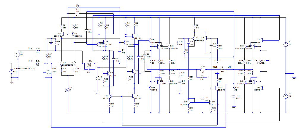

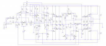

I see your challenge is to build a bridge amp. It always struck me that just a simple pair of amps would need a phase inverter to drive them. Why not design a fully differential amp in the first place?
Here's a proposal that is fully DC coupled, has an output servo bias and can deliver 100W into 8 ohms from +/- 35 rails.
To ensure stability it uses input degeneration resistors and inclusive Miller feedback capacitors which gives lower distortion especially around crossover than the standard Miller. This will not have the lowest distortion that might be possible but simulates at 0.014% at 20kHz/100W.
As with all simulations we need to build it and see ...
You've missed part of the discussions earlier in the thread. We're not aiming for an ordinary bridge with 2 identical amps. We're going for a grounded bridge, such as those in most (if not all) of crown's amps. Not quite as simple. There are many very specific considerations.
AND, we're making it all with 3055s.
This looks interesting, although not the goal that we're aiming for with the grounded bridge.
But I'd like to take a closer look. I can't make out much from the picture posted, the resolution is too low.
Could you post your sim file? (with the models used, to make sure it works the same)
We're on the 3055 thread, so anything based on that is on target.

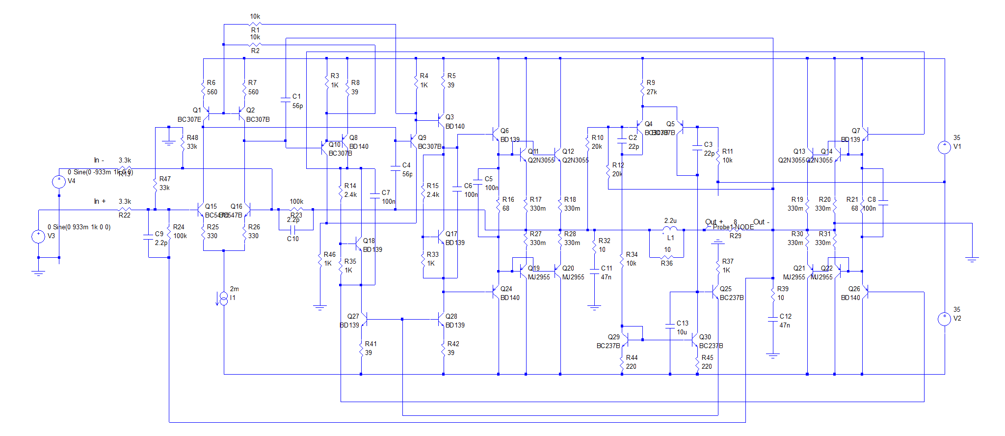

Actually I've been doing some experiments with various improvements on our chosen topo, and even tried it with a complementary EF3 such as used on the leach amp, to see if I could get something better than our existing quasi, but so far I couldn't match it. This is obviously due to my lack of spice and math skills to get the proper calculations done on compensation and other things like that.
On our quasi topo, with several improvements, mostly from bob cordell's suggestions, I was able to reach a much better thd, in the 0.000xxx, but with the input and output networks disabled, and DC coupled.
We started from an old elektor amp and made small changes here and there to make it work in a grounded bridge topo. This isn't as easy as it seems and both sides of the amp aren't identical.
...and 0.0013% at 1kHz/100W ...
This isn't bad.
I was able to reach this at 4 ohms load at 20khz and 20Vrms output signal level (our full rated goal power). The thing is, I want to make sure all the other aspects of the amp are ok before committing such huge changes. It needs to be double checked for proper roll offs, compensation calculations need to be made to make sure the choices are correct, the stability needs to be checked, square waves tests haven't yet been done, and those could be an issue. The noise is not so much of an issue, as it will be satisfactory as is, especially using the high gain low noise BC550C/60C in the diff amps and keeping the tail currents fairly low.
The behavior on 8ohms load is very nice, but this won't be the way it's used. As a grounded bridge, the amps will always be loaded at 4ohms each (8ohms on the whole bridge). And we're using 3 pairs of 3055s, so it might even be ok on 2ohms load (4 on the whole bridge), but probably with some sag in power level and an increase in thd.

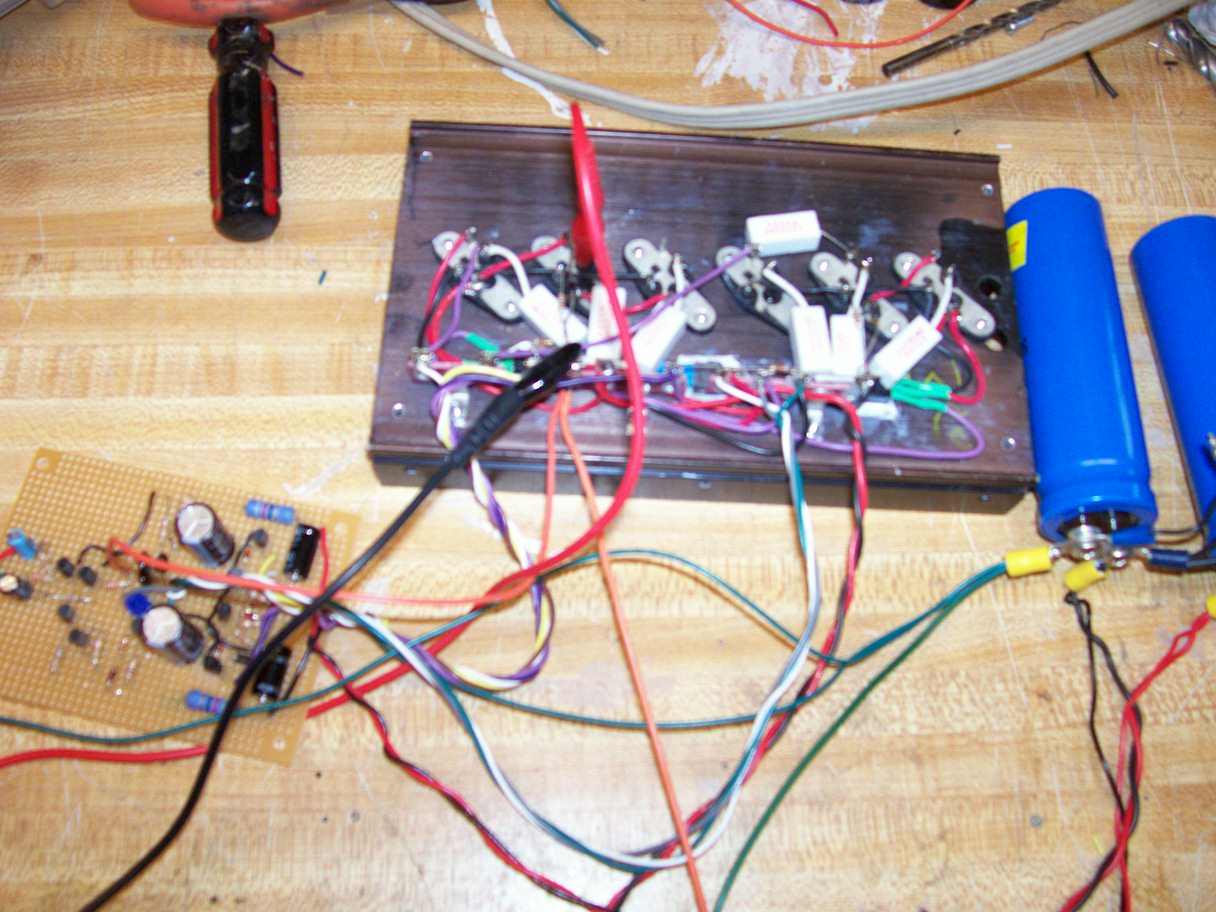

The proposed output stage will be fine. This little proof-of-concept 3055 amp had no trouble with a 2 ohm load. Not just a 2 ohm resistor, but a 4 speakers in parallel load. 3 pairs in quasi with a triple. PL400 style, with the upper half an EF3. TIP41 drivers. Front end was simple, just a diff pair and an 8mA VAS, with a current source on each. Probabaly not world-class distortion, but nothing obviously wrong with the sound. At least the proposed improvements are a bunch of cheap small signal devices so the cost to 'improve' it would be a buck or two - but a bit more homework up front to catch 'surprises'.
The trick to getting the grounded bridge to work right is to make sure the front end doesn't depend on a ground reference anyhwere to work right. And that both sides can tolerate sliding rails (very high PSRR and common mode range). It will work like 4 ohms loaded because it's a bridge - but because of the toploogy it is further bridgeable! That means you really want a 2 ohm capable OPS....
can you share a schematic? did you simulate it? or just went ahead and built it?
