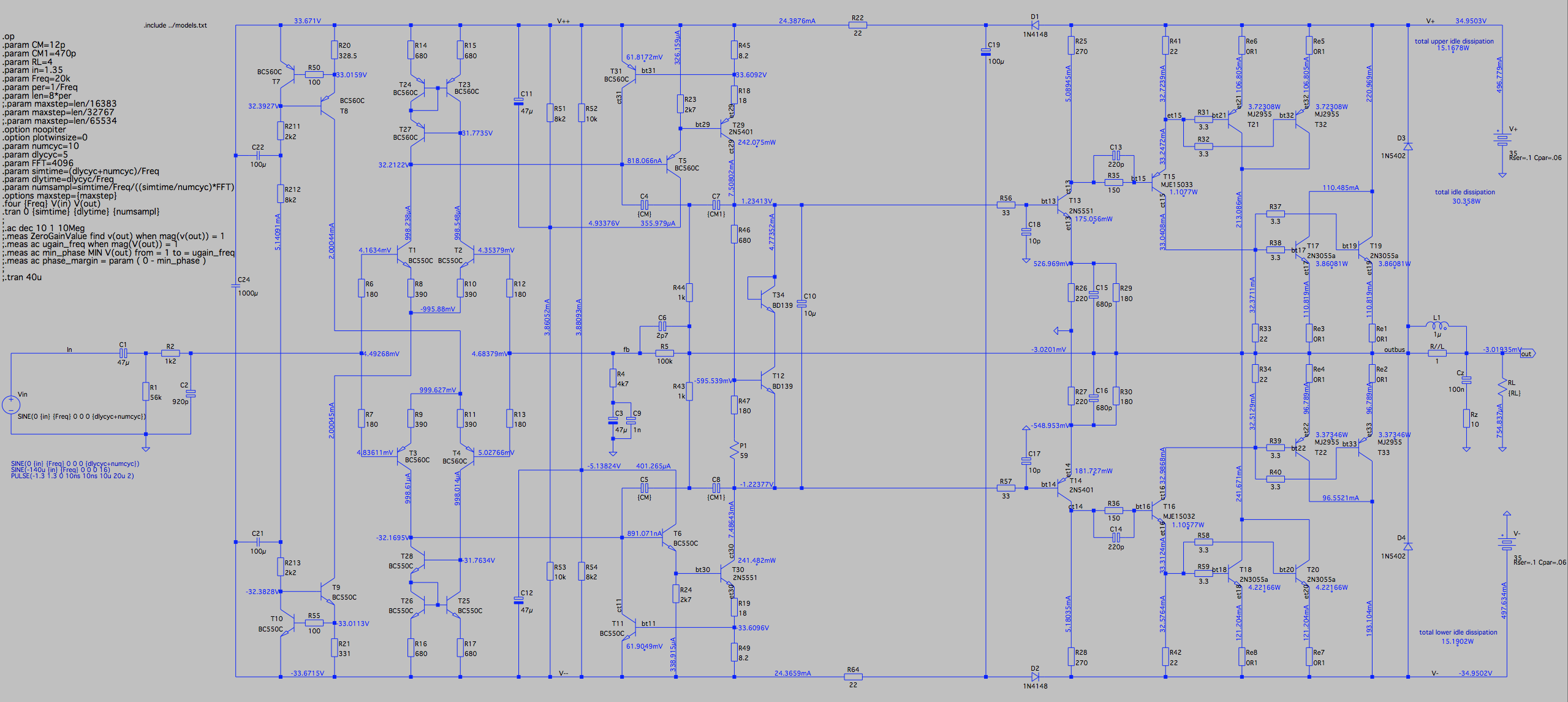

I'm attaching a screenshot of that sim schematic. This is of course a 4 pairs output and that would be an other build. The quasi remains a good one to make.

Since I haven't been able to make the simulation work for the ground bridged version from the quasi based on the elektor amp, I've been pursuing the "john ellis" grounded bridge complementary amp and this works beautifully so far.
I have solved the few issues, such as having a center point between the rails without having a center tapped dual supply, and the rather high thd @ 20k/8ohms that was accompanied with a somewhat limited slew rate and a more than questionable stability margin. I had been able to bring thd down a lot and slew rate up, but at the expense of thd near 1%. We can do much better than that.
So I've tried various things and made some compromises and I think I arrived at something pretty nice now.

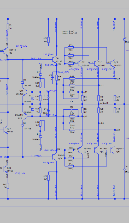

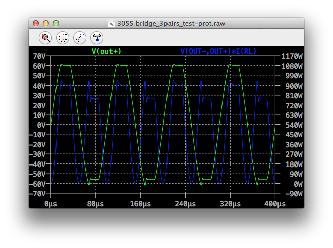

Trying to get the protections working on the John Ellis bridge. I partially enabled the VI limiter, keeping it in its simplest form to look at its behavior when acting. I unlinked its resistors going to the rails and the resistors/diodes going to ground, so what's left is only the very basic current limit.
I chose values so it won't act at all on the 8ohms load, so it works fine there and the amp clips cleanly without the limiter interfering.
I upped the load at 4 ohms and the protection starts acting where it should, right below where it would naturally clip, so I could see the behavior.
What I don't understand is why the negative side doesn't limit as neatly as the positive side does. The limiting on the positive side looks nearly the same as if the amp was clipping, but the negative side shows a slight delay in its action and then limits to a lower level than on the positive side and there is a little bit of ringing before it settles to the limiting level.
I also looked at the dissipated power in the vas transistors, drivers and outputs, and I can see that the effect of the limiter on the dissipated power in the outputs isn't what it should be, at all.
To push it into hard limiting, I brought the load to 1ohm, as if it was nearly a short, and the dissipation in the outputs is alarmingly high, such as over 3 times the capability of the 3055s (more than 360W per).
This can't work that way, as it won't protect against such overloads, the protection doesn't do its job properly.
I tried inserting base resistors before the drivers, but placed them between the vas and the limiters. That didn't help.
Just in case, I unhooked the small delay cap on the negative side from the sensing resistor, and that caused oscillations where it should act, so those caps are necessary.
I made a copy of the BC546B/56B models and made a slight adjustment to their BF and VAF parameters, to make them the same and BF a bit higher as if they were 46C/56C types, just to see how that would work. But that too doesn't change anything.
I had thought about a different way to make this type of protection to act. By adding transistors to short out the vas bases instead of the drivers bases. Perhaps this way to limit would be more gentle and would behave better without causing the large increase in power dissipation in the outputs.
If a limiter causes an increase in power dissipation, and doesn't prevent the destruction, then it's useless.
The thing is, I know how I could make the positive side change to act on the vas base, but I don't see how to do this properly, in a symmetrical enough way, on the negative side.
If we can't get such an ordinary limiter to work properly, then some other kind of protection needs to be worked out.
Any ideas on this?

The limiter doesn't act at the same level on the negative side as it does on the positive.
I think that due to the non symmetrical topo of the vas, and the fact that the drivers don't tie to the output but rather to each other, we can't have the limiters act exactly the same on both sides. I tried evening this out by inserting a resistor after the sensing resistors on the negative side, and this does re-establish a more equal action, but then I tried to look at this action at various frequencies and the behavior gets quite uggly at 20hz, with oscillations and stickyness. I added clamp diodes on the vas, but that has no effect.
I was trying to think of a different way to sense the output current and use this to clamp the driver bases together rather than independently to the output. I haven't come up with anything so far, but this could be something to experiment with.
I tweaked the sensing resistor values so they act early before clipping on a 4ohms load, so I could see the action behavior. When going back to 8ohms load, the limiter doesn't act and the amp just clips, fairly cleanly and reasonably.
On the 8ohms load with the closed loop gain the way I have it now and a few tweaks on the compensation, an input signal of 1.45V peak gives about 212W, and the thd @20hz is only 14.5ppm, almost 15ppm @1khz with about the same output power, however thd increases a lot @20khz at nearly 0.7% and a slightly lower power of about 207W.
I'm not sure the thd @20khz can be helped much without serious changes in the compromises I've made. As I've tweaked several things to get more phase margin with lower thd overall. This input level of 1.45V is a little below clipping, which happens a little higher with a little more than 1.5V for an output power a little over 227W (8ohms).
This is still beautiful though, but we need a properly working limiter that won't misbehave that way.

The "John Ellis bridge" clips rather gracefully and works great (in the sims), but the addition of the vi limiter trashes that and when it acts, the behavior is not good at all. I am thinking this may be due to the non symmetrical vas, and probably some other things due to the way the bridge works. I want to make this work and it must be protected properly, so a proper method needs to be found. One that doesn't trash the performance, lets the amp work normally under all "normal" circumstances, all the way to clipping, but does act without any adverse effects when needed.

I was able to put John Ellis's bridge in a bridged bridge simulation and it works fine. I wonder how it would work in case of action of a latch, because both bridges would be fully independent and the latches not acting in concert, but this may not be so much of an issue, if one bridge follows the other...
