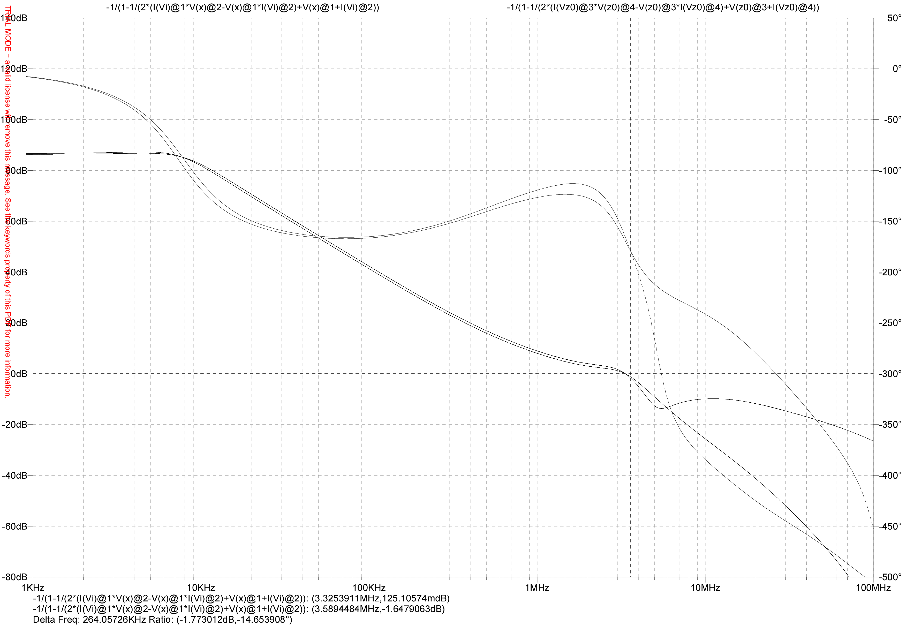

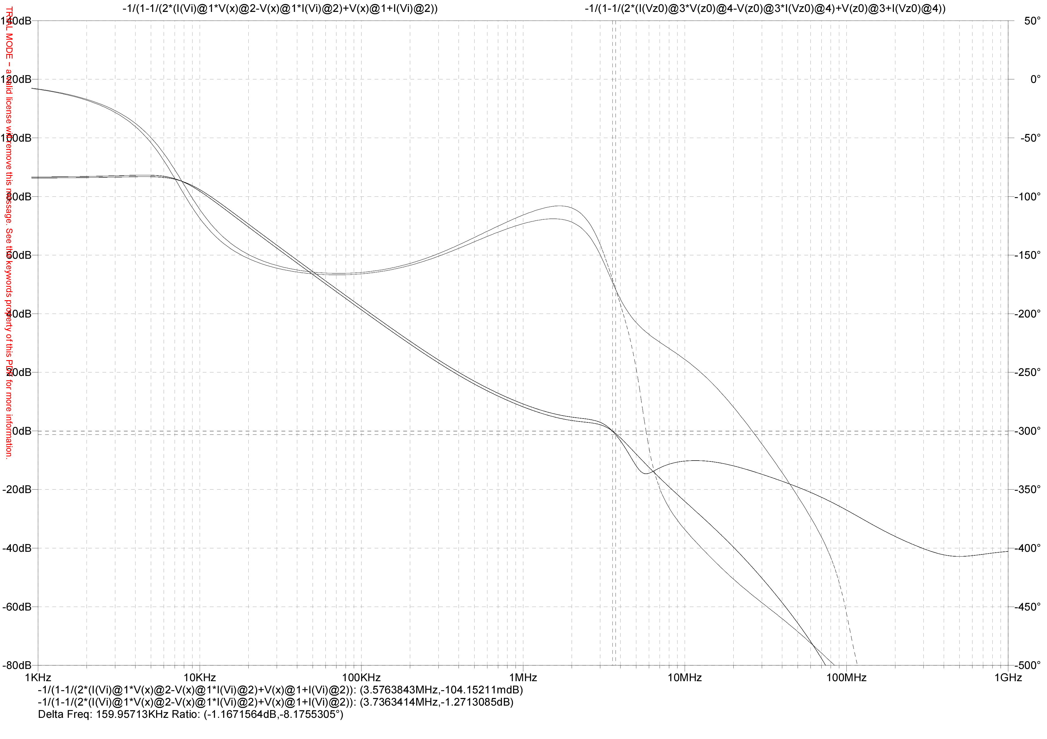

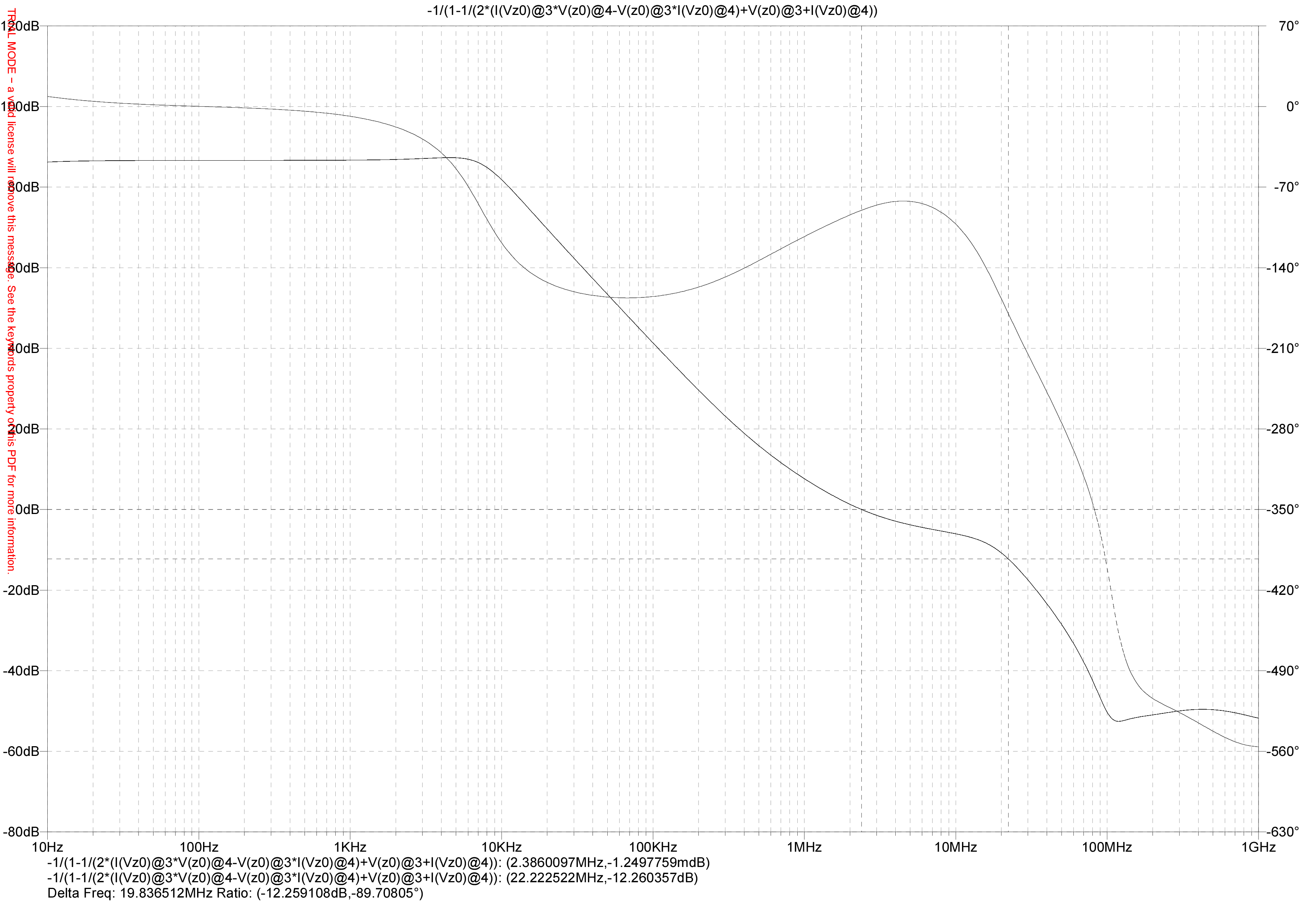

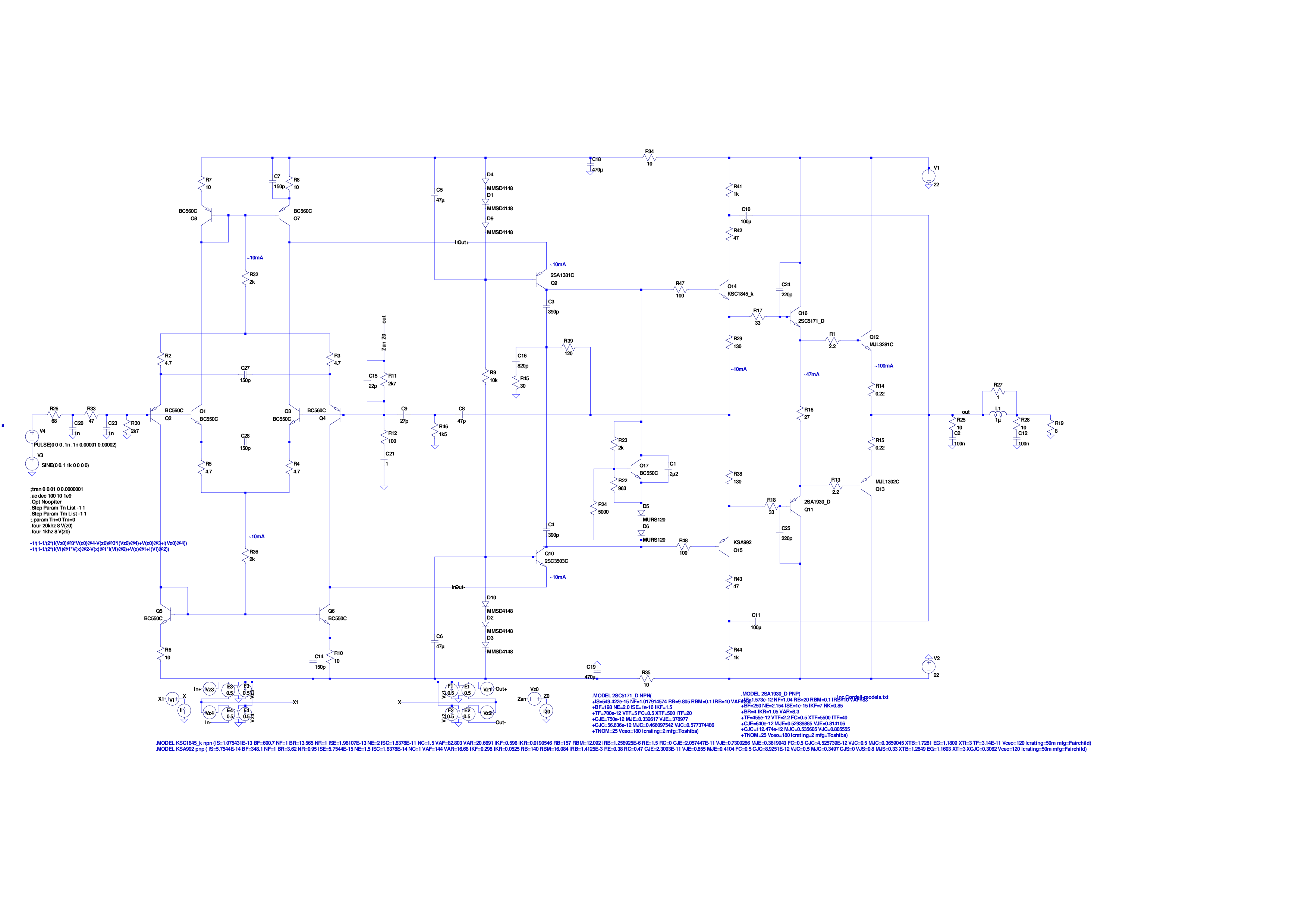

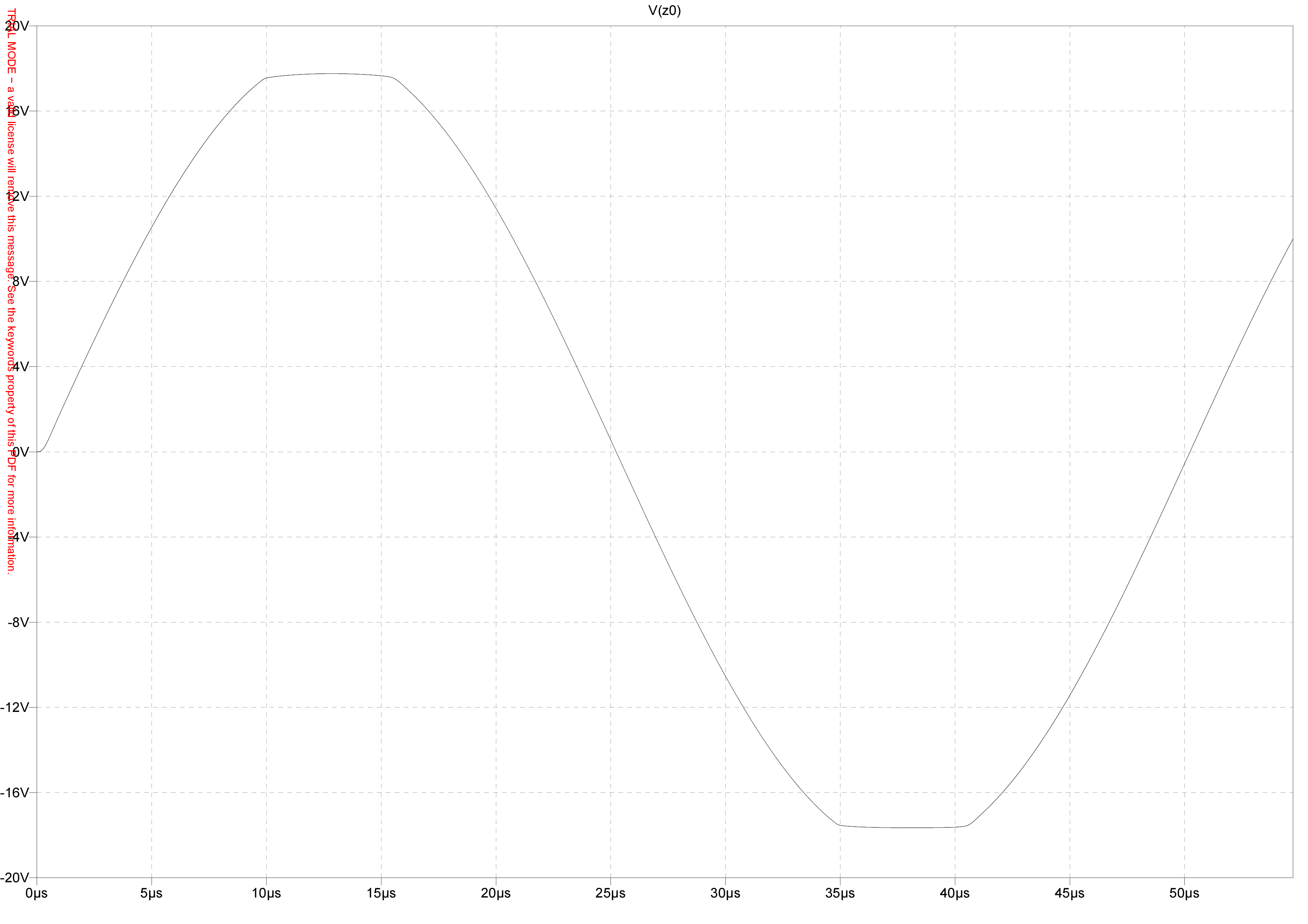

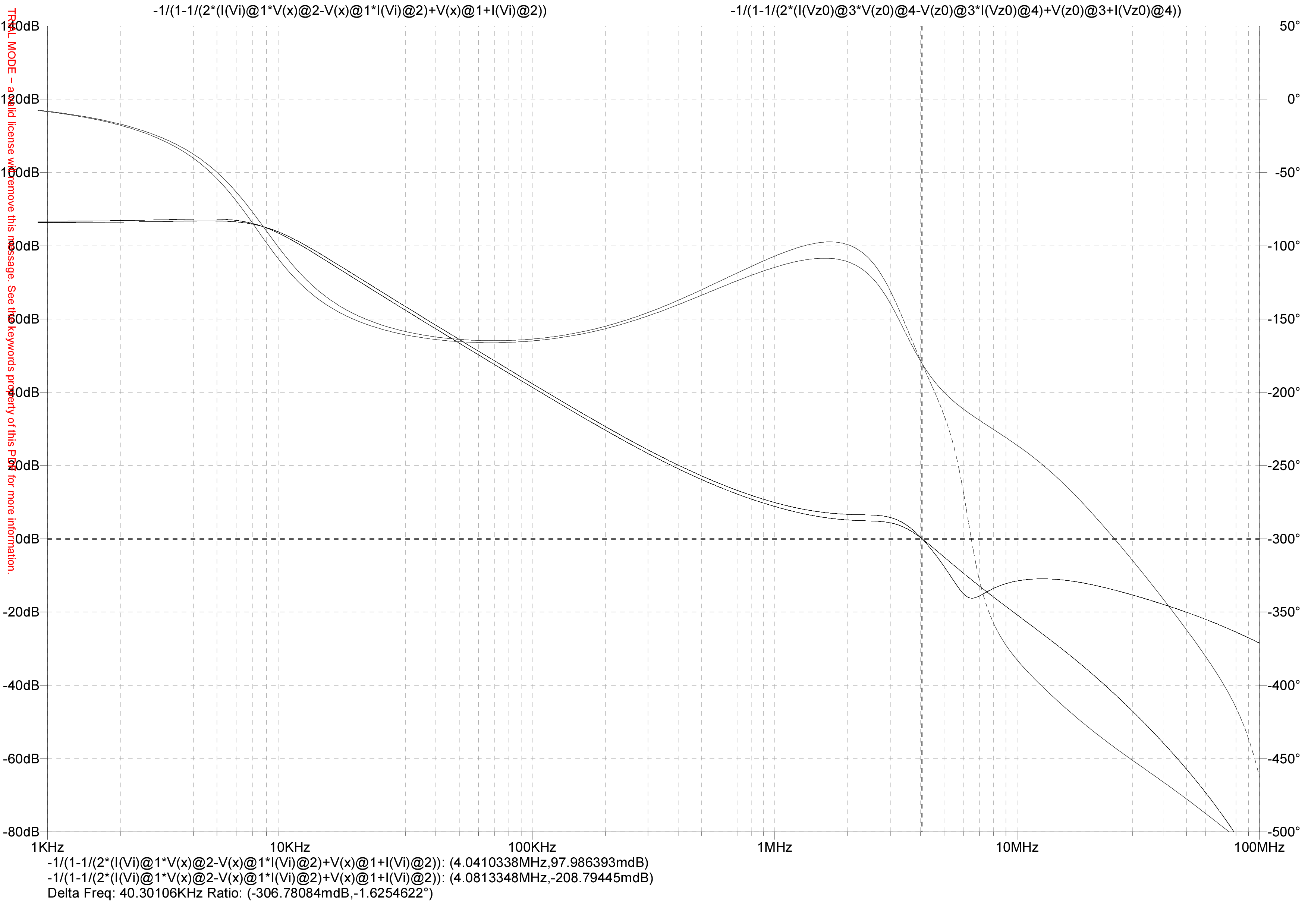

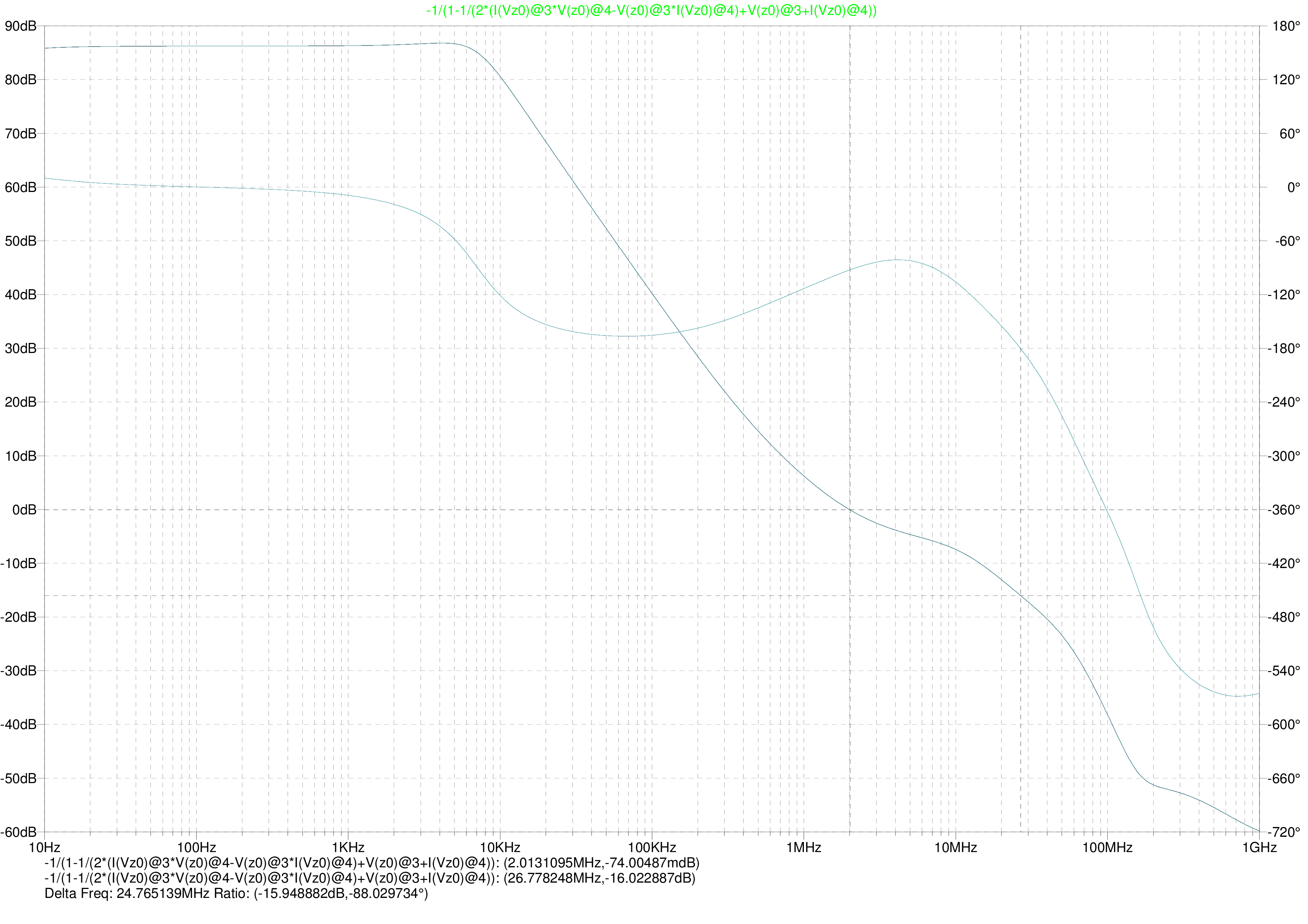

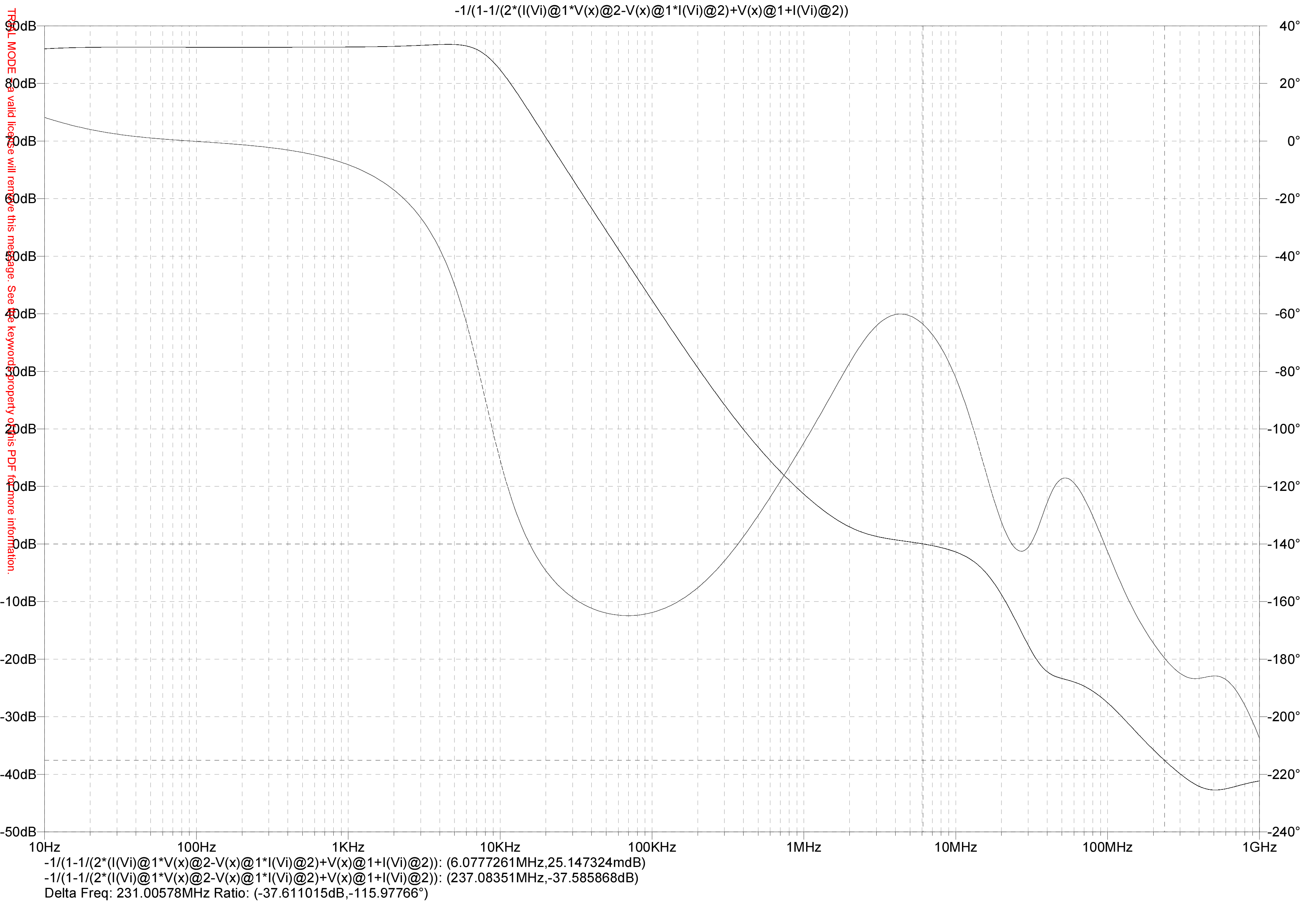

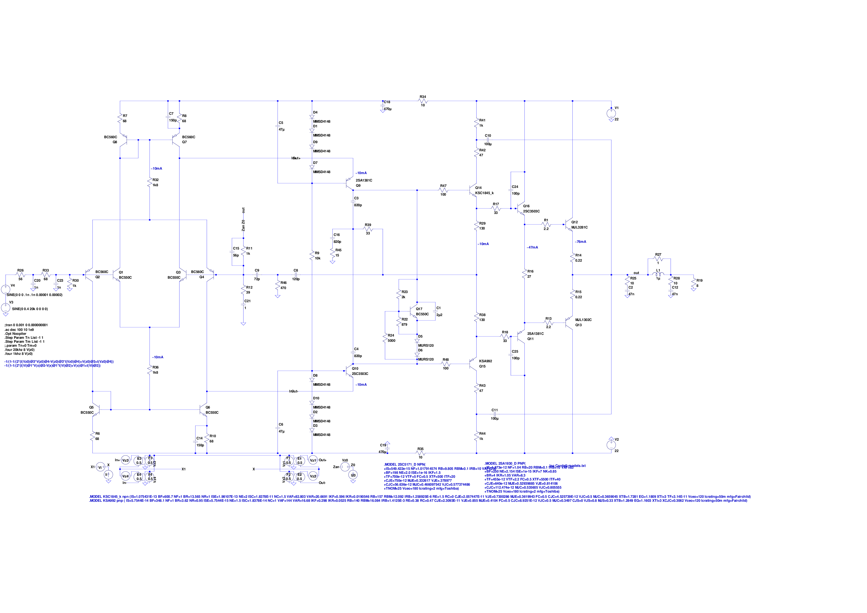

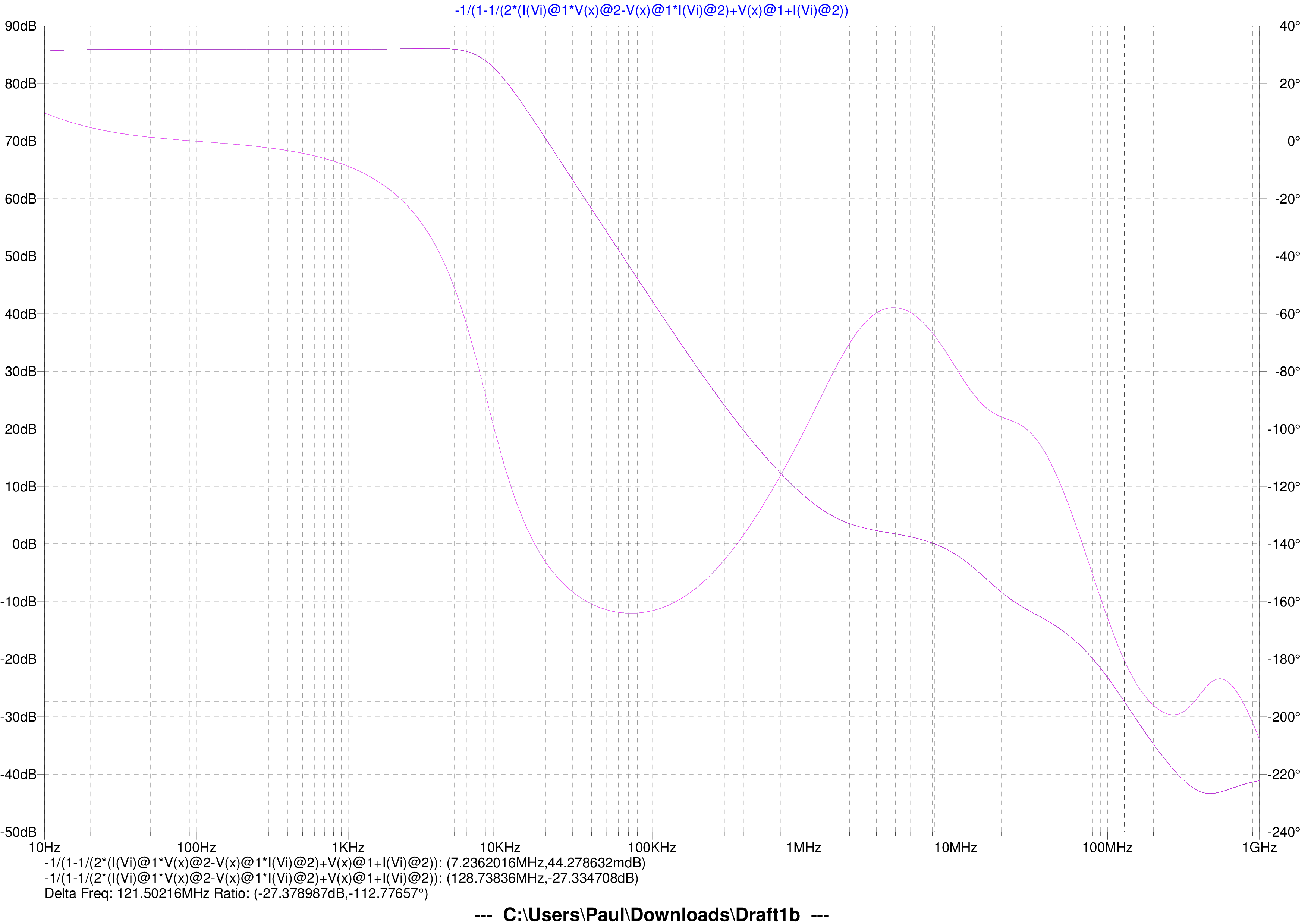

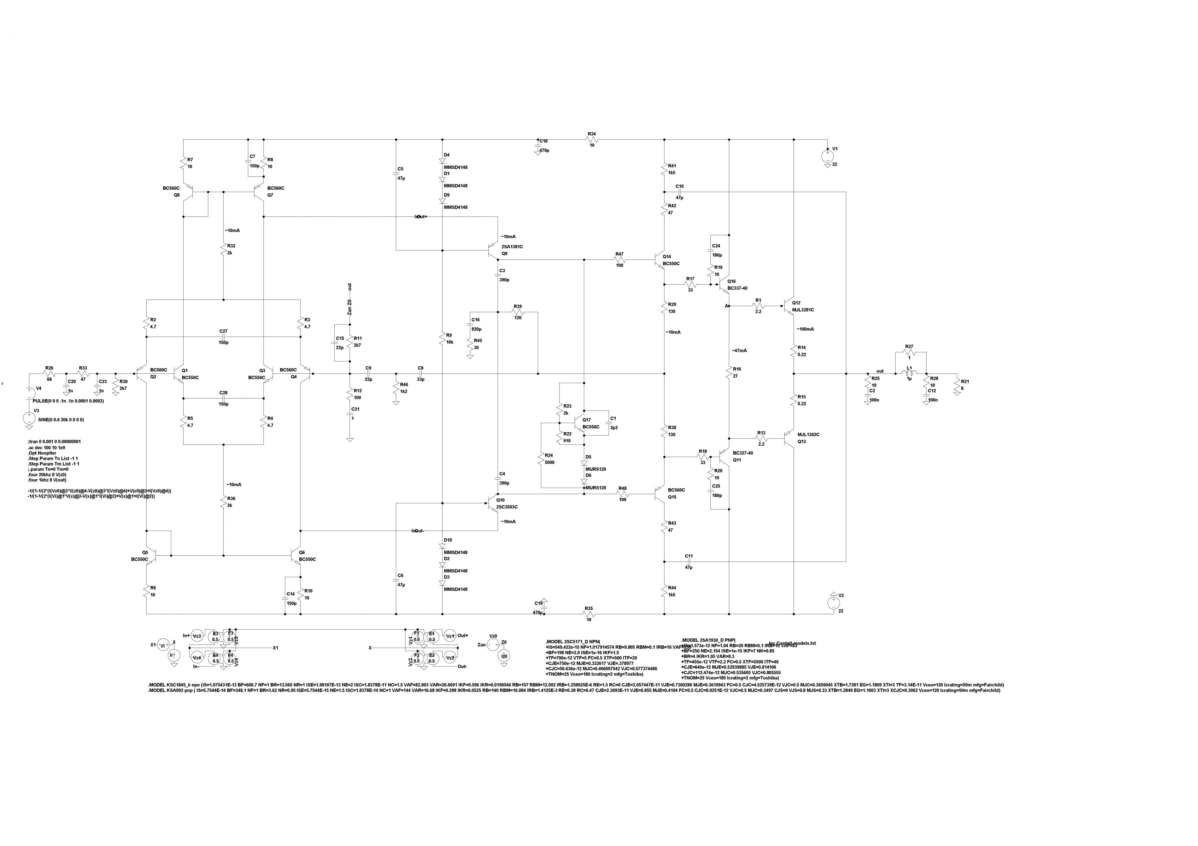

All quiet on the lunchtime front until I decided on a partial redesign.
Been trying to get stability into pure reactive loads of 1n to 100n. The first problem was the bootstrapping on the pre-drivers. This caused large phase twists that destroyed all PM and GM.
So the first change, move to a 3EF with bootstrapped pre-drivers. Bootstrapped to keep the VAS happier. There was an increase in THD without the bootstraps.
This certainly helped matters but stability was still an issue. So the next change was to work out which loop needed the most stability. Turns out to be the VAS loop (I think 😉) which has PM = 116 degrees and GM = 37dB.
Now we have a straight 3EF and now have a natural tap off point for my compensation scheme. It also allowed some simplification (component reduction).
Front end degeneration has also been reduced to increase the loop gain. Why not if you can keep good stability margins at the same time.
One interesting point is that increasing the cap across the feedback resistor actually makes the amp less stable into reactive loads. Not quite sure why... It does increase the PM of the OPS loop but when simmed into pure reactive loads the stability margins were worse overall. Even though the OPS loop had over 90 degrees PM. It's less important for the OPS loop to have massive PM. One nice thing about this amp is that it gets more stable as it heads towards the rails.
Also settled on Thermal Trak output transistors. They don't really add much complexity and I think are a neater solution. 🙂
On to the attachments:
1) Schematic
2) Loop around OPS
3) Loop stability into 100nF load as per schematic
4) Loop stability into 100nF load as per schematic with C15 = 33p
5) Loop stability into 100nF load as per schematic with C15 = 22p
6) Clipping
7) Loop around VAS
Think that's enough of an essay for now.😉
Paul
PS Apologies for the red trial version writing on the attachments. Sick of rebuilding this PC (haven't got a recent image) and haven't got any more patience until I get an SSD. 😉

BC327/BC337 as OPS driver?
BR, Toni
Thank you for pointing this out, it was an experiment... How could I have missed changing them back to the 2sa1930/2sc5171 pair?
Paul
A little update...
Corrected the mistake pointed out by Tony. 🙂
Looks very stable in sims. 🙂 See loop gain plots.
Loop V(z0) PM = 88 degrees GM = 16dB
Loop V(x) PM = 112 degrees GM = 27dB
Paul

Hi Paul
Just been at the beach so I haven't had a close look at this but a few quick comments.
I think the simpler EF3 makes sense with this circuit and like the simplification it allows.
I have tried a CFP + EF but it didn't simulate as well, somewhat to my surprise.
If you plan just one pair of Thermal Traks then the 2SA1381 + 2SC3503 may be worth consideration as drivers.
They will be faster and lower capacitance, should help stability.
You need to check with your worst case load, but the smaller drivers may have adequate SOA if you don't drive the outputs into beta droop.
I think the lower LTP emitter resistors make sense for the reason you note, more loop gain, and a bit lower noise as a bonus.
It does reduce the effectiveness of the zero from the capacitor a little.
Hard to optimise this analytically, for me anyway.
What's the limitation to make it even smaller?
And what's the trade-off to increase it?
The current mirror emitter resistors probably would benefit from an increase.
Lower noise and the zero will be more effective.
Best wishes
David

Ah the beach. 🙂 No jealousy here.... 😉
I agree with using the simpler EF3. It makes sense from a design point of view. It's always nice after a period of minimal progress to have the pieces fall into place.
The idea of a CFP + EF has crossed my mind. Have tried simulating such things but as you found things weren't as good. Although I put it down to my ability. Don't really understand the CFP properly.
Nice idea worth a closer look. Only plan on using one pair of outputs as this is only a low power amplifier. Also, multiple pairs bring extra problems that in mind were not worth the gains.

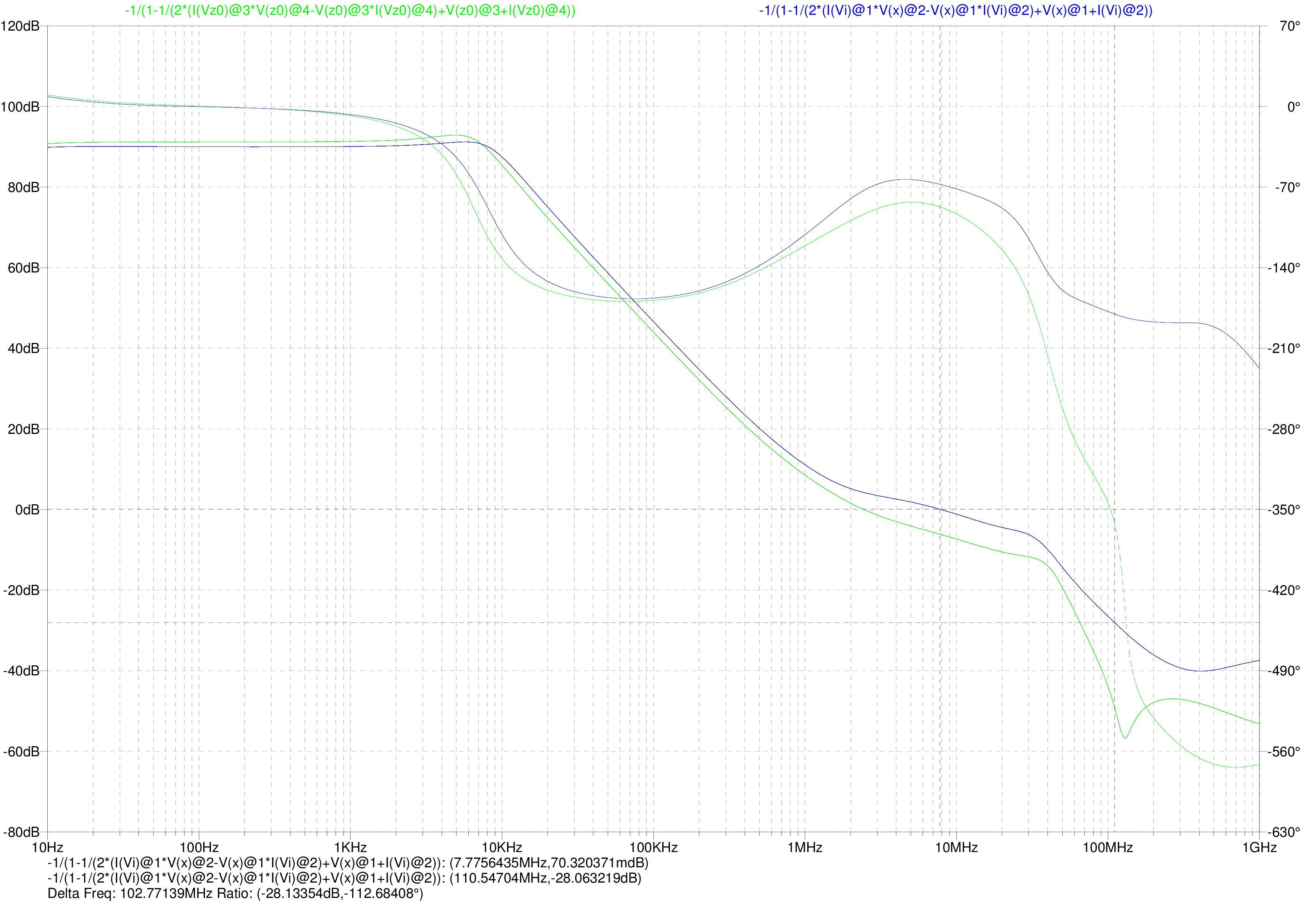

Have done a basic sim without the LTP emitter resistors. The result is workable after a few minor compensation changes.
An extra 3dB LG at 20kHz. Around 6dB of extra loop gain up to the pole at 10kHz.
Stability after emitter is now:
Loop V(z0) PM = 86 degrees GM = 14dB
Loop V(x) PM = 108 degrees GM = 23dB
As expected you have the classic trade off: Performance vs Stability.
It is still good into reactive loads though. 🙂

Increased these a little but would it not increase the voltage headroom required by the amp?
Have attached the latest .asc
Paul
Increased these a little but would it not increase the ... headroom required by the amp?
Yes, that's the trade-off.
But try for at least 260 mV across the emitter resistors, up to 1V.
And for future reference, even up to 2.6 V if you have elevated rails to the front end.

Gone for the full volt...... 😉 Live dangerously and that... Although elevated rails could be a possibility for this amp as I plan a separate PSU for the front end.
Here is another version of this amp with more loop gain and better stability into reactive loads.
Have also optimized output stage bias for lowest THD which is possibly the reason for the improved stability into reactive loads. Maybe the Gm profile is better now. Have to admit that haven't looked into this properly....
6 components lost and still got a good amp. There's probably more to come as this scheme can be optimized further... 🙂

Hi Guys
I like the schematics in the body of the post.
It looks like you have only 1uF as the shunt feedback cap? In series with 39R that does not provide much in the way of low-frequency gain extension - c4kHz. Is this supposed to be a tweeter amp?

Hi Guys
"One interesting point is that increasing the cap across the feedback resistor actually makes the amp less stable into reactive loads"
I found this to be particularly the case with CFP outputs. The problem arises with loads that are resistive too, if they are too low in value. So, I design for whatever the lowest load I expect and everything above that is happy.
Another weird thing was while compensating a simulated amp for lowest THD, the generator happened to be set at a high-ish voltage. Reducing the input signal caused the amp to oscillate. Have you encountered that?
Have fun
Have fun
Hi Guys
Have fun
The feedback cap (C21) is set to 1 Farad. 🙂 To simulate a DC servo. Which will come later. I find it just gets in the way with LTSpice convergence.
This amp has shown that exact behavior at times while experimenting with the compensation. Don't know why though. Need to look at this analytically, I think...
My mind is at it limits... 😉
... Here is another version of this amp ...
At the risk of being completely wrong, my 2 cents on the bias spreader - I'm using a very similar spreader and I believe the ratio of R24/R22 controls the proportion of temperature coefficient contributed by Q17 and the ThermalTrak diodes, so I would not use R22 to set the bias voltage. I would use R23 to set the bias voltage, but that's problematic also if the trimmer fails open, so I paralleled a fixed resistor with a trimmer to give a range of resistance.
...6 components lost... There's probably more to come as this scheme can be optimized further...
"Less is more" as Robert B. said, so I want the most less😉
More comments later, need a new Internet service.
Best wishes
David

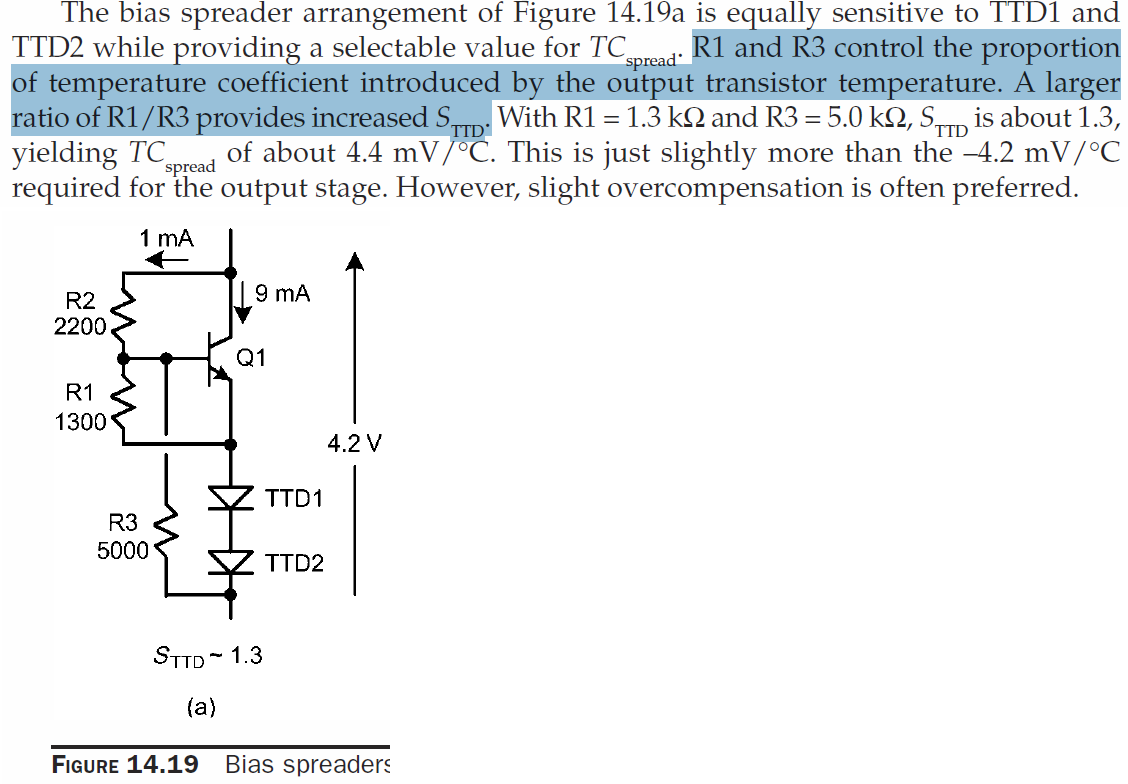

R23/R24 ratio defines the multiplication factor for the TT diodes tempco and R22 does not influence that. Correct way to set the bias is to use variable R22.
Hi Dadod,
Could you elaborate this. My remark was based on Cordell Book p.306 (extract attached), is it one of those cases where there is an erratum in the book?
Thanks and regards.
