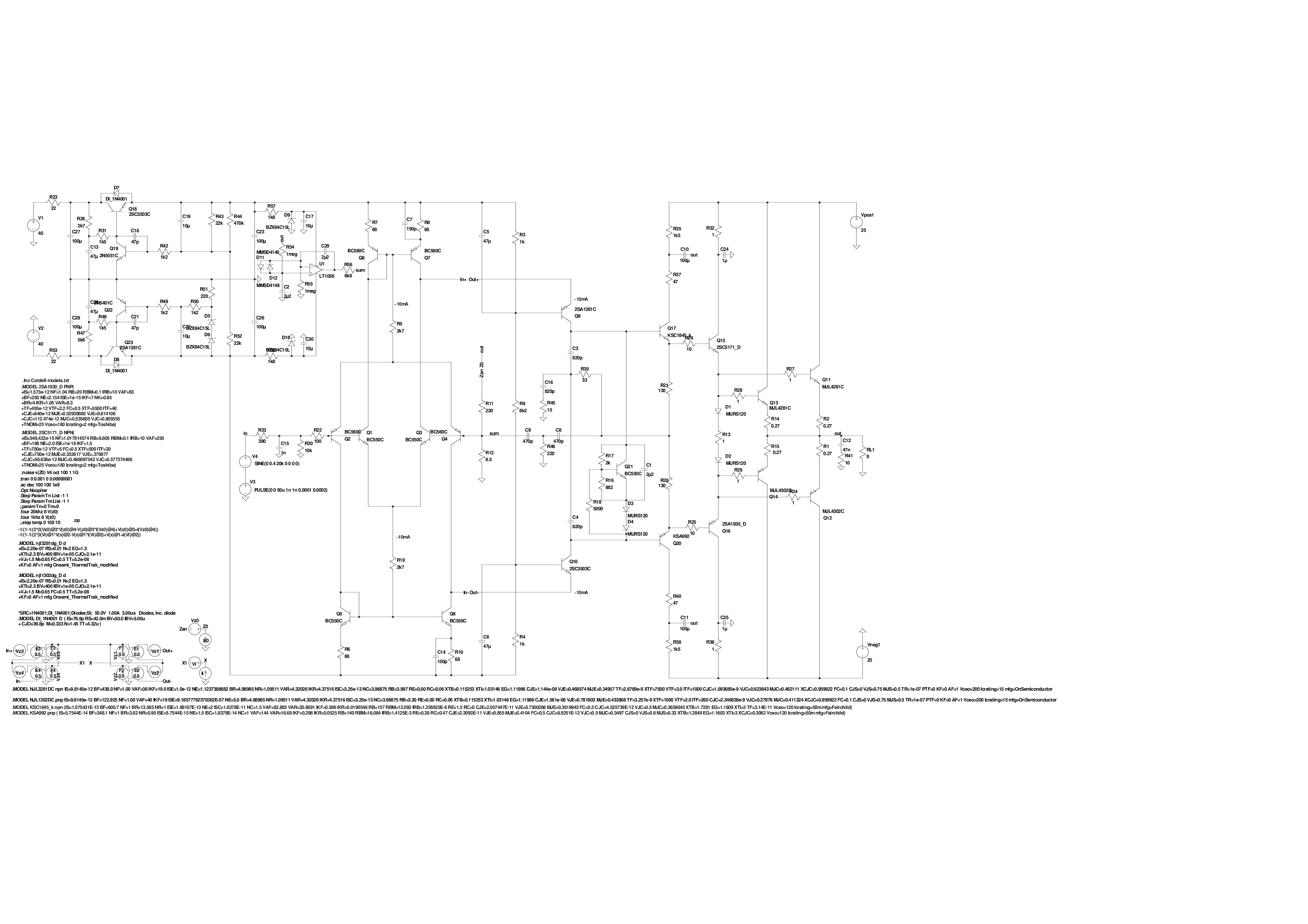

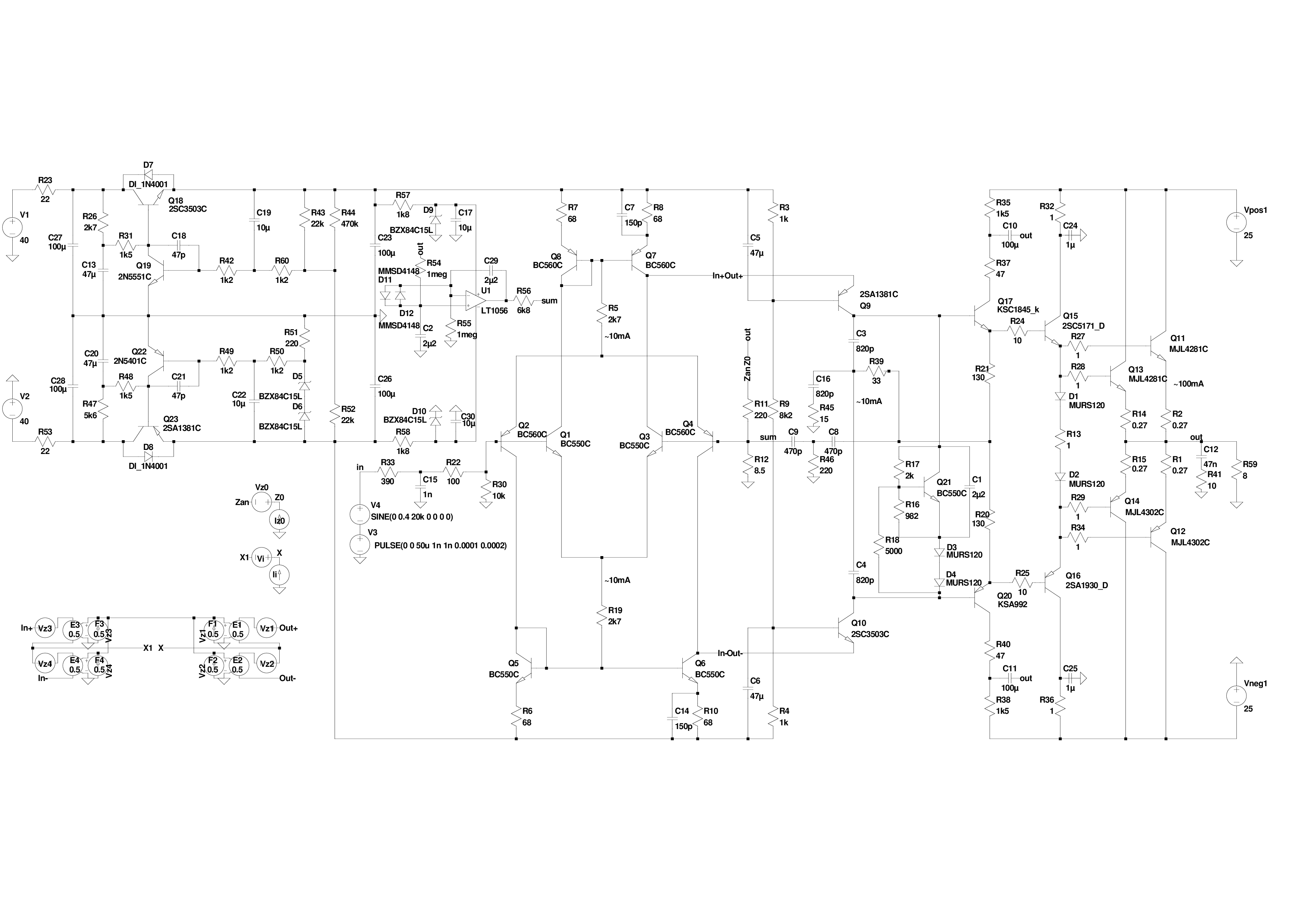

Redesign 2
The evolution continues...
This is the next experiment. Have tried to remove complexity where possible and to simplify things within the amplifier itself. Have removed some complexity from the front end and moved it to the front end PSU. As long as the front end rails are stable, minimal ripple and at defined voltages then I don't see any penalty.
A minimalist DC servo has been added. It's not strictly necessary as the first version of this amplifier (DC coupled) has been playing at work for weeks and the offset problems have not been an issue.

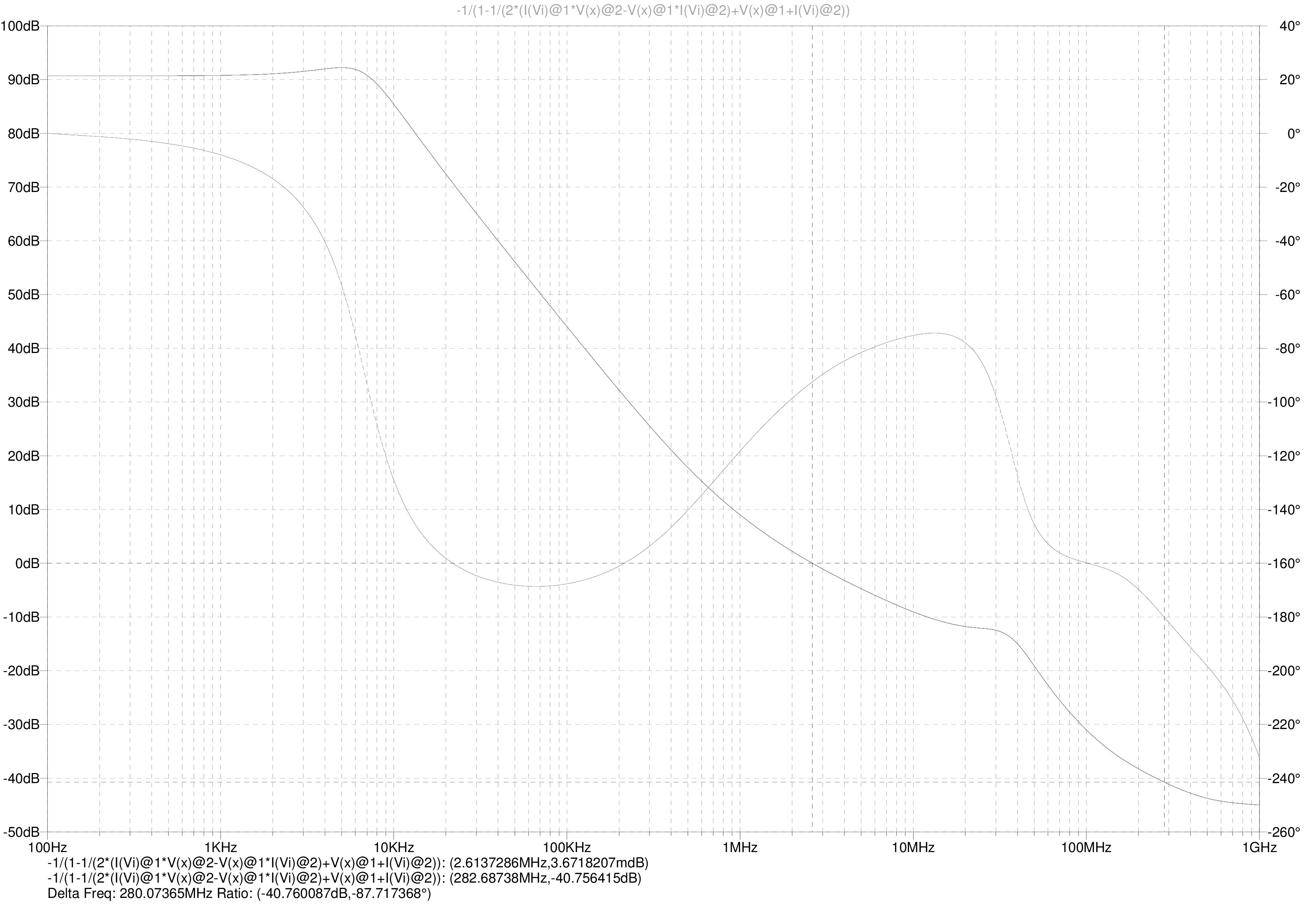

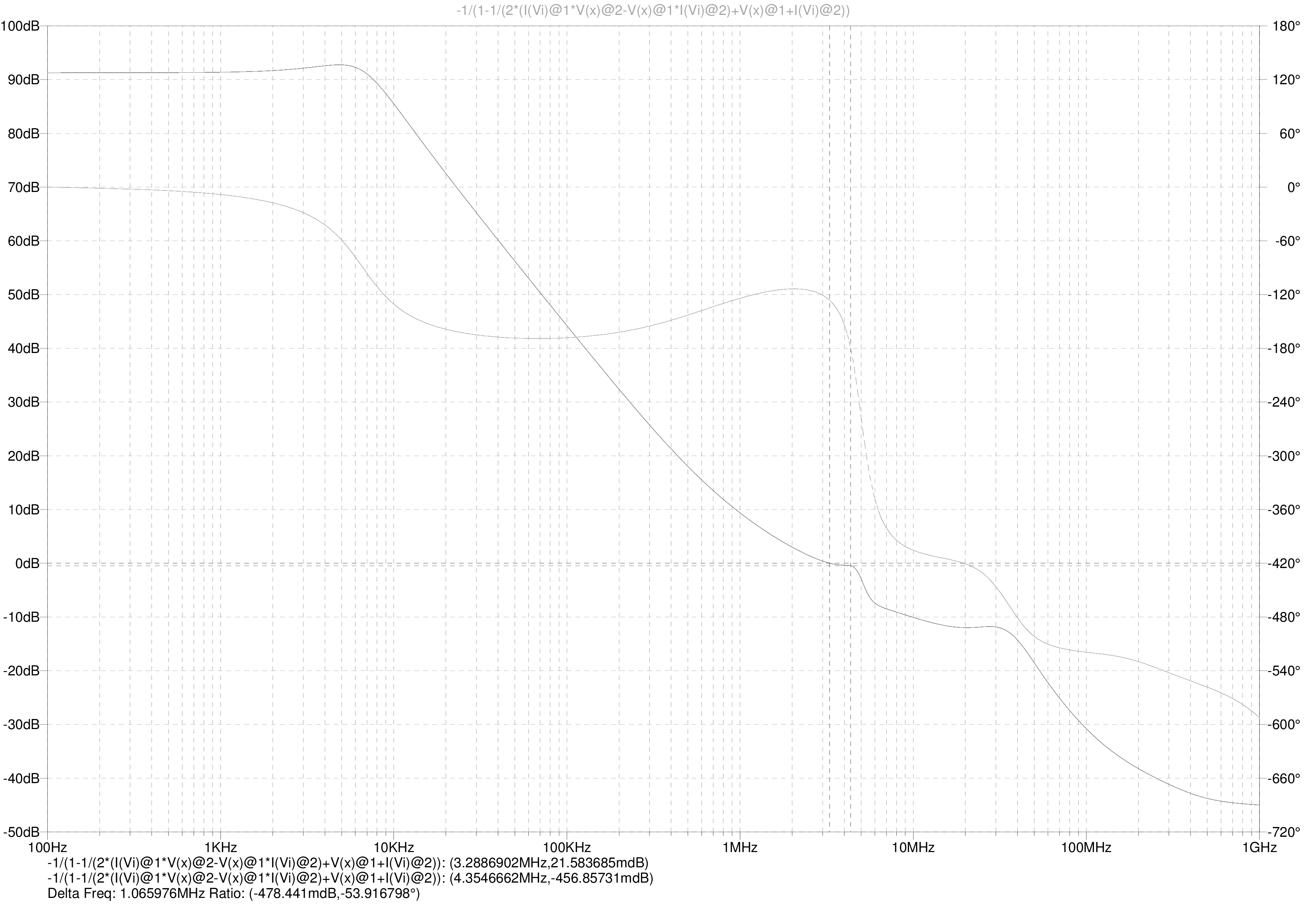

The most interesting part is the stability plots. Through experimentation with worst case loads have found that GM is far more important than PM for this amplifier. The plots look sub optimal at 0V output into a resistive load. And that the VAS loop is the critical one that requires massive GM. Maybe its to do with the bootstrapped shunts....?

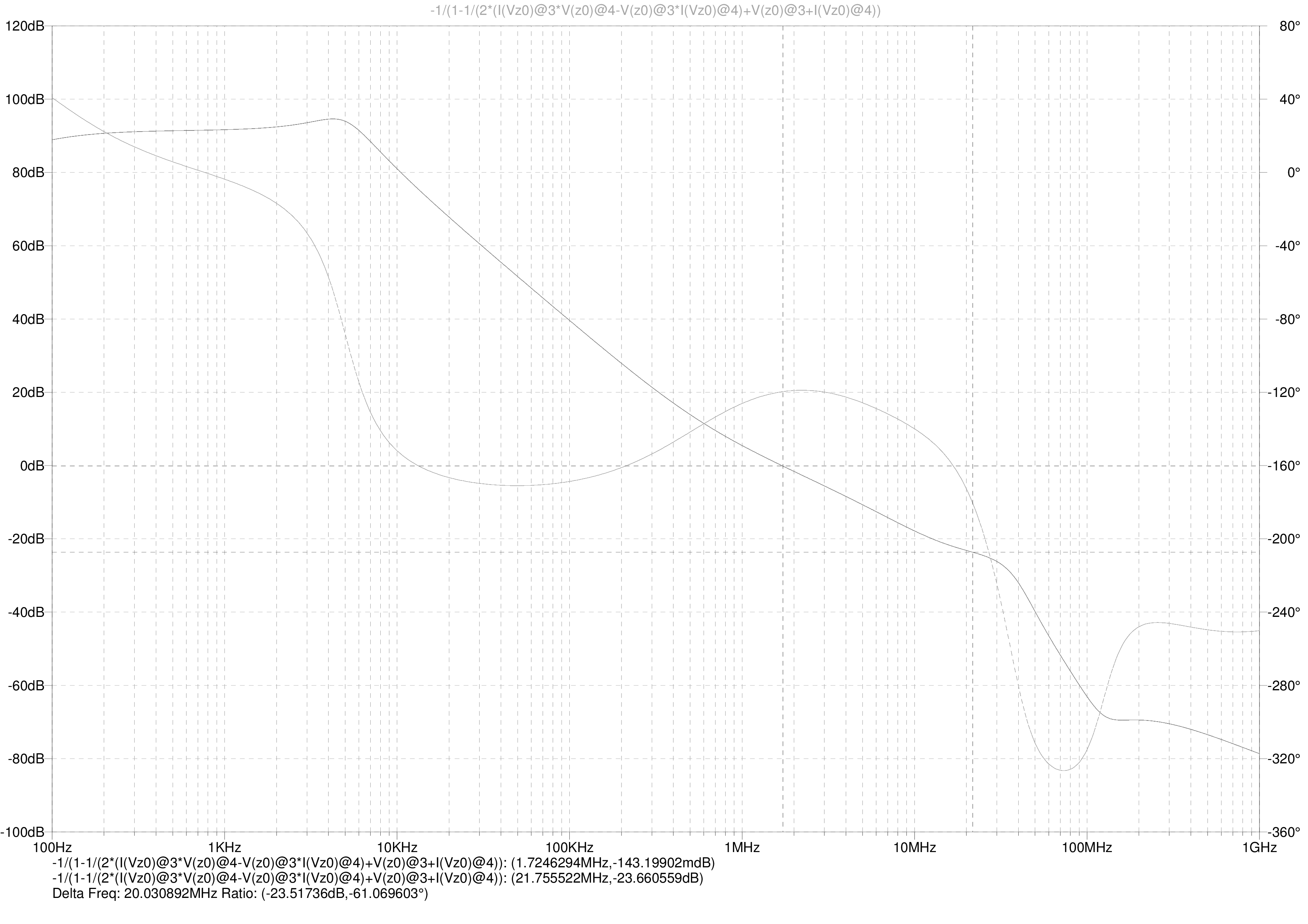

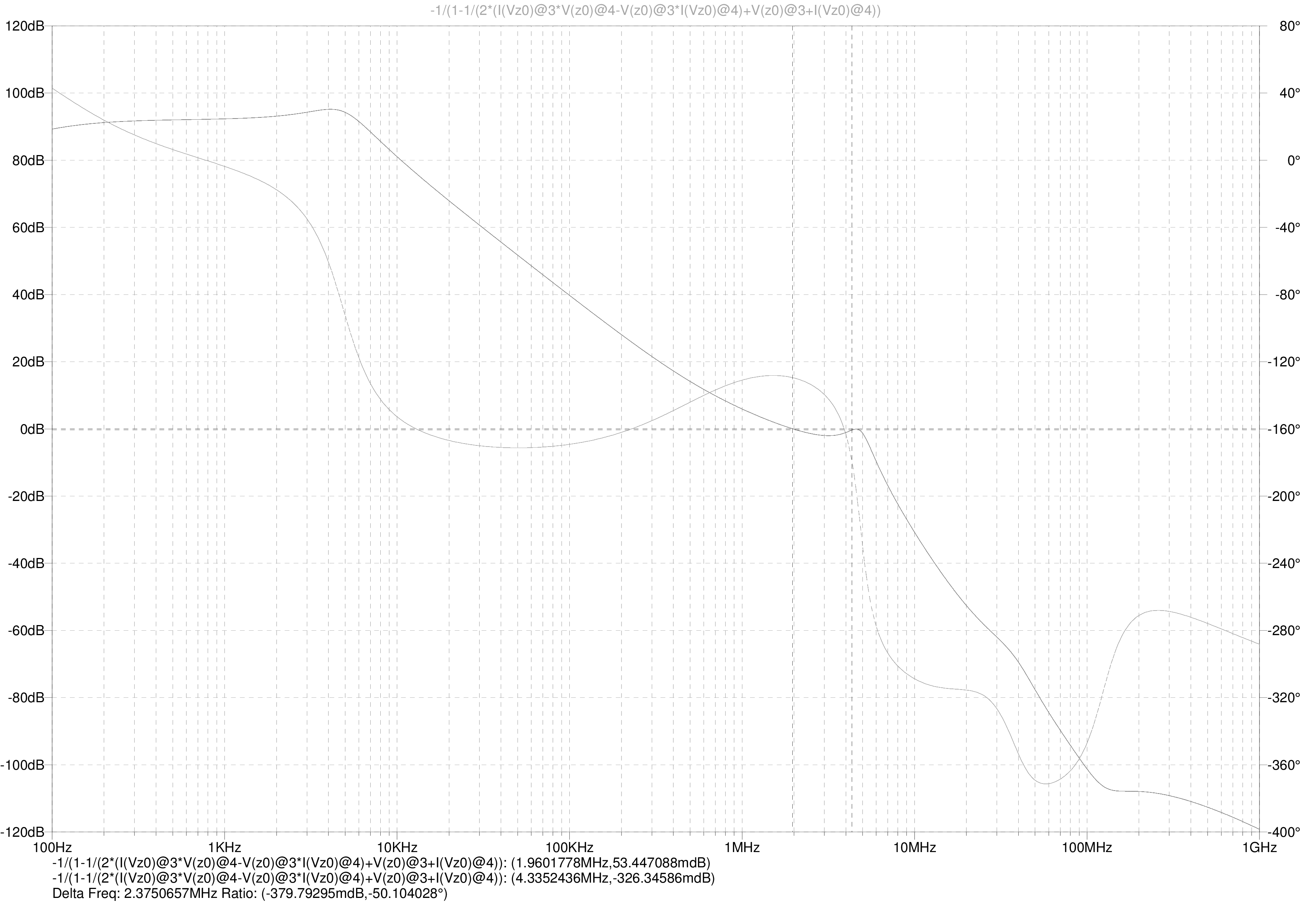

Attached is the schematic and some loop gain plots. The first two plots are of the output stage loop and the VAS loop at 0V output into an 8R load. looks sub optimal in that the it looks like more PM can be had through optimization. This is the wrong way to go. If you optimize this way when the amp is presented with a pure reactive load the VAS loop goes unstable. Optimize for GM and things improve into pure reactive load. See the next two loop gain plots for OPS loop and VAS loop. These are into pure 100nF (no resistive element series or parallel).
Loop Vx (VAS) into 8R with 0v amp output: PM = 88 degrees Gm = 41dB
Loop Vz0 (OPS) into 8R with 0v amp output: PM = 60 degrees Gm = 23dB
Loop Vx into 100nF with 0v amp output: PM = 54 degrees Gm = 0.5dB
Loop Vz0 into 100nF with 0v amp output: PM = 50 degrees Gm = 0.4dB
Need to try and understand why GM is so important to this amp.
And for the THD20: 0.4V from clipping into 8R = 8ppm 😉
Thank you for reading the ramblings of a madman... 😉
Paul

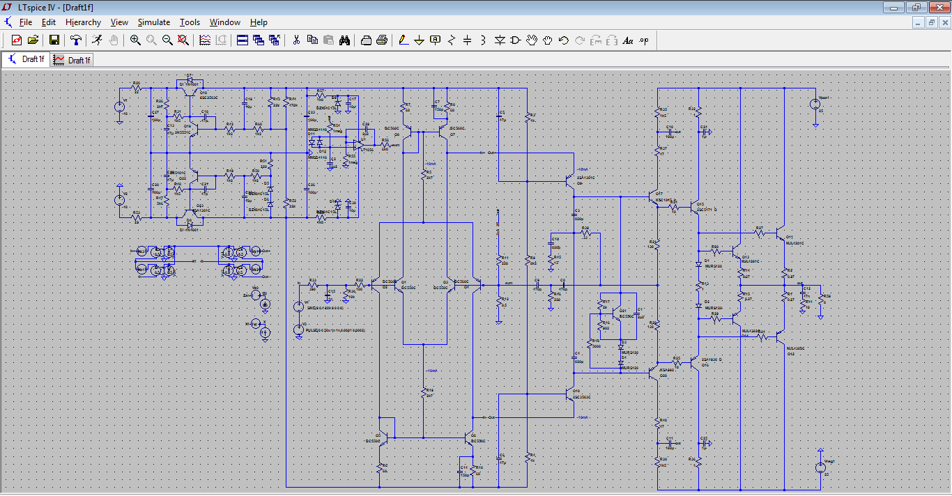

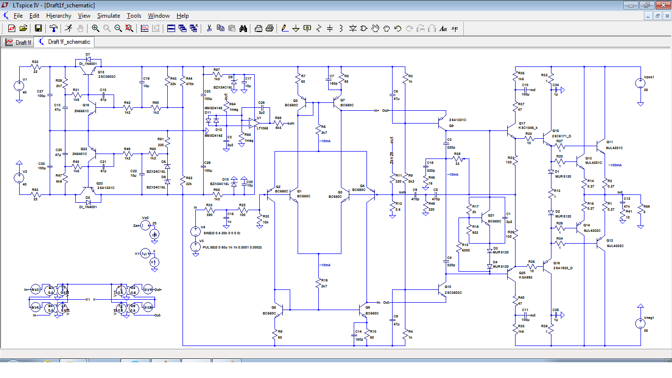

I really don't like those big picture, if I need to scroll the screen to see some detail I lose other part from the view, I lost interest.
Could you make those pictures just big enough to fulfill the screen or a bit bigger, but not much.
Damir
Hi Damir,
Is this any better?
Paul
P.S. Don't blame you for losing interest. 😉 Need to get this attachment thing right.
edit: Image quality isn't the best. Think I need to make the schematic a little smaller in LTSpice.

Hi Paul
Nice to see you continue to develop this one.
I suspect that your results reflect the lack of an output inductor, did you try 1 uH ?

Hi David,
The first prototype has impressed those at work. It does make a naff speaker sound good. Development continues...
Normally, would have an output inductor and second zobel. This "testing" in LTSpice was supposed to be unrealistically harsh. With a 1u inductor in place stability margins are better but that's cheating isn't it? 😉
Stability is paramount in this design so the output inductor is more of a safety belt than a necessity. Not chasing THD. It is already low enough that other external (parasitic) factors are going to be more of an issue. For example, PCB layout, component matching etc.

Hi Paul,
And I lose interest when seeing those horrible LTSpice schematics, haha 🙂 (by the way, those from Damir are the worst I've ever seen, sorry Damir).
The first thing you could do is customizing the appearance, for example changing the default setting from a gray background to a white one and turning off those distracting grid pixels.
Apart from these minor issues, please go on with your good and interesting work.
Cheers, E.

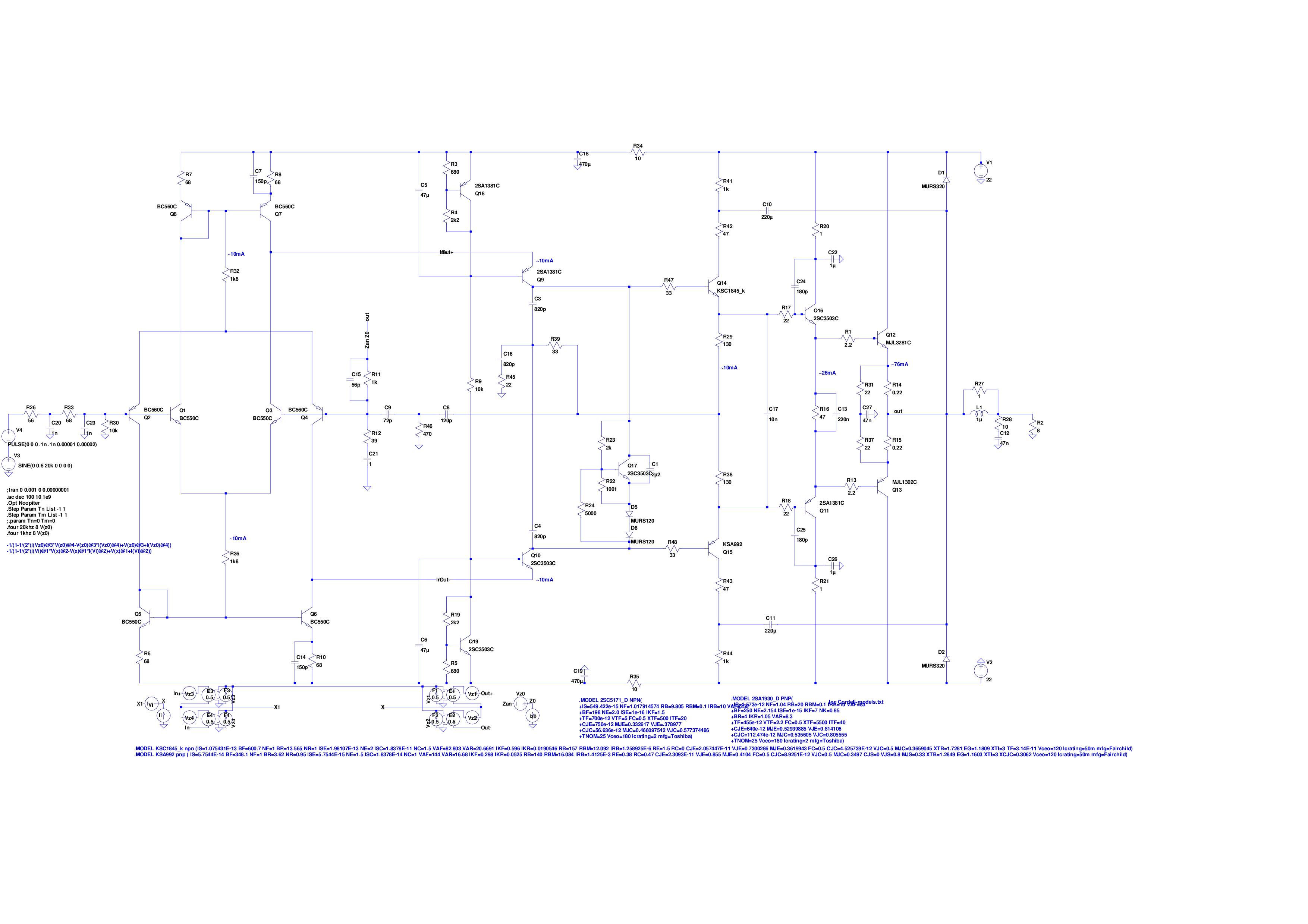

Hi Edmond,
Yes I agree, but I made progress. What's wrong with this LTspice schematic? http://www.diyaudio.com/forums/solid-state/243481-200w-mosfet-cfa-amp-74.html#post4278243 .Maybe a bit to much information on it.
BR Damir

Hi Damir,
Indeed, that looks much better, though still some lines and/or symbols are rather cramped together. Also there are several overlaps between text components and lines.
On the other hand, I do know it's a lot of work (just as any other art) to make it "ready for the press".
Cheers, E.

Hi Edmond,
For final schematic I use ExpressSCH not so good schematic software but free and result you can see here http://www.diyaudio.com/forums/solid-state/243481-200w-mosfet-cfa-amp-77.html#post4307021.
But for this one the same complain is valid I did to Paul's schematic, to big.
My apology Paul for stilling your thread
BR Damir

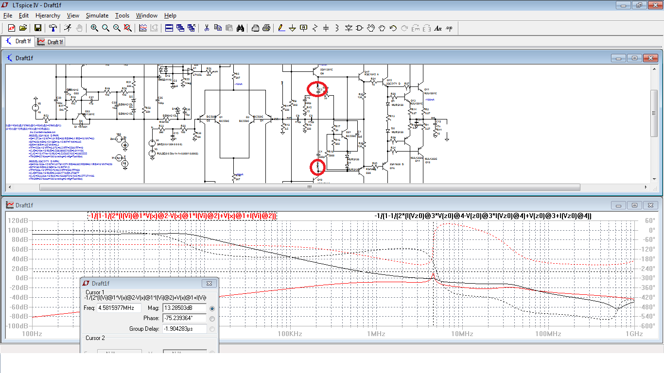

This makes interesting viewing. Have moved the differential probe to the bootstrapped shunts... Circled in red. Vz0 shows the stability of the OPS loop and the main VAS loop. The amplifier load is again pure 100nF.
Hope fully the probe placements are correct.
Paul

I don't think an output inductor is a cheat.
It only ensures a predictable load far above the audio spectrum, in reality there's speaker and cable inductance, so the Spice 8R plus capacitance load is a wildly inaccurate idealization anyway.
As usual, I find your compensation scheme difficult to analyse😉
In my own amp I have found that I can use the inevitable load of the TPC components (your C9,C8,R466) to eliminate the need for a shunt network (C16,R45).
I am not sure if it's theoretically better but it shouldn't be worse and it saves a few components, simplifies layout, more compact board etc.
But my main difficulty is C3,C4,R39 and the interaction with R21,R20.
This kind of delta network between amp sections has the potential to create multi-pole/zero compensation, a la TMC, but also to decrease performance from unintended feed-forward and RHP zeros.
Personally I don't like to use compensation I don't fully understand.
I will think some more, I have made some advances in nested loop theory.
In the mean time I would recommend you check it carefully.

Paul, I suspect that the shunt point you have probed is not indicative of a real stability problem. It isn't a "controlled source", to use Bode's nomenclature.
I had a bit of a discussion about this with Ric Lee and others on one of Damir's threads where he had a similar issue.
It is non minimum phase (due to multiple paths) and that usually means reduced stability but it doesn't seem to matter for nodes that are not sources.
So I would not be too concerned but I still don't understand it fully, ideas appreciated from anyone, as always.
