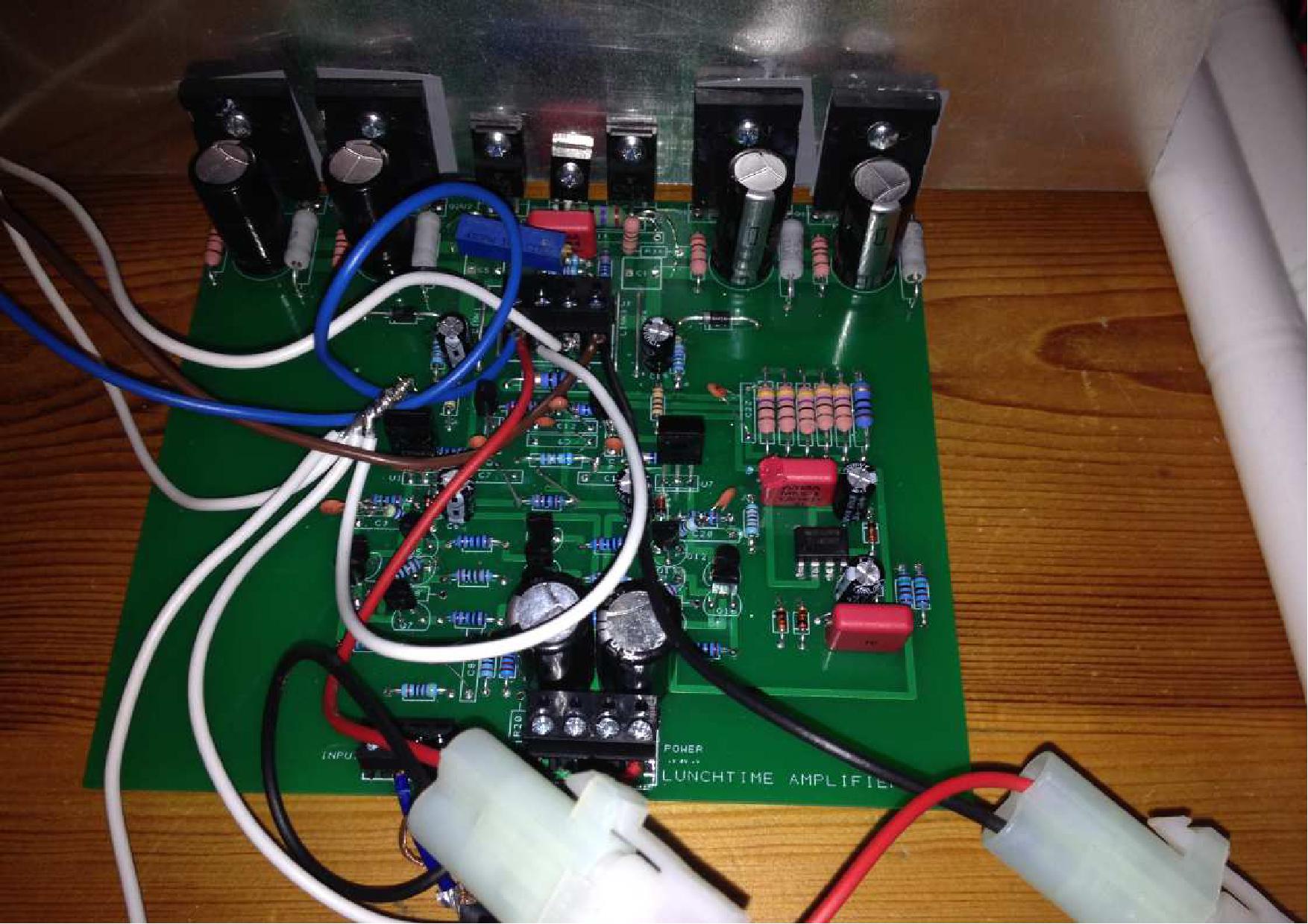

The Lunchbreak Amplifier Lives
A non thermal-trak version to evaluate compensation stability.
In the picture the TP-MIC is disabled but as I type the lunchbreak amplifier is "singing" with all but the lead compensation enabled.
Need to do some more sims and apply in reality.
Now the real fun starts.
Paul

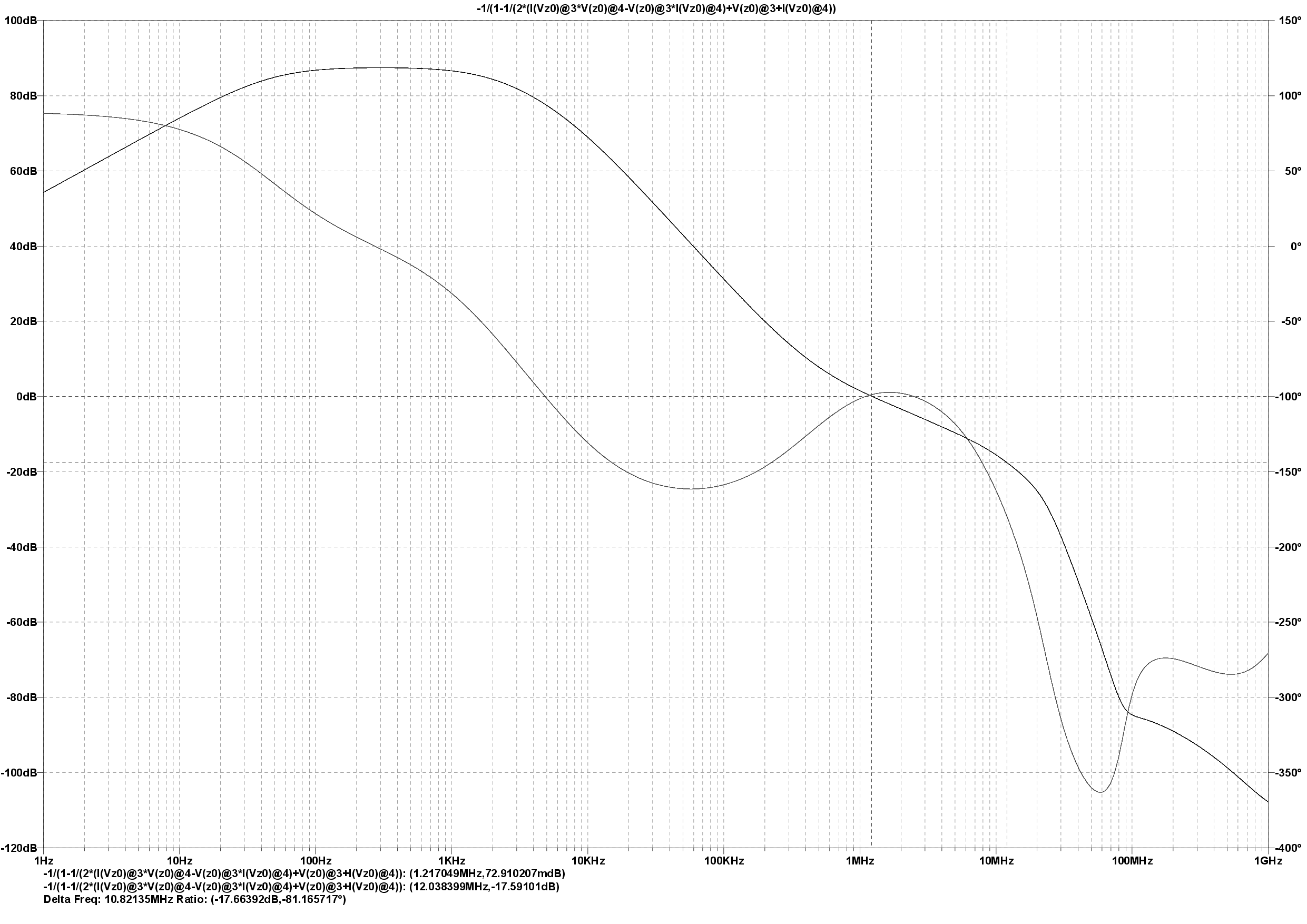

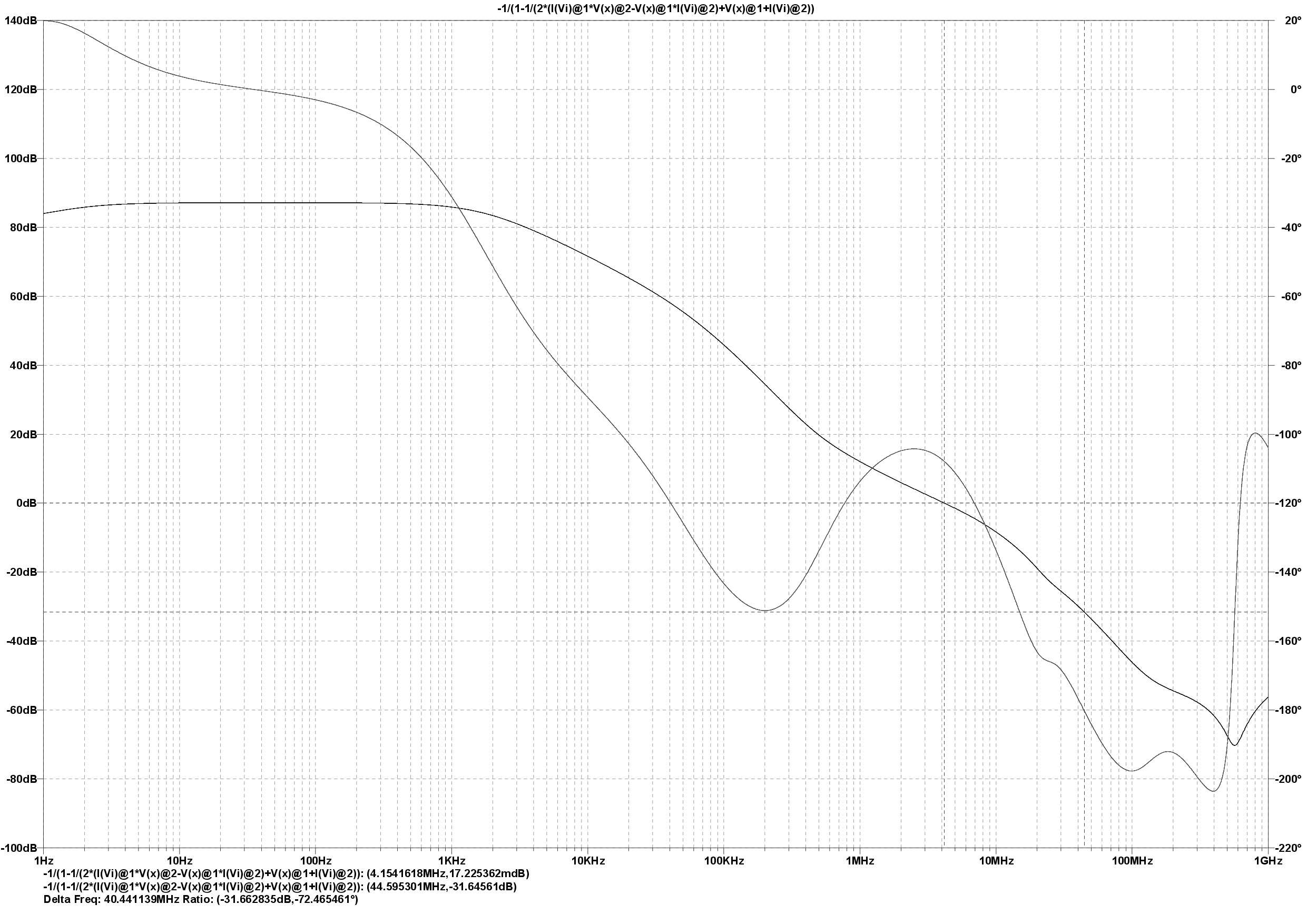

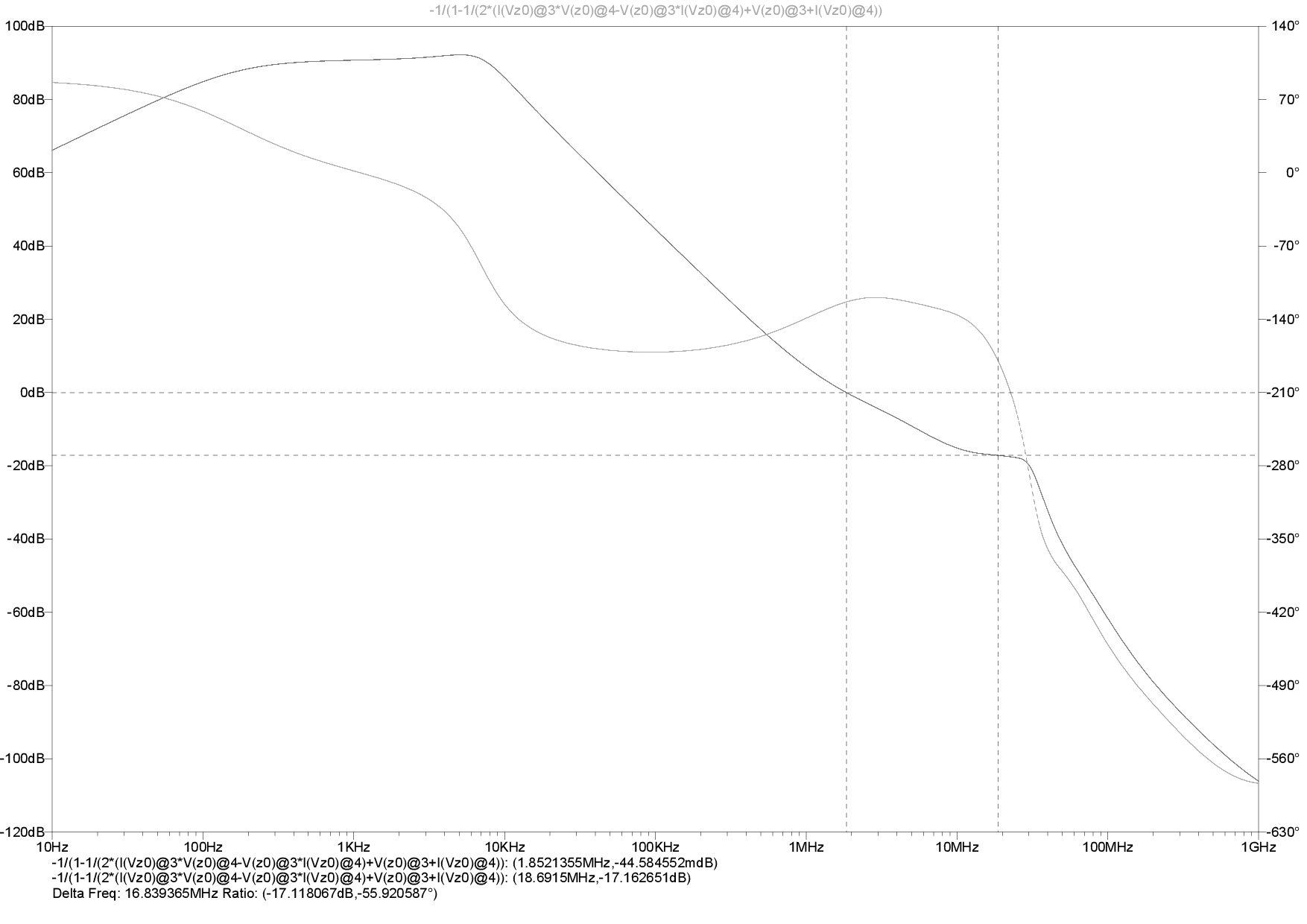

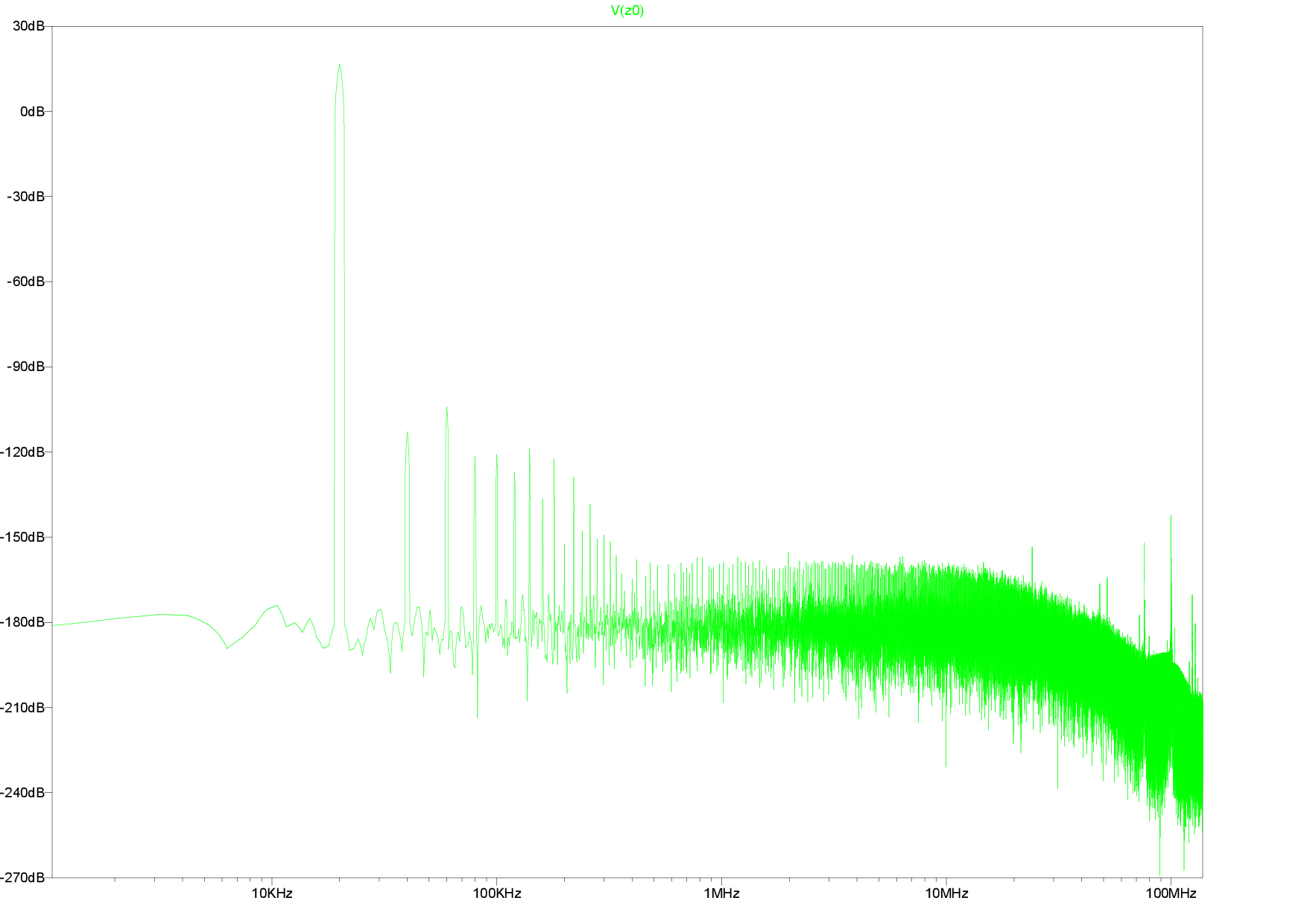

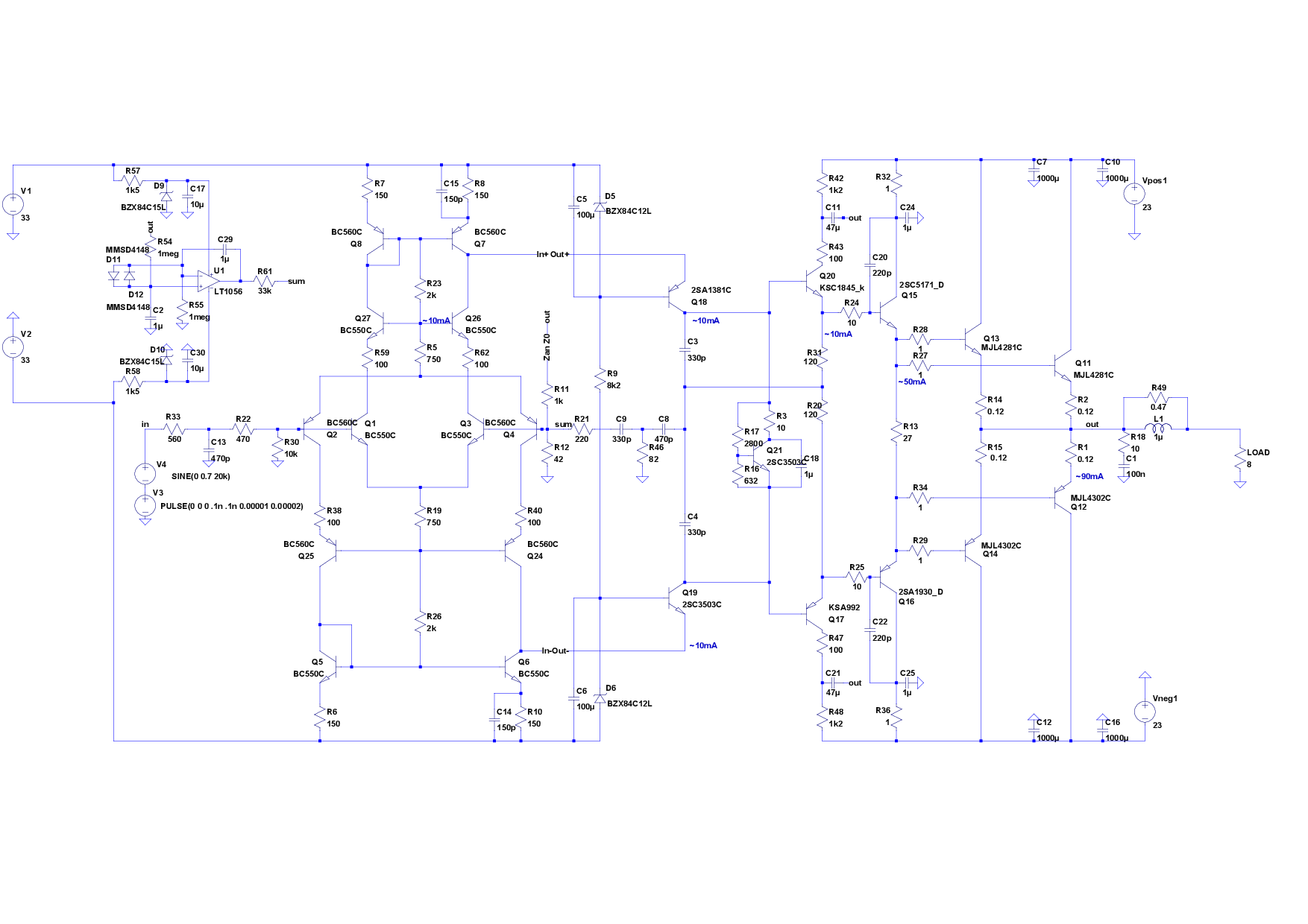

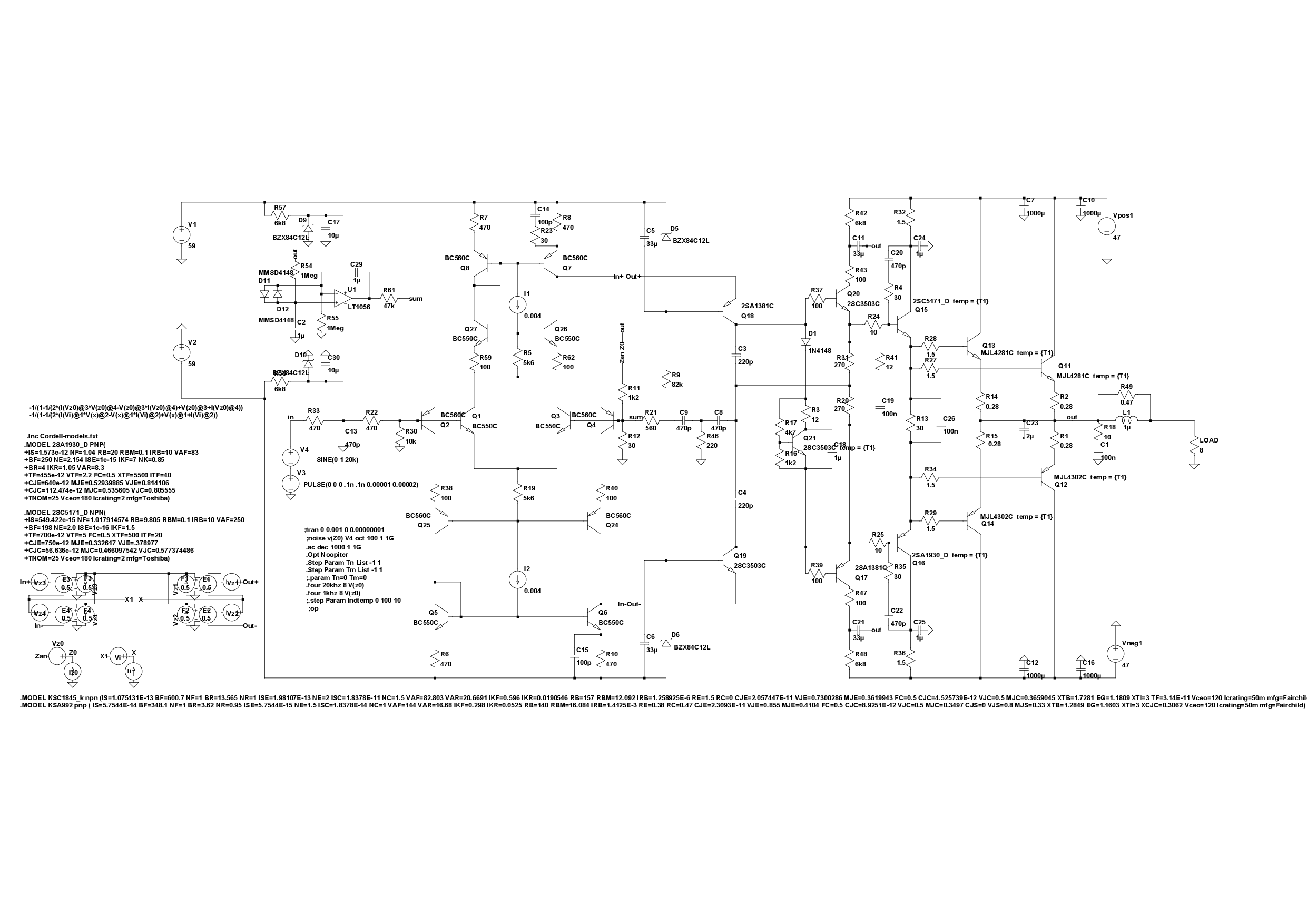

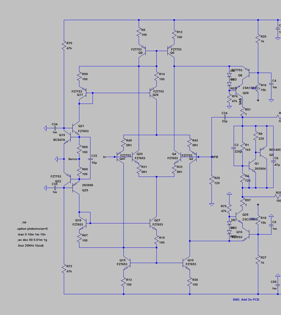

Hello all,
After the photo showing a photograph of the prototype PCB, now to give you some more details.
Start off with the basic design:
1) Front end based on Edmond Stewart's SuperTis. This time without current sources and with cascodes. The current sources will be added at at later date but I only have a very limited supply of through-hole JFets. However, have noticed in SMD there is more choice (Something for a future version ).
2) Single transistor cascode TIS. Gives the benefits of having a CMCL but without the complexity. This is detailed on Edmond's site:
Super TIS
Have found that with my compensation scheme that the Baxandall version of the TIS brings complexity but without my usable benefit. There was a big gain in loop gain at lower frequencies but nothing at 20kHz. Wonder is my compensation scheme has something to with this?
3) The compensation scheme is still made up from 2 pole bootstrapped shunts on the TIS outputs, TP-MIC, B-C capacitors on the driver transistors and some compensation on the current mirror degeneration.
4) Dropped the Thermal-Trak for the moment and have opted for a plain 3EF with bootstrapped Pre-drivers to minimise the effect of non-linear Cob loading on the TIS.
5) Basic DC servo used so that low values of resistance can be used for the feedback network.
6) Boosted front end power rails.
Think that covers the main features. The circuit posted here is a working circuit. Any suggestions are most welcome

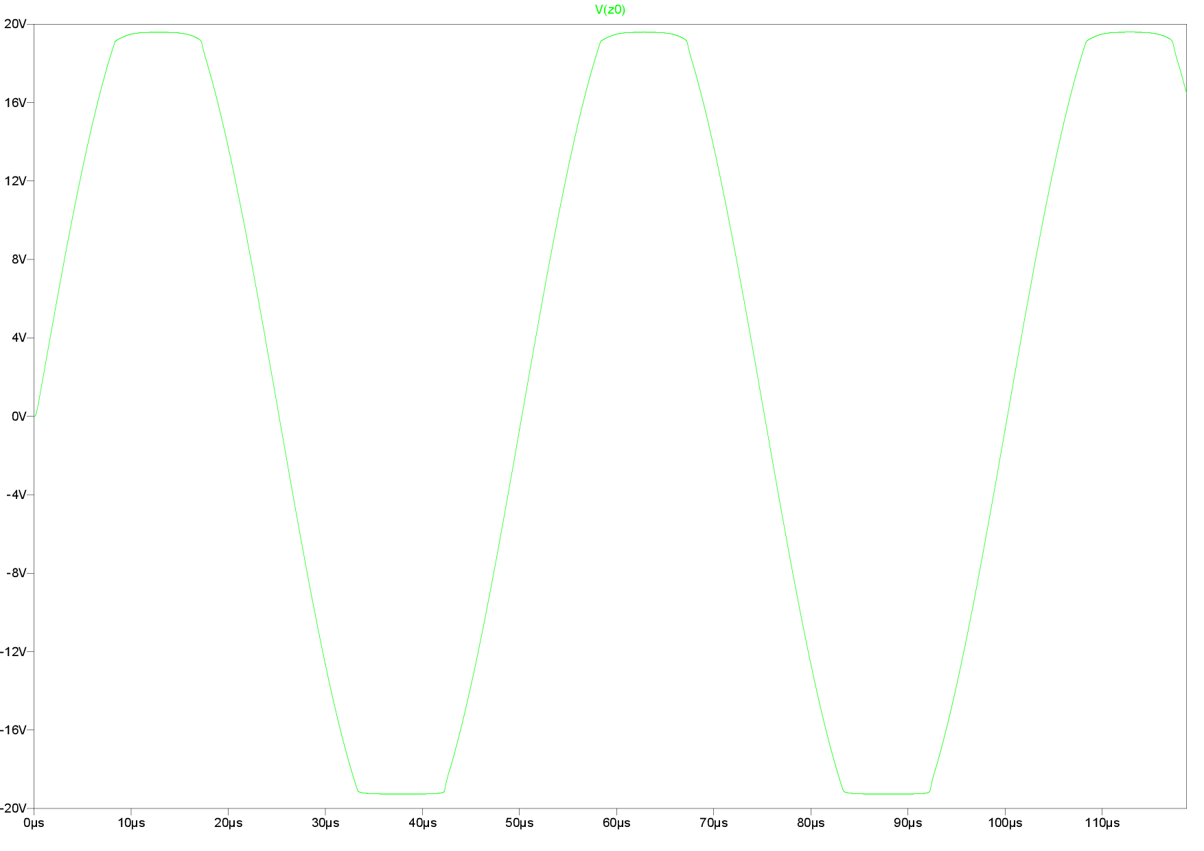

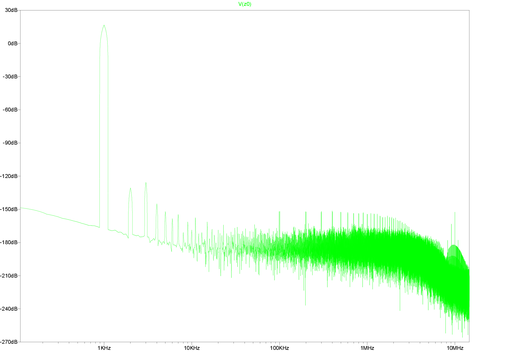

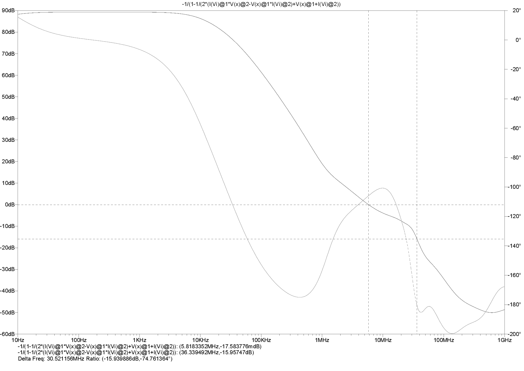

Some specs from simulations:
THD20K (0.5V off clipping +/- 19.3V): 0.002456%
THD20K ("half power" +/- 9.5V): 0.000103%
THD1K ("half power" +/- 9.5V): 0.000009%
VAS loop stability: PM= 75 degrees GM= 16dB
OPS loop stability: PM= 56 degrees GM= 17dB
1) Schematic
2) 1kHz half power FFT
3) 20khz half power FFT
4) OPS Loop Stability Plot
5) VAS Loop Stability Plot
6) Clipping
7) .asc file
Hope this is of some interest to people here. The schematic and .asc file is of the working prototype.
Any comments much appreciated. Will be working towards a version 2 PCB with Thermaltrak...
Best wishes,
Paul

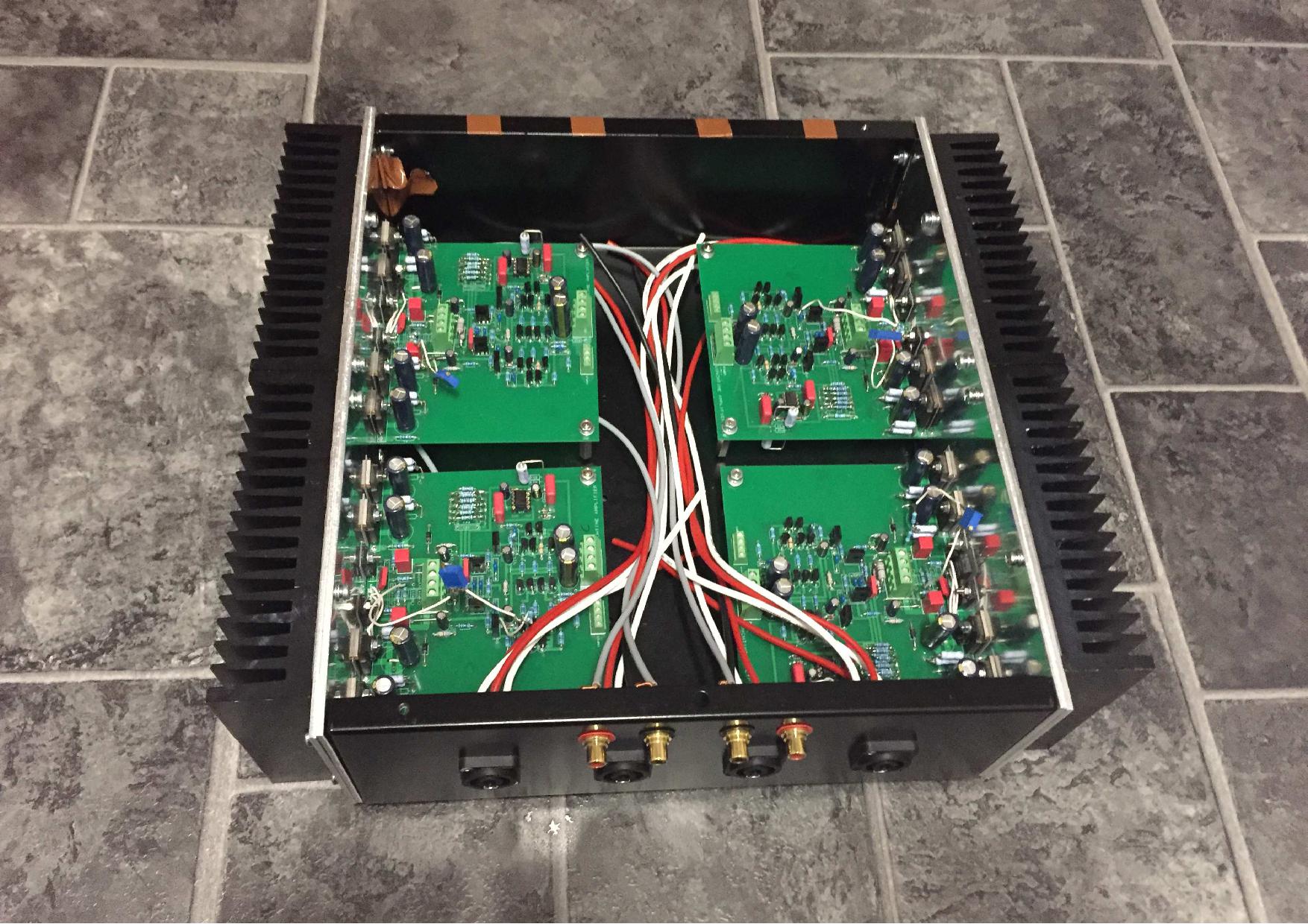

Time to resurect a 3 year old thread

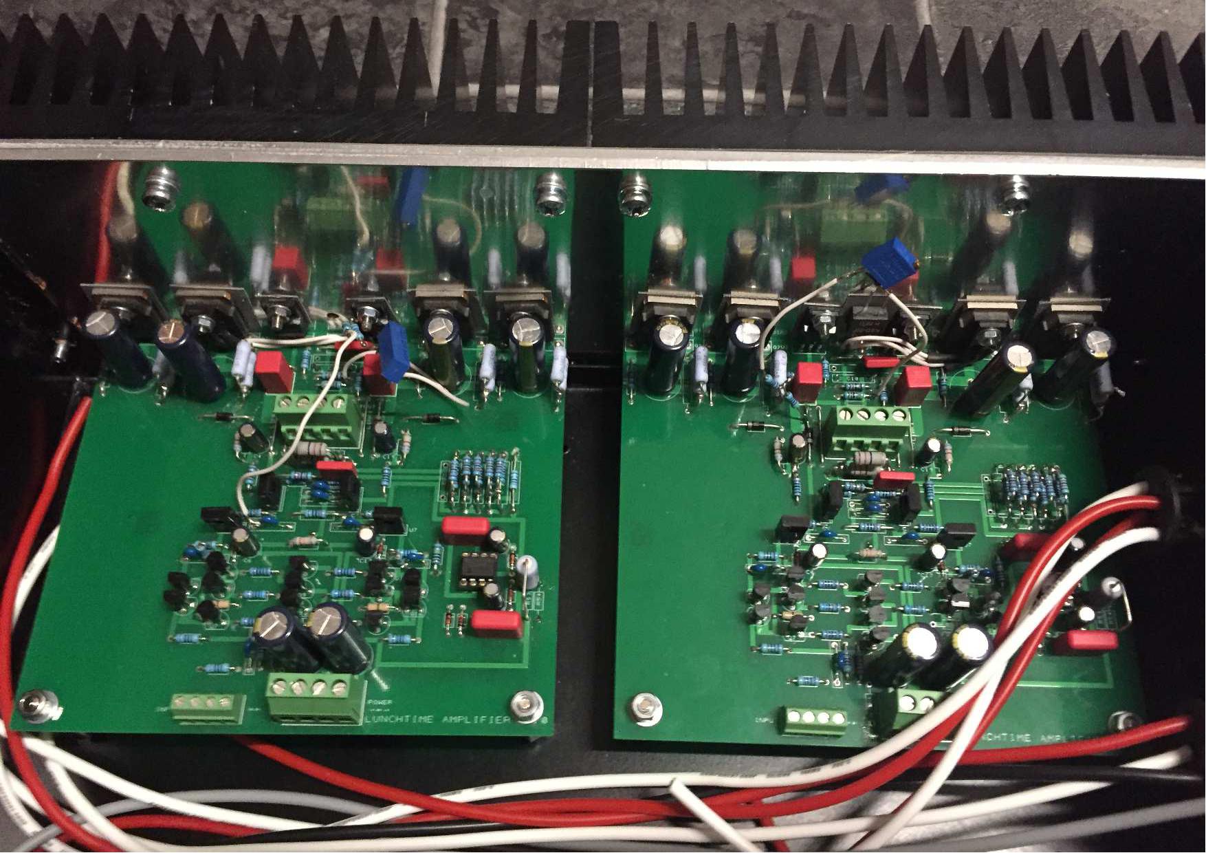

Decided to actually build this one.
Mainly using parts I have accumulated throughout the years.
These pictures of the first dry build.
Lots of work to go.
Have tested 3 of the 4 channels.
Did a quick and dirty test with some passive speakers and the results were certainly promising....
Enjoy
Paul

Hi Paul
Nice to read the outcome and see the pics, looks tidy.
It's been a while, so detailed comments maybe after I reread to come back up to speed.
Best wishes
David
Hi David,
Bet you had forgotten all about the lunchtime amp
It has been redesigned a little to run off higher voltage rails. +/- 59V for the front end and +/-47V for the output stage. The compensation has been re-tuned as well.
One thing that struck me is how close this compensation is to OITPC (Dadod). I could run an experiment and try OITPC but sims don't suggest any real gain. maybe the folded cascode isn't the ideal VAs to use with OITPC or maybe I am tuning the OITPC incorrectly.
The attached is almost an "as built" schematic. The main difference being the outut devices. The schematic has MJL4281 and MJL4302 whereas I have 2SA1386Y and 2SC3519Y. All front end transistors are matched and the LTP input transistors are a quad match.
Hi Nauta,
The outut devices are currently running at 70mA each.
Attached are the usual plots etc. Current sources are JFET (2sk246).
More pictures will follow...
Paul

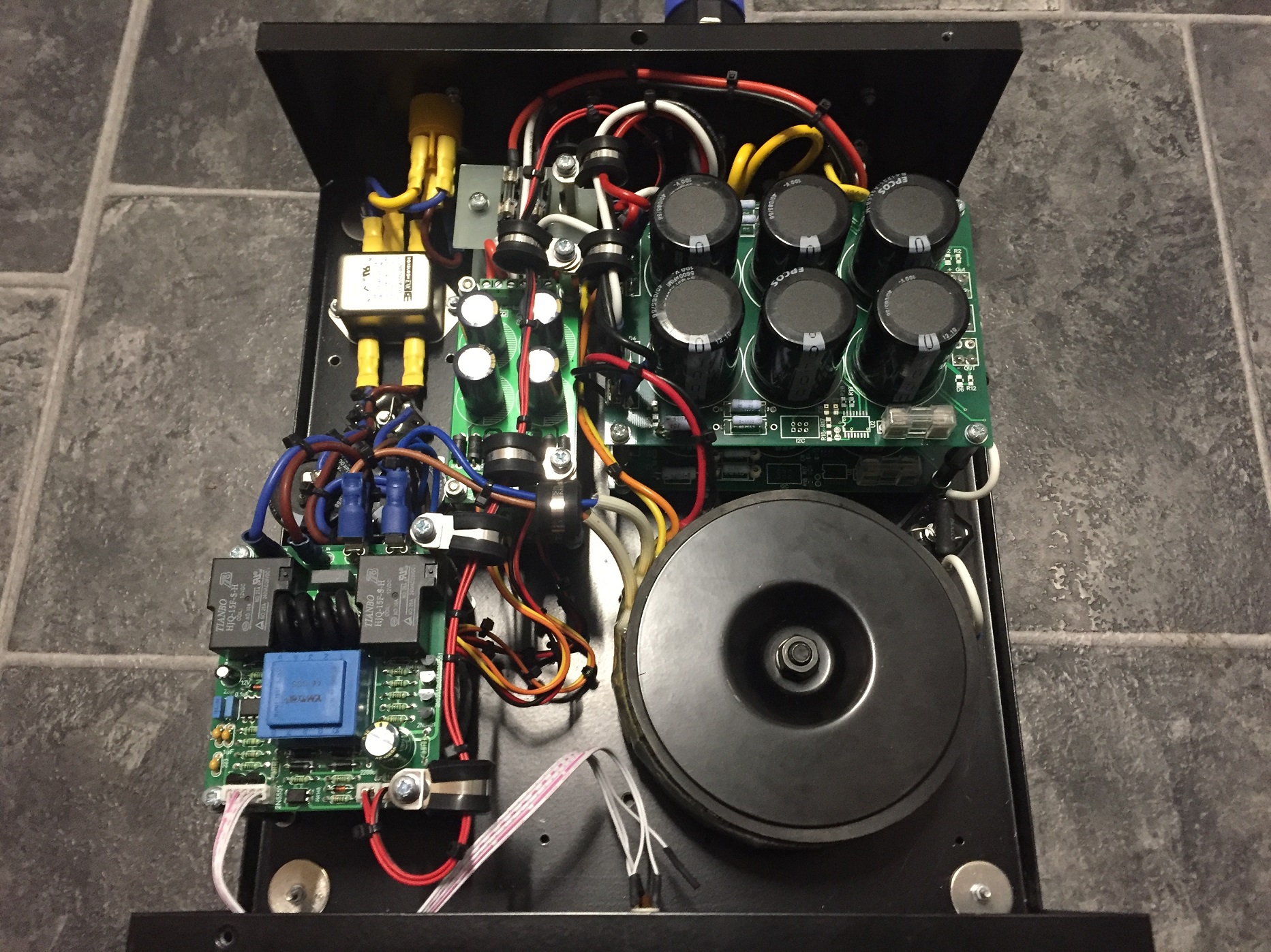

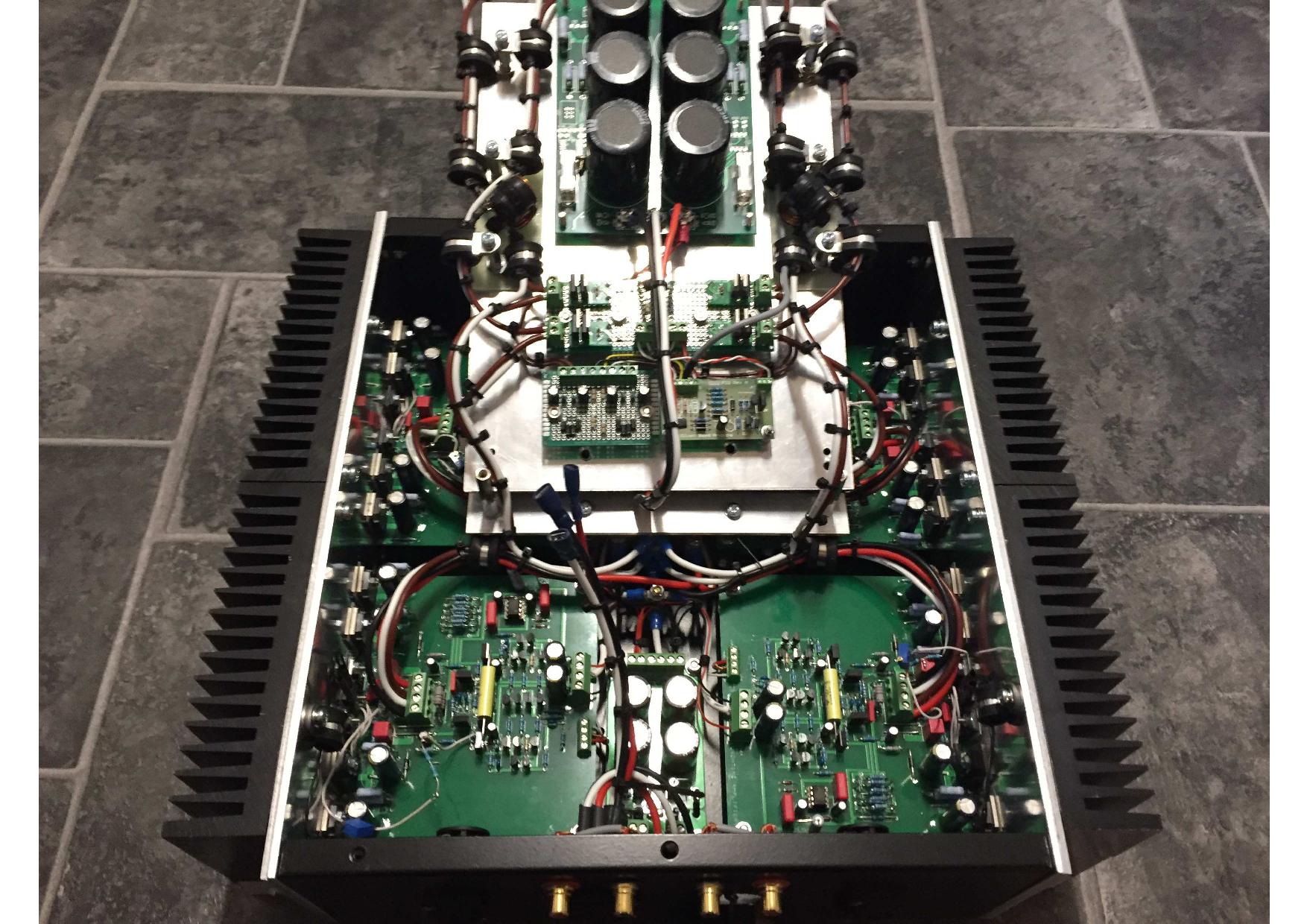

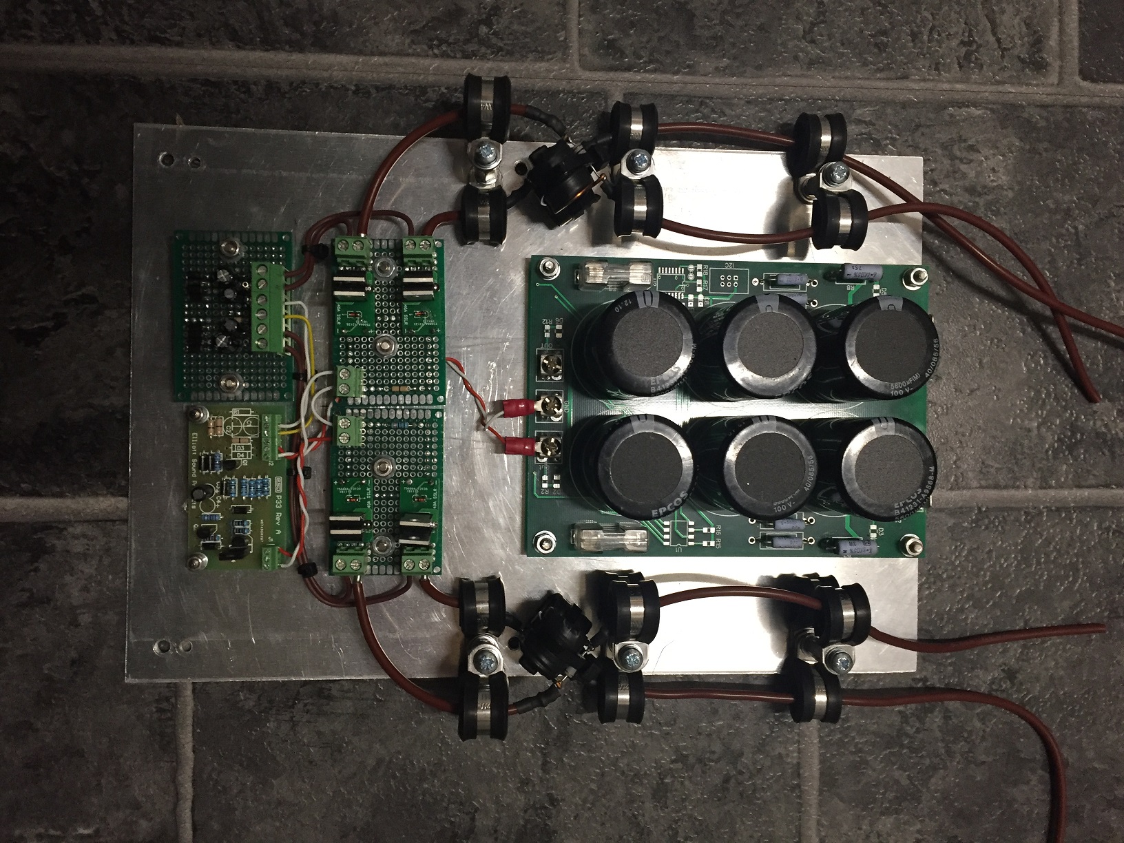

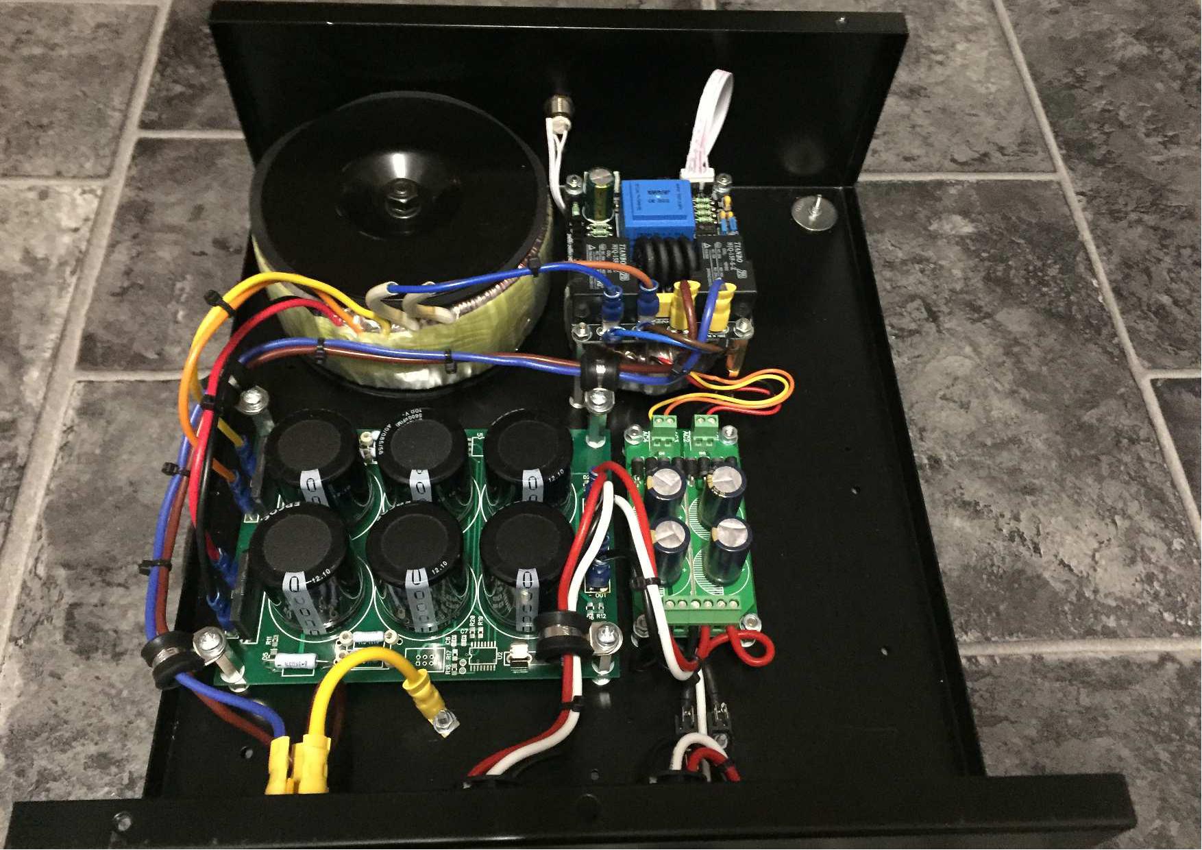

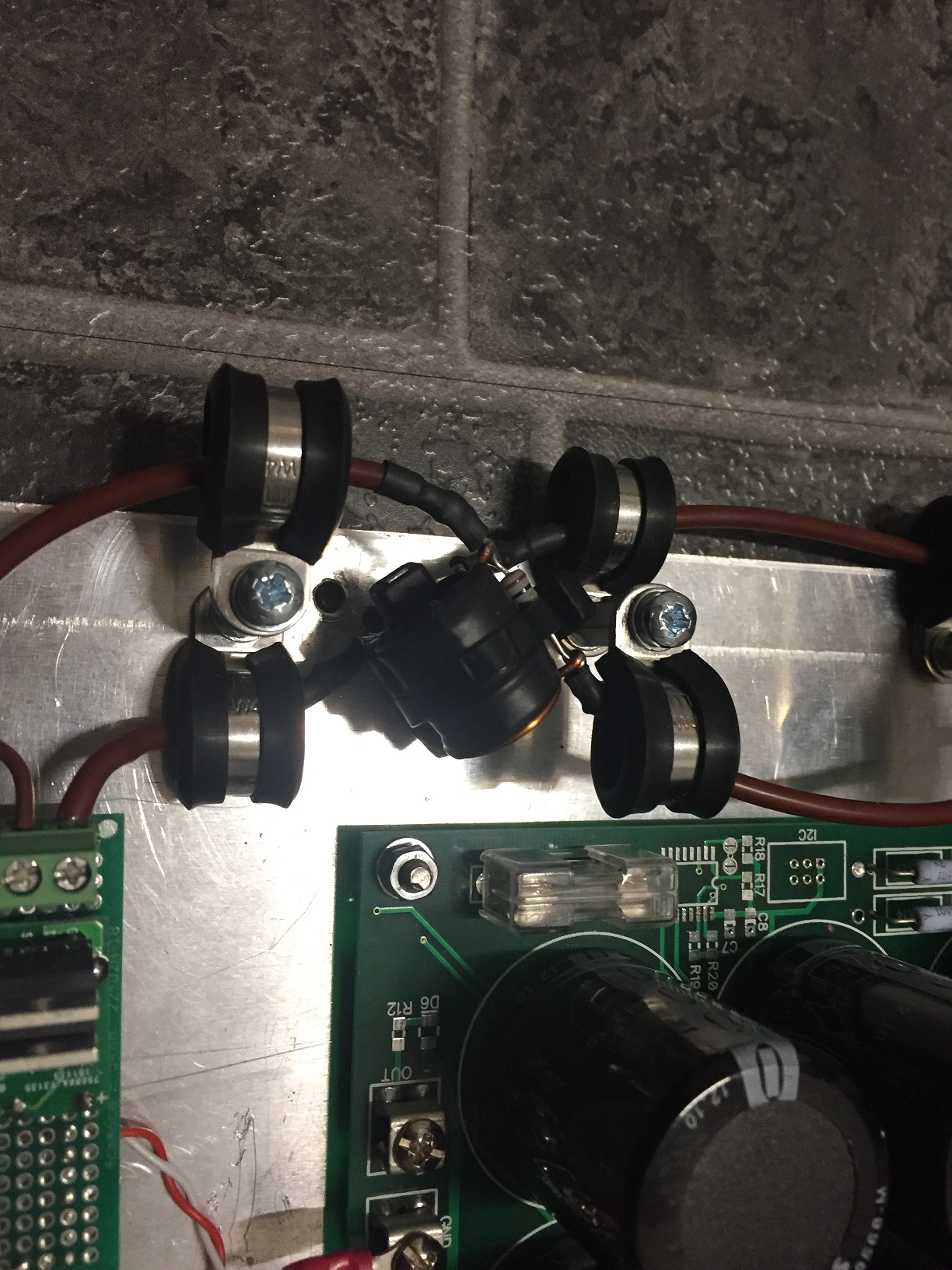

More Progress
Hello all,
More progress to report. Have now completed the build of a top plate that will sit upside down between the amplifier PCBs. It contains the local output stage decoupling capacitors and a basic SSLR speaker protection system based on bonsai's SSLR PCBs and Rod Elliot's P33 Speaker protection. It has been modified to allow for 4 channels. 2 full range and two midrange / tweeter channels. The Aluminium plate will be remade as it this is the result of designing by "winging" it.
All that is left to do on the amplifier enclosure is to test this circuit, glue heatsinks to the amplifier IPS transistors, connect it all together and test from bench PSUs. Then it is on to completing the PSU...
All the best,
Paul
Hello all,
All the best,
Paul

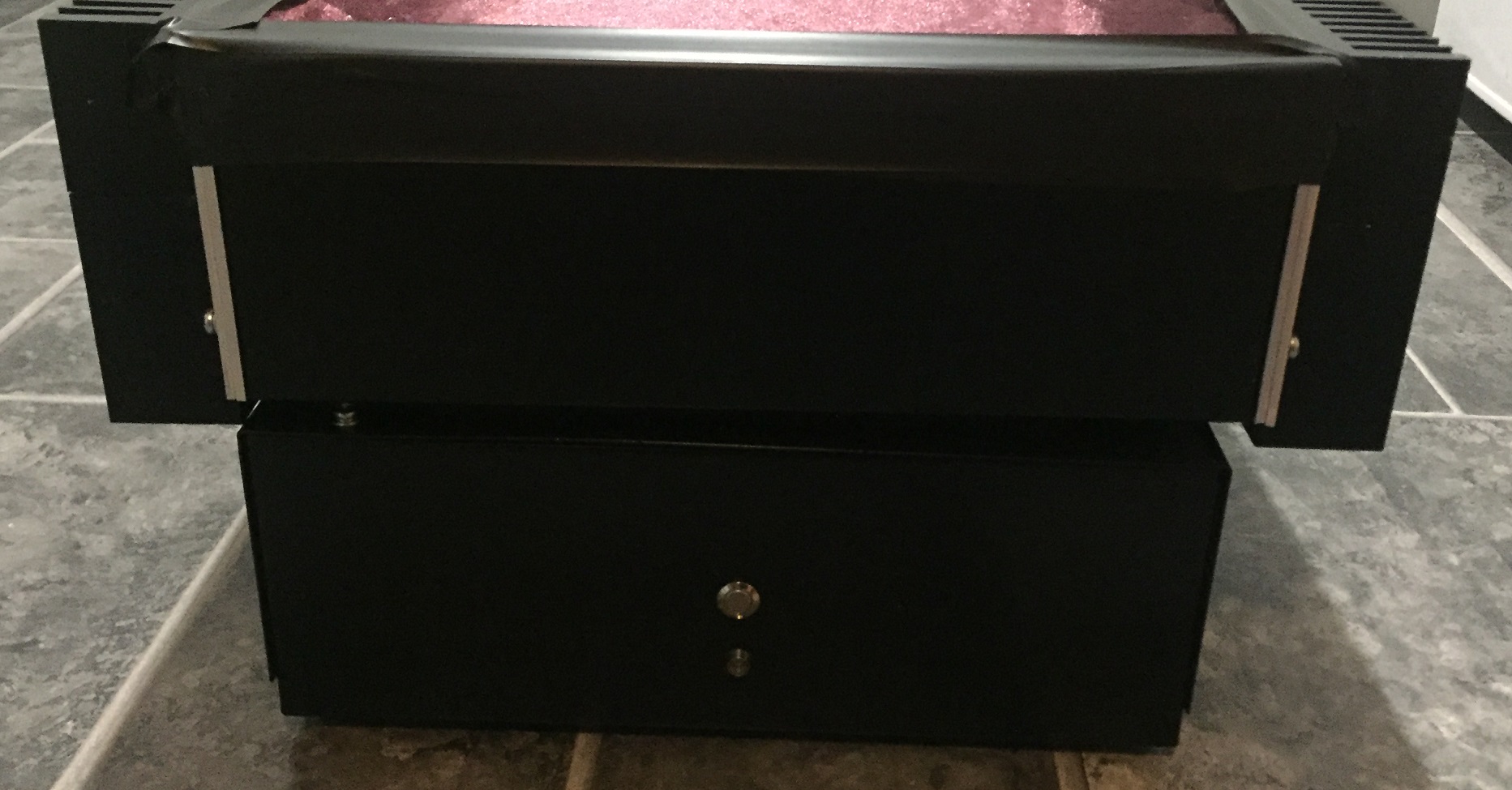

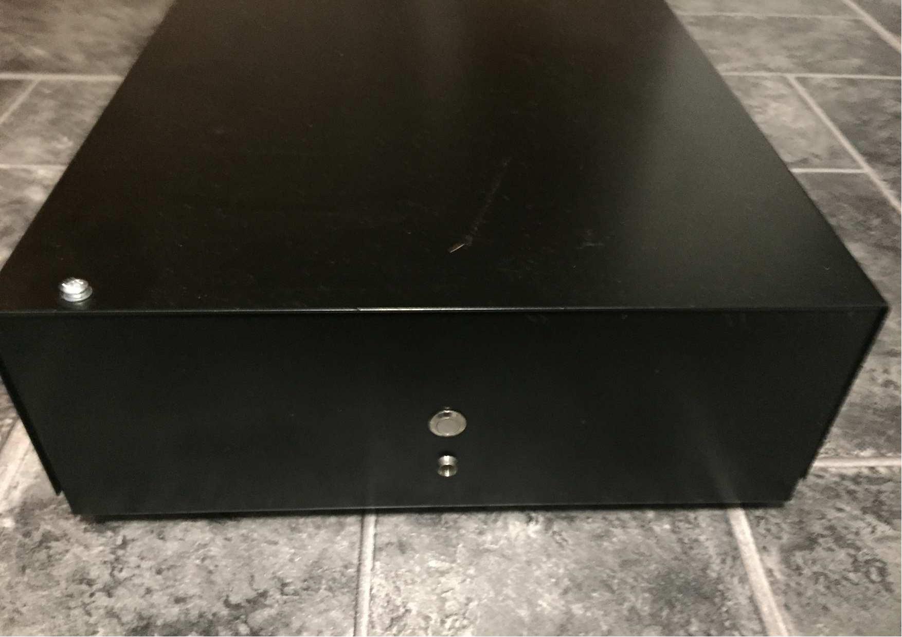

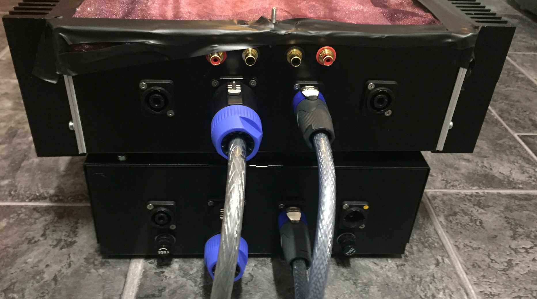

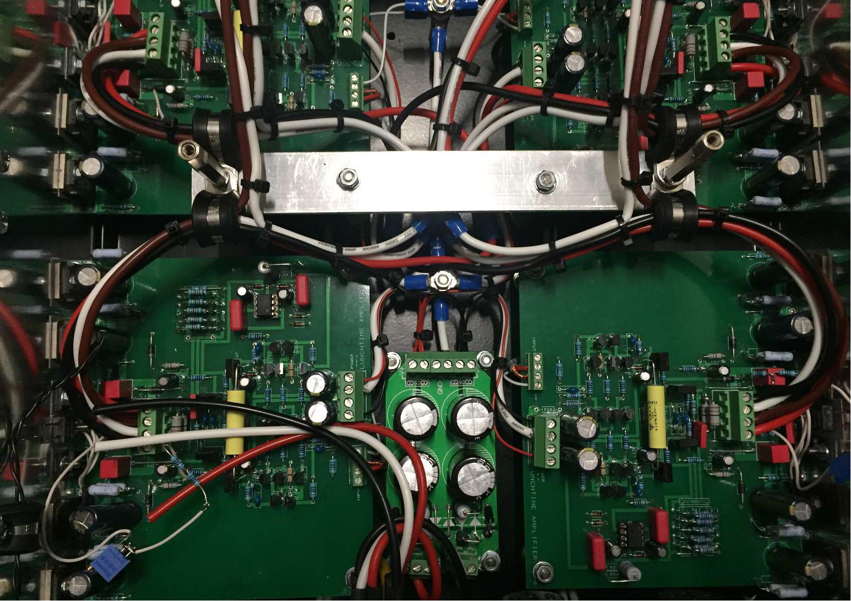

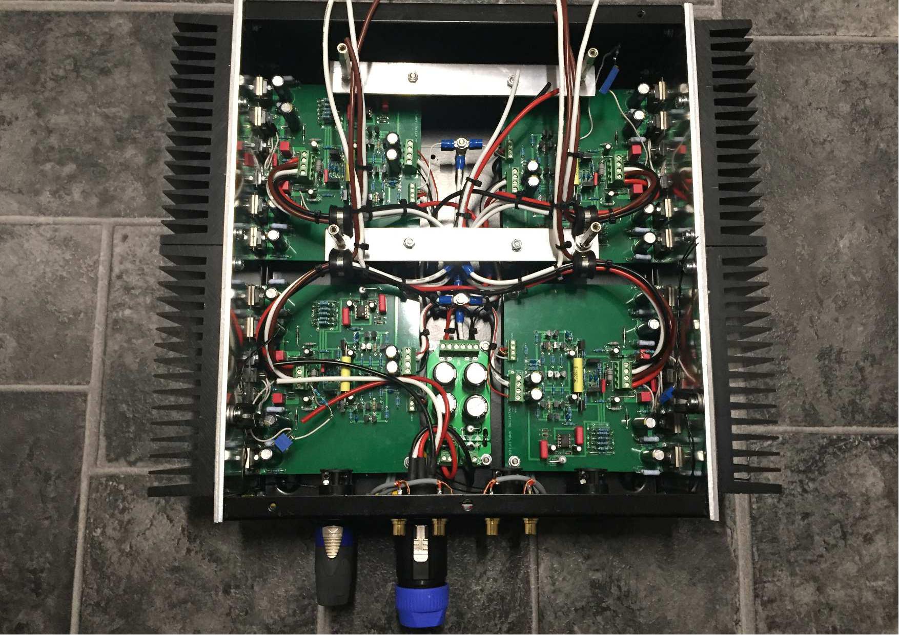

After 2 years you finally got the time to do itHello All,
Just another pic of the build. Actually getting somewhere now
Hopefully finish the amp box today. Then on too finishing the PSU box and the interconnects.
Paul

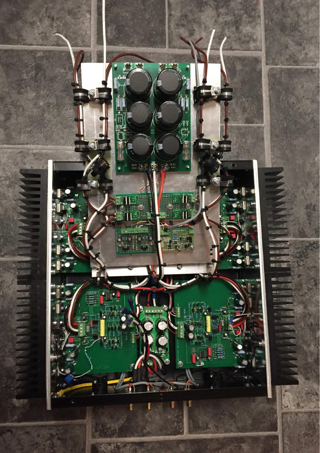

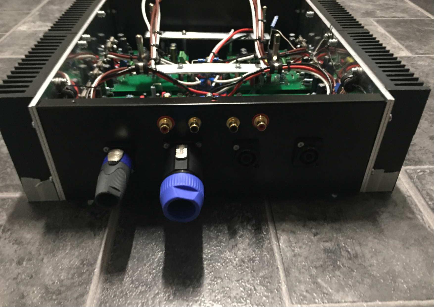

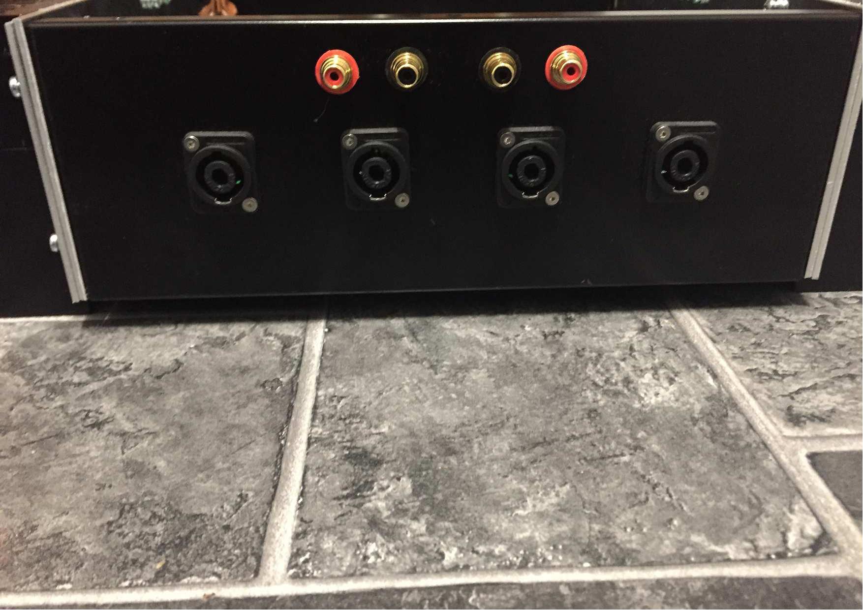

Hi Mark,
This front end a variant of Edmund Stuarts Supertis. The connection of the LTPs to the current mirrors along with the folded cascode VAS form a Common Mode Control Loop. Just think in terms of currents and it makes sense. The VAS current is balanced and defined.
Hi Dreamth,
Long time no speak If you decide to build this let me know. There are a few tweaks I would do. The active load project had been forgotten about until you mentioned it. I may return to it but right now I'm upgrading most of my system.

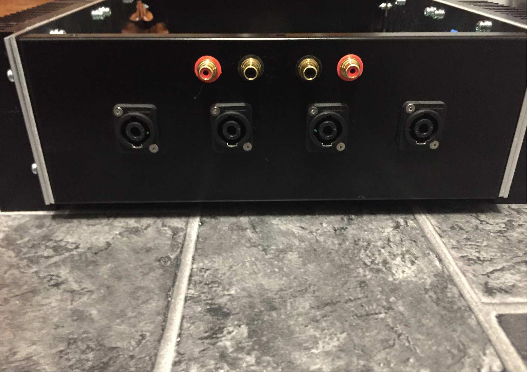

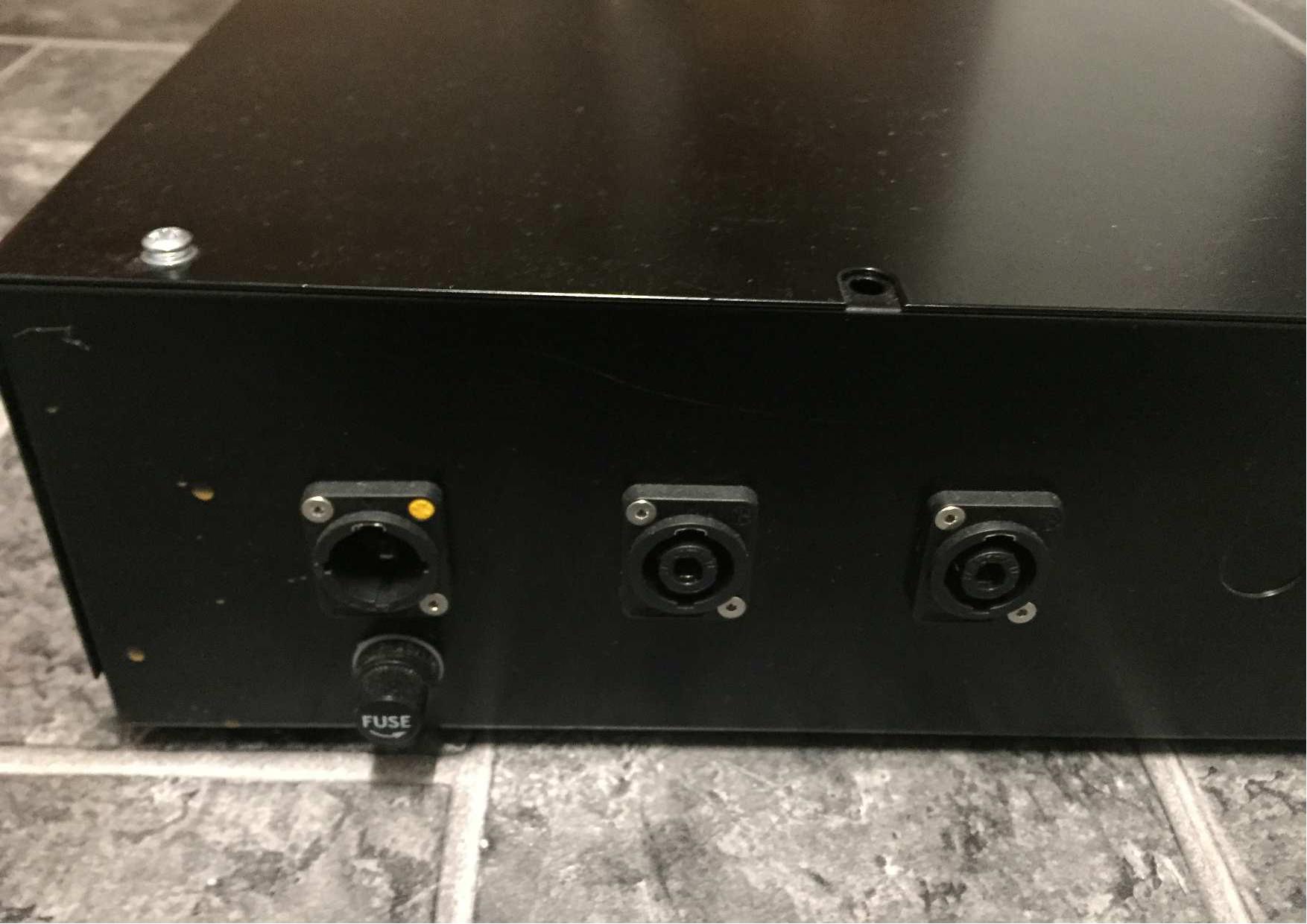

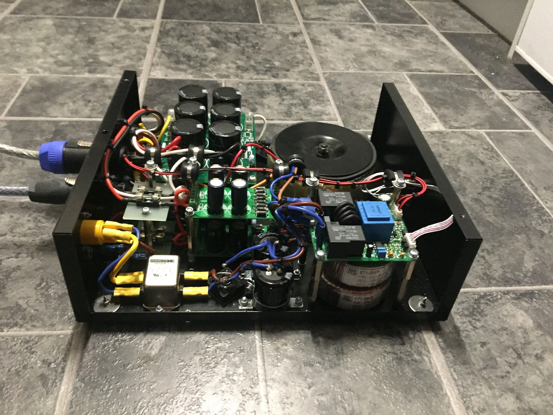

Here are a few pics Still to make a proper lid. The cloth is just to prevent stuff from falling in.
Paul
