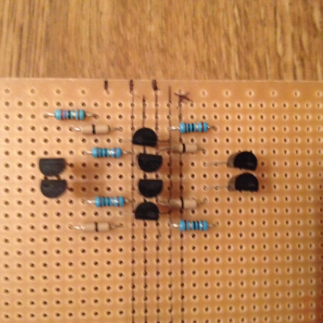

Hi Paul,I think I follow you scheme. Sounds like the original SuperTis compensation? See atached image.
probably, this is the topology I meant. In the schematic, R28 would be the "TMC resistor" from global output, and C13 and C22/23 would form the two branches to some inverting node (here inverting input) and "VAS output".
In my experience, in a conventional topolgy, TMC does work at least as well as TPC with respect to OPS linearisation.
TMC has the drawback, that it does not linearise the IPS, but this is here done via MIC. TMC has the advantage, that the second-order loop-gain characteristic is only seen by the OPS, and the global NFB loop has first-order characteristics which gives clean square-wave response of the whole circuit.
I cannot comment in detail on the problems with TPC+MIC. Only one thing: the second-order feedback network (in the the MIC loop) does cost you some phase margin in that loop, depending on how close the two frequencies are located.
If you use the TMC trick, then there will be some frequency, until where the OPS will influence somehow the response in the MIC loop. But probably, this frequency will be substantially lower than the ULGF in the MIC loop. So maybe, at least the MIC loop will be easier to get stable.
On the other hand, using TPC+MIC, the two MIC frequencies also have to be placed in such a way, that the global loop including the OPS may remain stable. This would mean, that in practice the frequencies should be separated by a fair margin: if one places both very high, then the OPS sees an ULGF comparable to the MIC-loop ULGF. So I repeat: cannot really comment ...
Kind regards,
Matthias

You and Matthias are now stretching my understanding. Which is good. One comforting thing is that it is not immediately obvious to you. As it was not and still is not obvious to me.
Interesting that you mention using a low impedance feedback network. Have been experimenting with Matthias's idea and have noticed that the feedback network values affect the open loop gain and stability for a given ULGF. So far I have managed to equal TPMIC in stability and the amount of negative feedback. One bonus has been the slew rate has increased and square waves are cleaner.
This amplifier seems to need the two pole shunts to burn off some gain. I can get all sorts of compensation schemes to "work" to some extent as long as the two pole shunt is present. Without the shunts the ULGF is always out in the 10Mhz + region.
The cascode TIS does not like to loaded. A 3EF is essential for this design. If a 2EF is substituted then the performance of the amplifier collapses. The minimisation of TIS loading is part of my design methodology, hence, the 2 pole bootstrapped shunts.
Still need to build the second prototype. Struggling with visualising the layout of the Supertis front end while using power rails down the centre of the PCB.
Paul
