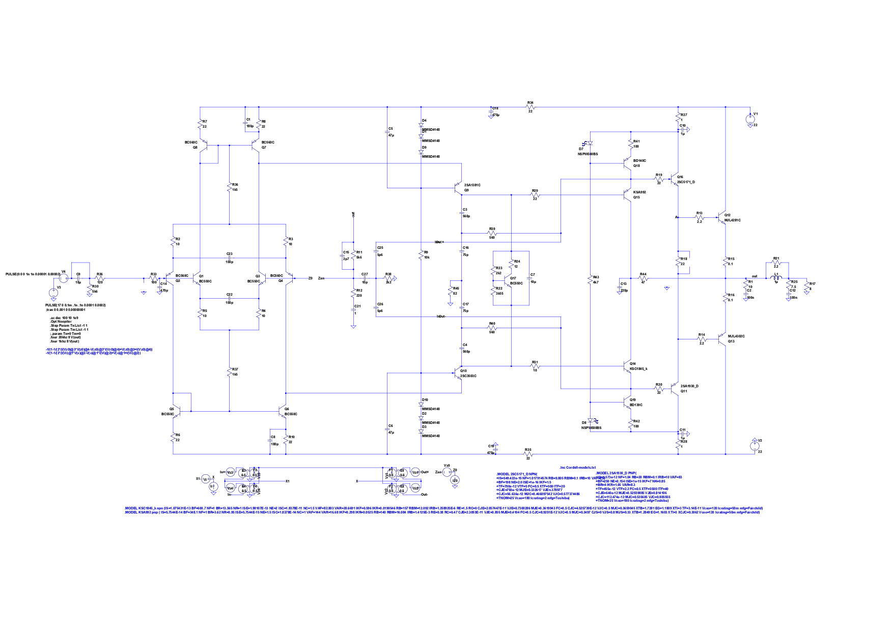

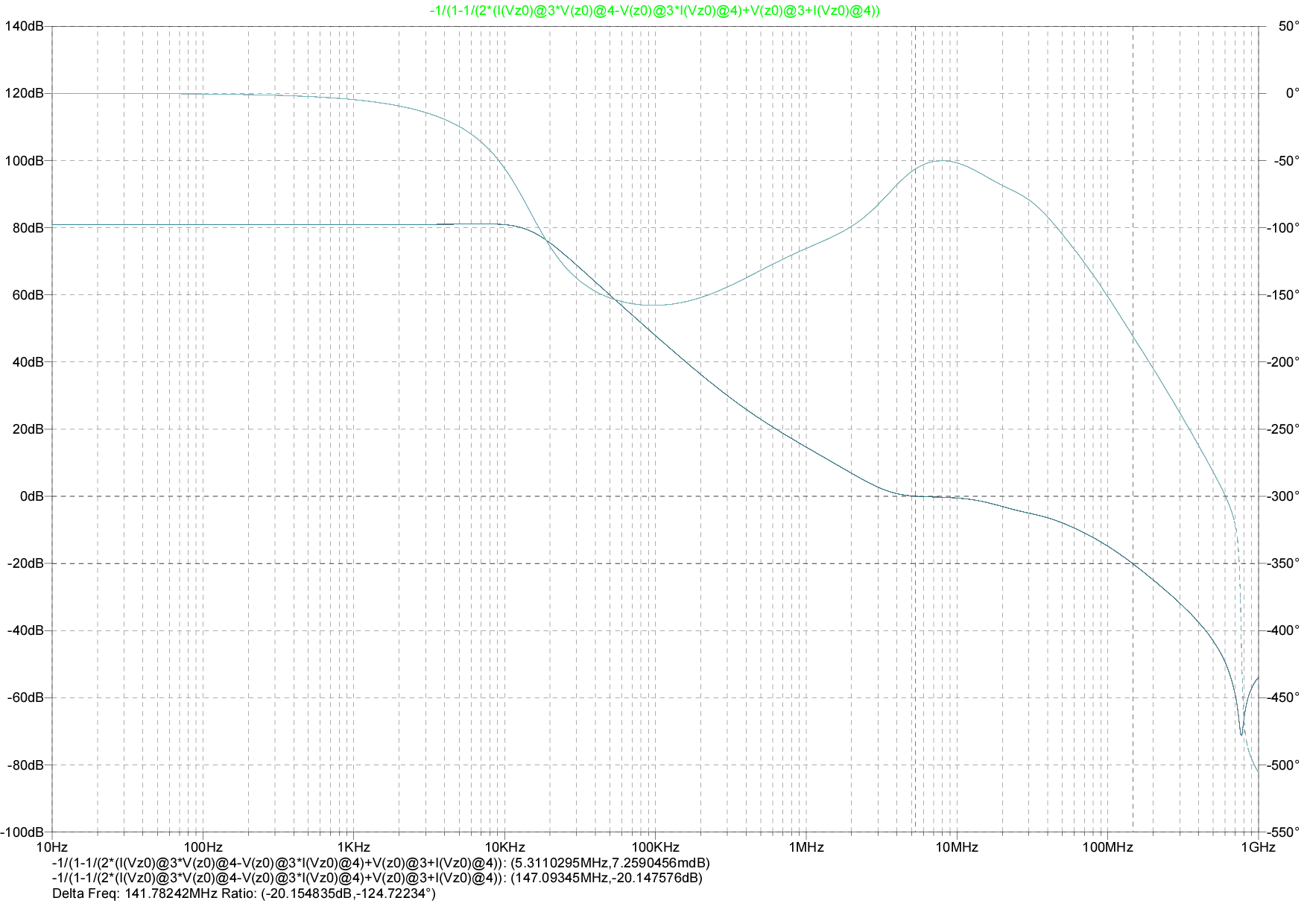

You do like circuits with multi-way feedback connections (to the VAS, to the Input and to the OPS) that really make me think
But am relaxed about this one because the response in this loop is "textbook".
In particular, the phase looks pleasantly understandable, just simple minimum phase.
Yes, I do. I like to try and do things differently. Keeps me (us) interested.
Thought the phase response resembled the one we saw in my other amplifier with HEC. So I thought it looked ok. The compensation has not really been tuned but was just thrown out there as a concept.
We know that feed-forward can potentially produce RHP zeroes, in other words "excess phase", in the strict use of the term.
So if there is no evidence of excess phase then I assume the feed-forward is so small that a simple analysis is fine and the complication of a Middlebrook GFT analysis is not needed.
On your post #48 you showed the shunt VAS loop to look for feed-forward there.
I think there is just a trace of non-minimum phase there, based only on visual estimate.
A second "To Do" is to work out how to plot excess phase in LTSpice.
In this case not critical because the loop gain is always small.
So using slightly dodgy logic. There may be a trace of feed-forward in the shunt too. Looking at the circuit, I wouldn't be too surprised.
We learn about some loop no matter where you put it.
True. Hopefully this one showed the feed-forward.

My decision to use MIC was only slightly biased by your recommendation. Using a zero in the feedback network (cap across feedback resistor) seemed sub optimal and a form of MIC looked like an obvious solution. At high frequencies hopefully it provides a short cut back to the front end summing node.
Yes, in this instance MIC has improved virtually every spec of this amplifier especially slew rate and stability. THD stayed about the same.
One downside to this amplifier's compensation is that it is difficult to make it symmetrical. Especially the shunts.

...Hopefully this one showed the feed-forward.
Yes, I think so.
Just to confirm, when I said the response was "textbook" I meant this loop.
So if it has a textbook minimum phase response then feed-forward is not an issue.
Actually the other loop is pretty textbook too.
And you can easily put back the front-end capacitors to add a little PM if you need it.
When I did simulations on my (similar-ish) amp I was surprised to see how much of the PM was eaten away once I started to put capacitive loads and pushed the OPS transistors up near the rails to test under low Vce.
So the PM that I expected to be conservative turned out to be adequate but not by too much.

Good, good, that 3 hours spent trying to understand probe placement was a good investment.
It resembled the HEC amplifier in phase response which was seen to be ok. So in my limited knowledge thought it looked ok.
Probably leave the front end caps out as less components means an easier PCB layout.
Tried torture testing this amp in sims with pure capacitive load with a small square wave super imposed on a 1K sine wave into clipping. It rang but didn't break away into uncontrolled oscillations.

It bothers me as well as... One problem I have with this amp is that the pre drivers are folded so there isn't a natural point to tap off centrally without duplication of compensation components.
Don't want to tap off the VAS for the MIC as I want to have the shunts as the main loading only. These shunts are complicated enough already.
Agree with the balancing of parasitics. No symmetrical amp is really symmetrical....
Another point to note, have noticed, in this amp the OPS zobel values are important and do make a difference to stability.

Tried the LTSpice input offset trick...
It appears the current .asc setup (104 degrees PM and 27 dB GM) can just about tolerate a 0.2R + 100nF as a load (PM = 5 degrees, GM =0.3 dB),This is while being 2V off clipping.
Found another place to gain some PM bypassing the current source resistors.
In this amp it is the input stage that clips first. Which is maybe why it clips so cleanly. It also means that the output transistor Vce never falls anywhere close to 0V so PM not compromised so much (if at all) by the voltage swing of the amp.

Hi David,
It is interesting to see how much PM you really need. Have been experimenting with TPMIC or at least my version... Again, THD showed almost no change but stability margins were very much improved. Something like PM = 116 degrees and GM = 26 dB @ULGF 7.5MHz.
Is 116 dgrees enough? Is 7.5Mhz ULGF asking for trouble?
PCB layout will be critical to this amp. It seems to always want to run fast in sims. Probably be the same in reality... On that note a plan a second prototype only this time actually paying attention to layout.
And the current limiters will have to go. Lends itself to a solid state relay like Bonsai documents on his website. The current limyers cost PM. Not immediately obvious to me but when you consider that the diodes (D5, D6) are really 4pF capacitors. Another benefit of the solid state relay is that you could choose a MOSFET with Rds ON of at least 0.4R and do away with the output network? Trade one source of distortion for another.
I like the square wave on sine method in LTSpice. Just with a little difference. At least with my HEC amp you could use the current in the gate resistor to see the first signs of instability long before you can see it on the output of the amp.

...how much PM you really need...116? Is 7.5Mhz ULGF...trouble?
This is the crux question, isn't it.
I have read comments that 7.5 MHz is well past a safe ULGF, no matter what the simulated PM.
But I don't believe it.
I suspect people had what they considered conservative stability and when the amp oscillated then they assumed there was some practical limit.
Instead the problem was simply that they had not simulated properly.
As I said, I was shocked to see how the PM disappeared as my amp neared the rails.
Unless I had done this then I would have been quite mistaken in a belief that the amp had plenty of PM.
The traditional 2 uF load test may also have mislead people
The worst case is usually quite different, your result of 100 nF is in line with Self comments (and Ric Lee's IIRC).
I don't have a particular number, because amps differ, for instance my amp's elevated front end supply can push the OPS close to the rails, your amp may have other critical areas.
PCB layout will be critical to this amp. It seems to always want to run fast in sims. Probably be the same in reality... On that note a plan a second prototype...
Theory implies that an increase in ULGF can improve stability, if properly done.
I think that's what you see when you say it wants to run fast, and I expect this is indeed the same in reality.
Hi David,
Yes. it is the question. This thread should be enlightening. one of the goals of this project is to hit ULGF = 8MHz with good stability. All qualatative objetives except for the 8MHz.
You don't often see amps with over 100 degrees PM it has to said. Currently in LTSpice I have achieved PM = 124 degrees with GM = 20dB @ 5.3MHz. Can get PM = 132 degrees @ 8.2MHz...
These high values of PM look so alien to me. They almost look wrong.
Despite my reservations, I am still going to build this. Those free sample MJL4302/3281 from On Semi in 2004 are proving usefull at last,
Have since re-done my sims for output close to the rails and now it is scary to see how much PM dissappears. I lose about 50 degrees of PM. But do gain GM. So really 124 may only just be enough. Interesting point is that the ULGF drops as the amplifier nears the rails.

True there is much to be gained from heavier compensation. With my version of TPMIC I have finally found a way of doing this without increasing the ULGF.
At the moment I am trying to work out the relationship between the two pole shunts and the TPMIC. There will be an optimum relationship.
Just beginning to see a bode step... Heavier compensation is on it's way.
Attached are schematic and loopgain plot. Enjoy the new loops. Still sub-optimal though.
Paul
Edit: Another observation about this amp is that it can provide 500mA without switching the non conducting half off. Not sure why.

...You don't often see amps with over 100 degrees PM it has to said....
You don't often see amps that try to hit 8 MHz either
TPC probably requires some extra PM.
As the amp slows down (due to approach to rails or capacitive load) we lose more PM than a Miller compensated amp I think.
Hence the numbers look unfamiliar and "alien".

PS. I really like to line up 0dB and 180 phase lines on the plot.
Makes it much easier to interpret.
your work is interesting and refreshing. Although I do not yet fully understand your compensation scheme (especially the higher-order behaviour) and although it might be counter to your basic approach of optimization, I'd like to make a proposal.
As far as I understand, the topology has the advantage that there is no really high-impedance node between inverting input and pre-driver input (or even its output). Thus, it should be possible in principle to use Miller input compensation (MIC) e.g. between pre-driver output and inverting input without wasting too much bandwidth by shunt compensation in this loop. Thus, the input stage enjoys high linearisation. (What I understood, this has been achieved.)
If you now close the global loop around the output stage, shouldn't it then be possible to use the TMC (transitional Miller compensation) trick? To my understanding, there should be no difference whether the Miller compensation spans only to the "VAS" input or to the global inverting input. Combining high ULGF in the global loop with TMC, one should get huge amounts of feedback around the output-stage (second-order characteristics).
I really appreciate your approach to try to optimize the compensation of a given architecture, that is sensible from general understanding, without resorting to established design ideas as TMC and so on. Nevertheless, isn't the above a possibility?
Kind regards,
Matthias

Your ideas are most welcome. I tend to end up in mental corners. I think I follow you scheme. Sounds like the original SuperTis compensation? See atached image. However, I'm struggling to use "TPMIC" as the main compensation for this amplifier. Keep ending up back at the "two pole boostrapped shunt compensation" with a little lead compensation accross the feedback resistor.
In the schematic with the "TPMIC" http://www.diyaudio.com/forums/solid-state/265449-amp-designed-during-lunch-breaks-8.html#post4186413 it appears that the MIC loop only provides extra stability due to the OPS being out of the loop at higher frequencies. Is this stability "real"? Not sure.

If you look at the LG plot above. Up to the ULGF the shunts dominate and after that my version of "TPMIC" takes over.
When driving capacitive loads or when driven close to the rails the amplifier slows down and the ULGF drops significantly. Should we be looking at the stability of the amplifier without the "TPMIC" to get an idea of the real stability at lower frequencies of ULGF? It may explain why "TPMIC" loses more PM than other forms of compensation when the amplifier is driven close to the rail voltage? At least for this amplifier...
Is it better to use "TPMIC" or use shunts to shape the NGFB loop? That way the whole amplifier is enclosed in the feedback loop. Shunt compensation is usually considered sub-optimal though?
There's something to be said about simplicity. Learnt from experience on this one. Why does experience have to be expensive?
I'm struggling to get an output from LTSpice that clearly shows the LG plots. The 0dB and 180 phase lines are lined up but they are not clearly visible in the attachments. It does, however, show the values for the cursors underneath the plot which may or may not be usefull.
Want to make things easy to read. So once again I'm open to suggestions to improve things.
