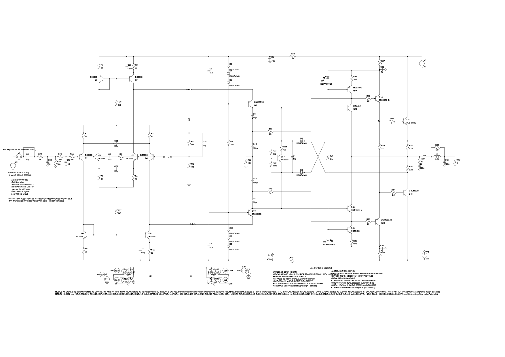

Still to big, or my screen is to small (I use a laptop) or your (screen) is to big.
I have a cheap Acer widescreen laptop. So my screen is small.
Have you any hints on what can be done better?

Hi David,
Sounds interesting. I shall build a prototype (less compensation). Got the next three days off work so should have plenty of time to experiment.
Are you like me in that you find compensation of an amp a very interesting area of study.

Edit: This image any better?

...any better?
Yes, it's adequate on my monitor

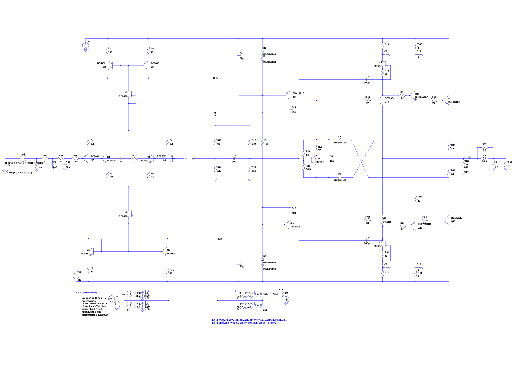

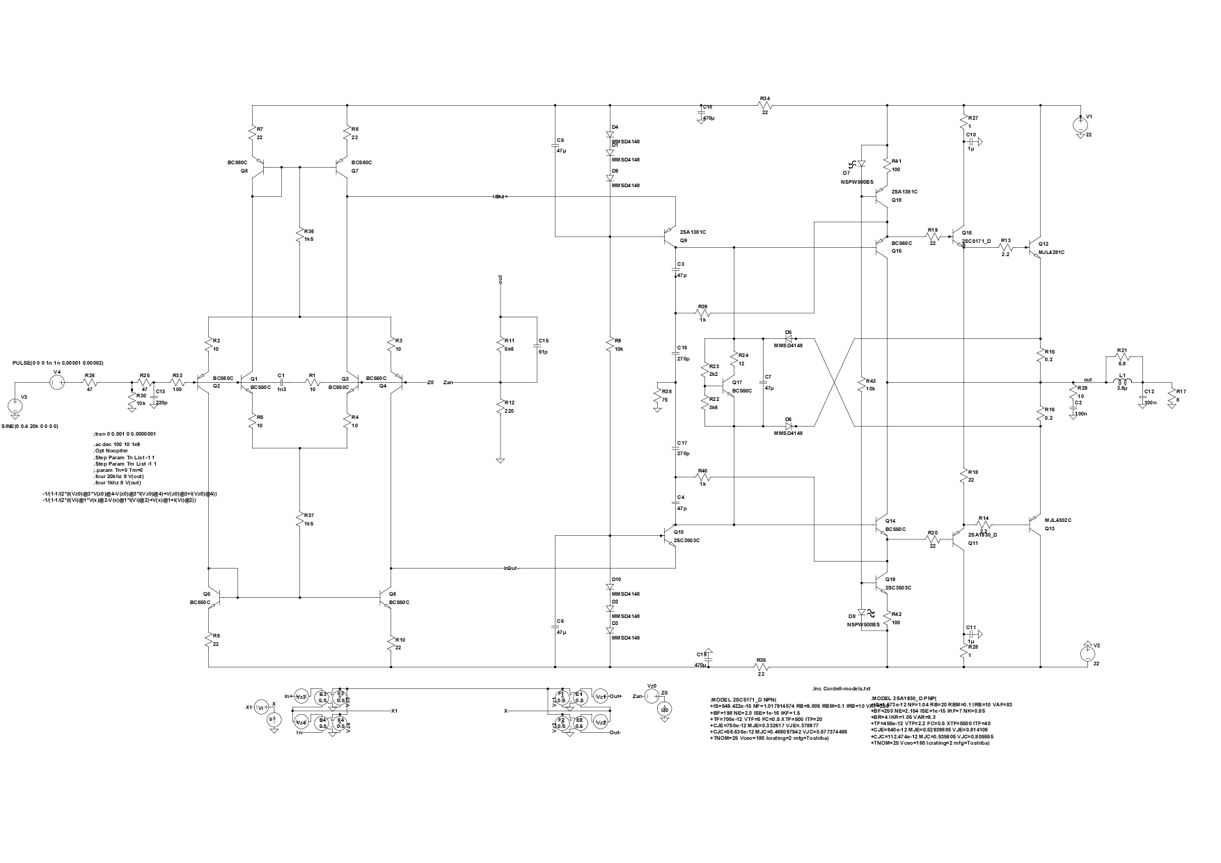

Lunchtime experimentation
Been messing again with the compensation. Two pole bootstrapped shunts on the VAS outputs. The difference in loop gain plots is significant. But then so is the stability (as expected). Looks much like a CFA loop gain plot.
The prototype is on its way... Sometime this week it will be ready for testing. Going for a higher ULGF than normal @3MHz. Then if this works I may try implementing the attached....

Looks correct to me.
The simple probe placed where I recommended, at the bases of the input transistors, should return essentially the same result as the differential probe where you already have it, for the VAS, with the compensation you have.
This will be a useful cross-check, which I claim as my excuse for why I didn't immediately see this last nite.
Exactly what to call the compensation is a bit less clear.
I don't see it as close to TMC (not "transitional") or OIC (which I define as Miller compensation from the OPS back to the VAS).
It is a Two Pole (to use the term loosely) overall loop with some shunt compensation.

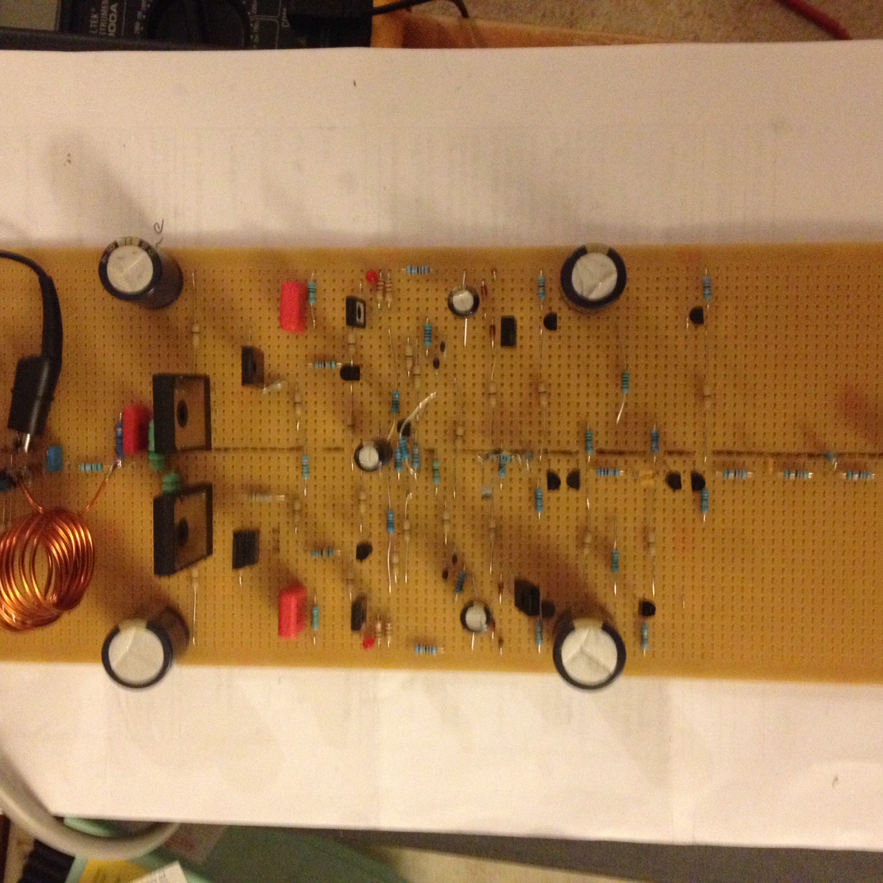

Been busy this past few days. Catching up with this project.
The previous versions have all been built. All worked as expected once a few tweaks had been made to ensure that the sims vaguley reflected real life. Then went on a characteristic quest to improve the specs...

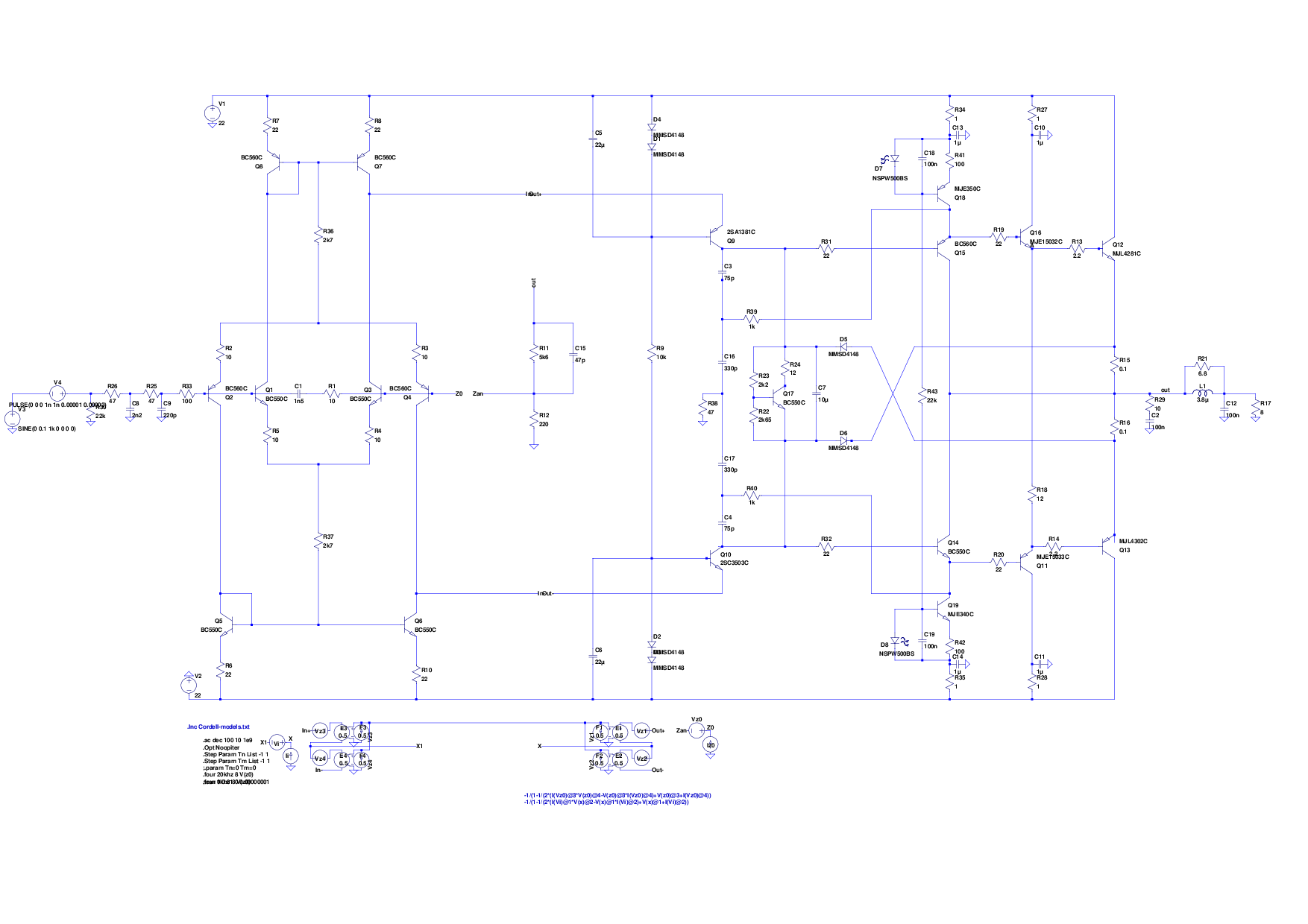

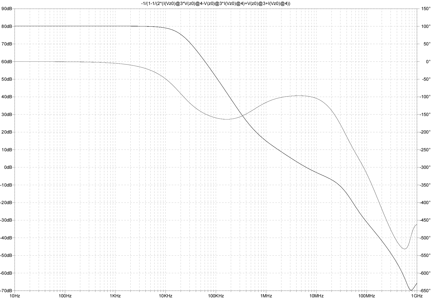

David, you said let it run fast well here it is...
(ULGF = 5.6 MHz, PM = 76 degrees, GM = 10dB)
It plays music but not done any specific stability tests yet.
I think I am being held back by the speed of the output devices. Could go with MOSFETs??
Further developments to this project will include a DC Servo and maybe an autobias scheme.
What do people think? Here are some attachments. The .asc is the current prototype.
Paul

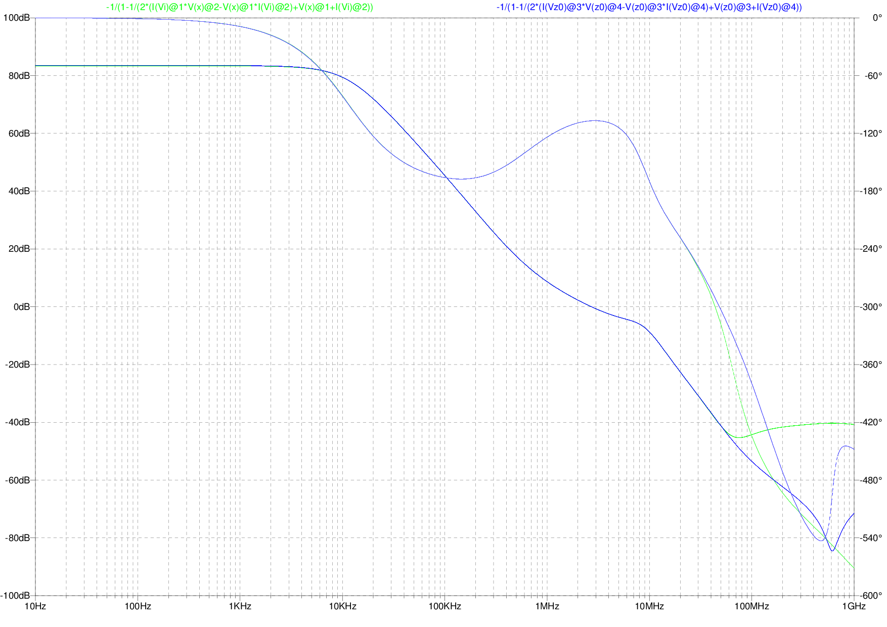

Hi Paul,
Very interesting, I did not try to simulate it yet. You have actually built it? So, high ULGF is not a problem?
My CFA mosfet amp has very similar ULGF (4.1MHz) and LG (75dB up to 20kHz a bit better PM and GM), and just in a process to be built.

Hi Damir,
Yes, this is a working prototype. All built on vero board. No signs of oscillations on the scope yet. Sure to find something.
The high ULGF does not seem a problem. Even with the most compromised layout possible. Just trying to think of ways to make this circuit faster so I have the stability margins to play with when trying for 6MHz.

Hi Paul
Compliments of the season. Nice to see the prototype.
Yes, if it works tolerably well with that veroboard then a proper optimized layout should have plenty of room for improvement.
Quite a reassurance.
You can use capacitors to bypass the current mirror emitter resistors R8 and it's complement R10.
Similarly capacitors to bypass the LTP emitter resistors R2,R3 and complement.
This can be one capacitor from one emitter of the LTP to the other (Q1 to Q3 etc.).

These ideas work. Have managed to improve stability margins a little while increasing the ULGF to 6MHz. Shall continue playing with the compensation. Sure there's more to come.
Keep thinking about going back to MOSFETs with a push /pull driver stage?

Hi David,
Been experimenting with this and have found that it is trading GM for PM. Have been using capacitor values of the order of 22pF to 390pF. Is this the expected behaviour?
Also, interestingly changing Q14 and Q15 (predrivers) has a significant affect on the stability parameters (ULGF, LG, PM, GM). Is this down to transistor models? Or are there specific requirements for the transistors in these places?
Even slightly changing the output stage topology slightly has an affect. If you feed the collectors of the pre drivers from the power rails things improve.
All interesting stuff... (at least for me )
More factors at play than I am aware of...

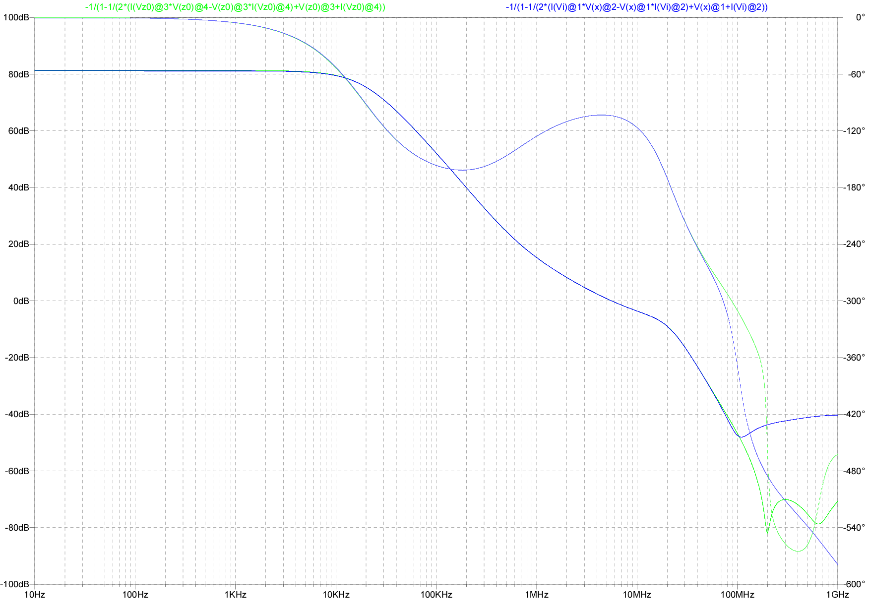

Hi All,
The ULGF is now 6.5Mhz (ish). PM = 82 degrees, GM = 11dB. Managed to improve the stability as well as upping the ULGF.
It is pretty stable. Plays music nicely. Clipping behaviour is almost exactly as expected. Square waves are clean with no overshoot. This was probed at the amp output before the output filter while connected to speaker.
All this on strip board with a poor earthing arrangement.
Is it worth pushing for a higher ULGF? It can be done in Spice. Suppose I need to define some stability tests. It happily drives a KEF Coda 7.
The only difference between the .asc file is the use of KSA733/KSC945 (Q14,Q15) in the prototype instead of KSA992/KSC1815. Don't have reliable models for the transistors used. Maybe I should try and learn how to make Spice models.
Attached are the schematic, LG plot and .asc
Many thanks for reading this thread.
Paul
Paul
...I always do my prototypes on vero board with component layout as per schematic...
I like the idea of a prototype but I don't think you need to layout as per schematic.
To simplistically copy the schematic usually leads to sub-optimal layout, but it's such an obvious way that most people tend to do it, even for the PCB.
Of course, you could say that if a circuit can cope with Vero-board AND sub-optimal layout then it will be VERY likely to work on optimised PCB.
But I would say, may as well at least start to consider layout.

...trad[es] GM for PM. Have been using capacitor values of the order of 22pF to 390pF. Is this the expected behaviour?
It is typical, but it's not zero-sum because it is possible to substantially improve PM while the loss of GM is minimal.
It is easiest to see this on a Nichols plot.
Still haven't worked out how to make LTSpice do this neatly, in the meantime you can look at the chart to see how they trade-off.
... Q14 and Q15 (predrivers) has a significant affect on the stability parameters (ULGF, LG, PM, GM). Is this down to transistor models? Or are there specific requirements for the transistors in these places?
I was never completely happy with my EF3 results, there are non obvious effects and a tendency to sensitivity, as you have noted.
Dennis Feucht has some discussion of this and some of Middlebrook looks relevant but I decided it was easier to use EF2 and use sufficient feedback around the VAS to make the extra load inconsequential.
Maybe not so simple for your Edmond Stuart style VAS/TIS that is more sensitive to load.
I discussed this a little with Edmond in his thread on the topic.
Extra complexity in the OPS versus simpler OPS but couple extra transistors in the front end.
I am happy with my version of the later but maybe when I understand more I will reconsider.
Hi David,
This is the thinking. If it works on veroboard it is unlikely I'll be wasting my money again on PCBs that don't work. It also makes it easier on my brain to transfer mods from LTSpice to the prototype.
Always have layout in mind while designing. I like to minimise the number of GND connections as these have proved most troublesome for me. Also, I try to imagine how the connections would work on PCB so there are not too many crossings. Like the idea of the Cherry recommendation of running the power rails down the middle of the PCB. That way you can avoid all the sensitive electronics being inbetween the main sources of interference.
Experience was expensive...
Do like the fact it works ok with the ~6MHz ULGF on veroboard.
Have to take a closer look. Don't have too much GM to play with...

Always had a fear of the 3EF myself. Maybe could use a CFP for the Pre drivers / drivers?
I thought that the changes in LG (-6db across the band in one case) when the Pre drivers were changed was a feature of the design not the 3EF. In this design it needs the Pre drivers because of the kind of VAS used. It has a very high output impedance. Or at least this is how I understand it with the compensation type used.
Got a significant improvement in THD when going from a 2EF to a 3EF...
Even more research required...
Paul
...Maybe could use a CFP for the Pre drivers / drivers?
I have simulated this and it did not work as well as I expected.
Those expectations were not just hope but based on simple theory, apparently TOO simple.
The unexpected bit was a result of source resistance, not revealed if one just tries an OPS driven from an ideal source.
...it needs the Pre drivers because of the kind of VAS used. It has a very high output impedance. Or at least this is how I understand it with the compensation type used.
Yes, I added a few comments about this after I pushed "submit" so we cross posted.
I try to put the posts up quickly but went a bit early.
