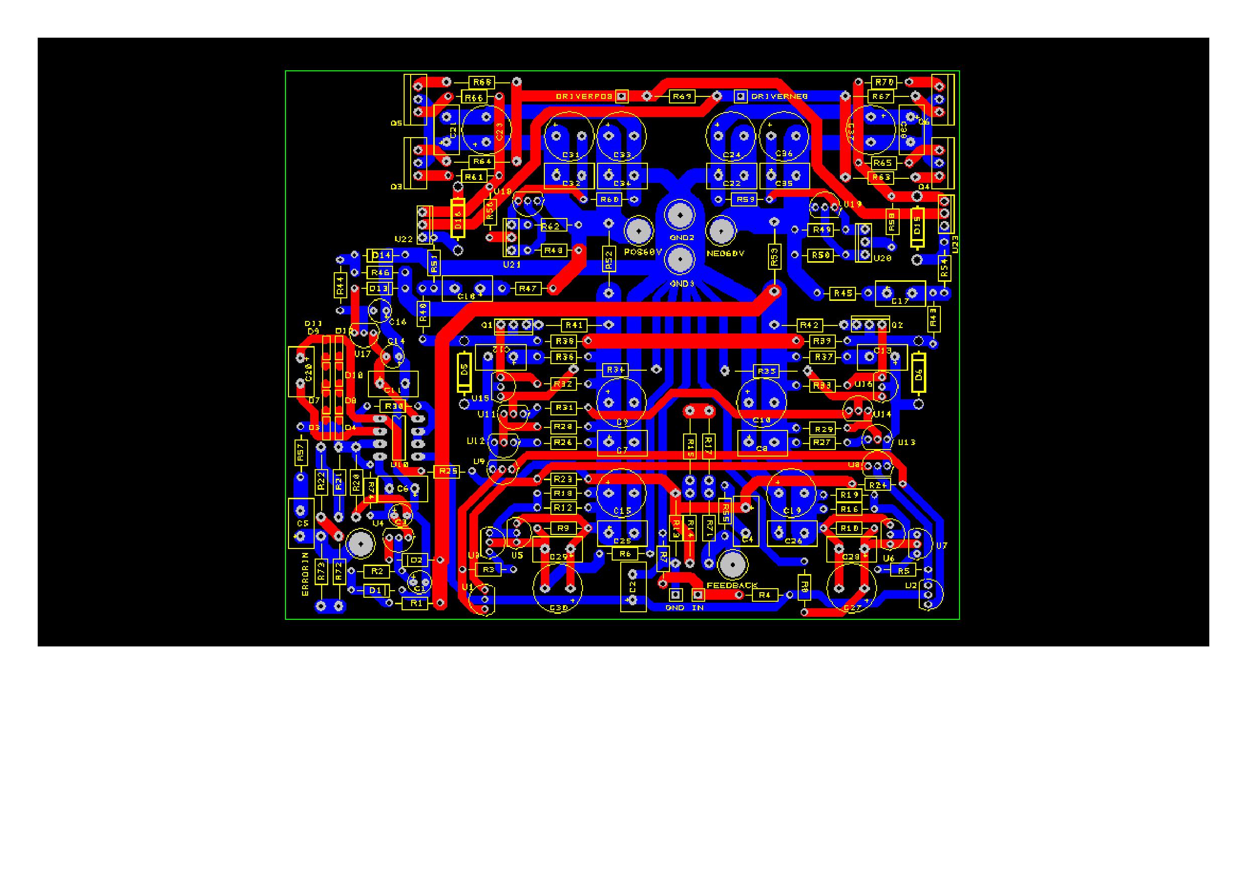

Amp design attempt number 2 (simpler)
Thank you for the feedback. What sort of track thickness would you use for signal grounds and decoupling grounds? Currently signal = 3mm and decoupling = 4mm.
I could add a scale to the drawings if that would be useful?
It looks bigger on first sight 🙂.
There are small currents, and it flows separately so half width will more than suffice (2mm, 1.5mm). Spacing is not critical, there is hardly potential between those tracks. Add all widths together to get effectively ground path. Top layer tracks will be shorter.
For current source stabilizing, capacitors should be connected to base of source transistor (example u3) not to ground.
This is good news. It doesn't look to difficult to add some stabilization of this type. You mentioned using 220u // 220n for current sources. The smaller current sources run at approx 1mA and the larger 20mA. Could I get away with smaller decoupling for the 1mA sources?
I will be relaying out the PCB tomorrow eve with smaller ground tracks and additional decoupling.

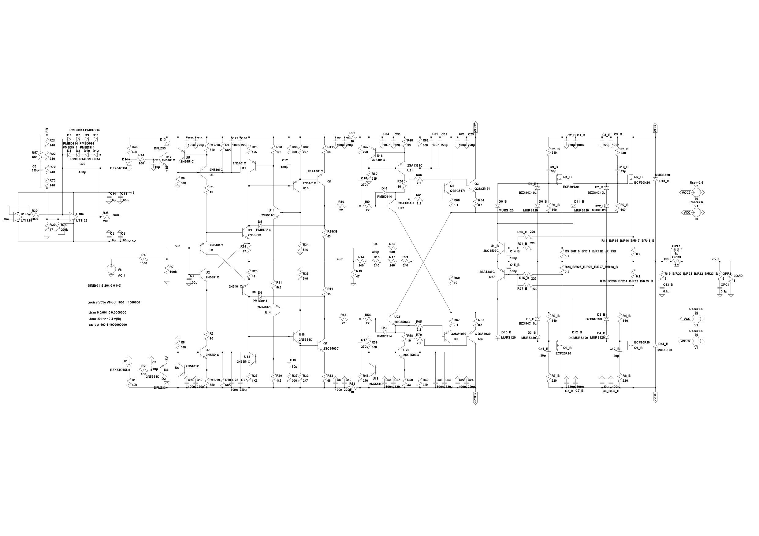

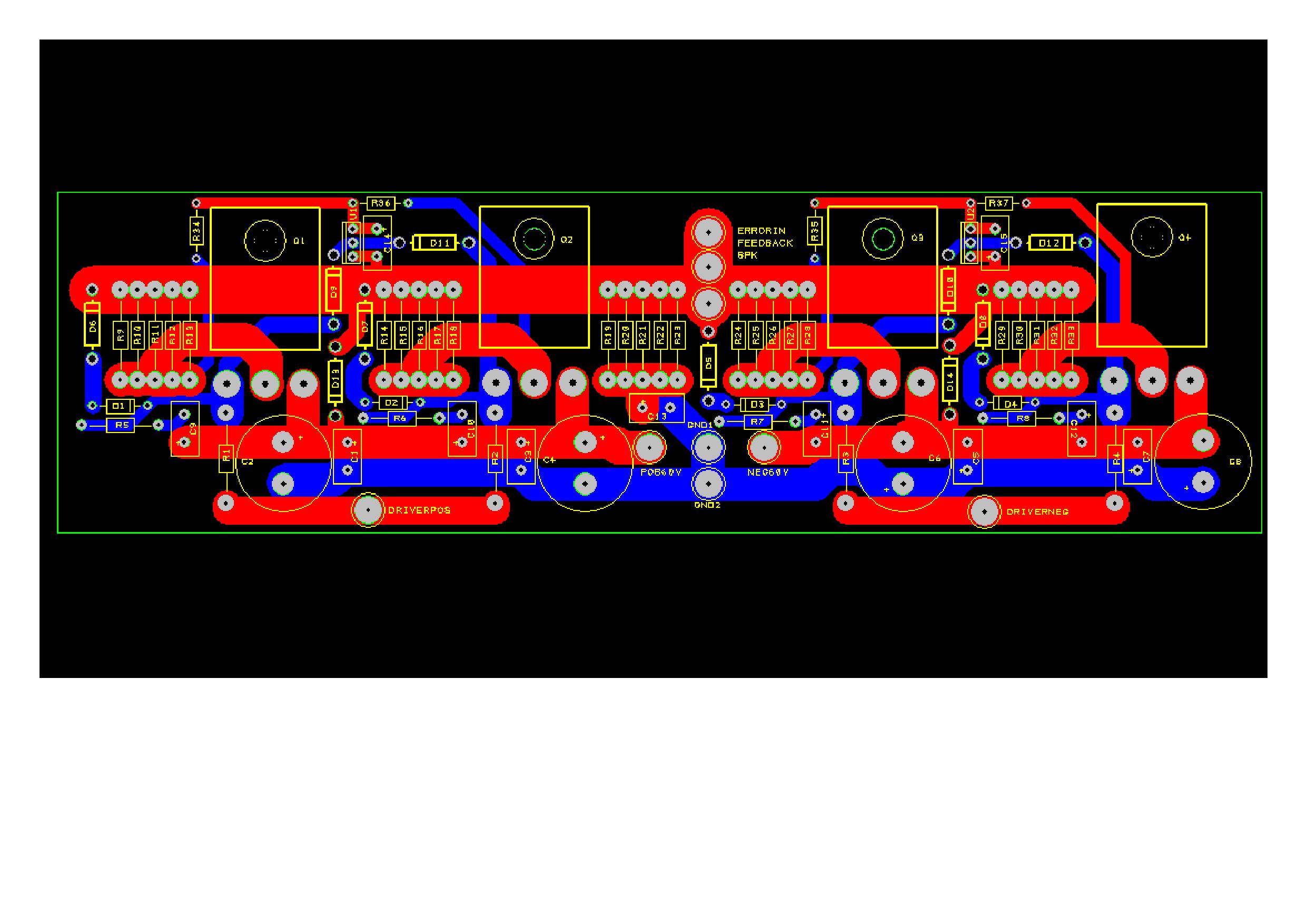

Attached are the latest schematics. Included the suggestions by overall feedback. Changed decoupling capacitors on output PCB to the ones suggested by transistormarkj. Added extra decoupling to the input PCB. There will no doubt be more changes to the PCBs to come.

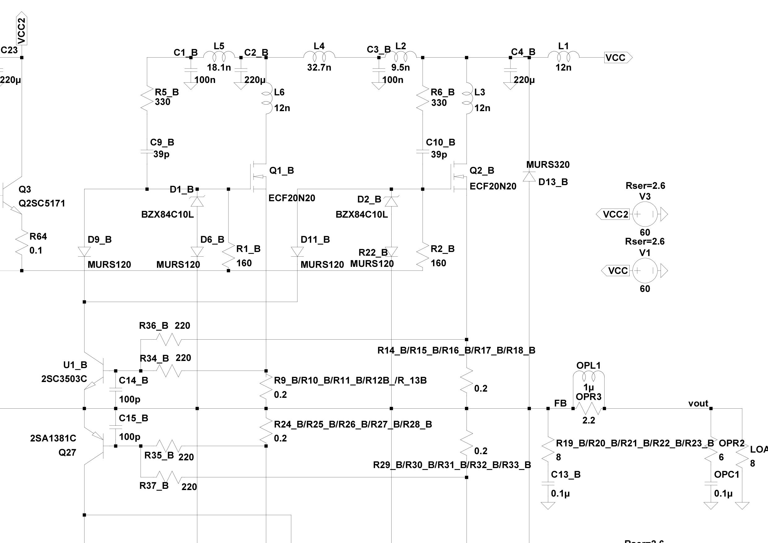

Now it is time to start with the parasistics properly. Attached is the section of the circuit that I have started with. Does it look sane to do it this way. I think I'll start with the power rails and then the longer tracks.
The attachments are latest PCB layouts, schematic and the the section of the circuit I have started parasitics work on.

I put a 1R+1u cap on the rails in simulation which works pretty well to stop the rail resonances that always occur when you parallel low-ESR lytics with film caps. Because the output stage is the main leakage point for rail parasitics, resonances here will push a fast amp into oscillation.
Why are you using C5171/A1930 as drivers?
You can use these discrete symbols in LTSpice to add inductances to traces without cluttering the schematic. According to Cordell's book, the gate and drain have about 5nH inductance whereas the source has around 13nH before they reach the pins, so that's a start. Just unzip them in your schematic directory or your /lib/sym directory for convenience. Then type "trace" in the symbol finder window.

Those trace symbols are much neater than the inductor symbol. Made some progress with the first power rail. Swapped position of two capacitors, increased the size of the film caps and added two snubbers with values you suggested. Now there are smooth changes in rail voltage rather than sharp changes with ringing.

The parasitic work is progressing nicely. I have virtually finished the output pcb. Interesting finding was that when only the top half was done there were some strange artefacts that disappeared once the bottom half was done. Suggests layout symmetry is important. Already have some PCB changes to make even at this early stage.

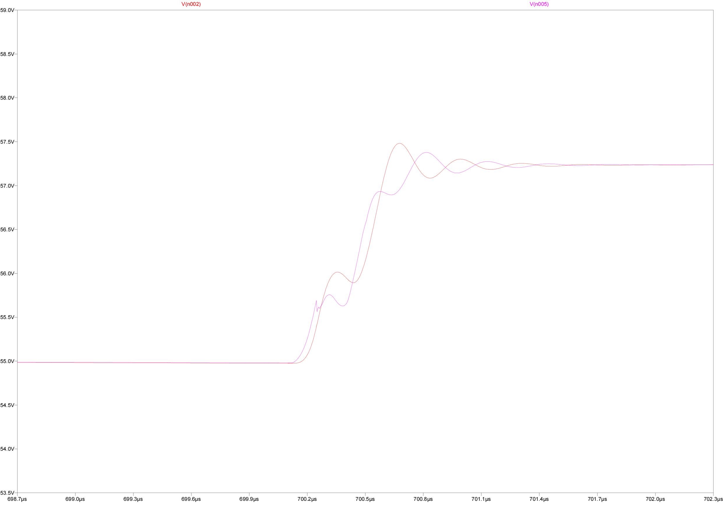

Having problems with the bootstrapped drivers. I think it has exposed some sort of problem with the amp. Looks good on over load tests, GM (12dB), PM(82 degrees), sine waves, THD but not on square waves. Rising edge looks good but the falling edge overshoots (but no ringing) can solve this with a bigger cap across the feedback resistor but this seems to be a sticking plaster approach. It now has to be 1n! Don't like it.
These tests were done on the non parasitic schematic.
How would I go about tracking down the problem?
Adjust small-signal square behavior first, then increase the signal level and see what problems occur. This way you start from something reasonable.
Click on the phase scale in LTSpice and switch to group delay. Make this smooth without peaking at all output current/voltages and you will get your perfect square waves. You will notice the AC response may seem perfect but the group delay will reveal problems which will show up in the square waves.
Plot the transconductance and gain of the OPS directly and see whether it is simply the OPS producing errata at frequencies where the feedback can't clean it up. This is very hard to fix, and in simulation anyways it seems to be the worst with FET output stages.
Consider that high-slewrate amps don't necessarily have high feedback at high speeds; they just have high dynamic ability. Therefore you may achieve high slewrate but the OPS behavior must be very benign because at those speeds the feedback loop won't be able to correct many things.
