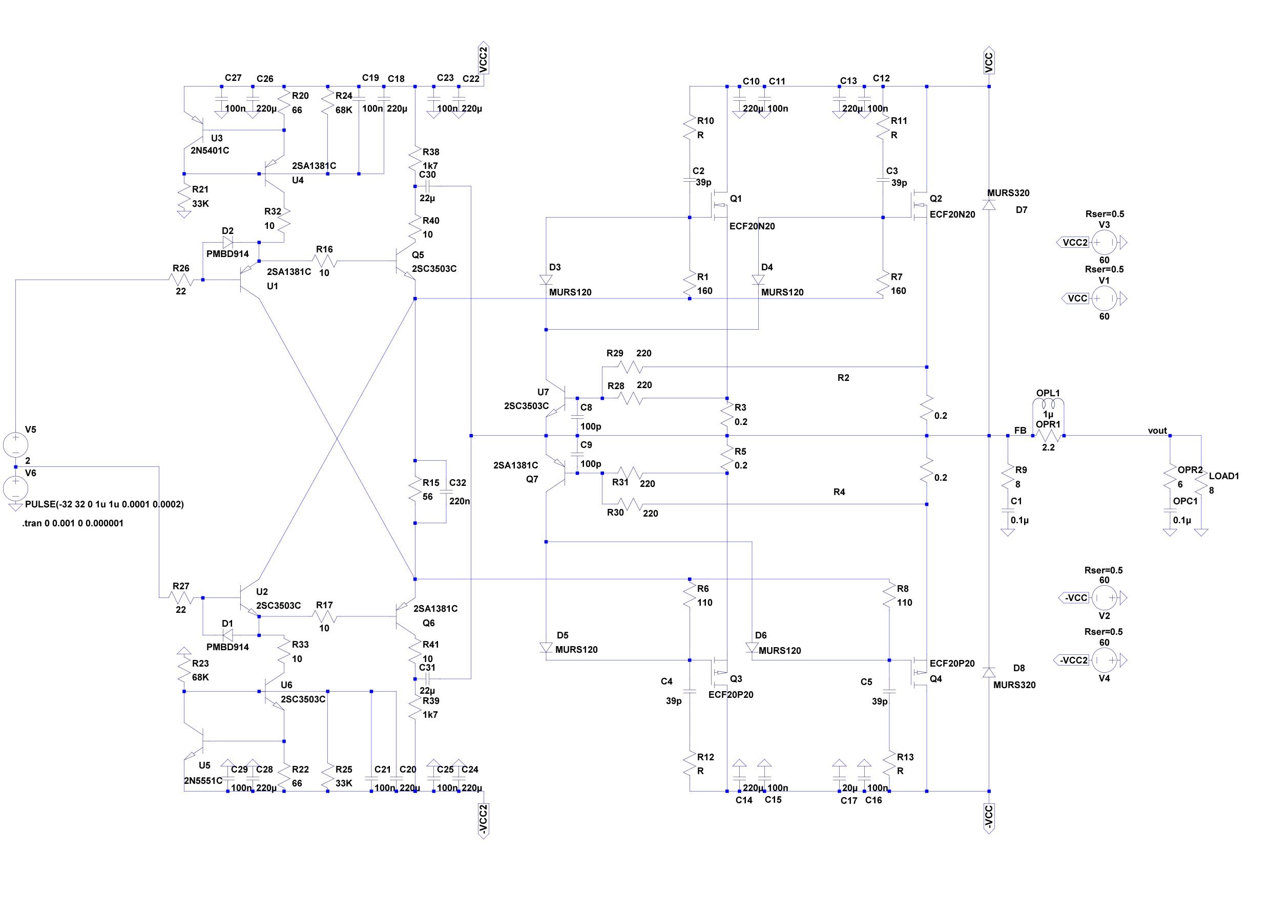

I'm now back at the simulator. Got the output stage separated. I think I have made a discovery. On the negative edge the U23/23 bases draw around 120mA each. Where as on the positive edge its only about 2mA.
Now going to trace the currents see where its going to.
What about C32 and C35? At transients the feedback transistors on all your current sources will be saturated, either turning off or turning full on because of the lytic bypass. 100nF should be more than enough to keep these stable. The lytics will only cause problematic recovery.
Tried removing them the lytics on the current sources. No change. It's something to do with the bootstrapping. I remove the bootstrap capacitors entirely and the current draw becomes symmetrical but 45mA.
Here is what I'm simulating. I've probably made some rookie error here.
Found biasing is failing on the negative edge. usually around 1.1V but on the negative edge hits 7V! Now the question is why. Voltage source doesn't work
You found a mistake they should all be 68K.
If I understand this correctly the bootstrap voltage should be quiescent voltage at the collector + whatever the output is doing.
What is very strange is that if you reverse the initial value and the Von value for the voltage source (signal generator) everything reverses and its now happening on the positive edge. The bootstrapped voltages at the collectors of the drivers is mad. One is tracking and the other seems to hit power rail + output voltage.
Its an ltspice quick. You expect the bootstrap voltage on both collectors to start off the same value (obviously one positive, one negative) but they don't. One starts off offset by the output voltage.
It's solved by using a second voltage source to give a 0V input to the amp at the start of the simulation then it runs fine. The second voltage source is a single pulse to cancel the first half cycle of the first source.

Actually, I found a way around that by using two square sources. This is the rig I use to simulate my amps. Consider it beta and incompletely documented, so ask questions if you really want to know something.

Its a good thing in a way that you didn't make the connection. It made me think. Best way to learn. It all makes sense now and knowledge has been gained about LTspice.
It all came down to following your suggestions earlier. I now know that the output stage is benign. The exicon models are ok and that the bootstraps are fine. Thank you!
Bootstrapped drivers work a treat now 😀. This is the driver topology sorted then.

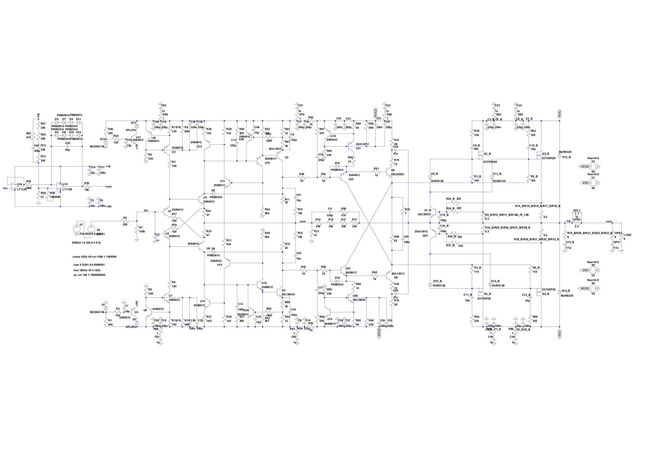

Here is what I hope to be close to the final schematic. Done a lot of experimenting and there doesn't seem to be any real improvements that can be made without significantly changing topology. Anyhow, feel I need to move on to the next stage. Which I think you can guess what that is and its not a prototype 😉
The power rail snubber positions are representative. Added VAS current limiting as I noticed during clipping the VAS was running way too much current. Lots of extreme tests have been simulated and the amp appears to be well behaved. Decided to keep the current source caps. Without them to diamond buffer current sources had a strange dip in output. Also, they don't seem to affect recovery as I think other mechanism kick in before they saturate completely.
PM = 83 degrees / GM = 12dB.

Is this a current feedback amplifier?

Without going into the arguments about what a CFB amplifier really is, yes.

Much better, this is around the min a allround high performance amp should have. You can use any speakers or cables without any worries.
The RC network on the bases of the vas is near always necessary to smooth a slight step that is caused by EF augmented vas in CFB. You can increase the gain margin by increasing the resistor in either the RC on the NFB compensation or the compensation of the vas but at the cost of PM. Yours is just dandy as is.
Its a nice high performance design, I would just cascode the input diamond so that I could use low noise RF transistors but your way with error correction to improve performance is a good alternate way.

Thank you. Hopefully, it'll sound good. It's up against the Leach, Sansui AU517 and Cyrus2 trio of amps.
I'm steering clear of cascodes in this version. I'm worried about cascode oscillation.

Have now got the all parasistics simulated down to 5n and some even below that.
THD has gone up massively and LTspice is having problems. It just spends ages source stepping.
The good news is that the circuit is stable and still has much the same spec other than thd.
If only I could get LTspice to simulate without stepping so much then I could make some progress with the THD.

I hear you! That can be one of the most challenging things.
I have found on many occasions that if I leave a capacitor "dangling" with one side not connected to anything, it will stop convergence. LTSpice doesn't seem to recognize open-ended caps as singular matrixes and I'm not sure why. Deleting these caps or terminating their loose ends somehow often unfreezes the simulation. You might try Rclick->Rpar=100meg.
Also, try running the amp without solving the DC operating point (sim cmd->skip op point). This will allow you to see start-up behavior. Sometimes the sim can't find the operating point simply because the circuit in it's present state wants to latch on startup, or is unstable during startup.

At least its not just me. I have noticed that reducing the mosfet bias improves things. Could this be a clue?
Just tried skipping operating point and it is unstable. There's some oscillation at the beginning that dies down. Then the simulation settles down and there is no output from the amp.
