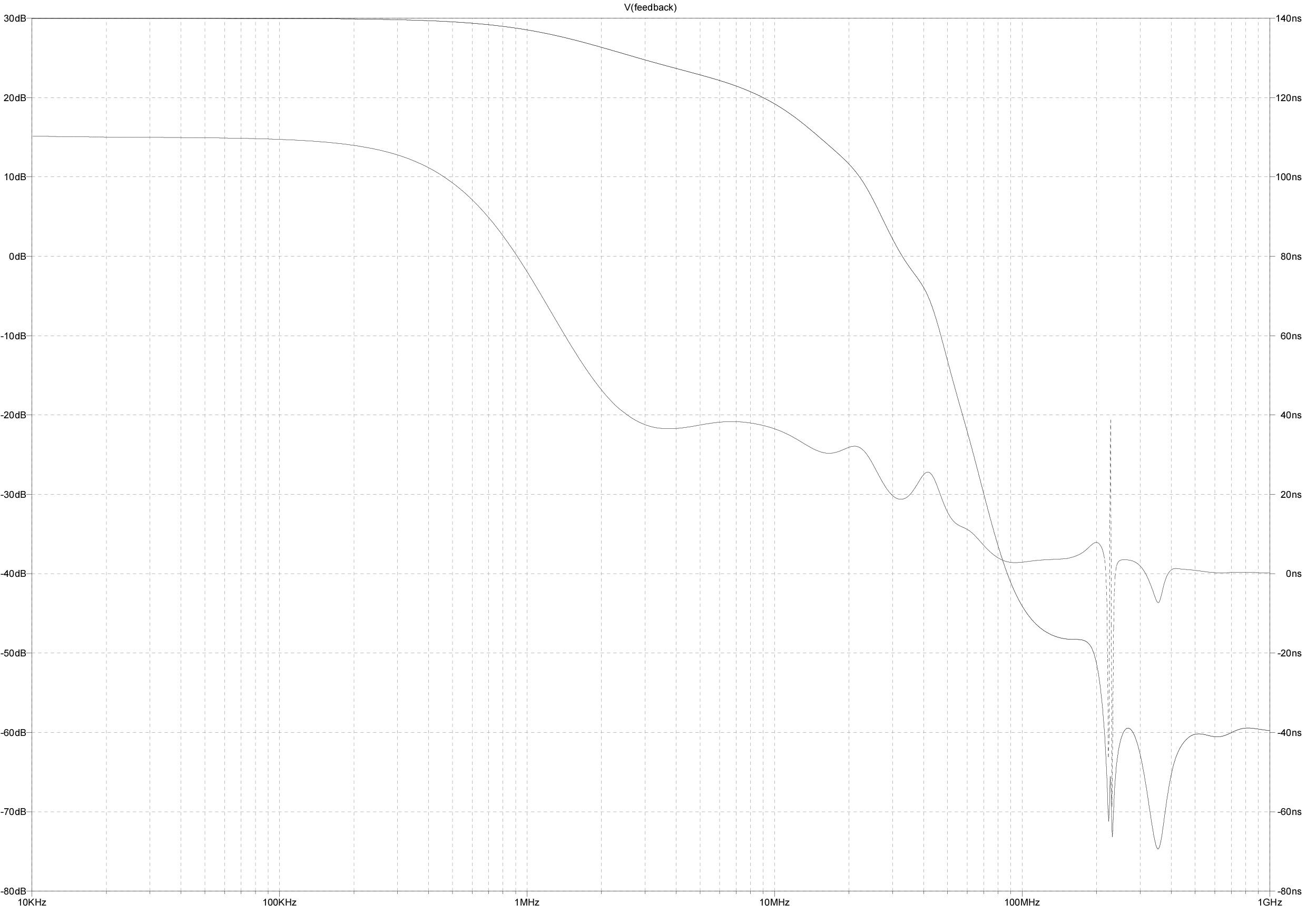

I would like to ask your opinion on this loop gain plot. This is from the full parasitic simulation. Would like your opinion on the shelving at around 200Mhz. Is this a problem?
The top line is the gain the bottom line is the group delay.

How did you extract phase margin from this simulation of closed loop performance? Phase margin is defined as 180 degrees minus (phase of (Vout/Vin) open loop) at ULGF, and people usually extract it from an open loop simulation.
The PM/GM came from a different simulation of the same circuit.
I've used the method described in Cordells book page 88 Fig 4.7. Where the loop is broken by a 1G inductor etc. Hopefully, I've done it correctly. I look for the point at which the gain falls back to 0dB after the peak.
The compensation scheme is now an adaptation of Edmond's DTMC which he claims had 95 degrees of PM in the MCP amplifier design of his.
I would use the method in /examples/educational/loopgain2.asc in your LTSpice folder. I've often had problems or inconsistent results with other methods.
I shall try this method. This may be the method I've seen that looks like hieroglyphics to me at present. Need to get an accurate measure of this then maybe I could trade PM for higher ULGF (or vice versa).
Do you think the shelving is a problem in the loop gain plot? It's not a peak as I've zoomed (focussed the sim) right in at that frequency.

Interesting, just succeeded in getting the open loop gain example to work. It appears Bob Cordell's version isn't too far off (assuming the LTspice version is more accurate). Bob's version reckoned PM=100 degrees GM = 16dB. Ltspice version reckoned PM = 96 degrees and GM = 18dB.
Edit: I may have got my maths wrong... Is it 180 minus the reading at 0dB?
Wasn't comparing apples with apples and my maths / logic was wrong. I had already traded PM for ULGF and had forgotten. Both methods give 87 degrees phase margin and 18dB of gain margin.
