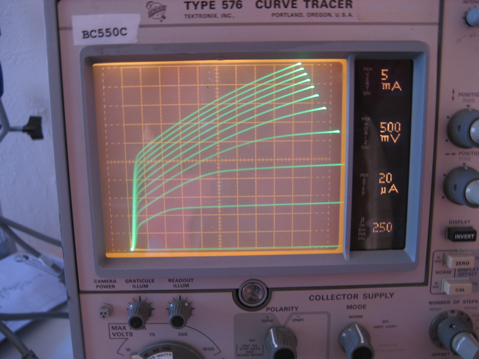

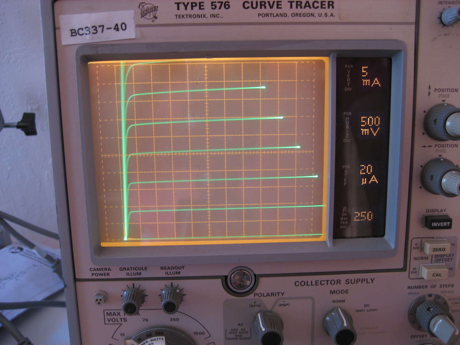

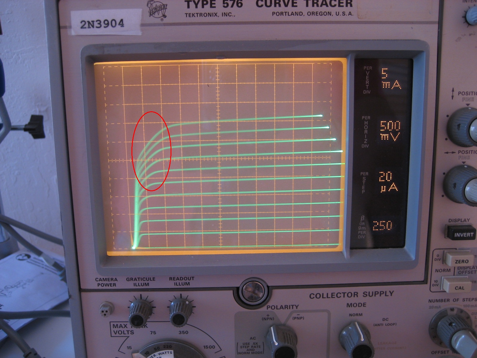

I just took I-V curves of 3 small signal NPN transistors (Thurs 01 Aug 2013, at 18:55 GMT). They are attached. I believe DIYaudio members call the phenomenon circled in red, by the name "quasi saturation". Device type is noted in the upper left. Sorry I didn't use a Polaroid scope camera :rolleyes:
You'll see that all three measurements use the same setup:
  • 10 steps of base current @ 20 uA per step
  • Vce = 0v to 5V @ 0.5V per division
  • Ice = 5 mA per division, 10 vertical divisions max

Thank you!! You have some decent equipment.
The phenomena is very real then. I best obtain a decent amount BC337-40s then.
If I'm understanding the pics right the BC337-40 looks almost ideal at low Vces.

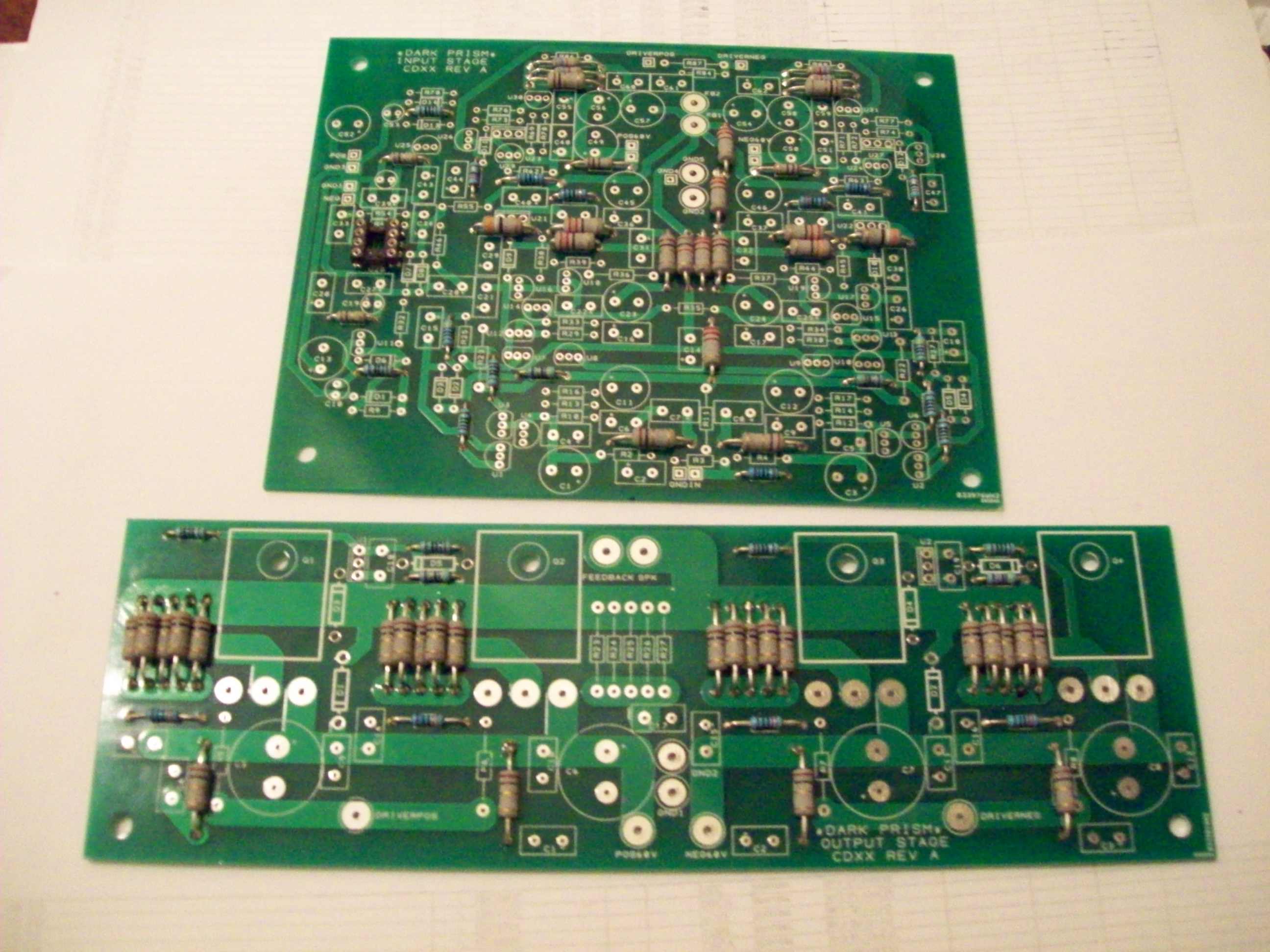

Things are progressing. I have pieced together a BOM and placed orders for some components. Just finalising the last two orders. The PCBs should arrive sometime next week. Then its build time. :D

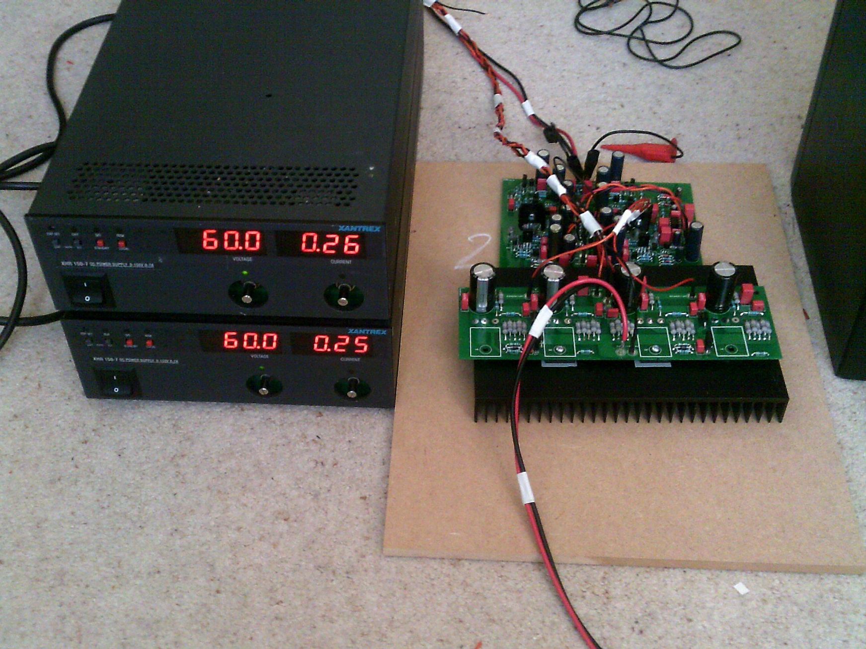

It only works!!!!
Almost exactly as the simulation predicted.
The only small difference was the boot straps. They were predicted at +/-15V and reality is +/-13V. Not a problem. Bias was simulated at 150mA and is as close as damn it. Can't see any oscillation with the MOSFETs which was a relief.
Square waves with no overshoot but not as defined as the simulation.
Learnt that grounding is ABSOLUTELY critical. Got a bit of a noise problem getting in but that I think is the result of the test setup. Going to have to improve that. Once I sort the noise issue I'll post some pics.
It is stable into the test speaker without the L//R output filter. I have run at various levels and from frequencies 3Hz to 100kHz. Unloaded it gets to within 3V of the rails. It also clips nicely unloaded.
Where to go next is the question... Aside from the noise issue what is the next step?
Really pleased with initial testing especially for it being the first amp I have ever designed.

Sorted out the noise issues. Just taped all the pairs of conductors together and the noise virtually dissappeared. Been giving the single channel a listen and in mono and off an mp3 player it sounds pretty good.
Looks like a very good job!
Also twist the pairs and the noise should almost disappear. (Of course, you should have done that before both ends were connected...)

I did plait the power leads but then got the grounding wrong and got some strange square wave oscillation. Then the path of least resistance was to use tape.
PM in simulation is 58 degrees. Gives enough stability to drive a speaker directly.
Here's a pic of the initial setup. It now has 2 pairs of outputs. And no oscillation!
