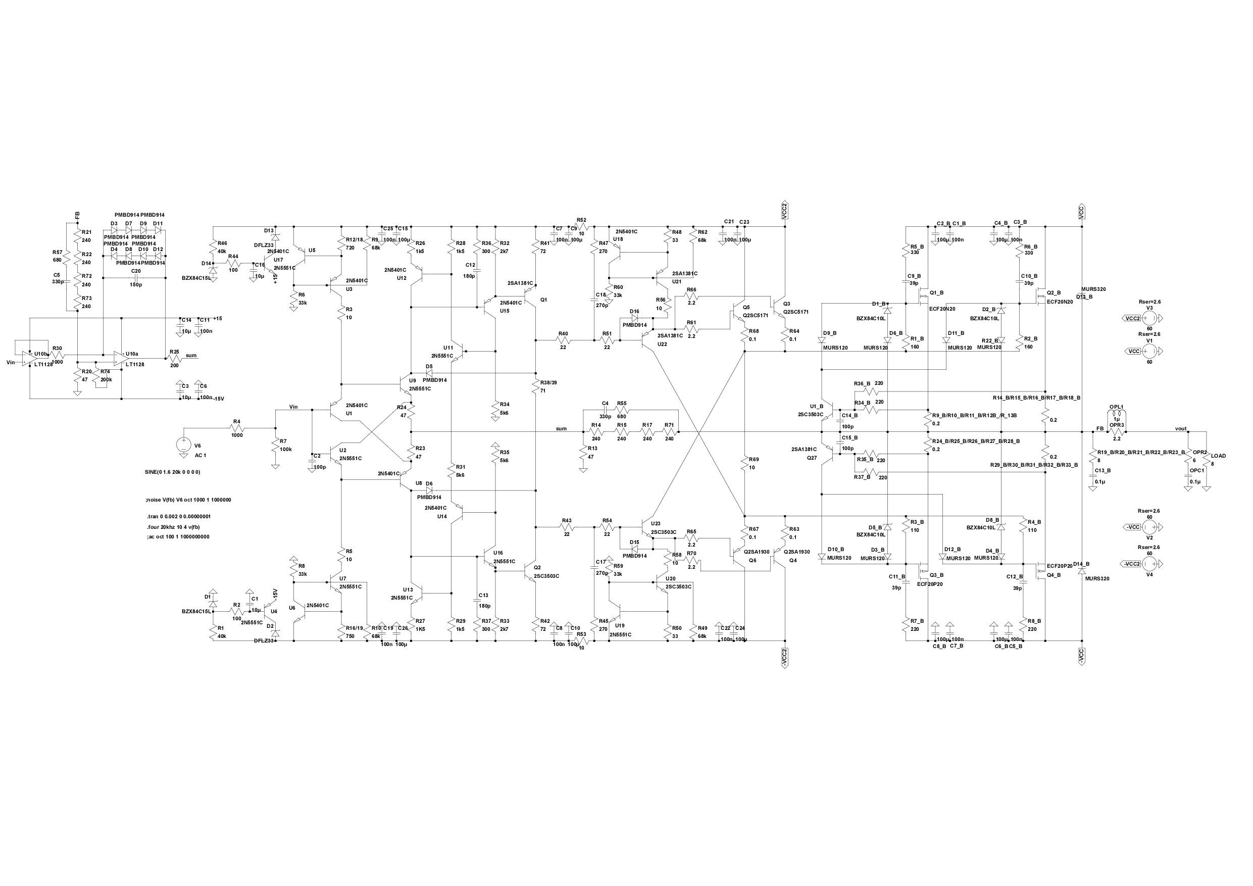

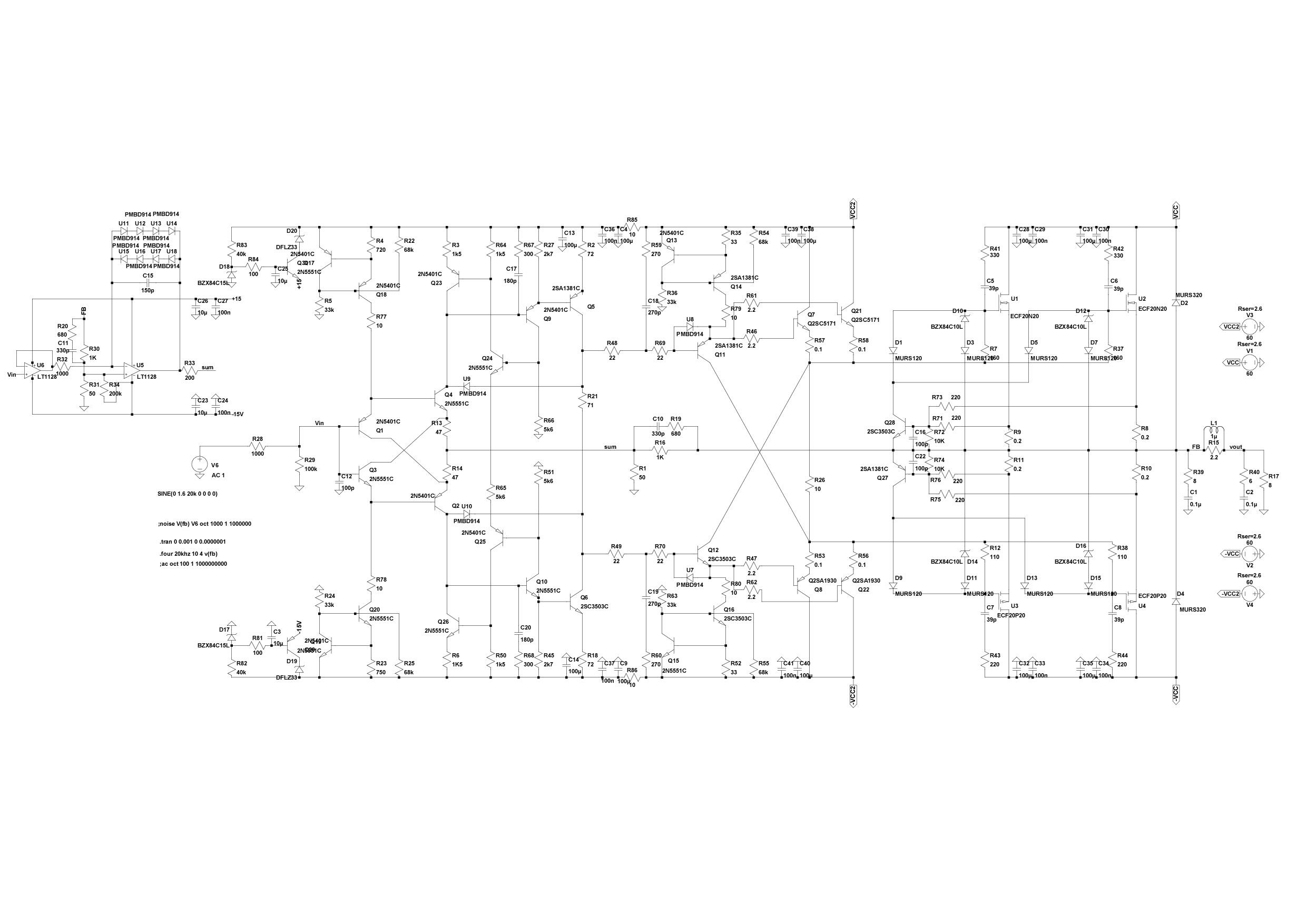

Here is the schematic...

Been a bit quiet of late... Been busy progressing this project.
<snipped>
1) Regarding parasitics what would be a good series resistance value for the DC supplies in LTspice? I have read that 2.6R is a good value but does this take into account the reservoir caps? If I use 2.6R I get a peaking in the closed loop response just before roll off. Not good. Can solve this by slowing the amp down but this results in an increase in THD at 20K.
<snipped>

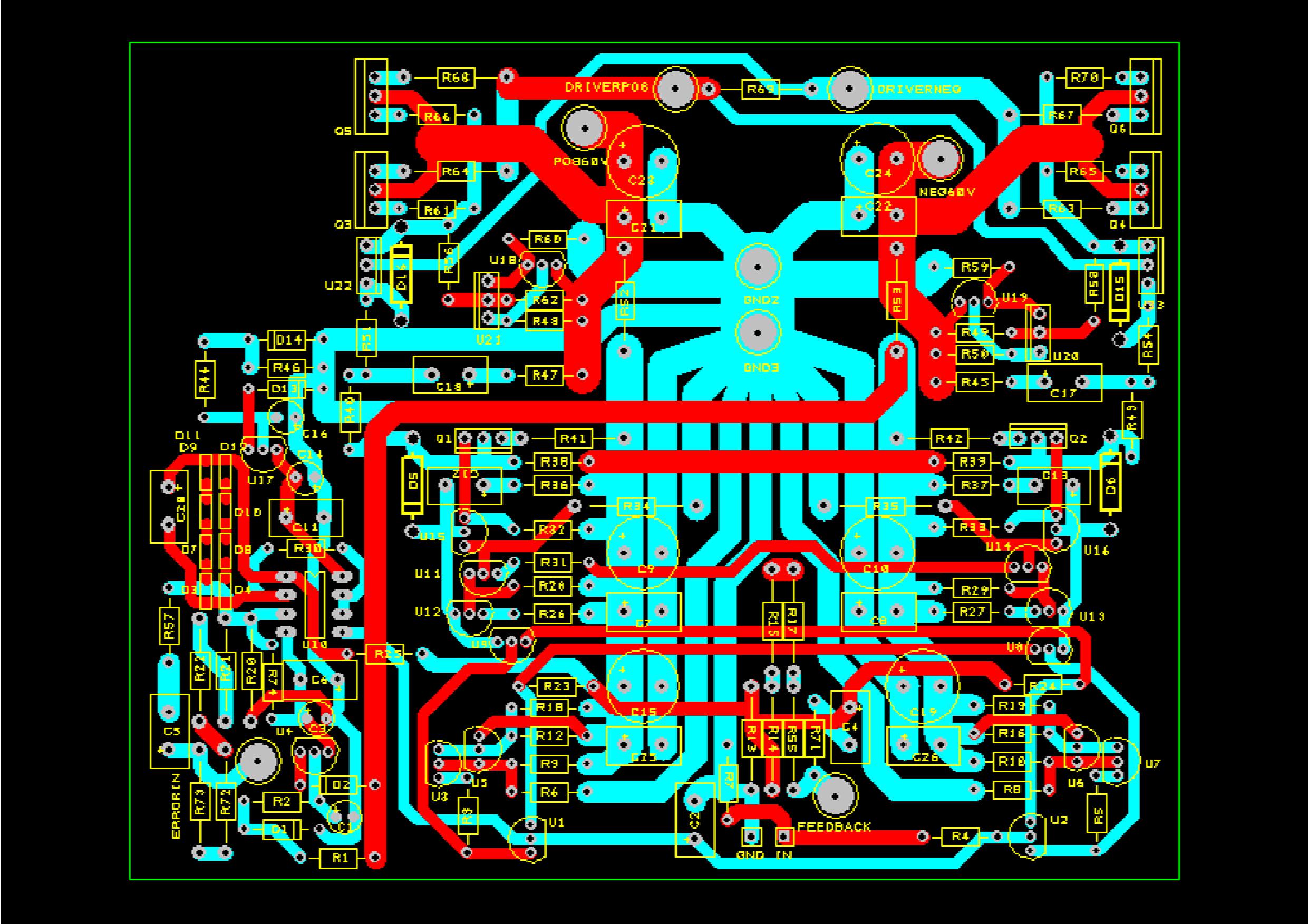

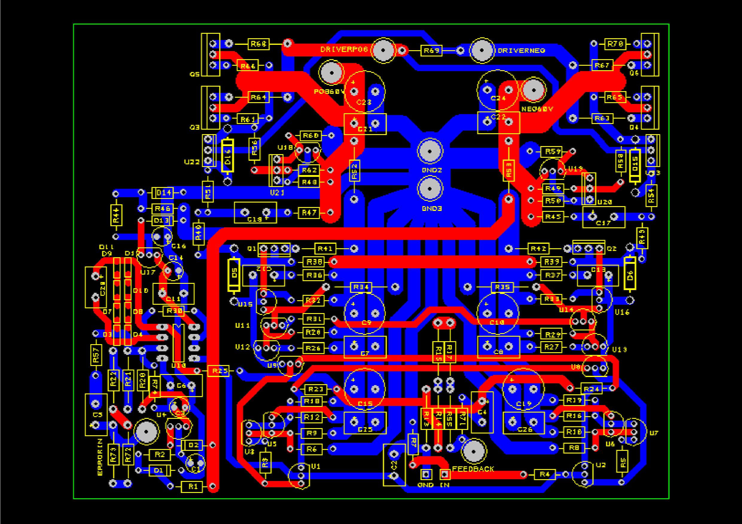

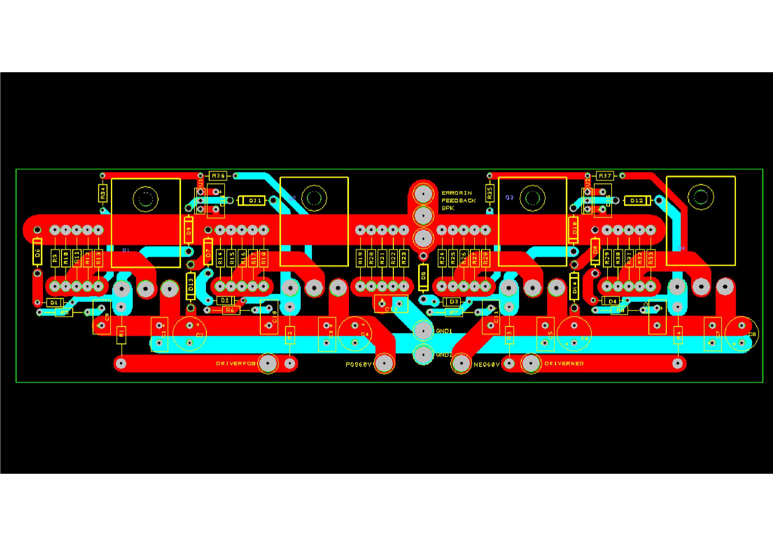

I will be posting PCBs and updated schematics soon.

Thank you, Andrew, for helping me with this. It makes sense to me now. Then the putting a cap over the +/- rails would work for maybe an opamp but not for an amp output stage. This would actually end up increasing the loop area and cause currents to flow in the neg half of the PSU.
When I post the 1st version of the PCBs for this amp you will be pleasantly surprised to see the rails going sown the centre of the PCB with virtually all components out side of this. I remembered reading your advice on this some time ago and thought "this makes sense" and gave it a try. May not have implemented the loop idea perfectly but have had a go. I understood the concept of loop area but not decoupling.

This has been painful....
Have found the peaking problem. I think it was always there just over looked it. Have changed the compensation of the amp and reduced the VAS current. I ended up going open loop and doing an AC analysis. The open loop response was clean but once the feedback was reconnected it reappeared. This lead me to adding a capacitor in series with a resistor across the feedback resistor. This I thought was against the rules of CFB amps. Yet, the amp smulates ok into reactive loads. The square wave output is clean. The PM is now 81 degrees and GM is 12dB. ULGF is now only 3Mhz. It could be raised but I'll leave that for real world testing. At the moment I'll stick with safety.
Have added the fly back diodes as suggested. Couldn't find a spice model for the 1N5404 so just added a MURS320 in LTspice.
The PSU is a figment of imagination at present. I envisage a dual PSU off one transformer with 30000uF + 3000uF reservoir caps. The smaller PSU will be CRCRC and the larger PSU will just be a basic arrangement. There will also be some DC protection.
All parasitics for the caps have been added back in and everything is ok.
Mark, that capacitor looks good. I especially like the ripple current. Just got to modify PCBs to accept it.
Thank you for all your help

Quick update
Time is a bit limited today. Just posting these as an update. The PCB images are not the best and will be working on a better way to post them. There must be a way without exceeding the image size limits.
Please do not spend too much time trying to read them. The main purpose of this PCB layout is to allow parasitic transfer to simulation. All components on the the schematic suffixed with a B are on the output PCB.
The input PCB will be mounted above the output PCB with the output PCB flat against heatsink. The L//R filter will be remote.
Paul
Paul
Is this easier to read? Also noticed a track error in the previous version.
I have no 1:1 filing about dimensions but looks like ground tracks can be smaller width. Two sides can be closer in that area and rectangle will be smaller.
- Amp design attempt number 2 (simpler)
