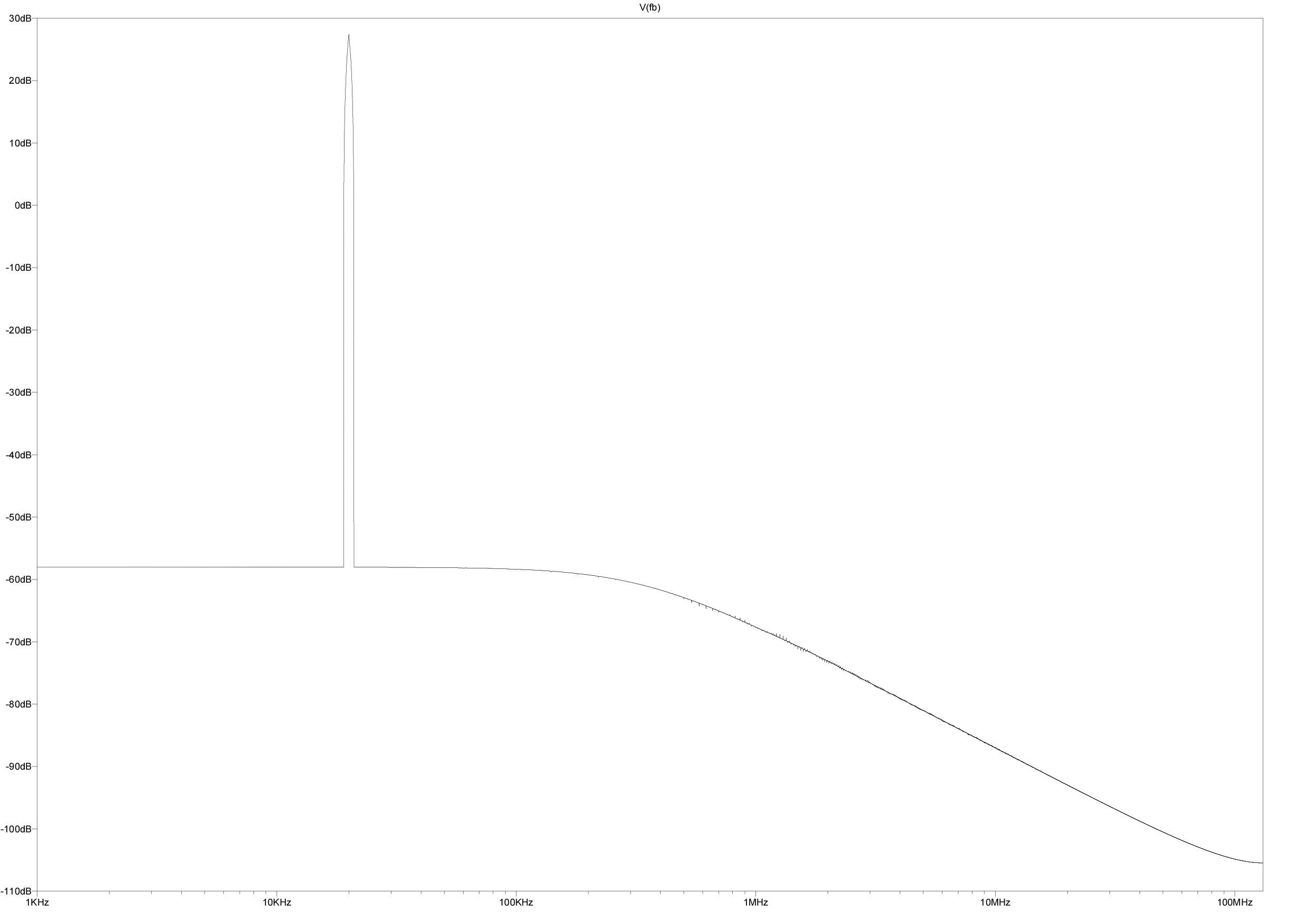

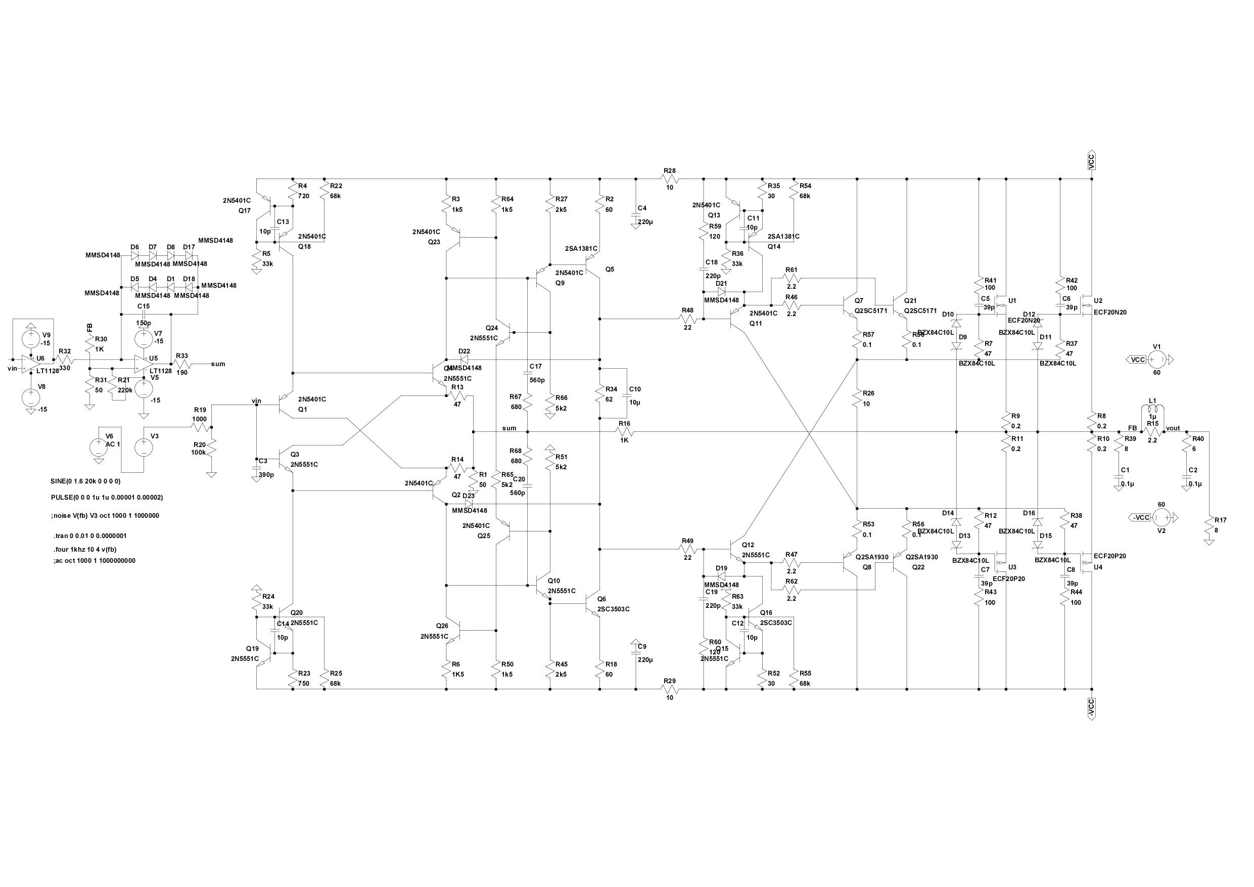

Apex (DC Offset) vs Hifisonix (AFEC) vs mcd99uk
Went back to basics. Took some ideas off Apex and his FX8SCF. By chance the first version of this amp resembled his amplifier. Then having read a paper on distortion only feedback and having previously experimented with Hifisonix AFEC I decided to go back to a more basic amp that was stable producing half decent THD figures and then add on a small dose of AFEC.
Also, reduced the number of cascaded transistors. The amp was much easier to compensate than the others.
The result is this creation.... No HEC only distortion feedback. It doesn't care about low impedance loads and doesn't seem to mind reactive loads.
Figures... All into 8R.
THD @ 20k +/- 2V = 0.000027%
THD @ 20k +/- 32V = 0.001224%
THD @ 1k +/- 2V = 0.000133%
THD @ 1k +/- 32V = 0.000644%
Not outstanding figures but low enough for pcb layout to be the limiting factor. Could wind the AFEC up a bit but this can wait until potential real world experimentation. Still got some tweaking to do anyway, like adding baker clamps etc.
The only down side is a small overshoot on square waves.
What do people think of this one?
Paul

- Gain at DC is 21X so you'll need a means to trim the output offset, or nullify it with a servo. Do the opamps @ leftside also perform this function?
- Maybe there's a way to connect the collectors of Q9 and Q10 so their VCE is constant even when passing large amplitude waveforms. If so this would reduce distortion.
- R28+C12 appear to frequency compensate Q7. Why not connect them from base to collector, rather than from base to not-the-collector?
- What's the power dissipated in R39 when driving a just-barely-clipped 20 kHz sinewave into an 8 ohm load?
- I would hope that the DC bias current in the drivers Q7, Q8 is at least 100 mA, for good control of the MOSFET output stage when slewing. But low-VTH MOS transistors and R26= 120 ohms suggest that driver stage bias is much lower. What's the simulated value of Ic(Q7)?
Thank you for reviewing my circuit. 🙂
Resistors R24 and R25 represent a 10k variable resistor and the opamp circuit reflects the dc component over to the output of the amplifier. I have considred a dc servo between the input of the amp and the output. Can't do a normal servo which connects to the summing node as it fights with AEFC. Going for a DC servo does give lower distortion and come to think of it may use less components.
Should be possible. Some sort of cascode like arrangement. Have to have a think about how it could be done.
R28 and C12 was included to load the VAS at high frequencies and add some amplifier compensation. Without these networks the ability to drive capacitive loads is very much reduced.
The power dissipated when clipping is 5W.
In the current setup, you're right, the driver stage bias is only 10mA.
Tried changing drivers to MJE150xx types and increasing the bias to 70mA. The THD increased significantly. Maybe this is caused by increased loading on the VAS. Wouldn't the output device stopper resistors limit any advantage of a much smaller R26?
Maybe the alleged increase in predicted distortion is more to do with swapping the transistor models.
Yes, I tend to agree because given that hfe is still significant and the current is small, the loading on the VAS should still be minimal.
In reality, I plan to use bigger drivers probably either the 2SA1225/ 2SC2983. But the power dissipation of running 100mA bias is quite large and may force either a compromise or using the dreaded MJE150xx transistors. I would rather the compromise and use the lower cob transistors.
PS I like the use of the word "alleged" 🙂

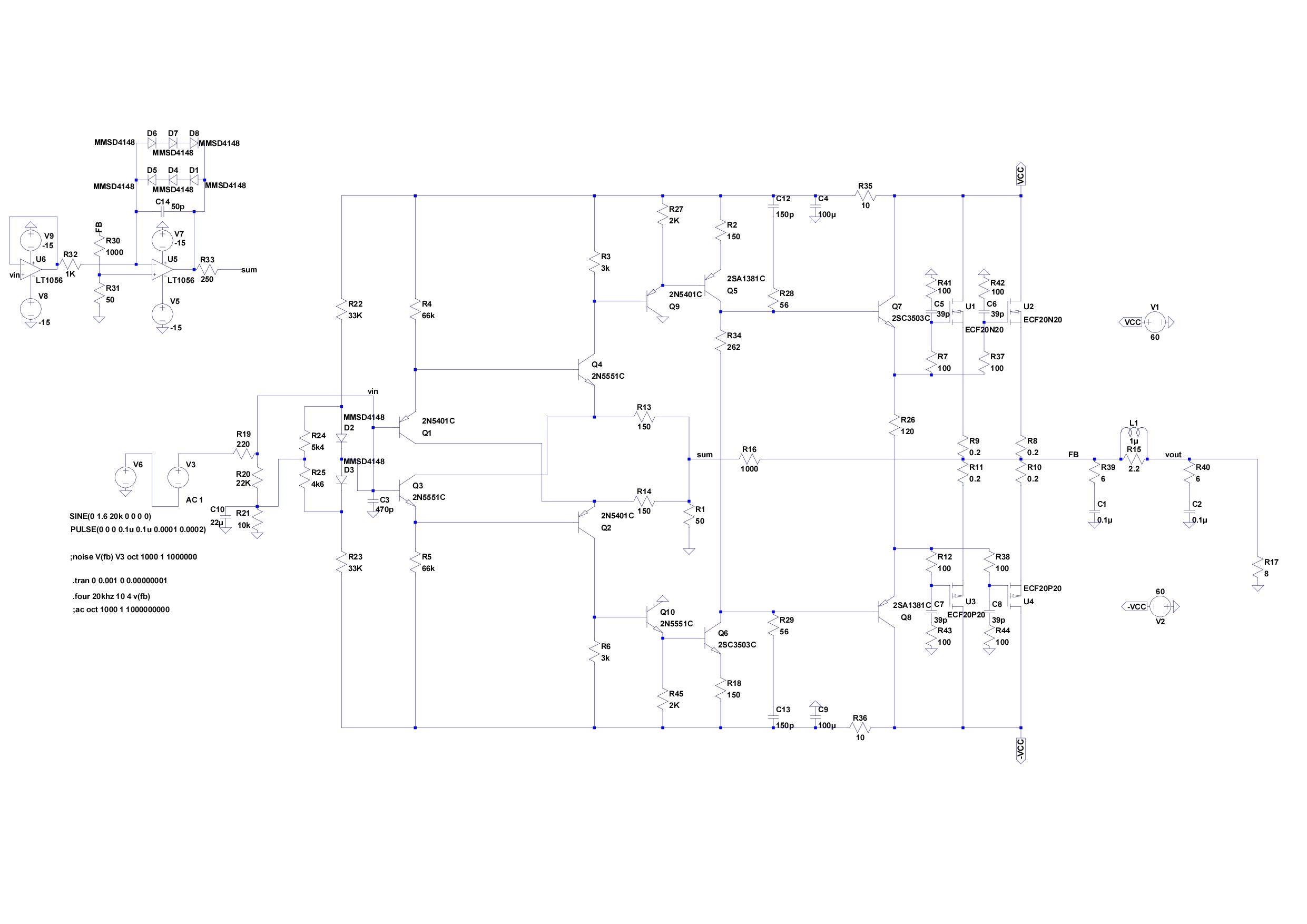

The evolution continues
Here's the latest version. A lot has changed, have used the common mode loop control and associated compensation from the MCP amplifier on the Data Odyssey site. What a difference... Also, using X buffer output stage. Boosted the driver bias up to just over 100mA as well as boosting the VAS current.
Still got fine tuning to do but looking promising. Need to tune the compensation properly for best THD vs GM/PM. Also, need to decide whether to use the current sources at the front end. Might also go back to a normal output stage. Had enough of simulating for today. 🙂
It has gained a stage and become a cascade of 4 instead of 3 but losing that stage destroys the performance and strangely the amp is less stable.

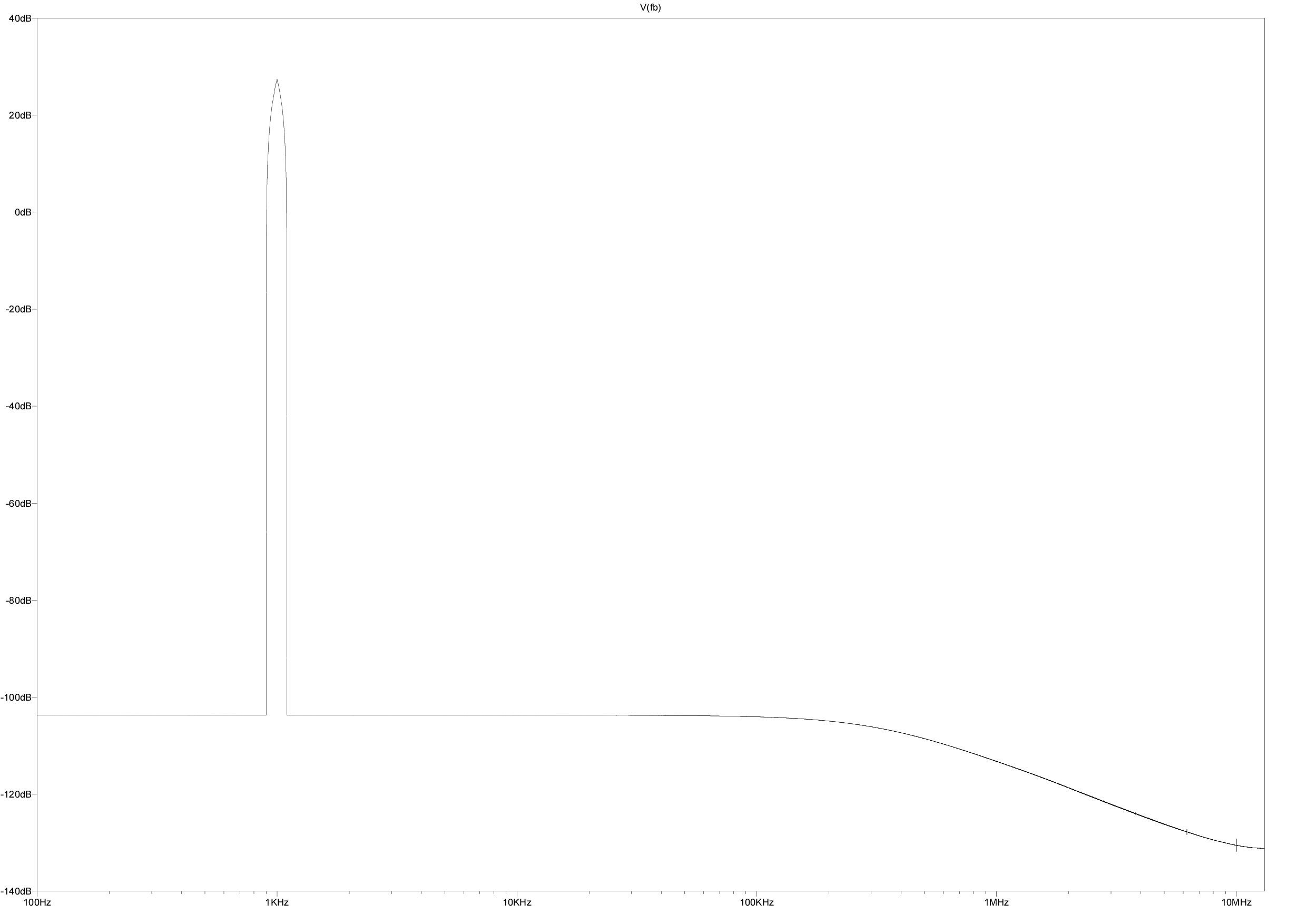

THD figures... Simulation of course.
THD @ 20k +/- 2V = 0.000002%
THD @ 20k +/- 32V = 0.000151%
THD @ 1k +/- 2V = 0.000000%
THD @ 1k +/- 32V = 0.000000%
Even without the AEFC THD is respectable...
THD @ 20k +/- 32V = 0.000597%
Won't see this kind of performance in reality sadly 😉

- I'd suggest you monitor the power dissipation of predrivers Q11 and Q12 when delivering a full-amplitude, slightly clipped 20kHz sinewave into 8 ohms. Both RMS average power, and instantaneous power-vs-time. You might want a beefier package than TO-92 in those positions.
- I like your choice of drivers (Q7, 8, 21, 22) and bias current; these ought to authoritatively control the gates of the output MOSFETs, even under severe conditions.
- You might find that you prefer the low capacitance NXP diode PBMD914 (datasheet) rather than the MMSD4148. Its Cmax is 1.5 pF, while the 4148's Cmax is 4 pF.
Mark,
I shall do as you say and simulate the power dissipation of the pre drivers. May substitute in 2sa1381 and 2sc3503. then I could up the current sources supplying them. I like the idea of high biasing with MOSFET outputs. It seems to help stability into reactive loads and help THD.
I like these drivers too as they are very low cob. The SOA is a bit suspect that's why I paralleled two pairs for safety. The MJE150xx drivers are horrible in a fast amp. It made mine oscillate in ltspice even with no input signal. Then looked at the closed loop response and there was a nice peak...
Indeed, I do prefer that diode, it is a superior device.
Do you think that a ULGF of 4Mhz is asking for trouble?
I very much appreciate your help, thank you!

There really is no need for such high bias current or such high power transistors for the application, those are lateral mosfets. As there is two in parralel is there is even less of such requirement. If I remember correctly the application notes for those devices supply all the necessary and correct information.
No.
I'm away from my bookshelf for the next several days so I'm not able to quote chapter and verse, but I recall that 90% of the amplifiers in Bob Cordell's book have a unity loop gain frequency of 10 MHz. Look at the Bode plots; closed loop gain -3dB corner frequency is 0.5 MHz and ULGF is 10 MHz. Since closed loop gain is 20X, these numbers are in agreement. As I recall, Self's book approves of 10 MHz ULGF too, but this is well disguised; it's embedded in a discussion of "number of dBs negative feedback at 20 kHz" or some other contortion.
Since you are using extremely fast output stage devices (FETs), the amount of "excess phase" they will contribute at 10 MHz is quite small. (and at 4 MHz, even less). I expect your feedback loop will be very stable when compensated for 4 MHz ULGF. Using the considerably slower bipolar pair MJL3281A/1302A, whose fTs are "only" 40 MHz, I get stable and solid performance at 10 MHz ULGF.

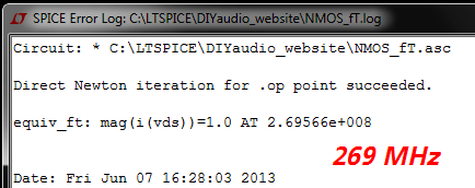

(It may give you a giggle to extract the "equivalent fT" of your MOSFET's spice model: Run an AC analysis with the device biased at VDS=10 and IDS=1 amp. Apply an AC current source to the gate and plot (Idrain/Igate) versus frequency. Where this curve crosses below 0dB is the "equivalent fT", i.e., the frequency at which the device ceases amplifying. I betcha it's waaaaay above 40 MHz. Meaning: it's a durn fast sumbitch, pardner.)

Edit: Extracted the Ft from the models and it was somewhere around 400Mhz 😉

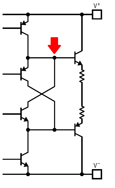

Have been looking at the section on current limiting in Bob Cordell's book and am currently leaning towards the opto/triac solution. I like the fact that its either on or off. It's also very simple. This circuit doesn't seem to accept natural current limiting as it just oscillates.
