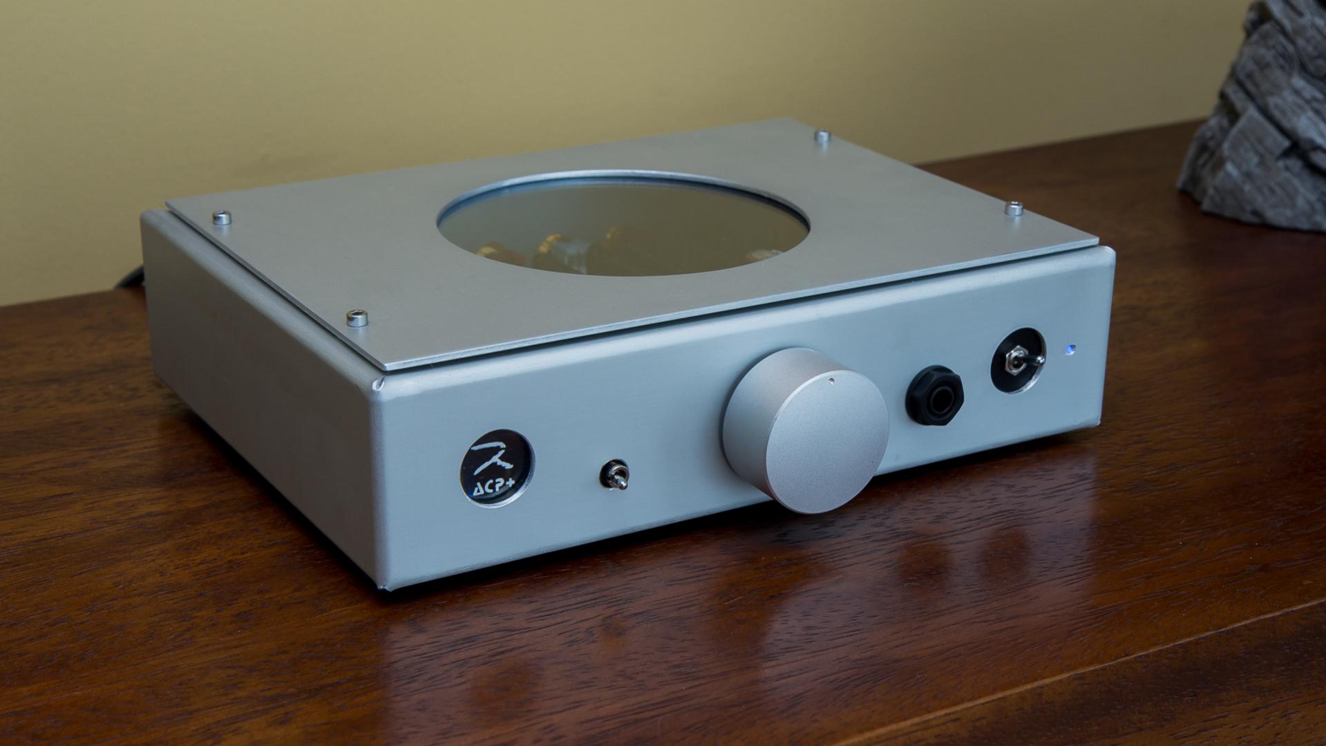

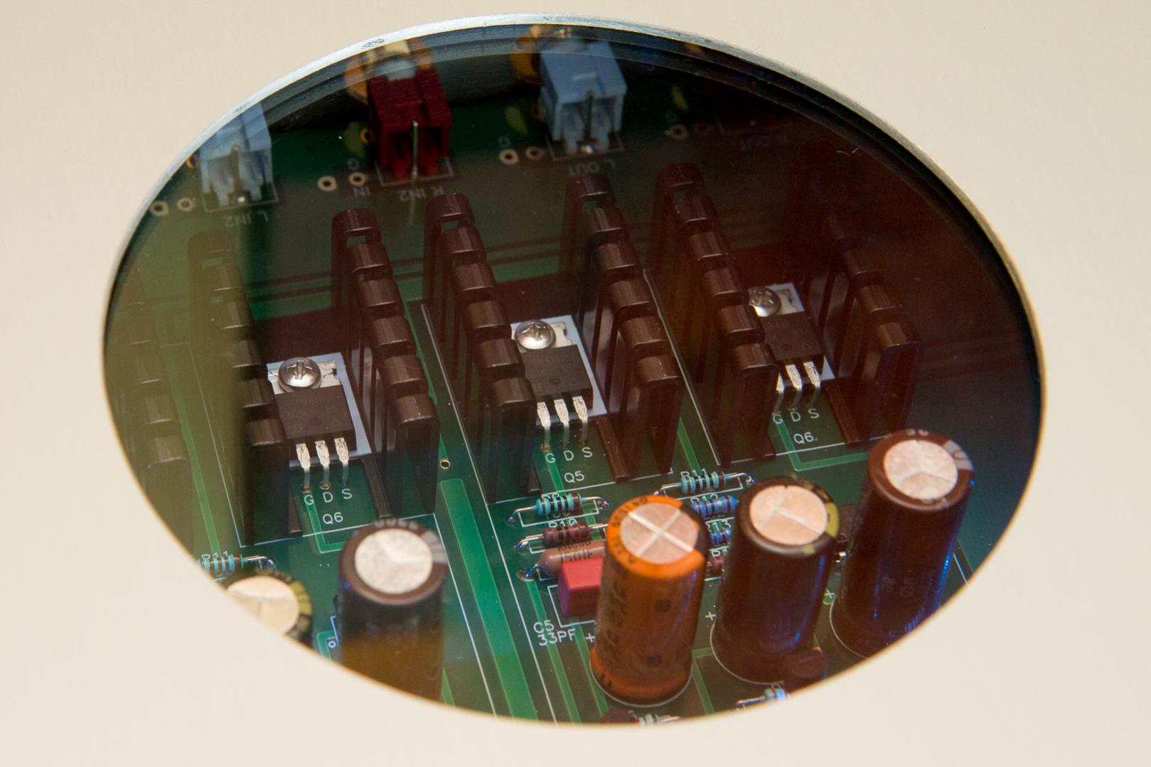

Well, my ACP+ is up and running! Thanks so much Papa Nelson, Jim, Tom and all the community for your help, the myriad of posts in this thread with recommendations and pointers.
After the minor hiccup with the PSU, I ended up purchasing what was available locally: a fake Samsung 24V laptop-type PSU. It's working, I could bet a month's salary that it is noisy as hell. No way to test it, I will wait a bit to finalize the process of replacing the PSU with the suggested one.
Other than that minor issue, the store's Kit is beautifully put together. Thanks Tom!
The PCB layout from Papa Nelson is so gorgeous, that the "naked" PCB was very tempting! Alas, a cat, a dog and the chance of smaller nieces and nephews visiting (hasn't happened since the pandemic, but one could only hope it is almost over!), prevented me going that route.
So, with some 3D modeling and the help of the community, I decided to go with a hand-made aluminum chassis with a look-through window on top. Since I was going to pair it with a Chord Qutest, it also had somewhat of a "theme" going on:
It pairs lovely with the VFET amp, as so many have already reported:

Wow, Rafa! That is a thing of beauty! The positioning of the blue LEDs inside the case are spot on!

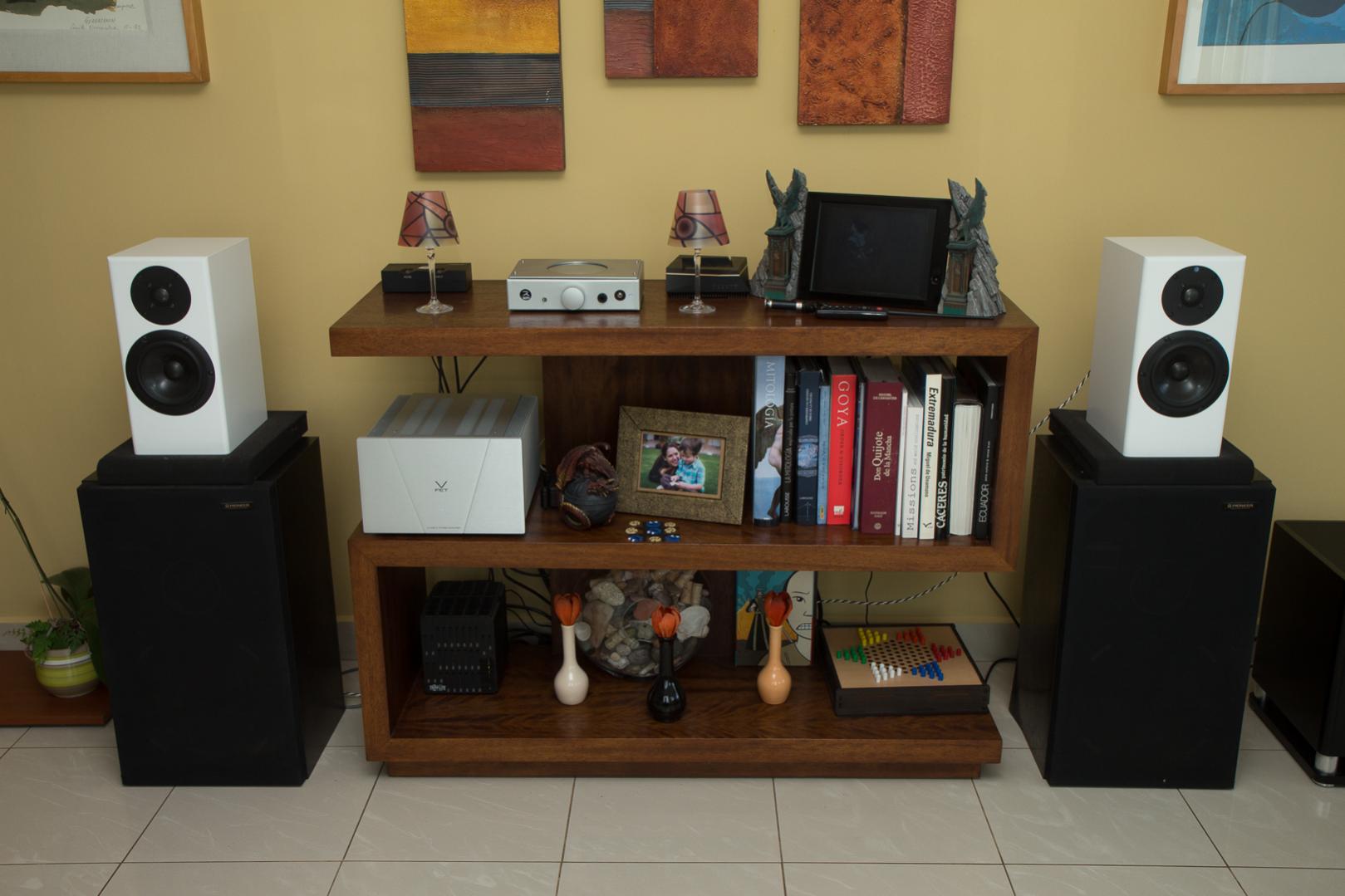

Thanks everyone for your comments! It’s so great to read all the support from the community. It has been a relaxing Saturday sitting in the living room listening to the ACP+ and the VFET amp. Really lovely.
