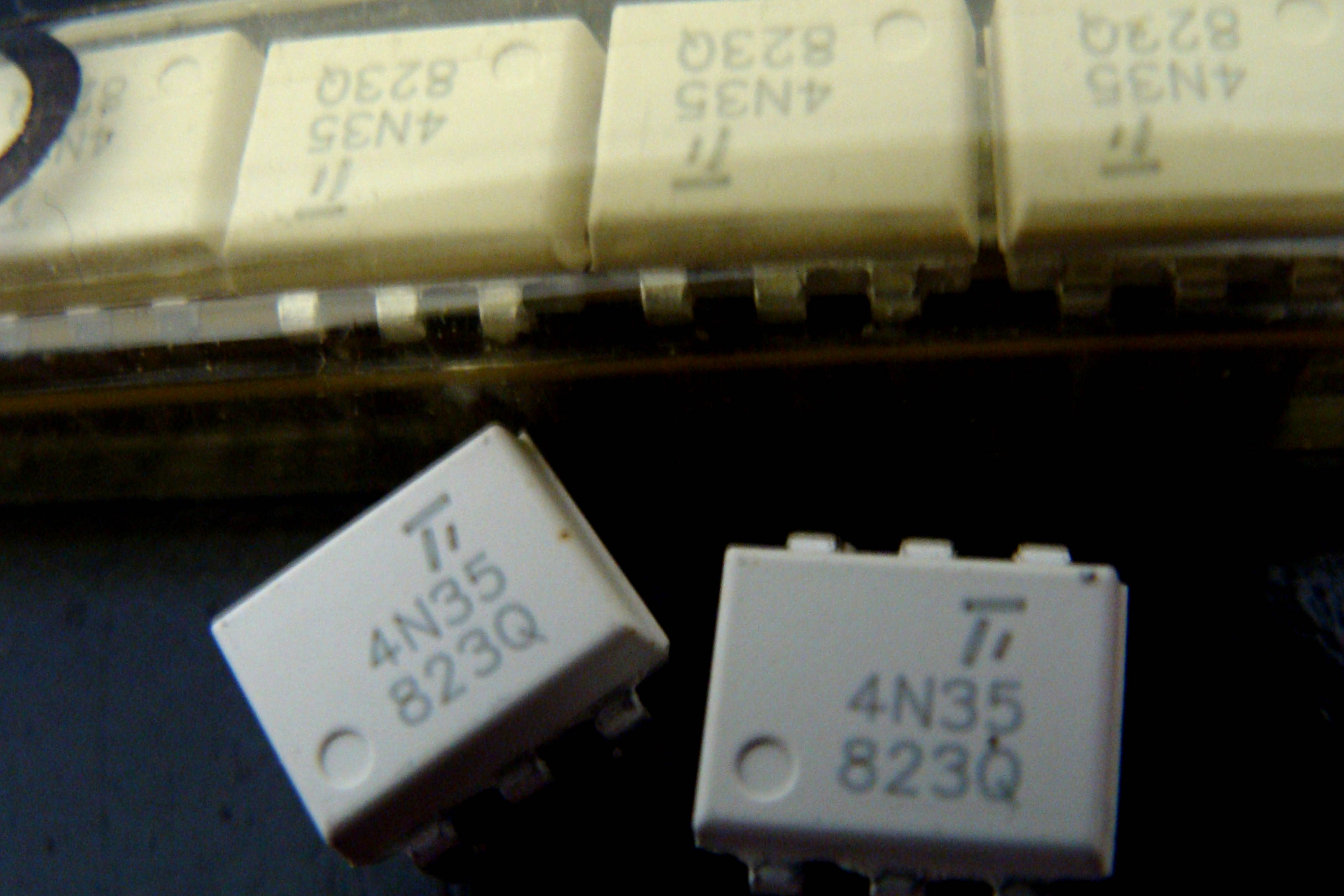

Could anyone say what brand this is, inscribed in this 4N35? Can I use this on my pcb?

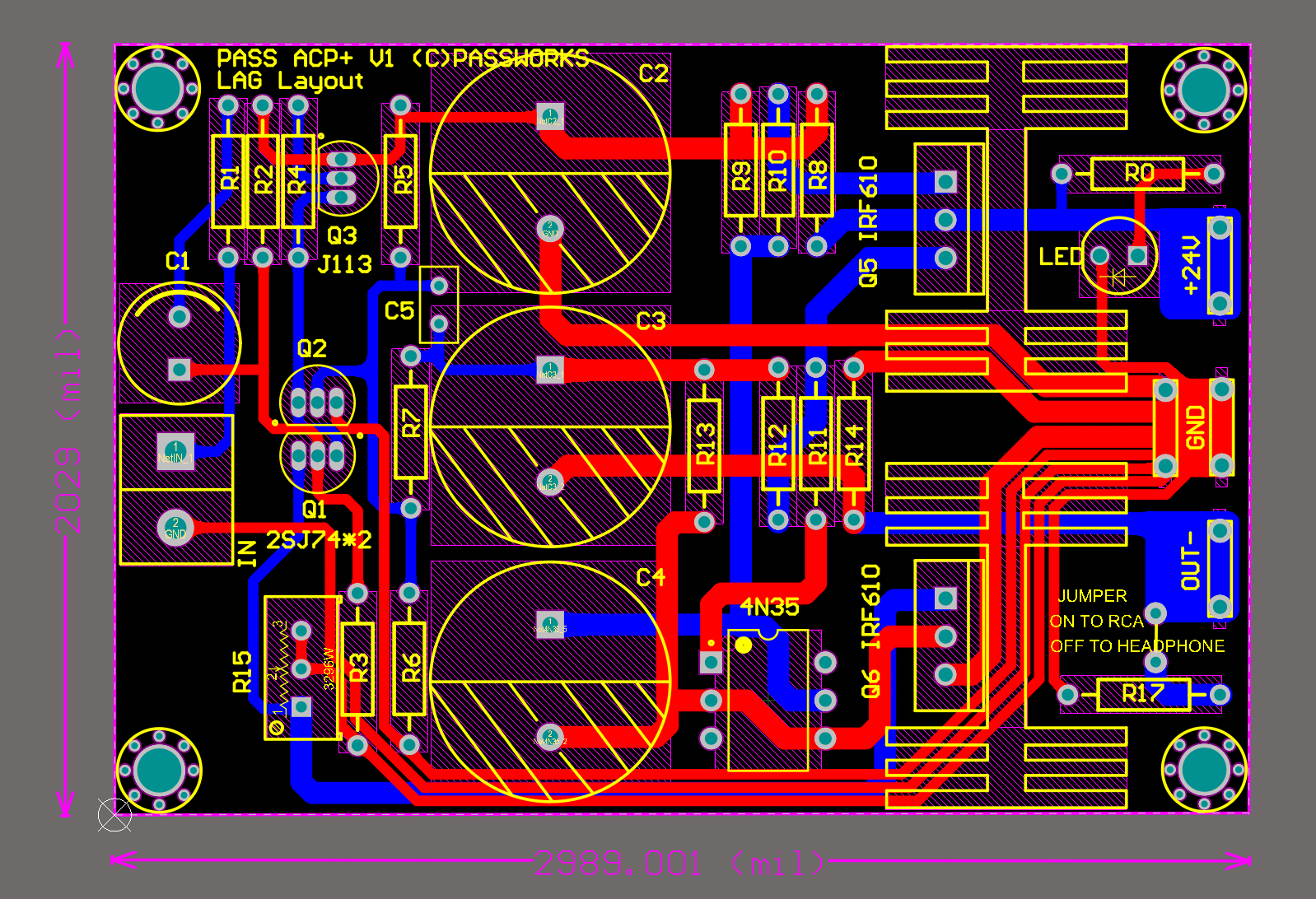

Soooorry,my mistake!Q3 pins (=j113) on PCB is wrong.
Now when I use J113 on my other PCB project , I found pins is rong!!!
I am SOOOO SOOOOOOOOORRY!!!
I had maked it up now!
The software is AD20 , u can modified it freely.
BRG!
View attachment PASS ACP+ V1.zip
