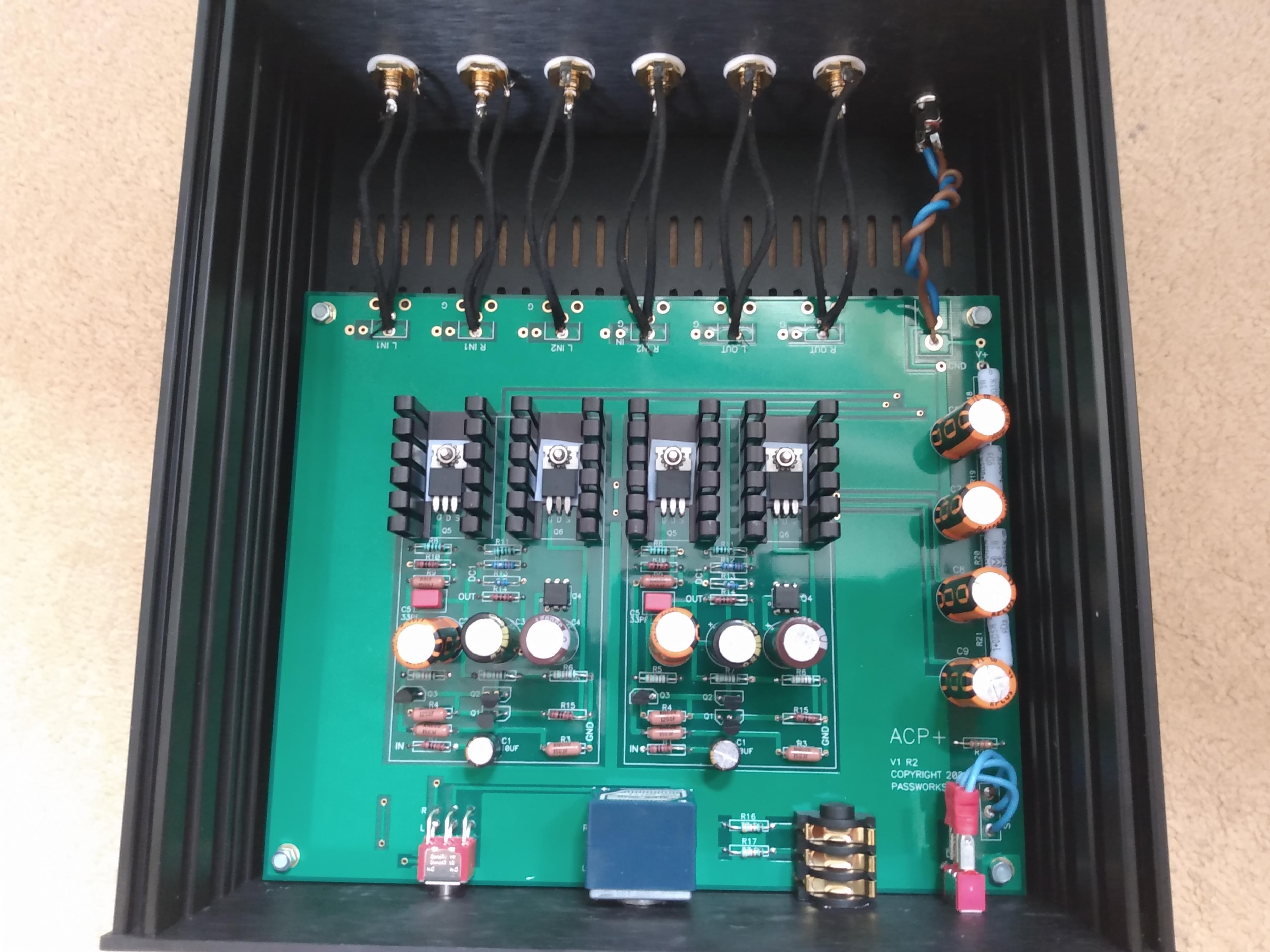

I just fired up the ACP+ and got a thump-thump-thump sound on the headphones, like if I had created a small pulsating machine. Led was blinking on/off, voltage across R4 where almost reaching value, and then dropping back to 0.8V.
Having already read your experience, I swapped the Kit's poser supply with the ACA v1 I have (19v/4A) and, voilá, I have lovely music playing on both ears.

Hi, a while back I posted that I had a problem with the LED pulsing once the build was completed. I hooked the amp up to some music and heard music pulsing as well. Somebody had mentioned that it maybe the power supply and suggested to try a laptop supply, which I did. Although the only one I had was 19VDC at the time, but it worked. Once I replaced the 24VDC/1A Walmart with a larger supply (24VDC/2.71A) everything was fine. I tested the voltages as per Nelson Pass pdf and the amp has been chugging along just fine. Hope that helps. Love the amp...
We are receiving a number of reports of this behavior on the kit and the culprit appears to the the wall-wart SMPS we included. We chose these as they are over-specced for the needs of the circuit and were pretty inexpensive compared to the Triads Nelson specified in his article. Unfortunately some do not appear to function as specified and are resulting in what you are seeing above - pulsing of the LED and failure of the circuit to come on in a steady state. This is actually the result of the wall-wart's short-circuit/overload failure mode, so its saw-toothing from on to off but not charging the input filter caps and so will never actually come on.
If you are having issues as above, please contact me directly and I will arrange to get you a replacement. We are halting orders of the kit from the store and will be shipping replacements to the store that will be included with the kits. In the meantime, if you have one of the Triads or Meanwells that have been used on previous kits that have a rating of 24vdc at 500ma or greater, you should be able to build the circuit and get going.

The issue isn't current, the issue is how much load capacitance the wall wart can tolerate at turn-on. Bigger current ratings don't automatically go hand-in-hand with higher load capacitance specs.
ACP+ puts a lot of load capacitance on the SMPS. As you have painfully discovered, some SMPS can handle this gracefully and others cannot. UNfortunately, very few SMPS sellers are willing to write a max-load-capacitance spec on their datasheet, and then accept customer returns of units that fail this spec. Just for fun, search Mouser and DigiKey and Element14 for wall warts that have the right voltage and current for an ACP+. Then check whether their datasheets give a max load cap specification. Maybe you'll get lucky (?)

It is worthwile to try a little trick i learned a while ago experimenting with smps. Insert full diode bridge between the brick and input on the acp+.

Completed the kit yesterday. Had the pulsing LED so popped in another 24V brick and all good. The amp has replaced a passive pre and an O2 headphone amp. Partnered with an old F5 it sounds simply gorgeous!!
