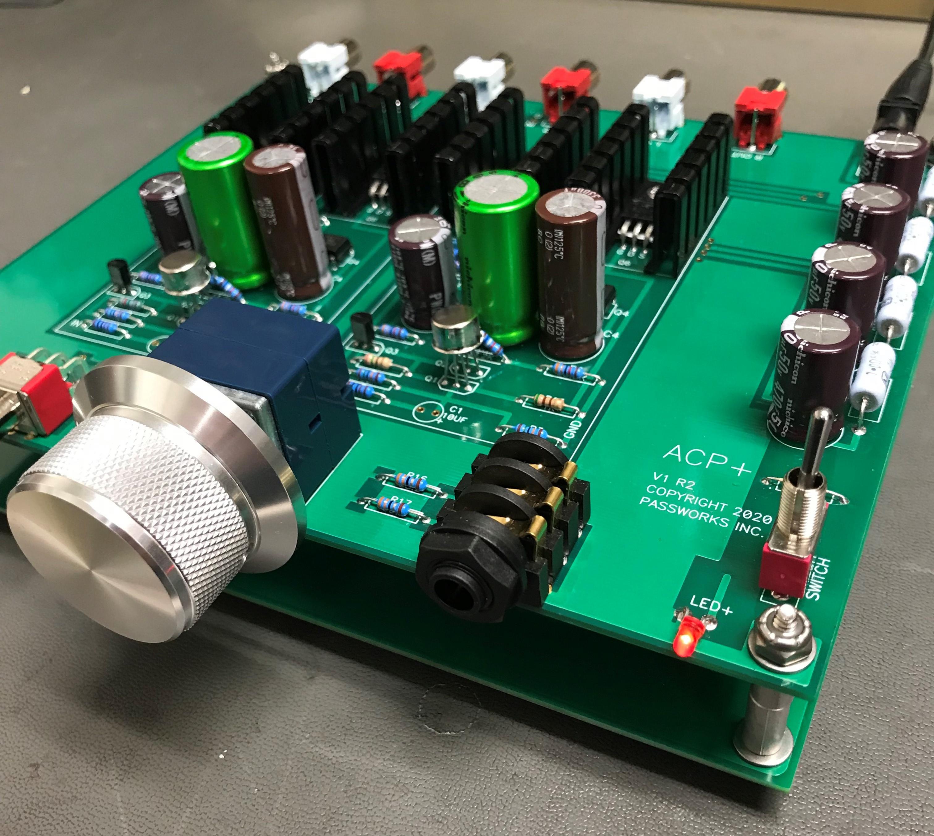

Here is another one. Made a few minor changes from stock. Went straight to the Toshiba 2SK2013 for Q6 since I have a few on hand (matched even). Used some of my very best matched 2SJ74's for the FE. Have 9.1 mA through R4 on both channels after some tweaking. Ended up with 500 ohms at R15 to get the LTP current closely matched, not perfect, but close. Ran a short wire from the volume control shaft to ground so nothing gets zapped hopefully. Ran into startup issues with the switching supply as I was bringing everything up. Was OK initially, then went into "let's just continue to pulse forever and not start...." Worked perfect with a lab supply. Changed all 1000 UF filter caps to 470's (Nichicon PW) and it seems to be starting OK now. I guess time will tell. C3 is 3X 330 UF Nichicon ES, just because. Film cap (underneath) for C1. Haven't had a chance to listen yet, just finished late today.

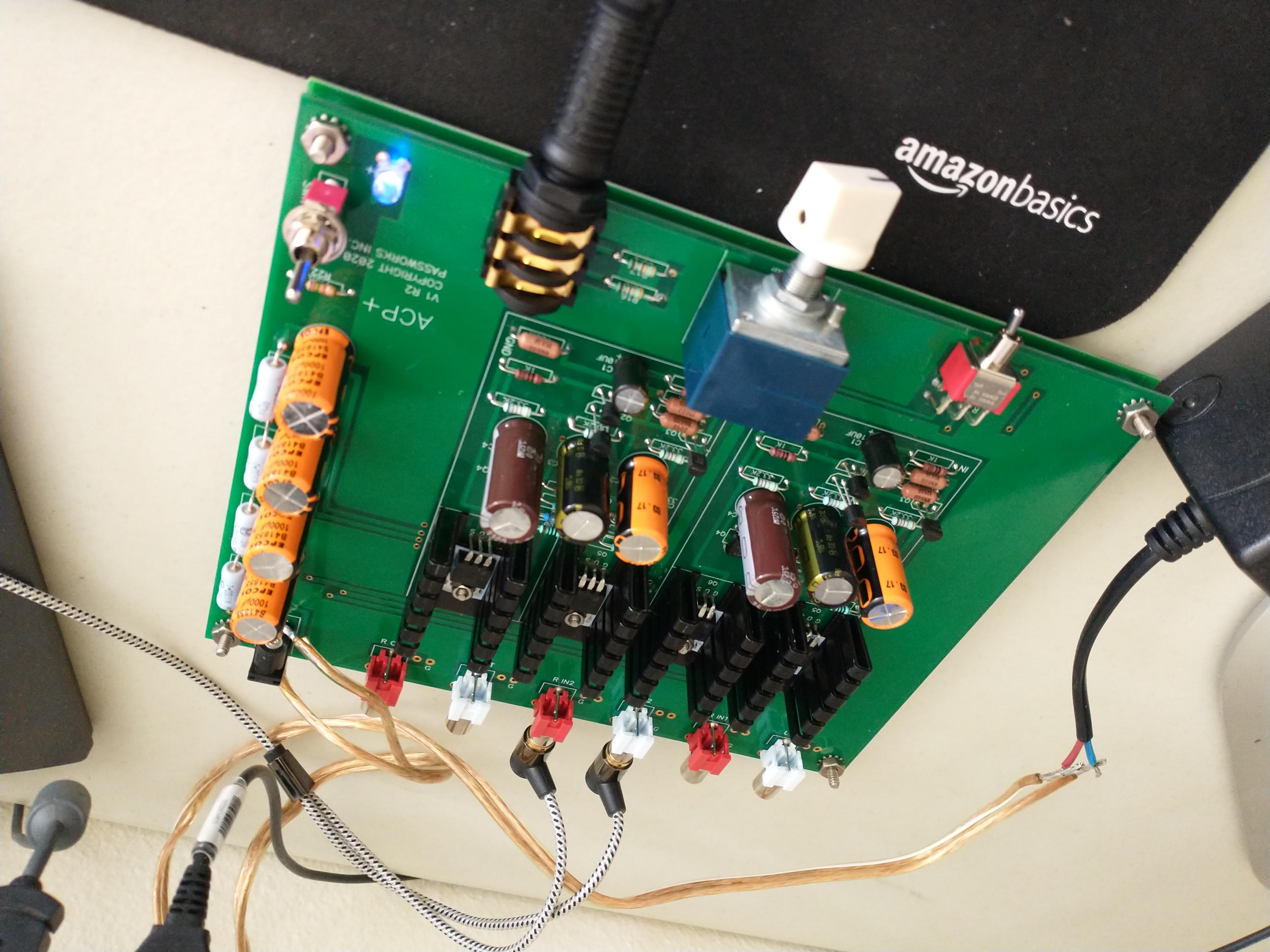

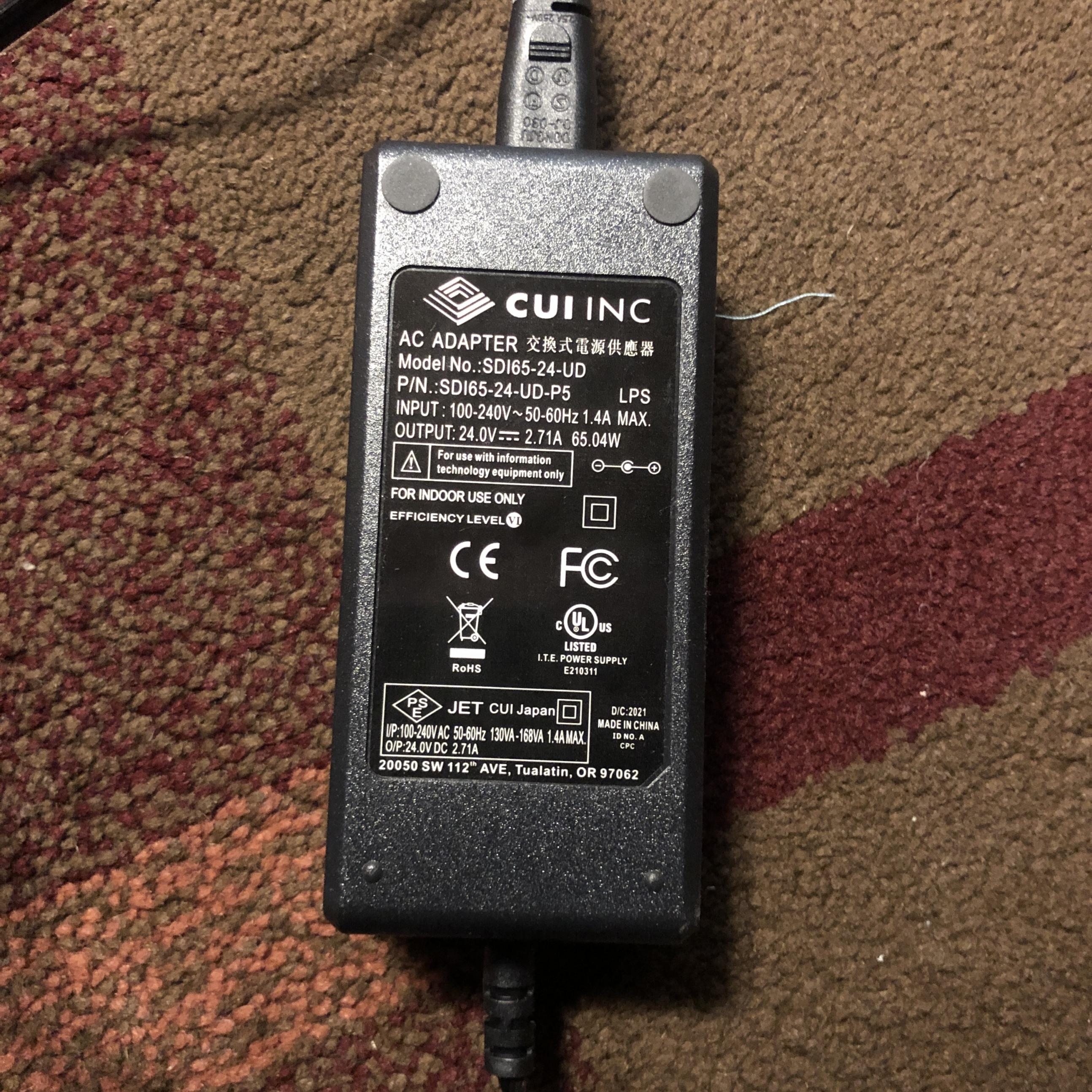

Follow-up on pulsing problem
Hi, a while back I posted that I had a problem with the LED pulsing once the build was completed. I hooked the amp up to some music and heard music pulsing as well. Somebody had mentioned that it maybe the power supply and suggested to try a laptop supply, which I did. Although the only one I had was 19VDC at the time, but it worked. Once I replaced the 24VDC/1A Walmart with a larger supply (24VDC/2.71A) everything was fine. I tested the voltages as per Nelson Pass pdf and the amp has been chugging along just fine. Hope that helps. Love the amp...

My own feeling is that there is just too much capacitance for these little wallwarts to start up properly. I changed both C2's, C6, C7, C8, and C9 to 470 UF and the problem hasn't returned. This is with the kit wallwart. We'll see if it makes a liar out of me, but it seems well behaved now, no pulsing at all. By the way, brief casual listen last night turned into hours of not getting anything else done, and going to bed way too late. Proud papa sure, but it has some really nice synergy with my VFET amp going on here. Beyond just "more gain".

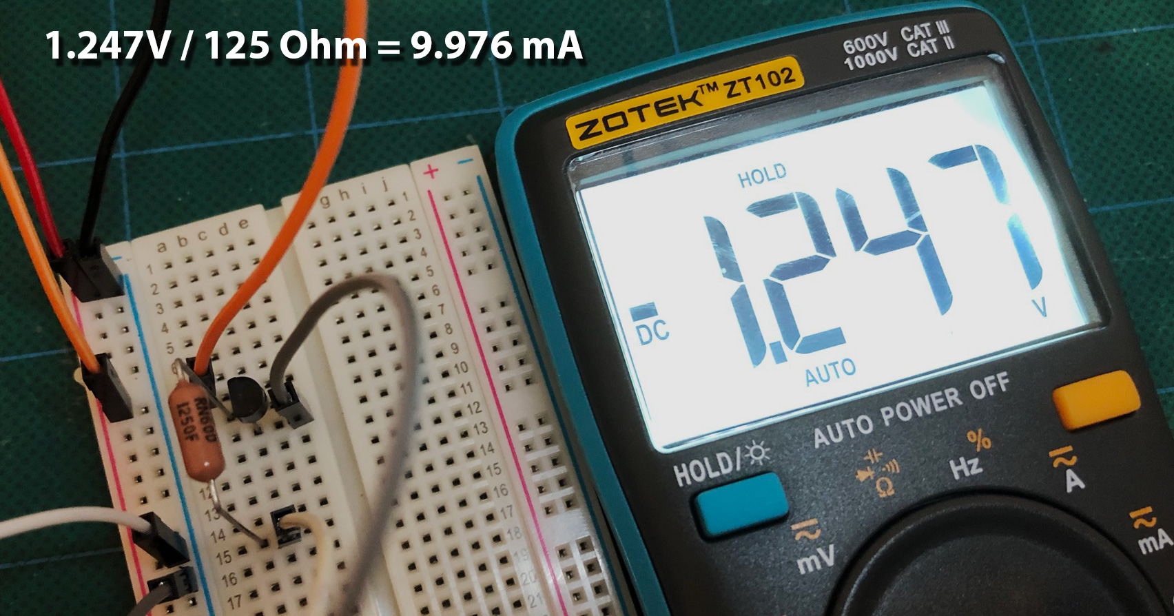

This may need more cases reported, but I can confirm that the Kits from the store have produced 10mA spot on! (well, 9.976 mA according to my MM)
I created the test rig suggested to avoid soldering things and then finding out I required dramatically different R4 values (as others have reported from self-sourced J113).
The kits from the store have apparently been "screened" before hand (perhaps confirmation needed?) and matched accordingly to the 125R suplied.
Here's my rig and the measurement I got:
It's really something else to be able to just trust the values and not having to source and match a lot of pieces. Thanks!!!
