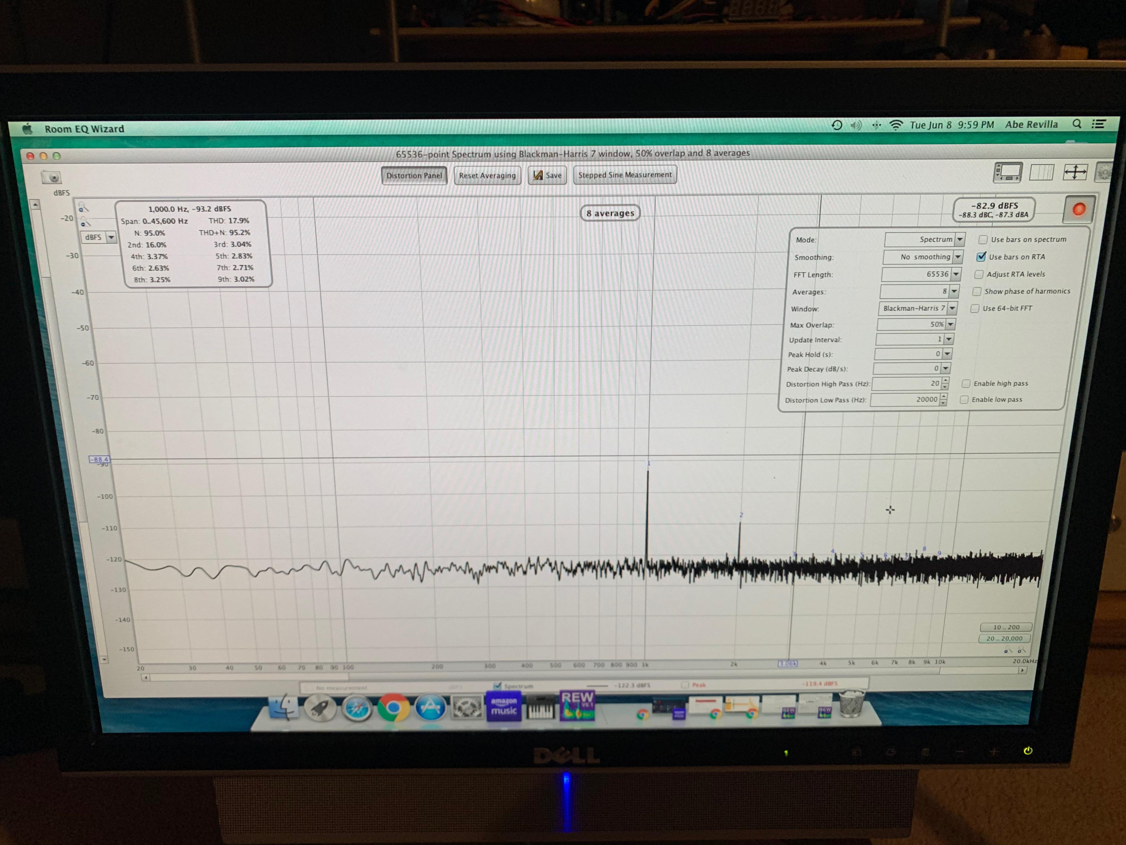

Anyone has a saved distortion spectra of the ACP+ using REW, 1khz internal generator, about 4 to 8 average, no smoothing that you can post? I am trying to figure out if I am doing my set up correctly as I am new to this type of measurement.
Here's a pic of the trial run. Set up is a Macmini to Focusrite Solo, to ACP+, to attenuator, then to Focusrite input. Later on, I will use a battery powered Mac laptop.
Also, how do I create a label on the spectra, as I have seen on other people's graph, before saving it?
Any feedback much appreciated. Thank you!

Oops, I forgot to ask, when doing measurement, even in loopback, the DUT needs to drive a load?

Here is a good how-to:
Howto - Distortion Measurements with REW
To save, click on the camera symbol in the upper left of the screen. It will open a window for entering a title.
I usually load the DUT. For instance for an amplifier I use an 8 Ohm load. For a preamp I usually use a 10K load (to simulate the input impedance of my amplifiers).

Thank you Ben!
