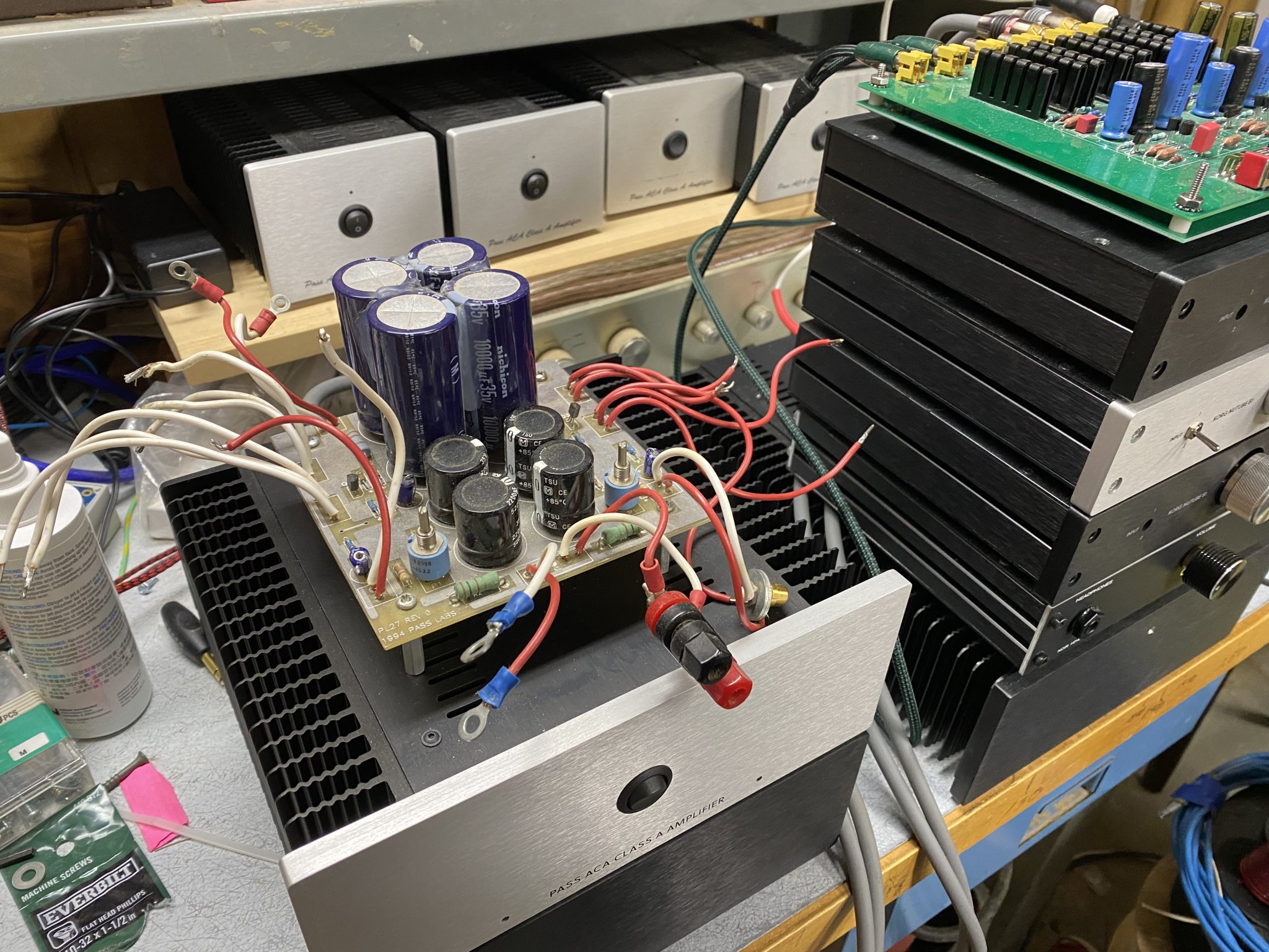

That is a fantastic combination with the right speakers. That is what I run in my workshop - not the Zen amp but whats below and next to it. 😉You're in for a treat.

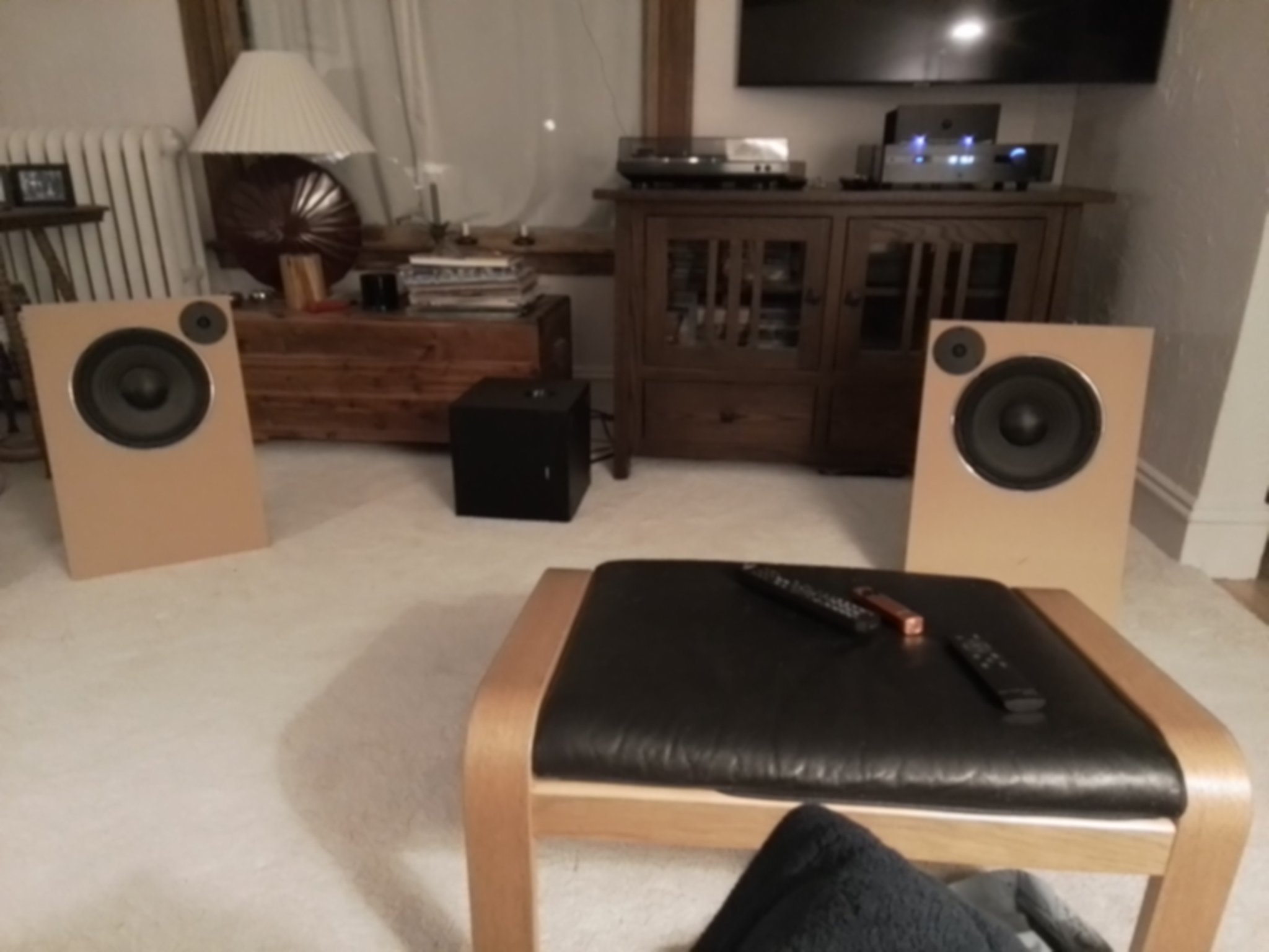

These turned out to be the right speakers for me. I highly recommend them. 91 spl iirc. https://www.audiocircle.com/index.php?topic=108003.0. I left off the woofers and am using a Yamaha NS-SW050 8" subwoofer with mine.

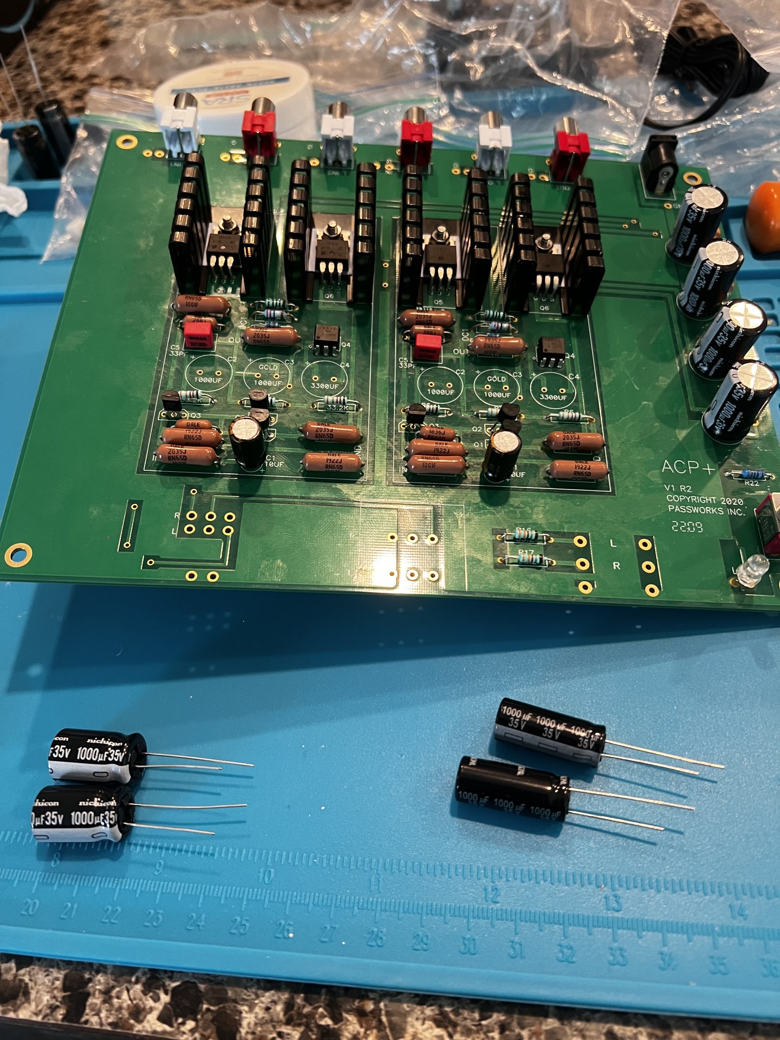

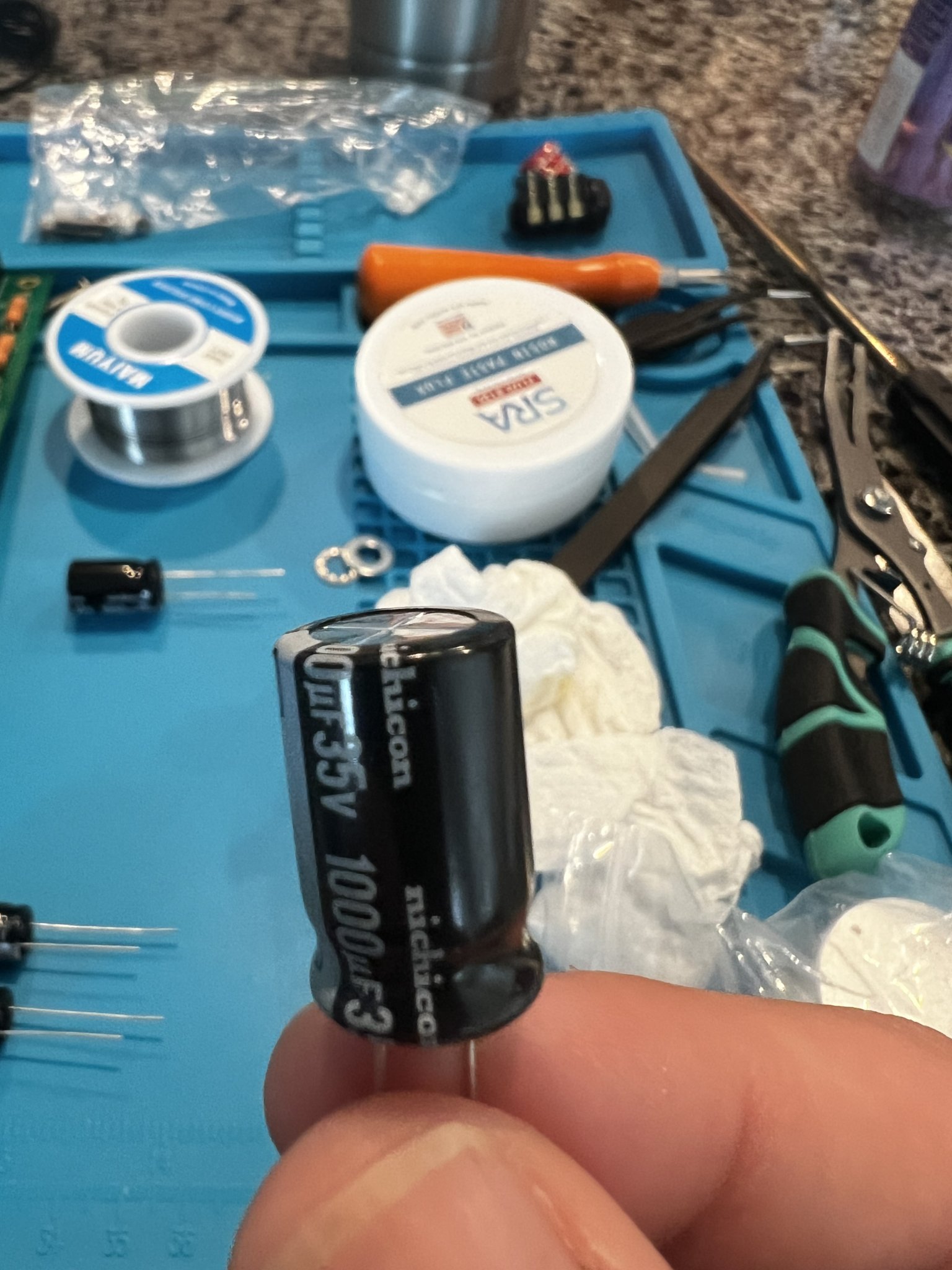

I am installing C2 and C3. The kit brought two different capacitors for these. some shorter 1000uf Nichicons and some taller 1000uf ones. Do I install the smaller Nichicons in the C2?
C3 is the "audio" grade capacitor. Please post pictures of the two capacitors so that they can be identified.

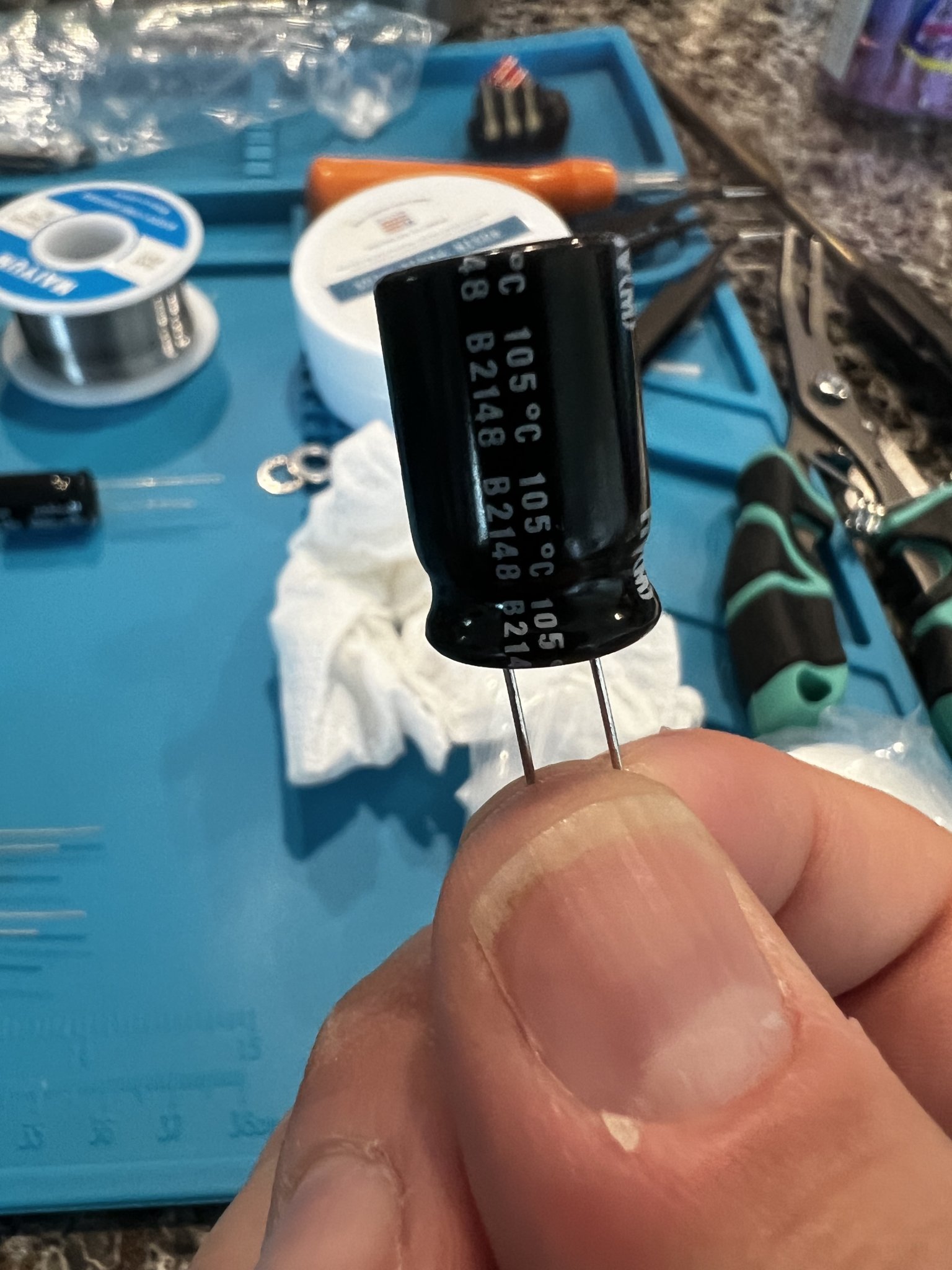

The nichicons are on the left, the other ones on the right.C3 is the "audio" grade capacitor. Please post pictures of the two capacitors so that they can be identified.

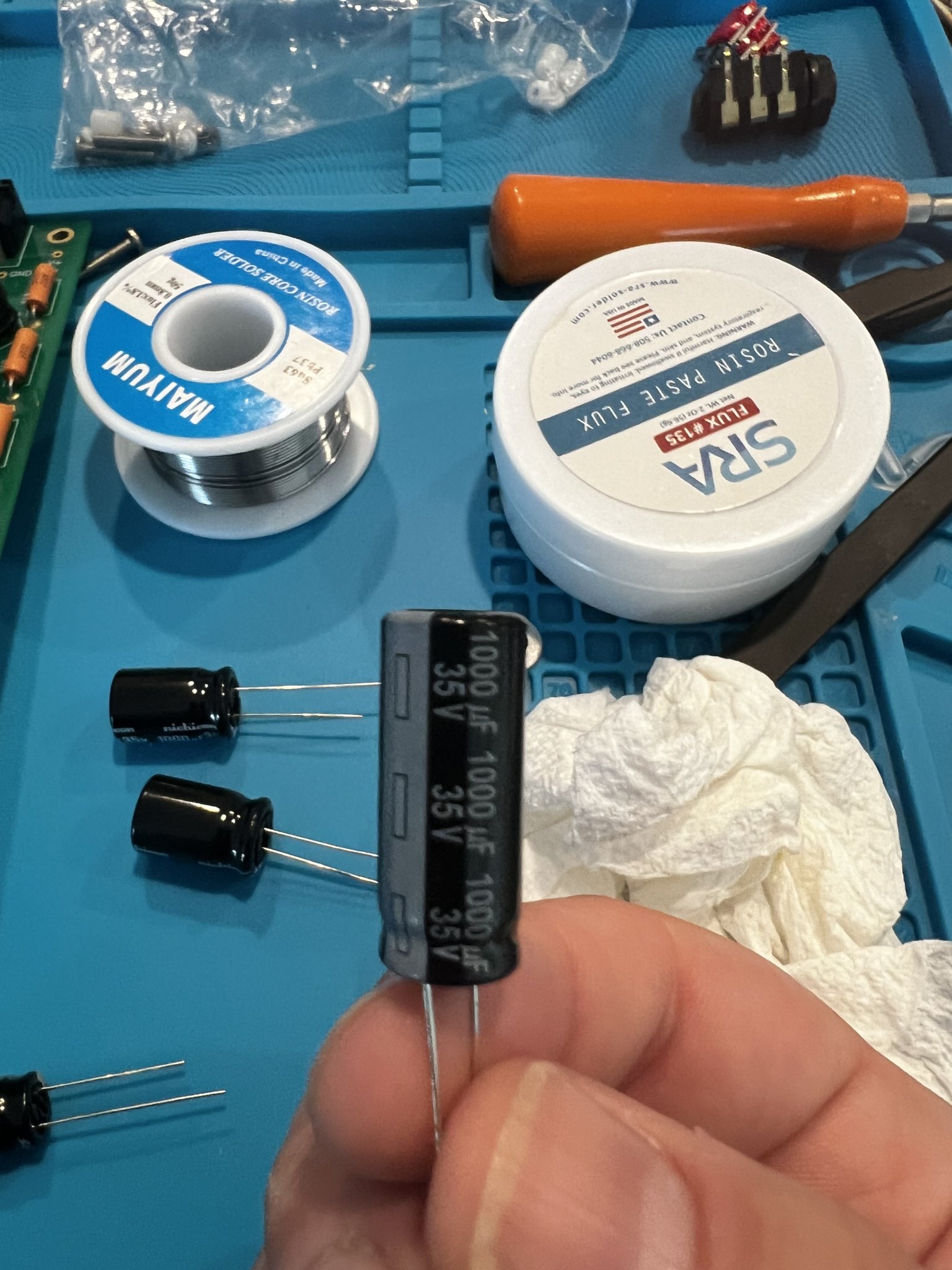

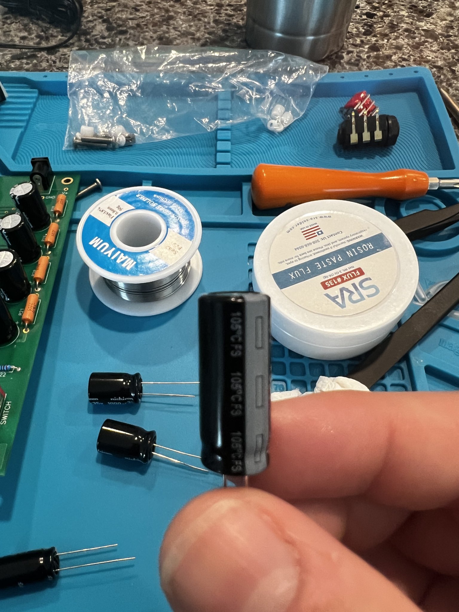

What brand is the capacitors on the right? Please post a picture of the other side of the capacitor.
The Nichicon on the left - also post a picture of the other side.
Excellent! Thank you!I just had another look. C2 capacitor should be the same type as C6 to C9. So the capacitors that are different from those are for C3.

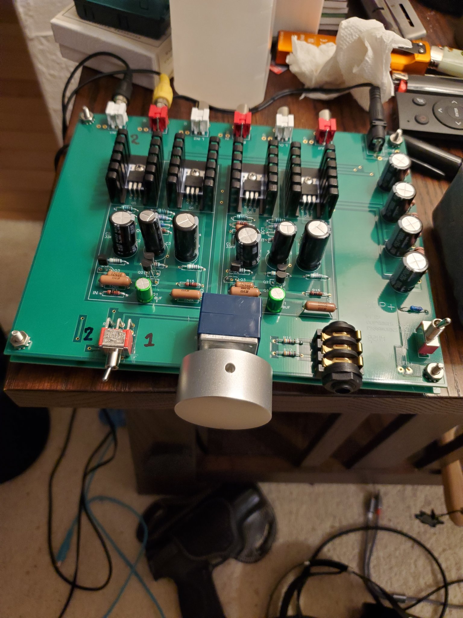

They were a bit tedious to stuff, but nothing crazy. I am almost done, lets hope I didn't screw something up!
