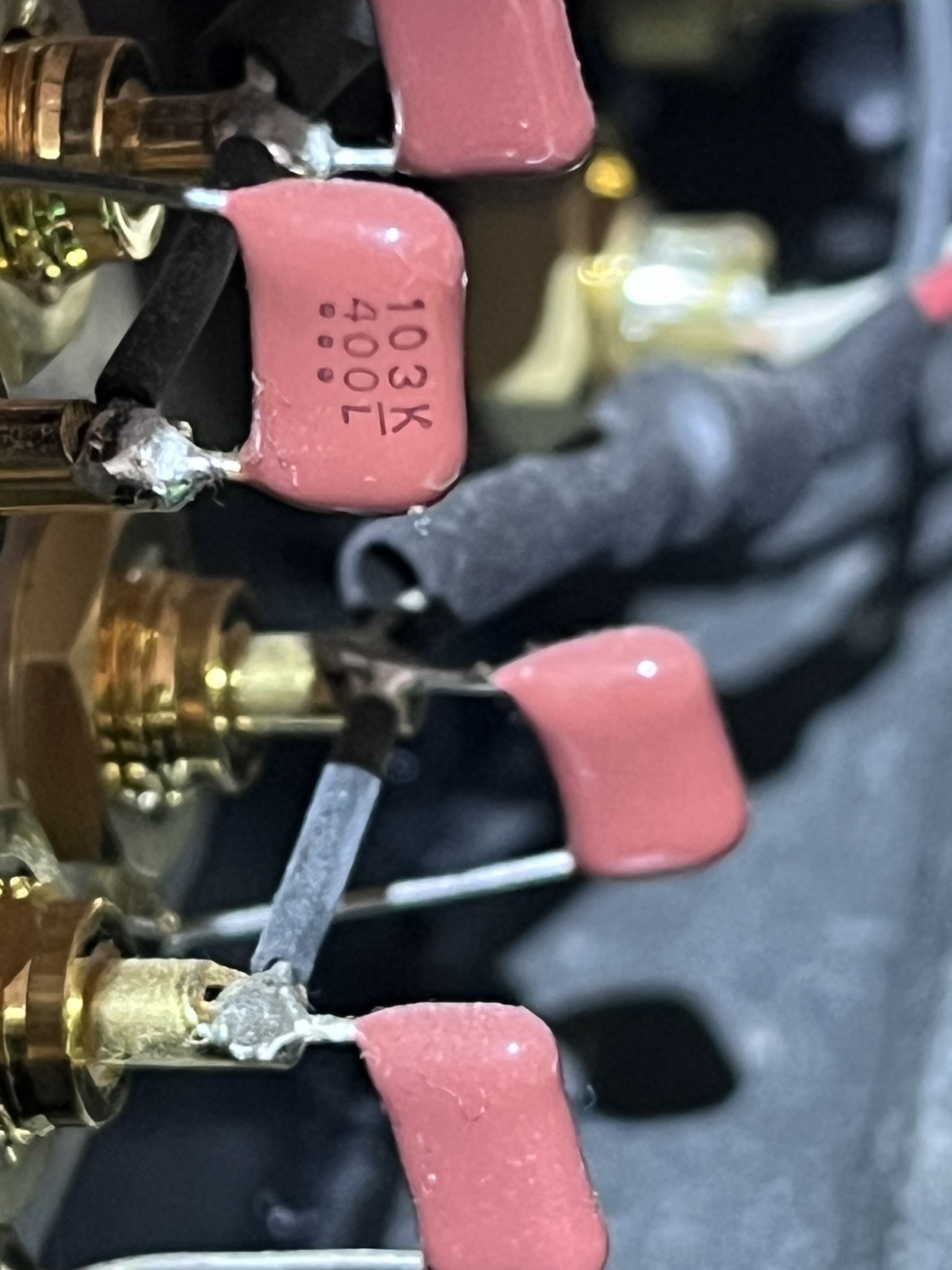

I opened another preamp I have in hand, it seems there is a capacitor soldered between signal and ground of each rca output, that's I am thinking needed but don't know which one I shall have for ACP+.
That would increase the capacitance, and there’s not much reason to do so. It’s probably on that preamp to help with switching selection noise.

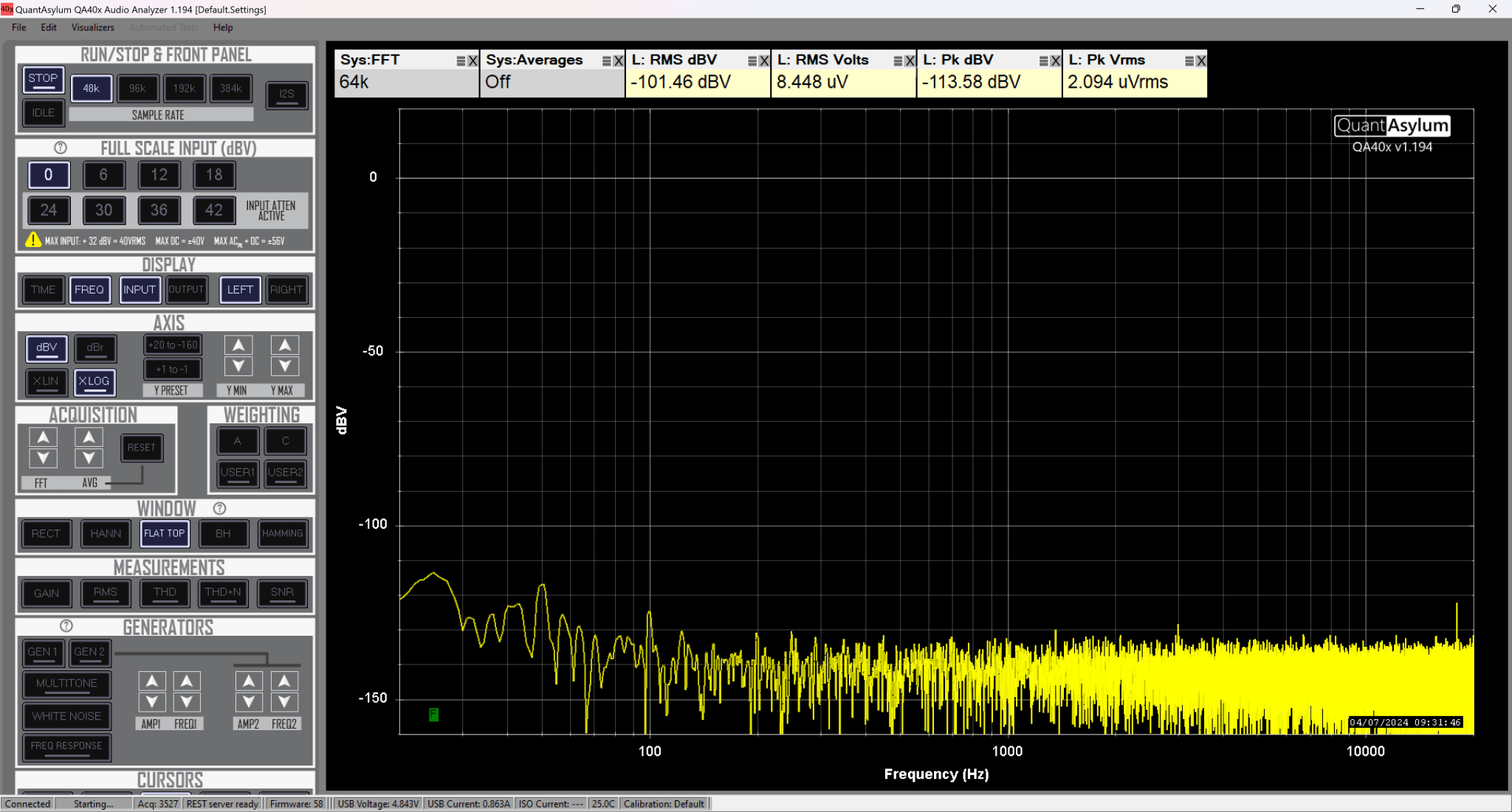

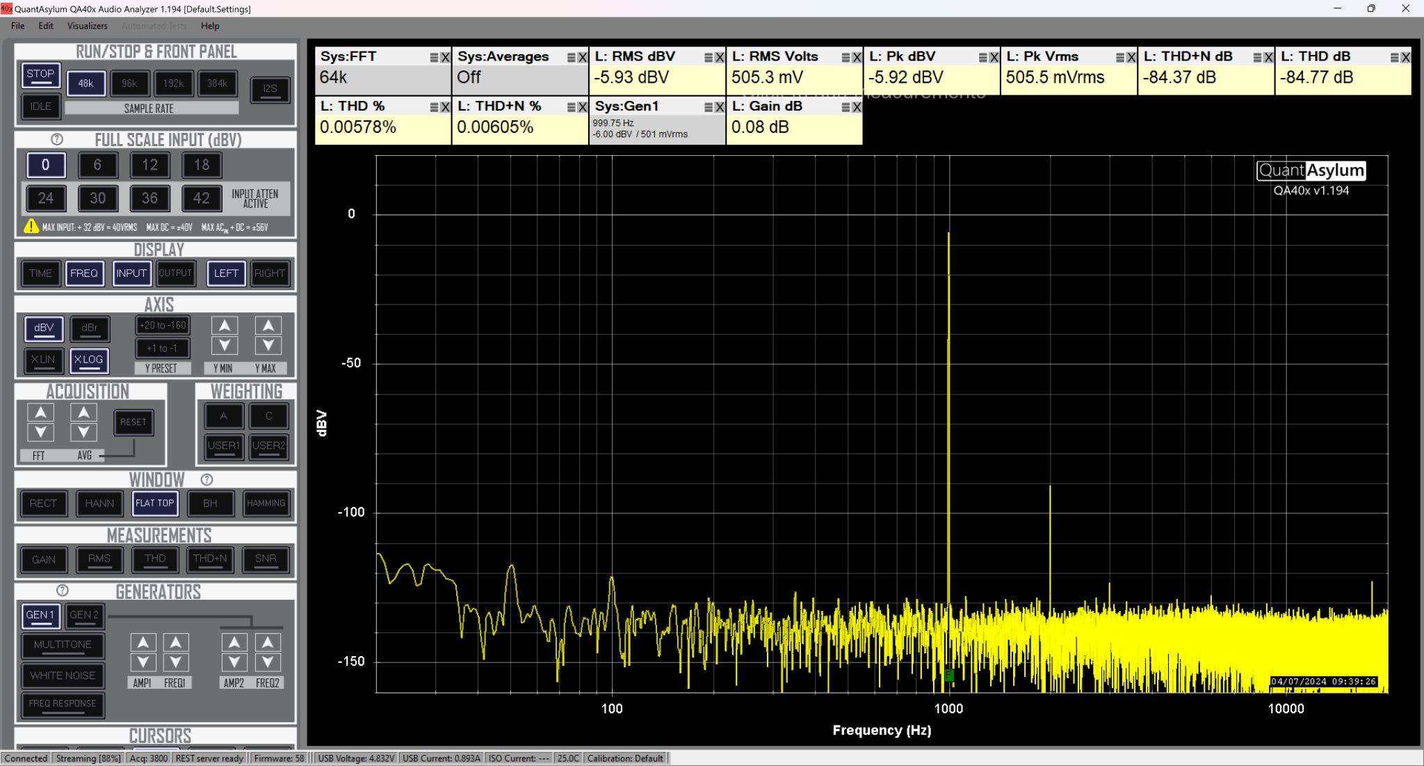

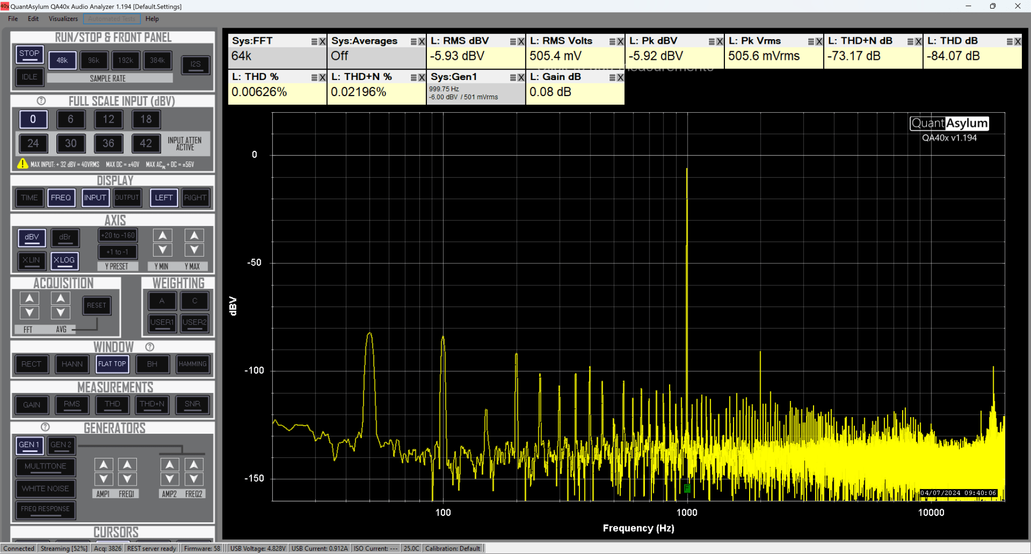

I was playing with QA403 (an audio analyzer) and tried a few things with my ACP+. I noticed there is something happening ~18kHz. It does not seem to be related to the power supply and the input. I tried both a battery and wall mount switching power supply, and I do not see this when the analyzer is in loop back so it is not related I guess to the source. Is this normal, why would be the reason for this ?
ACP+ powered with battery, no input signal:
ACP+ powered with battery, and with input signal from the analyzer:
ACP+ powered with wall mount switching power supply (Triad Magnetics WSX240-1000), and with input signal from the analyzer:

Looks like something external, possibly coming from the AC mains.

But it exists also when ACP+ is battery powered. QA403 audio section is also isolated from USB and I dont see this in other tests. I dont know if it can be due to environment, I did this test in a different place then I usually do.

Mark's SMPS filter is effective right in that range. Try using that after the PSU and before the ACP+ and I bet you will see that artifact disappear.I was playing with QA403 (an audio analyzer) and tried a few things with my ACP+. I noticed there is something happening ~18kHz. It does not seem to be related to the power supply and the input. I tried both a battery and wall mount switching power supply, and I do not see this when the analyzer is in loop back so it is not related I guess to the source. Is this normal, why would be the reason for this ?

I have tried also the SMPS filter but I dont see much difference in the spectrum comparing to wall mount adapter. Maybe I did something wrong when building the filter but electrically it works.

Does your analyzer have a float and ground switch?
Try it both ways?
I had an issue like this many years ago with the ACA. It ended up being the switch mode power supply. When tested with a switch mode power supply that had a ground pin there was no noise. When testing with a switch mode power supply without a ground pin it was noisy.
The 18kHz could be conducted and radiated interference. The 18kHz noise while using the battery is so insignificant (-120dB), it’s not worth worrying about.
No the analyzer does not have such a switch, so the audio section is always floating. A few things are mentioned in some places and I tried some things but it did not change anything. On the other hand, I tried another (commercial) device and it is pretty silent.
My switch mode power supply has 2 pins, I should try one with grounding, good idea.

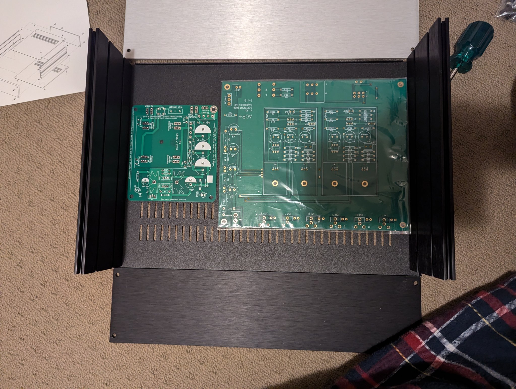

Hey all,
I'm just in the early planning stages of my 'ACP+ in a chassis with PSU' build, and thought I'd get some suggestions now before I do anything irreversible/regrettable.
(I know some of you may feel putting the power supply in the chassis is regrettable, but I'm doing it anyway)
Here's the basic idea - the board in a Galaxy chassis with a FlexReg single rail supply. Here are my random thoughts so far;
Any suggestions or cautions welcome. Especially on how to cut an IEC inlet hole into the backplate. I'm thinking to trace the outline, drill holes into the four corners of the outline, dremel cut between the holes, and then file clean. Getting a good angle with the dremel seems tricky though - might need one of those umbilical thingos.
- I plan to have the pot and RCAs off the board, as getting the holes to line up with the board positions seems like an absolute bear
- I want to run a switch on the front of the chassis (hence the AC input side of the FlexReg facing the front)
- I was considering having a gal steel sheet fence between the FlexReg board and the main board, drilling a hole with a grommet to feed the power through to the main board, but I'm not sure it's necessary or just paranoia (my Whammy doesn't seem to have any issues with having the transformer right there on the board, not sure if ACP+ would be any more susceptible to issues)
- I might bridge the on board power switch pads, although I guess having an unused internal switch doesn't harm anything
- there are three different locations from which I could run an LED (FlexReg power on, FlexReg positive rail, ACP+ LED), but I figure the ACP+ location makes most sense (I suppose there'll be a tiny delay, but hardly noticeable)
- I assume I can just populate the ACP+ power section caps without issue, even if they are redundant?
- I figure I need to isolate the ACP+ board from chassis ground and, ideally, star ground to the chassis at the chassis ground mounting hole on the FlexReg board - so nylon supports for all but that position? Do I need to isolate the pot also?
- I was thinking I could slide some m3 nylon nuts into the channels on the side panel closest to the FlexReg, and then use a chain of two zip ties to hold the AC power input wires (twisted) up and to the side.

You'll do fine; it ain't rocket science, after all. If you're considering having the front panel milled/engraved (e.g., Front Panel Express), shoot me a PM -- I can share my .fpd files. See post # 222 in this thread.

I just took a look. Very cool. I considered having things milled/engraved, but I don't know much about the relevant software. I might try it by hand first, if for no other reason than to make sure the layout works. My plan is sort of the mirror image of yours. I appreciate the offer though. 🙂
